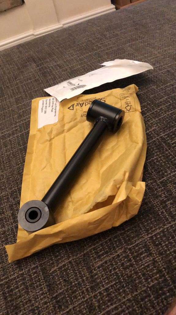

Decided to change the standard mount for the Evol mount. Going to give it a go at the weekend fitting it.
Anyone have any advice? Or anyone struggled fitting one? I’m quite a newbie when it comes to messing about with cars.

Which evil mount did you buy
  Clio 182, Megane 225
Which version did you ask for as he does a couple.
I’m not sure I just ordered it off Ebay, I’ll have to check to see if it says it on the paperwork, I’m guessing it’s to do with the different hardness of the polyurethane?

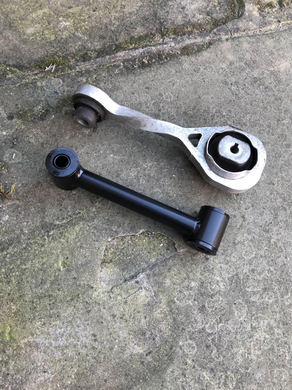

For the money, it's my favourite modification I've done to my Clio so far, makes a huge difference! It does increase the vibrations quite a lot, but I like it cause it's gives a sort of racecar feel haha. Really easy to fit.
As above, sit the car on axle stands, you don't need to support the engine - if you do the bolts won't line up and it'll be impossible to fit.

I’m not great mechanically but I found this job really quick and easy. It is also my favourite mod so far and I didn’t notice much of a difference with vibrations either.
As others have said make sure you use axle stands though for safety.

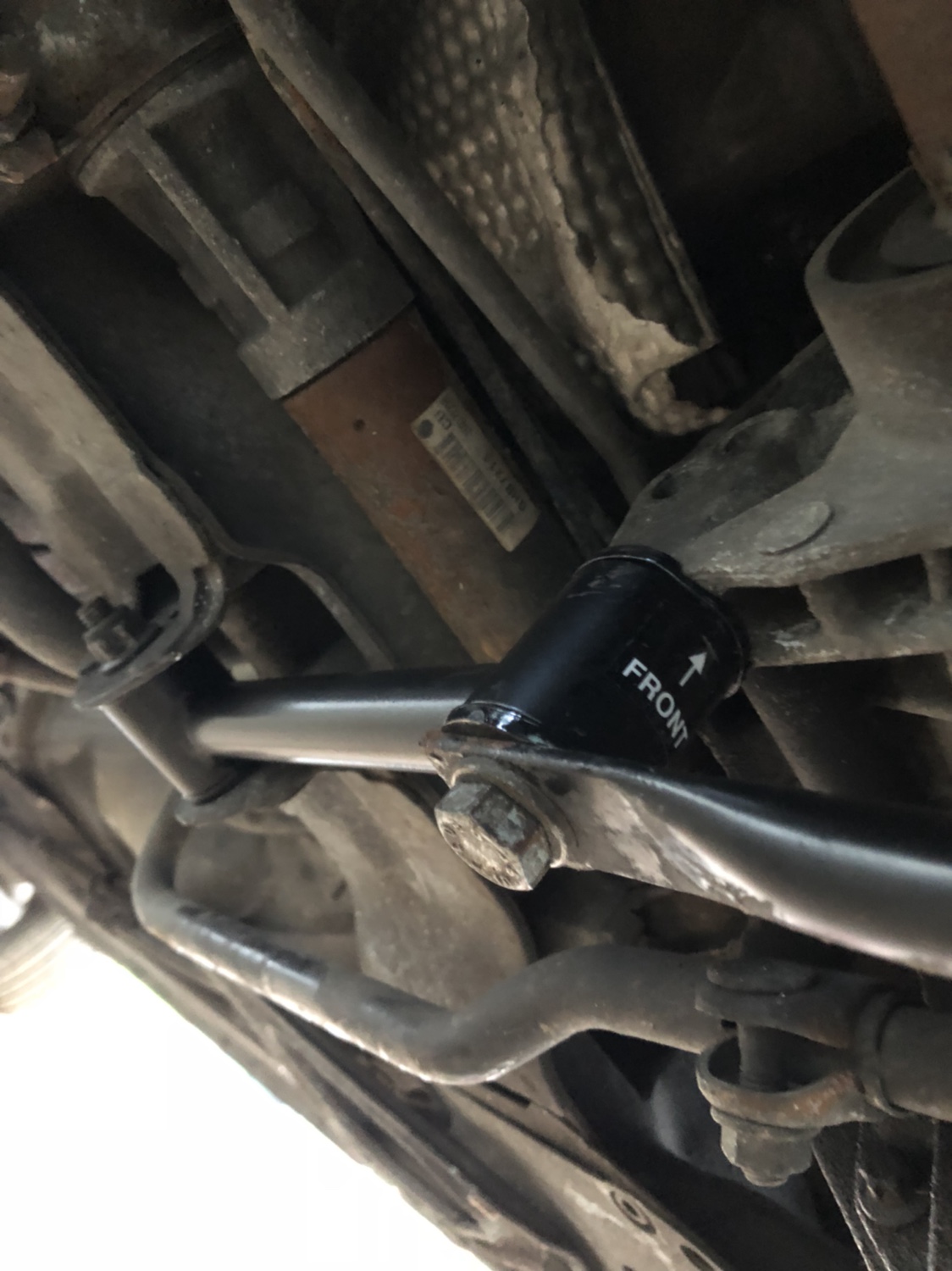

Just fitted this last week along with the upper right engine mount and must say some difference.
It does vibrate a fair bit but once ur driving it calms down a bit most when ur sitting idle it’s worse but such a good mod

Thanks to all who commented. I found it a very nice and steady job, I’m not great when it comes to cars but I’m learning. Not sure if I tightened it up too tight? Feels fine in tick over but when I start driving it vibrates a lot [emoji23] think it’s a great modification, I can see why people rate them so much. Next week I’ll be taking off the Vmaxx Coilovers 60mm not 54mm, for standard suspension and lowering springs as I find the coilovers too hard. So will have them going for sale cheap if anyone is interested!
