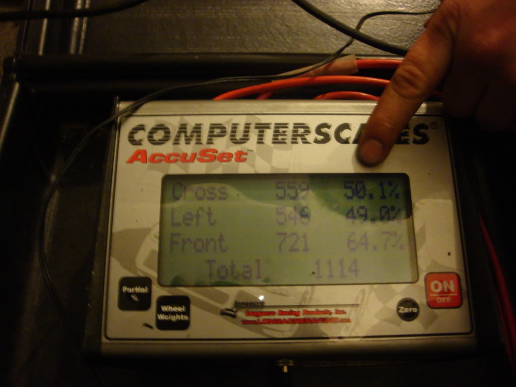

The car enters the garage for the first time for the initial weigh in before stripping anything out of it. We filled it with a full tank of fuel and stuck it on corner weights.
For a car that cost me just £1700 back in May of 2011, in good condition and with 90k on the clock….it's doing well. The weigh in reads out at 1114kg with a 64.7% front split.

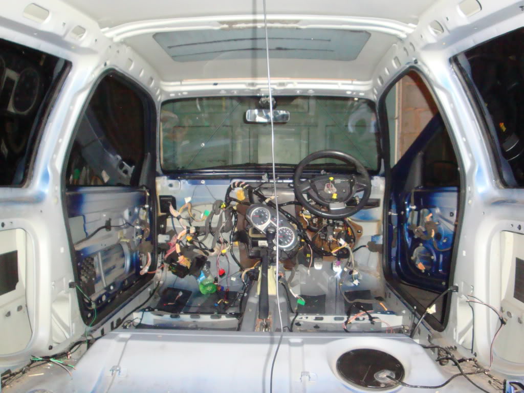

Today is stripping day and boy did we gut that thing quickly! All seats and interior trim out in 3 hours by Rob and I.
We could have weighed everything we took out and give a nice break down of the change, but that's way too much effort. The seats and seatbelts were immediately sold and Rob took them down south to a guy who gave us £175 for the lot, already recuperating some of the costs!!

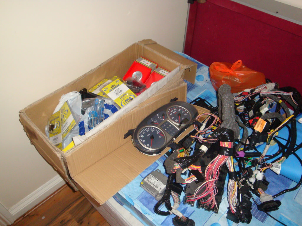

We've obtained some very vital parts. We did an order of electric components, mainly switches along with a number plate for the trailer and some gauges. The whole lot adding up to just over £100.

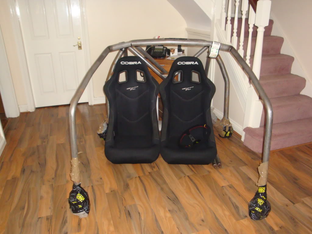

We have also got ourselves an OMP bolt-in cage at just £530 and some Cobra Monaco Pros (in date until 2014) for £225!! Lovely jubbly.

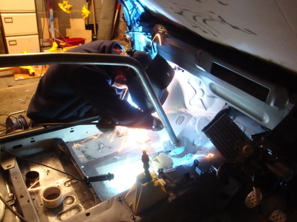

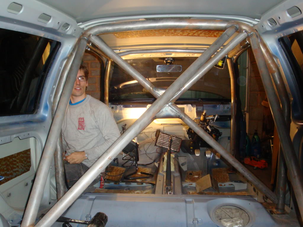

February 2[SUP]nd[/SUP] 2012:

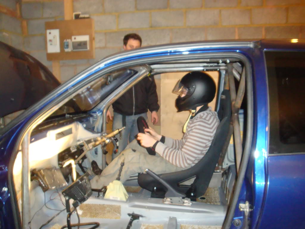

Initial test fitment of the cage (Rob looks proud of it coming together), so we can figure out where all the mounting plates will need to be welded and so on.
He's me sitting in the seat (I'm the tallest of the 3 of us), mocking up where the seat mounts will go as well as steering rack position.
  Chase Racing Clio
February 10[SUP]th[/SUP],11[SUP]th[/SUP] & 12[SUP]th[/SUP] 2012

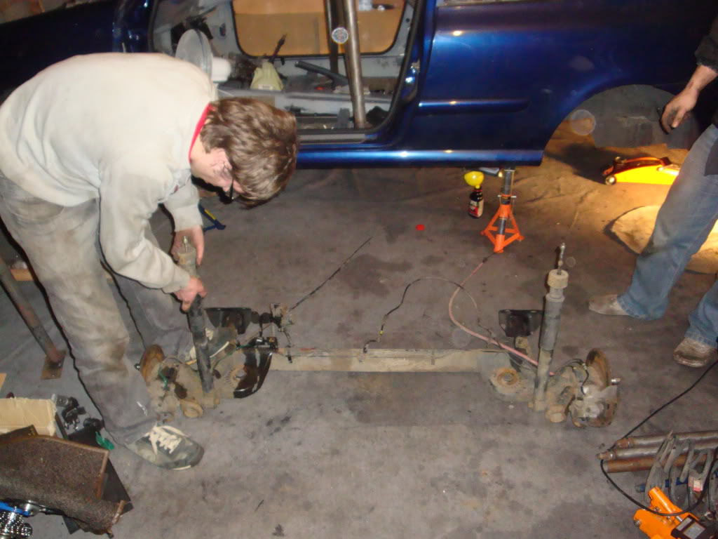

A weekend working on the car commences; Whilst Ryan is fabricating all the bracketry and welding things in place, Rob and I will crack on with other items on the car. So, out come the rear beam and the rest of the rear suspension components and brakes.

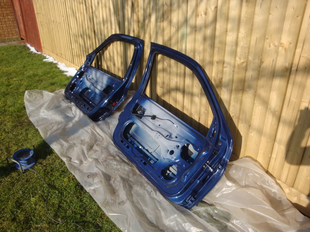

The doors comes off the car and out comes the glass, the inner skin will get chopped for that extra bit of weight saving!

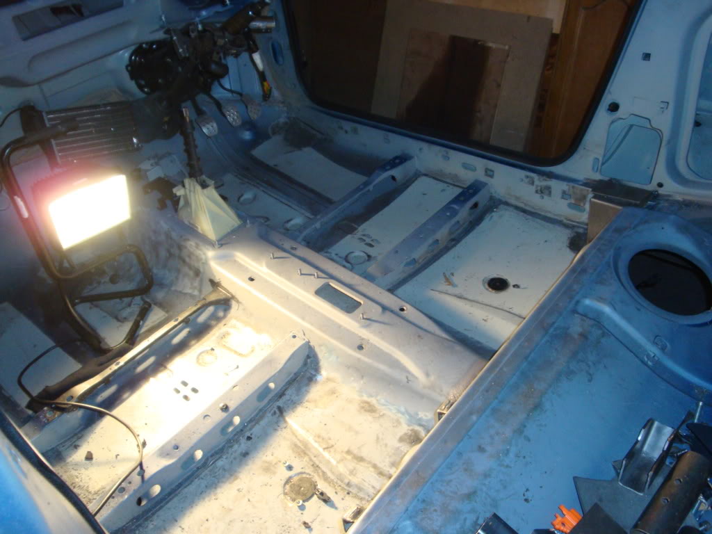

Rob's been busy inside the car with the wire brush attachment on the grinder and a lot of petrol…. All the sound deadening is gone!
All the glass has now been removed as well. The doors were carefully extracted, but the rear was not!

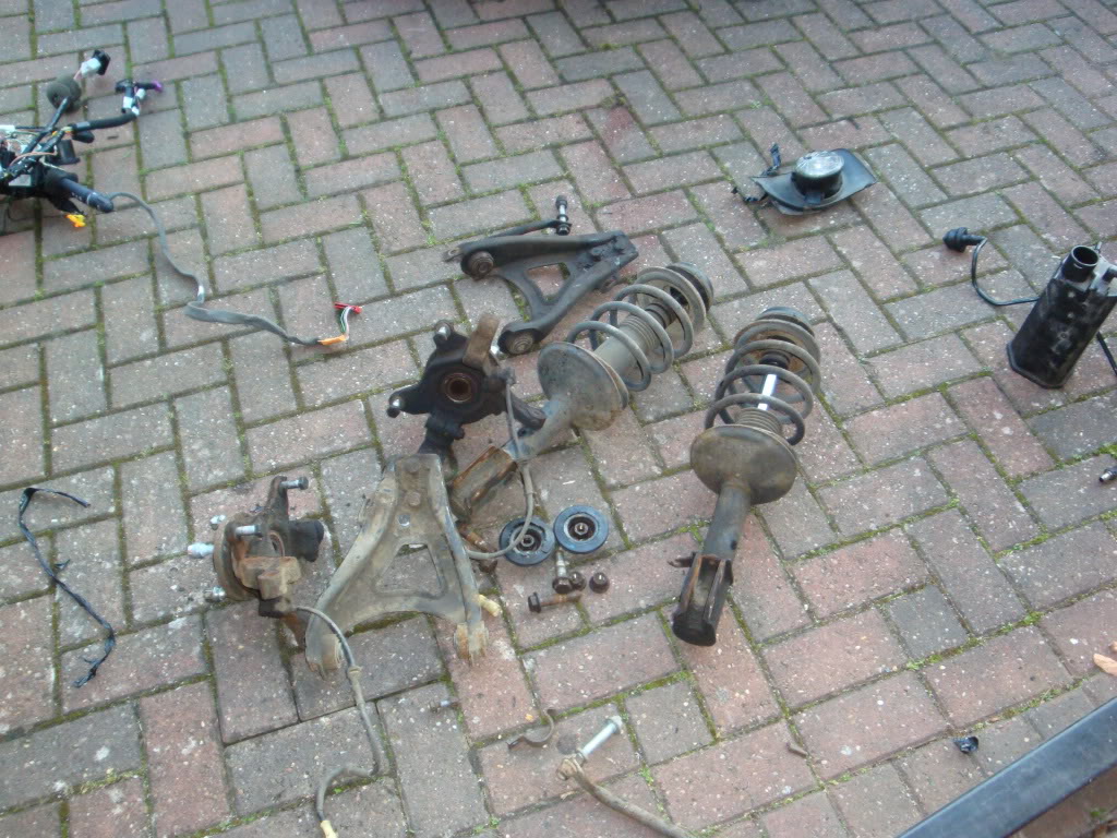

February 25[SUP]th[/SUP] 2012

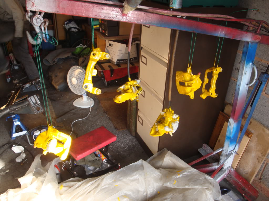

Some more thorough cleaning from Rob and all the brake components have been painted up.
An air compressor proved very useful in removing all the front suspension!

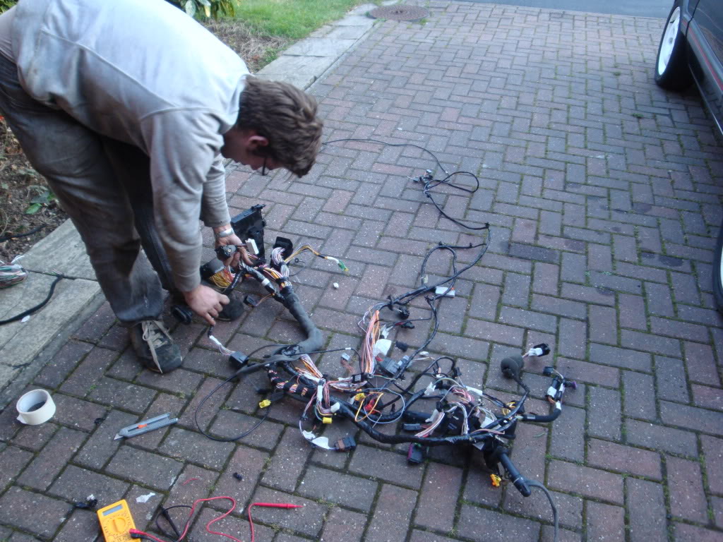

Rob starts on the unenviable task of sorting through the main loom (this won't be all done for a while)

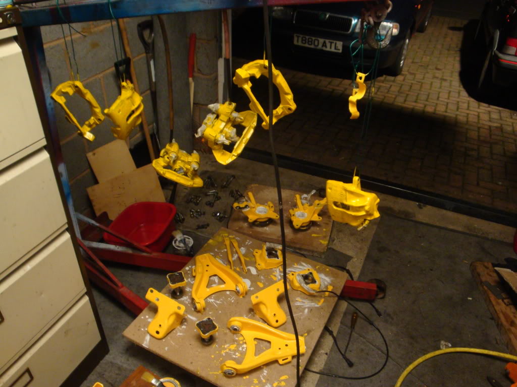

February 28[SUP]th[/SUP] 2012

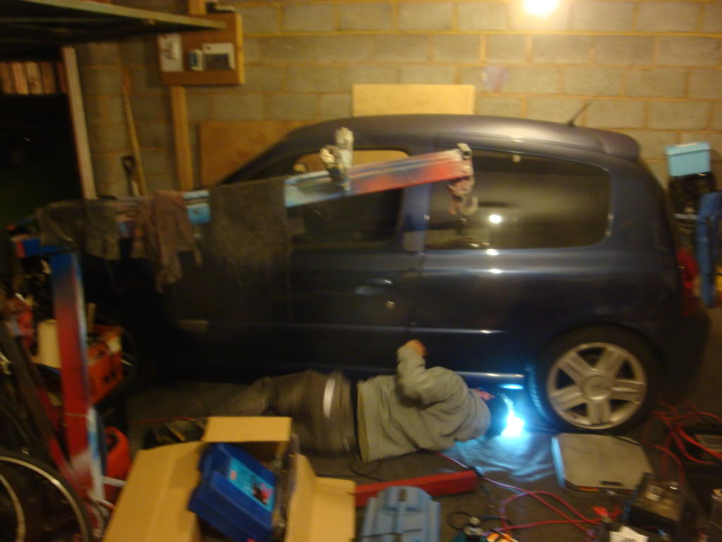

After a little delay with the welding as we had to get ourselves a big bottle of gas, Ryan is continuing the progress of fabricating all the base plates and so on.
Following on from Rob's efforts with cleaning up all the suspension components, I finished off painting them all a nice vibrant yellow!!

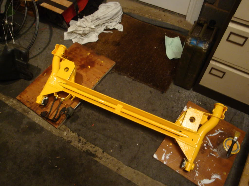

Even the rear beam (complete with strengthening plates) gets the same treatment!
What paint did you use? Looks good.
  Chase Racing Clio
It's just yellow hammerite (there's the tin next to the beam). The art is in the preparation, Rob cleaned them up real nice with the wire brush on the bench grinder. We did a white undercoat as well, also hammerite.
