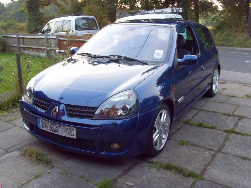

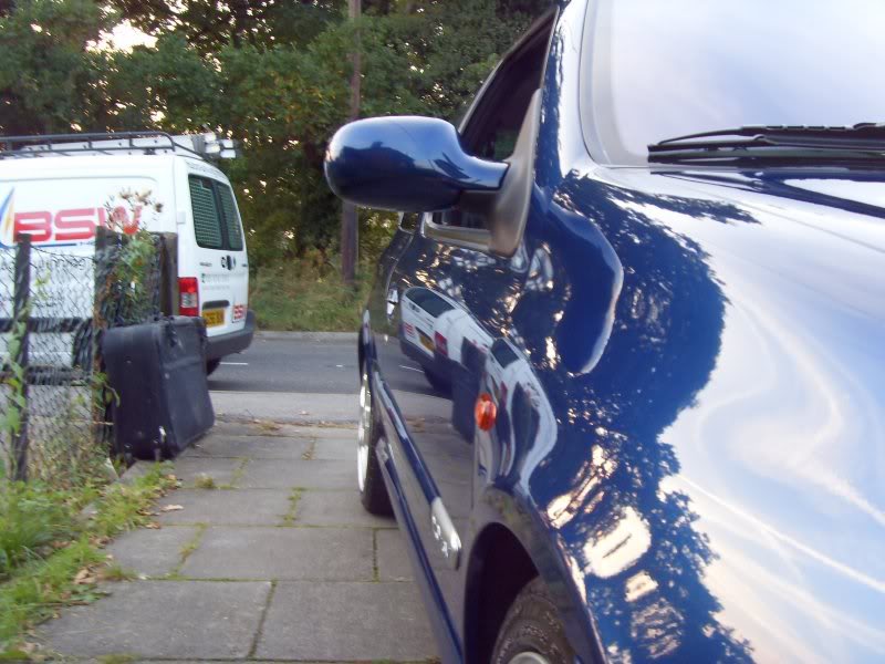

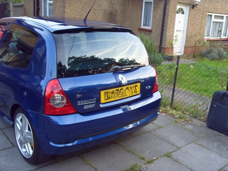

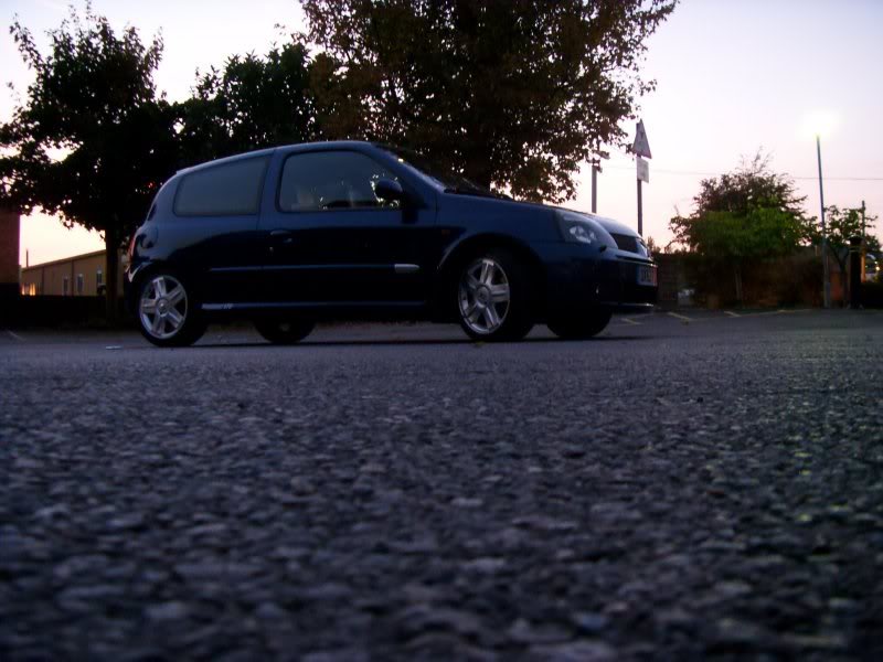

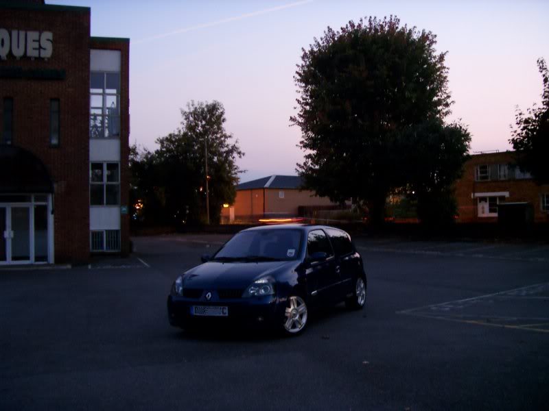

here's the couple I think are ok ISH.. the rest are just pointless showing
on the drive prior to egp:
in car park after egp but too dark to really see much (some of the ones that actually came out not blury):

Looks like your camera is on Macro mode mate as the photo's from further away are blurry.
Looks clean though mate :)
