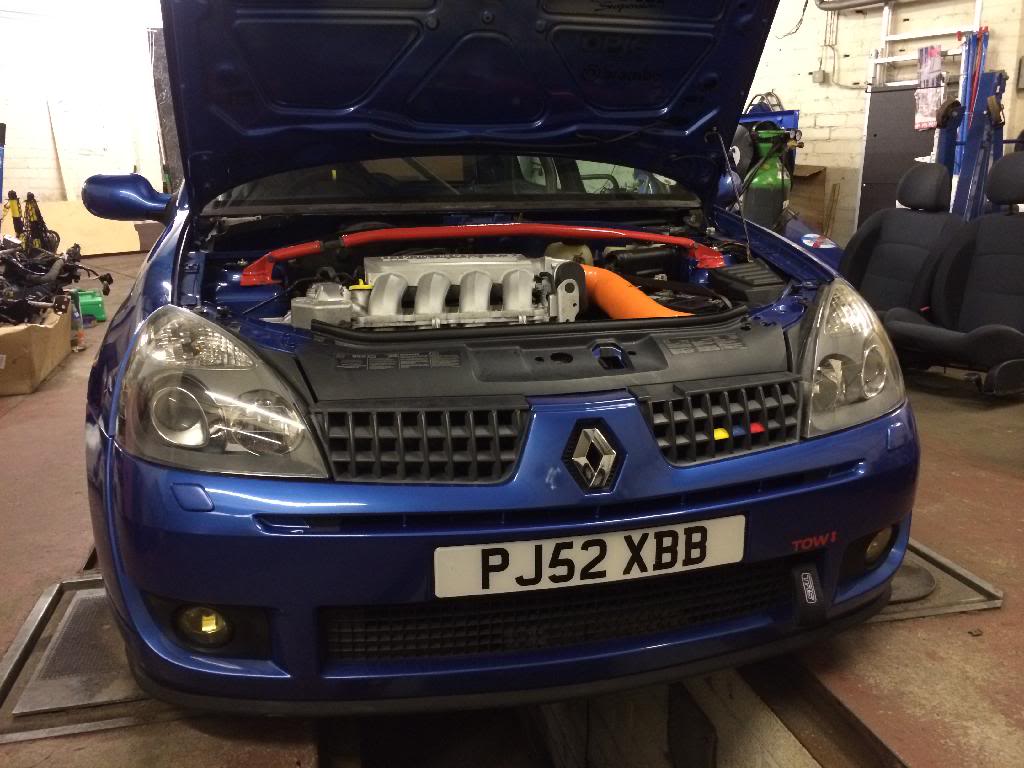

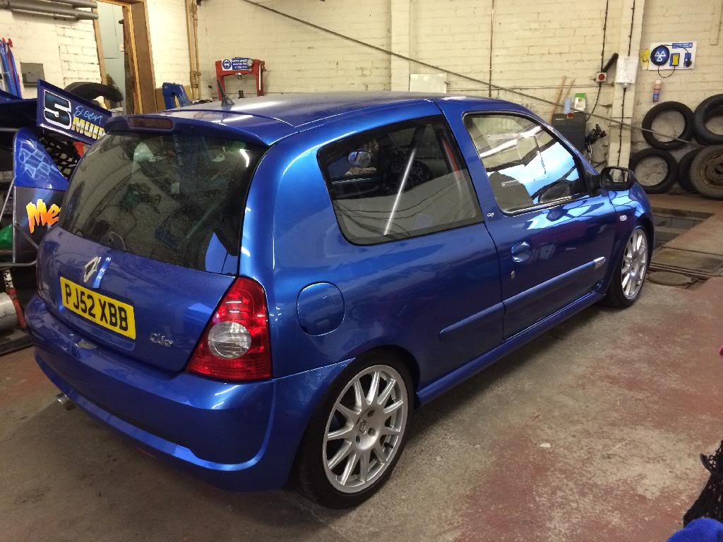

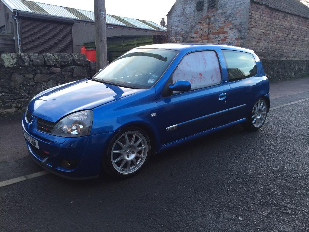

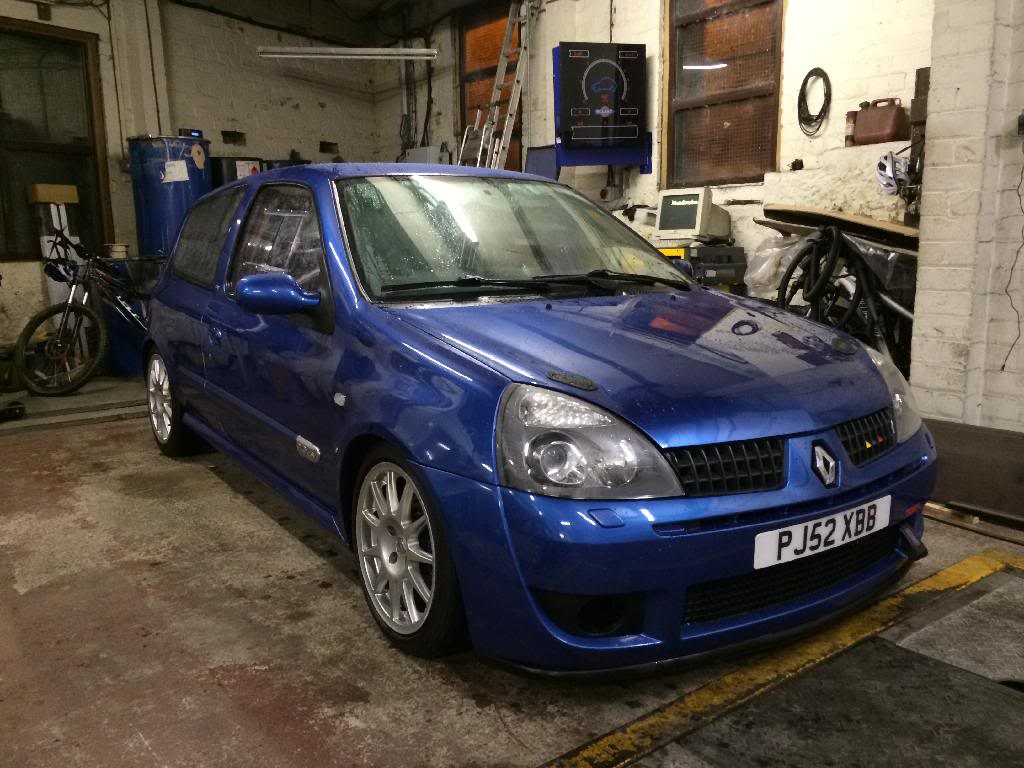

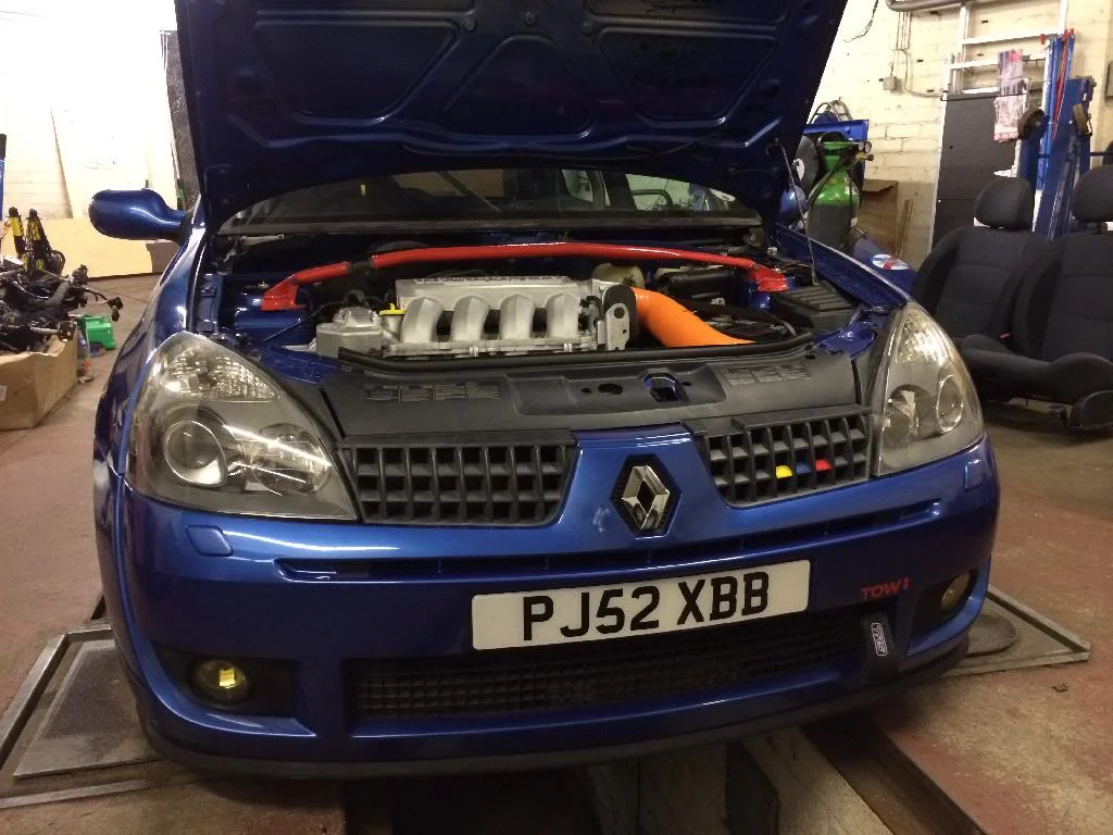

Ok, the eagle eyed of you might have noticed the other thread i started with a standard 172 which i was planning on turning into a track car, well i eventually managed to get hold of the guy with this 172 Cup which i fancied as it has a lot of track orientaded bits on it already.
Also had a recent dephaser pulley, timing belt kit and clutch. (£1000 of work!!)
Has 74k miles with full service history and a folder of receipts!
Current spec is;
Yozza exhaust & decat
K-tec air filter setup
K-tec Engine mounts
OMP strut brace
Koni coilovers (dampening adjustable)
K-tec Solid front suspension mounts
HEL braided brake lines
Brembo front discs (need replaced)
DS2500 Front pads
Toyo Proxes tyres all round
Has Trophy Speedline Turinis and upgraded xenon headlights too.
Happy its a Cup too, no air-con, climate control, ABS or traction control crap. What else differs on a Cup?
Ive said enough, quick pics once picked up
Plans are to strip it, rollcage, bucket seat, steering wheel and polycarb windows at some point. Cant wait !!

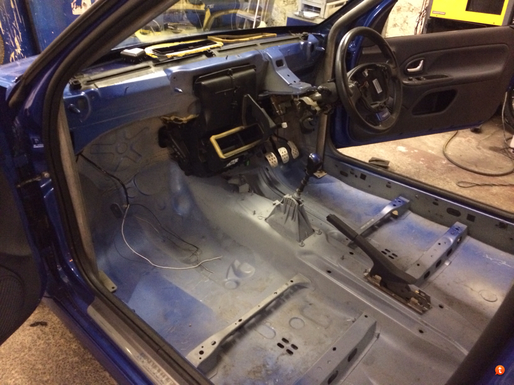

Numerous things ordered including fibreglass bucket seat, steering wheel, harness, 6 point rollcage, polycarbonate windows, isolator switch, tow straps. Still more to order but already been a very expensive week!!
Still need front discs, steering wheel boss (theyre a rip off), ABS plastic to make door cards, door handles, paint for the inside and god knows what else.

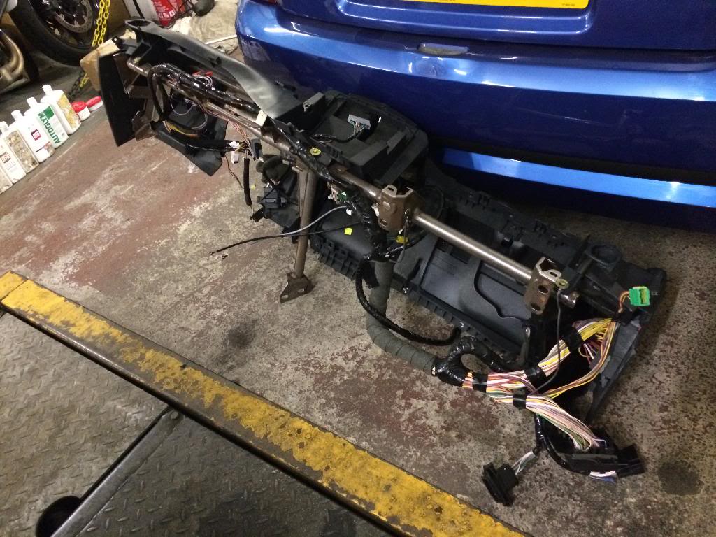

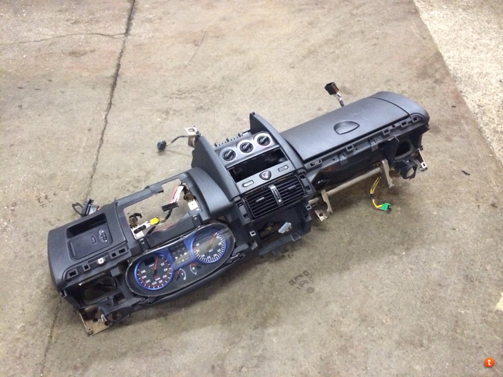

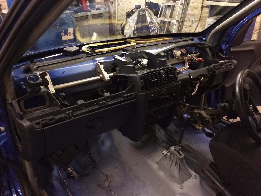

Next im going to pull the dash back to remove sound deadening and to help for fitting the cage.

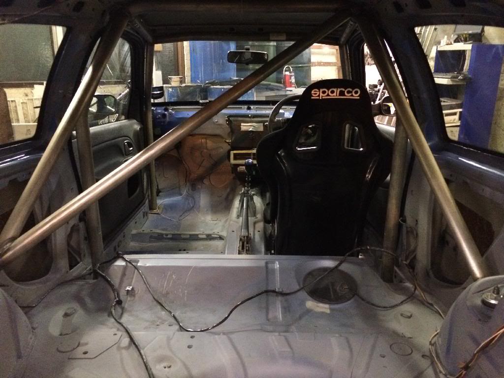

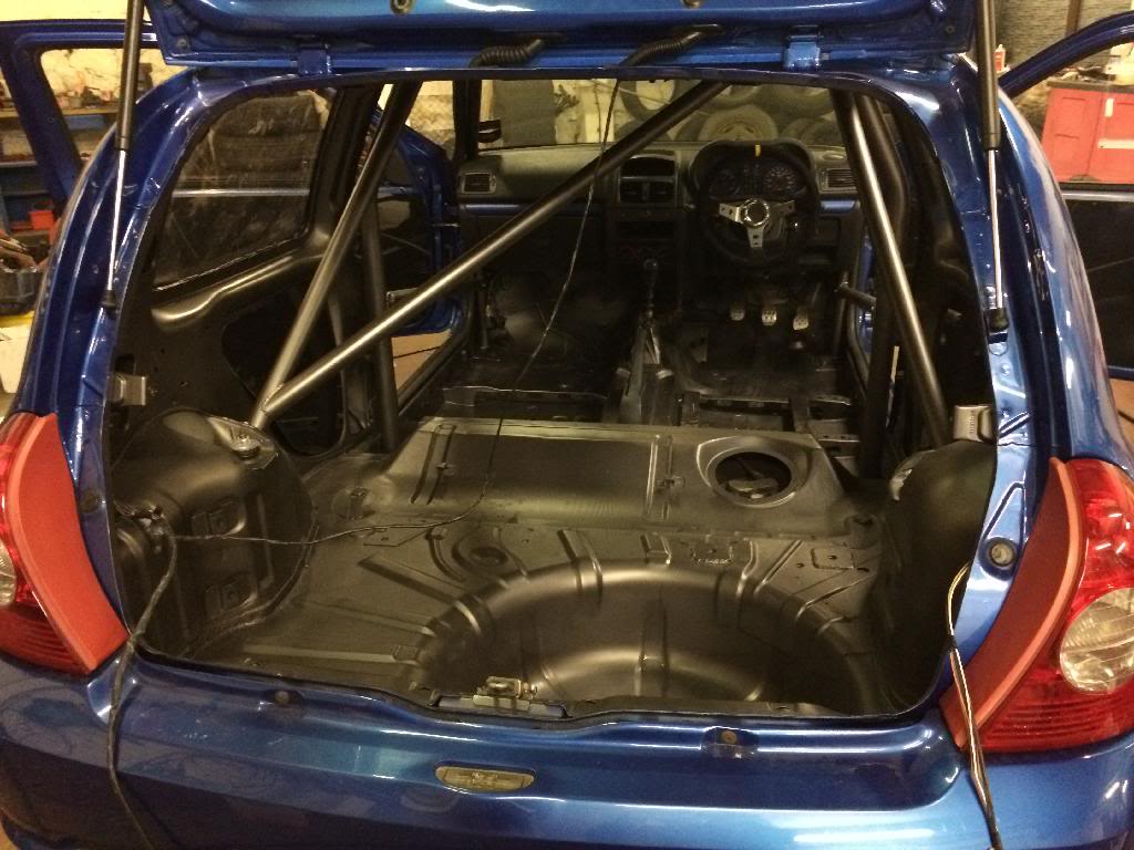

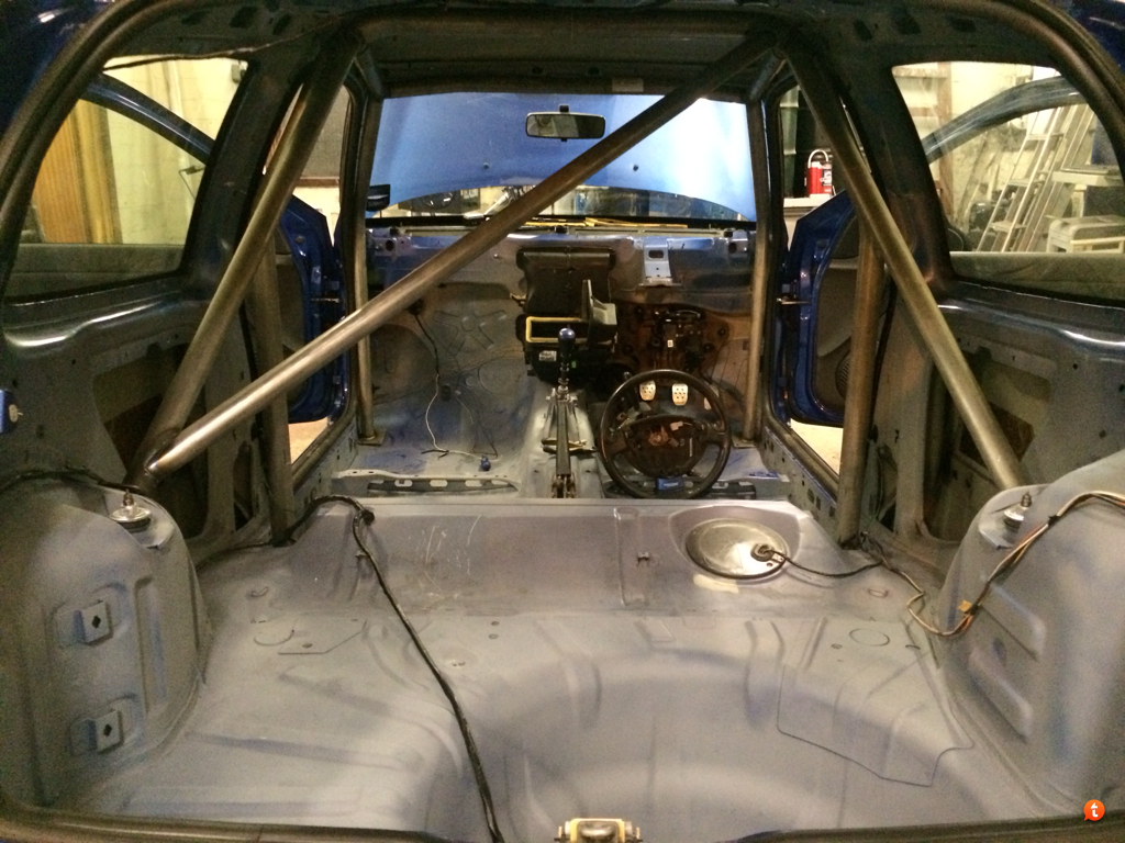

Parts arrived. This is getting more involved than i planned :O
Next stage is to weld on footplates and doorbars, then bolt it all down.
Then sort out seat mount and position.
Then paint it all, modify dash around cage and refit it.
Its not much fun this part!!!
  172 Cup (Track)

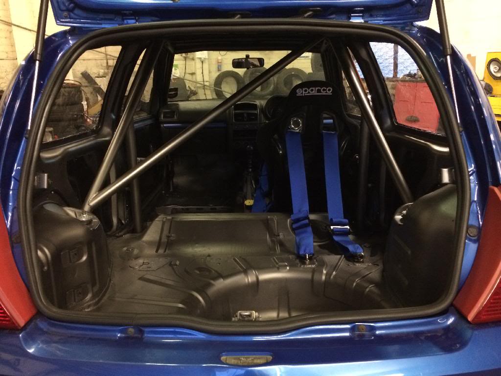

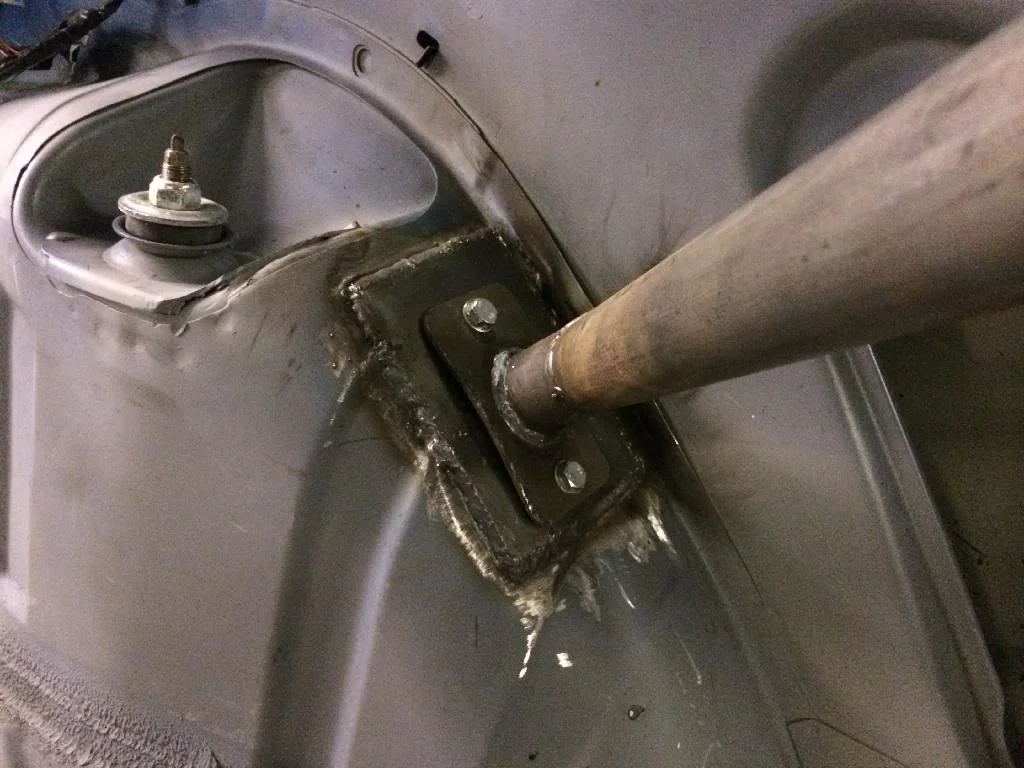

What cage is that? Seems very basic, no door/harness bars? Do you plan to add more in?
Its Sparco 6 Point, its only just in place, door bars have to be welded on where they suit.
I like the look of X bars and harness bars but i suppose its saving me weight. ;)

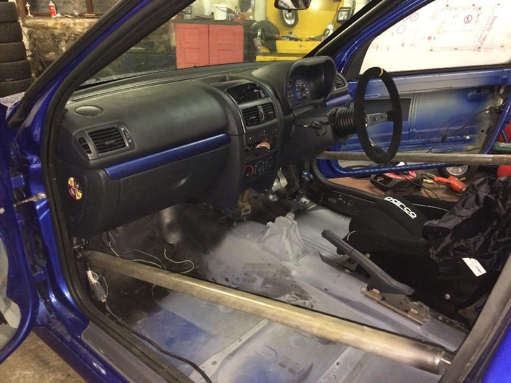

Lightened all the dash and cut to fit around the rollcage.

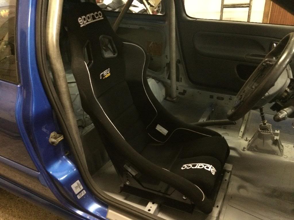

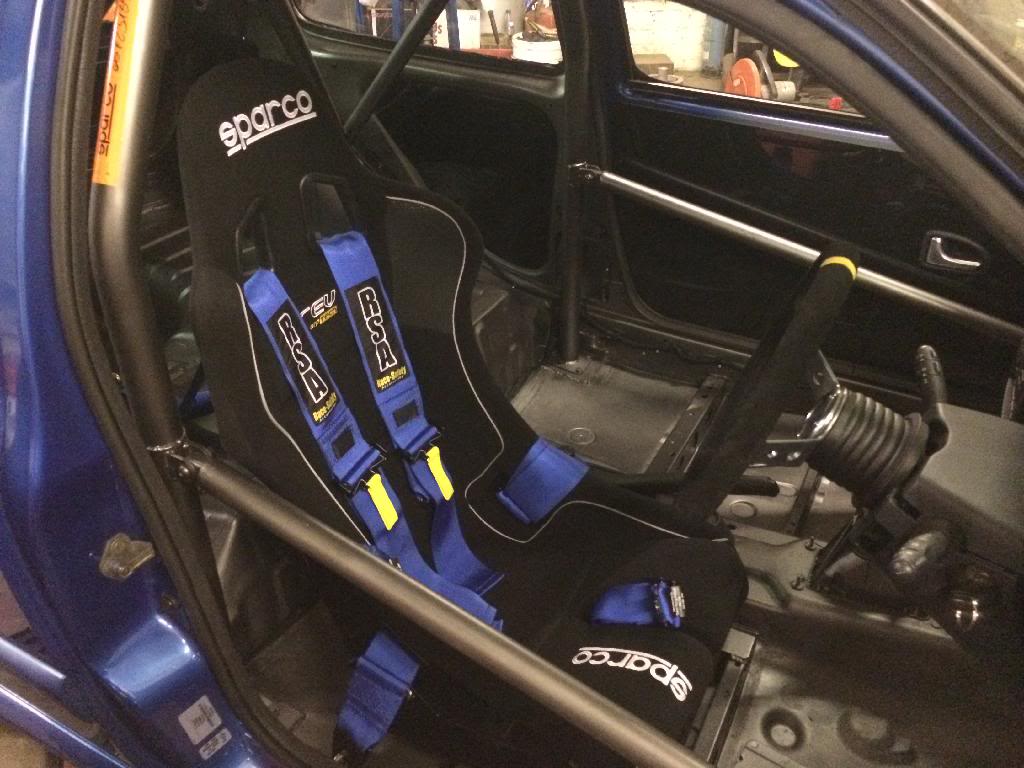

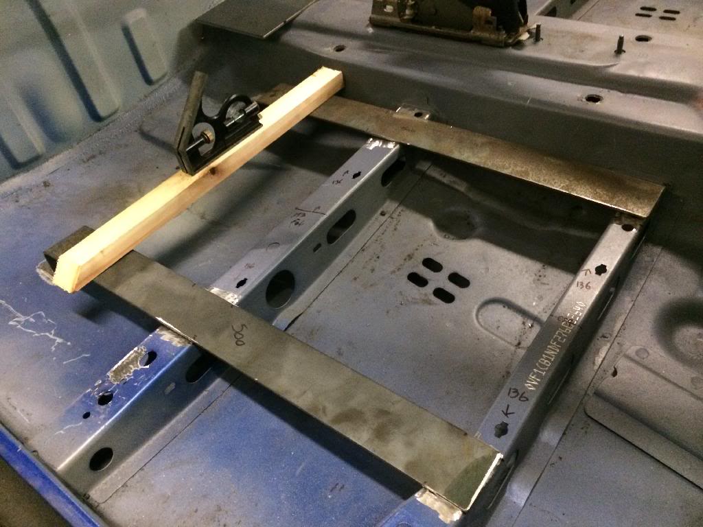

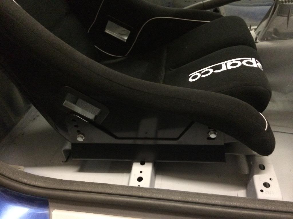

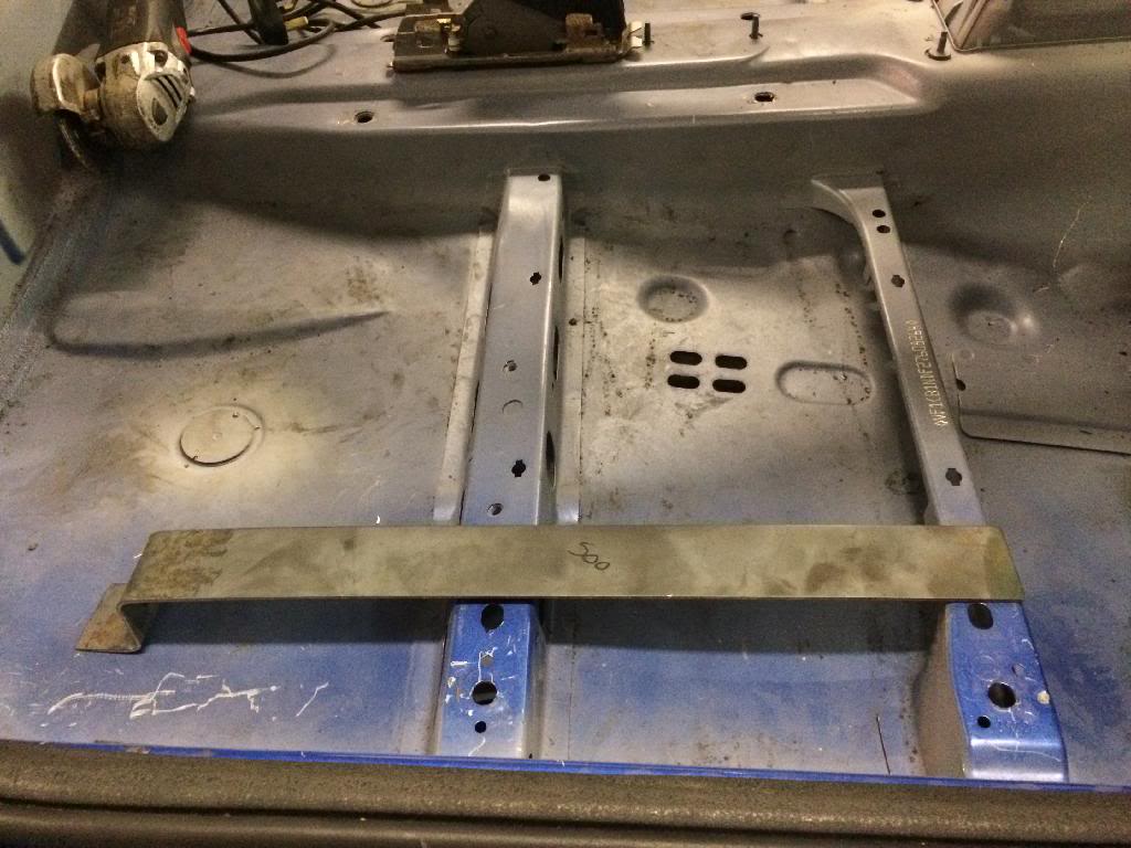

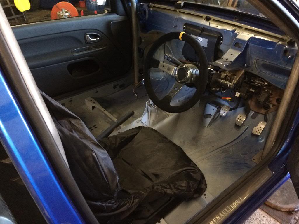

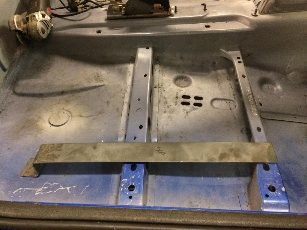

Seat bars made up, got the welder kindled up and welded in and seat fitting in place. Very happy with seating position- good height, angle and distance from pedals etc.
  172 Cup (Track)
Seat seems good, snug fit for a 32" waist so be careful what you buy.

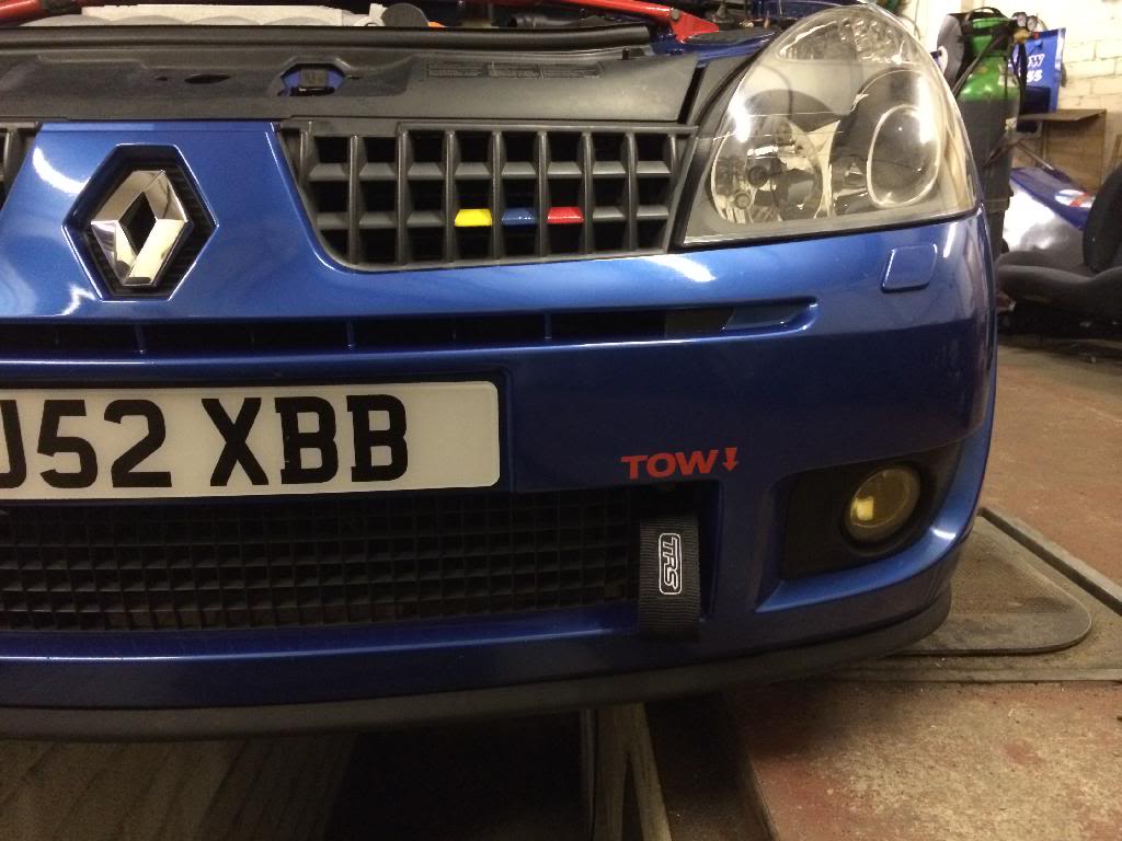

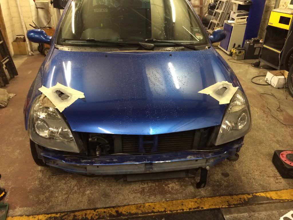

Bumper removed, tow strap fitted, bumper mod to fit strap through, re-fit with minimal fixings for quick release, fit tow sticker as per MSA
OMP steering wheel boss arrived so fitted and played with column height- dropping it an inch

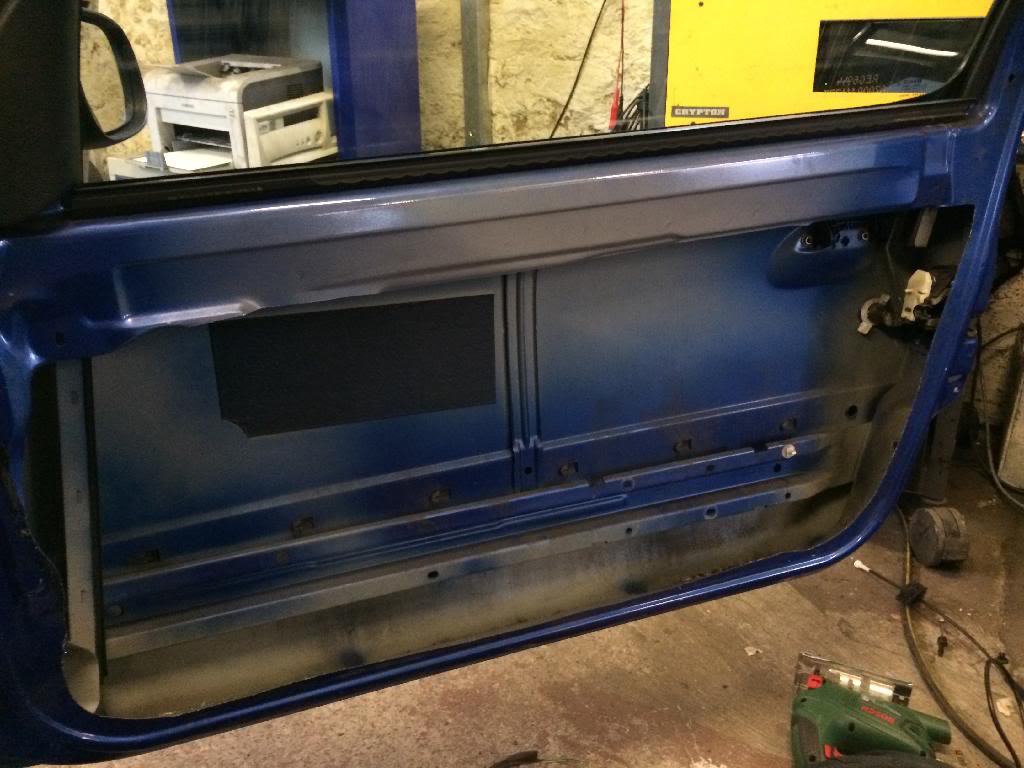

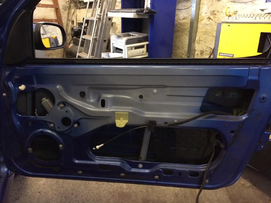

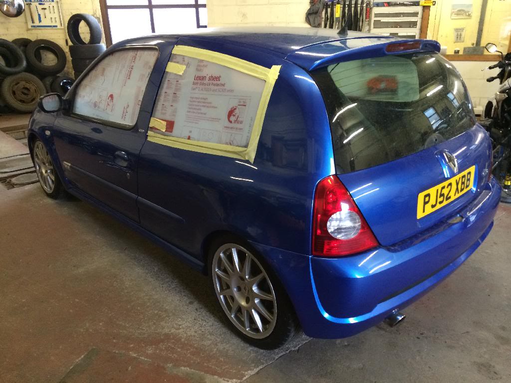

Ive now stripped doors back to next to nothing, ready for polycarbonate windows and inner trims to be made up.
Before
Door harness before
After (Im keeping central locking!)
After

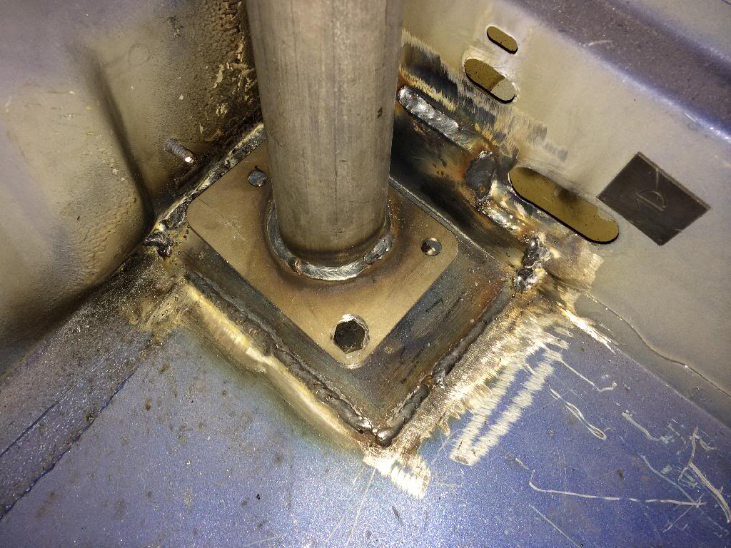

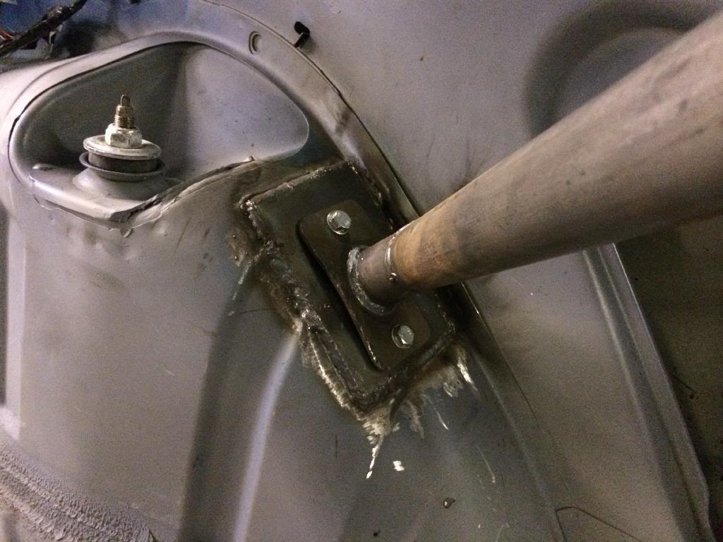

My mate builds stock cars, so can just about weld in his sleep, had him do my rollcage spreader plates as i was worried about scruitineering!
I was the fireman!

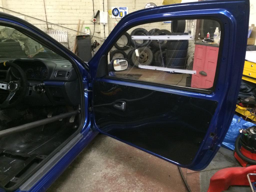

Front polycarb windows in to check fitment, not a clue what best way is to remove rear bonded ones!

Getting there Gaz, is your rear arch stay made up of two pieces of CDS?

Full cage is made of CDS, its a Sparco FIA/ MSA approved one.

I thought cages needed 3 bolts each plate, the rear of that is only 2?
Like the looks of your doors I'm going to do mine tonight I think, what are you doing for opening the doors on the inside?
Let me know how you fix your front Polycarbs, not sure how to hold them up!
  172 Cup (Track)
3 Bolts for front and main roll bar, back stays need 2. Back stays also just need a spreader half the size of mains. Yous need to read the bloody book. Lol.
Im going to re-fit standard door handle into the ABS plastic panels.
The windows are so tight in the seals that they hold themselves up, so ive just put 2 screws at the bottom into the door reinforcing bar to hold them up. Very easy!
I would be better reading a Japanese encyclopedia it would make more sense than that book, I just look at the pictures. :)

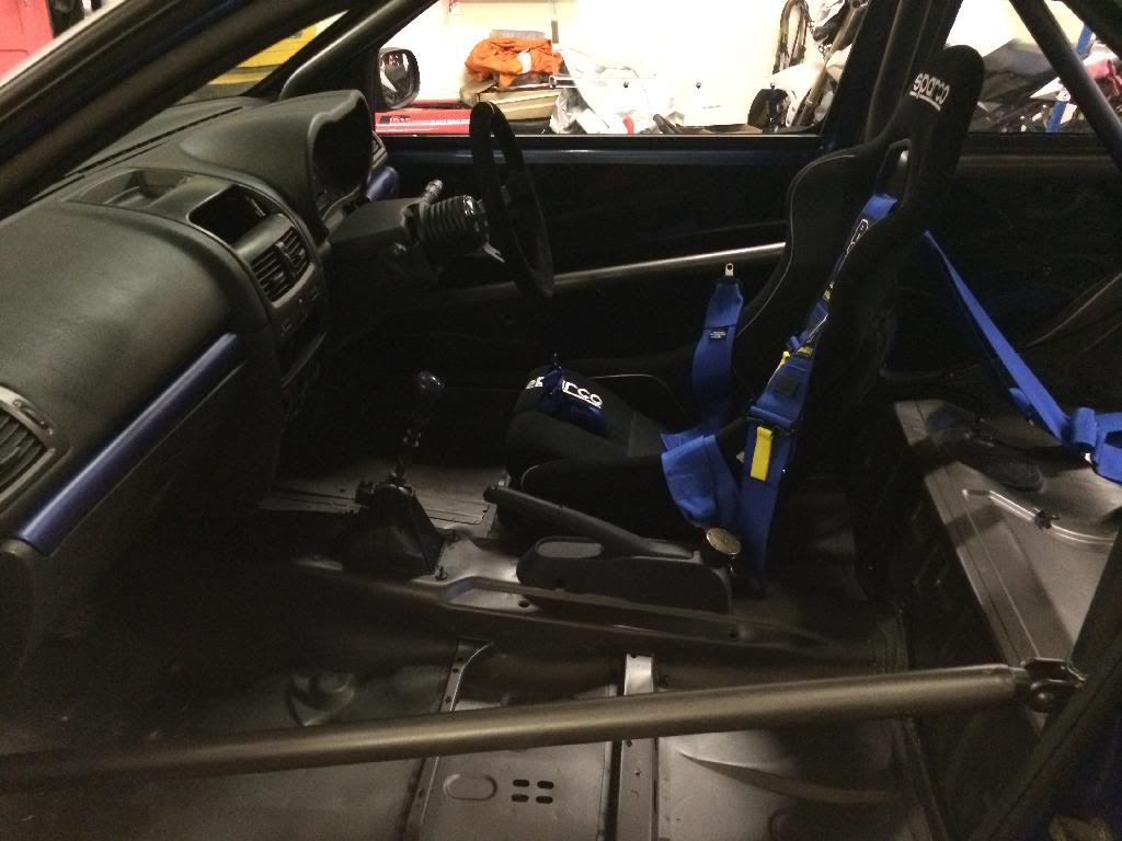

Front of car/ cage painted to get the dash back in and get it running again!
Now to get some door trims made, paint the rest and have rear windows fitted. Hopefully be done by Sat!
  172 Cup (Track)

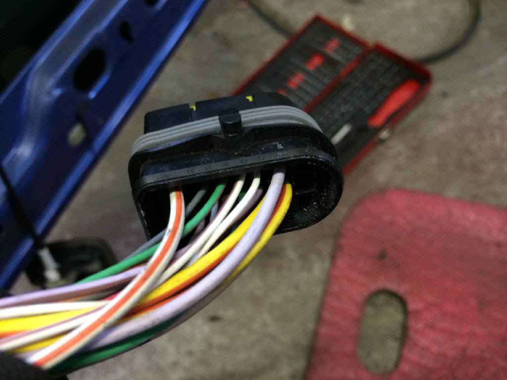

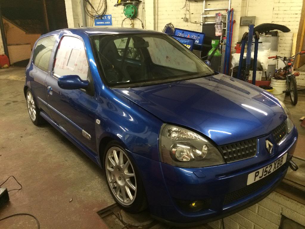

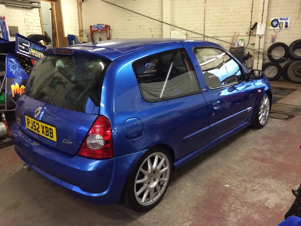

Got most of inside done last night and today, all painted, loom wrapped in loom tape and P clipped in place , doorcards made from ABS and fitted (cheers Findlay!), polycarbonate windows all fitted. just needs few finishing bits done and car needs a good wash again!
All done myself other than spreader plates and making of doorcards, very happy with it!

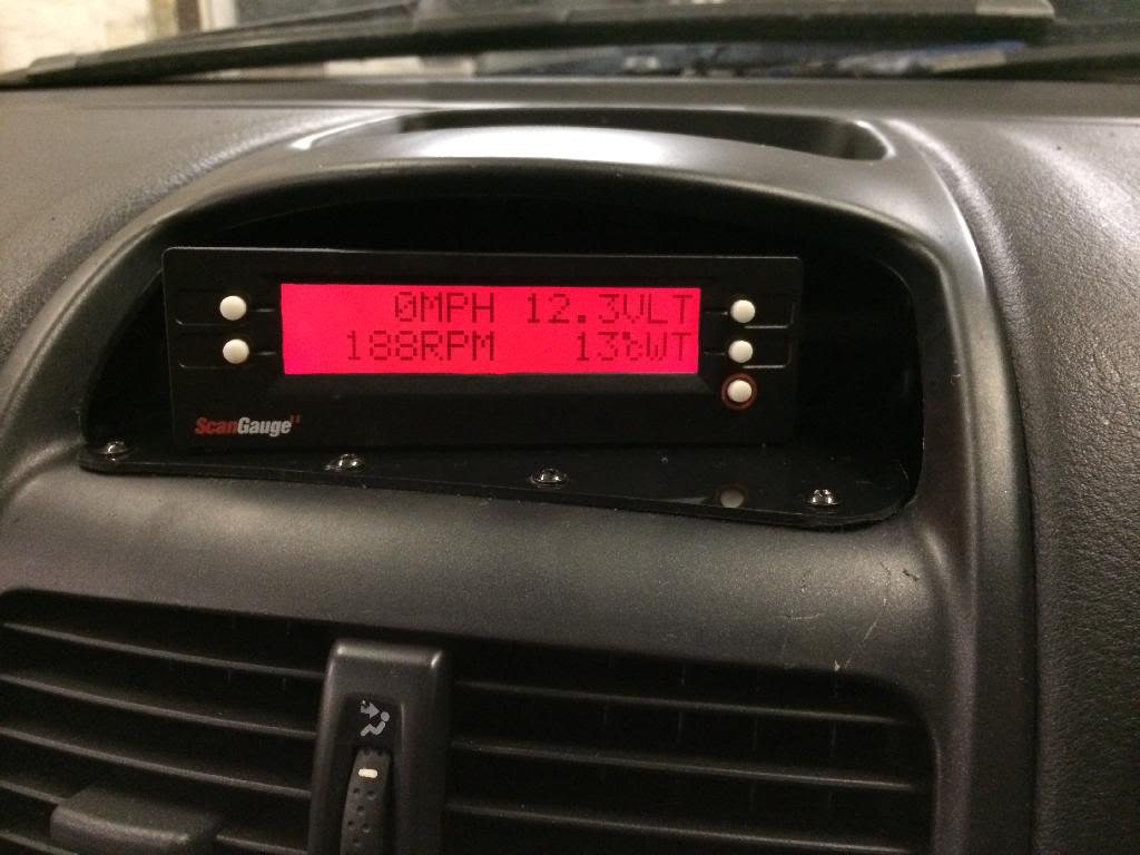

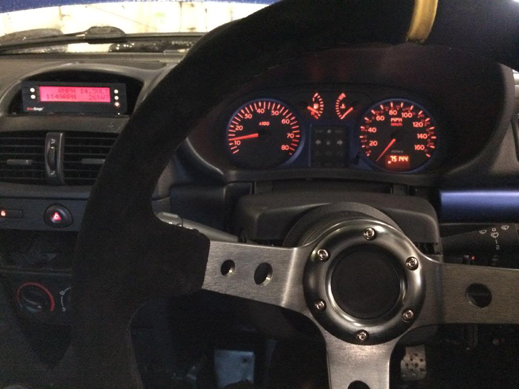

Fitted my ScangaugeII to the dash where radio info was
Fitted Aerocatches, spent ages perfecting their position so they open/ close spot on!
Removed foglights for fitting some ducting.
