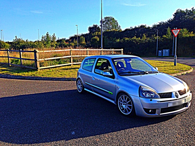

Well after many months browsing the forum I thought it was about time to join.
After speaking and reading a lot of information on here I had a budget of ~£2000. When this came up I thought that looks ideal for what we want in a clio sport.
The idea is to transform it into a track friendly car without spending silly money as past projects have usually ran over £15000 so this was more of a 'budget' project than an all out project I am used to. However saying that after driving the clio I cant really brand it as a budget more so a BARGAIN. For how much you can pick a nice 172 up for these days they really do offer a lot.
Already bought some little items which will be added to the car in the next 2 weeks just before its first outing at Oulton Park. Already fitted the front 'tow' eye which is a nice little item for £15.
Sorry about picture quality I only got back last this afternoon so have not really had chance to take some better pictures. I will the weekend though!

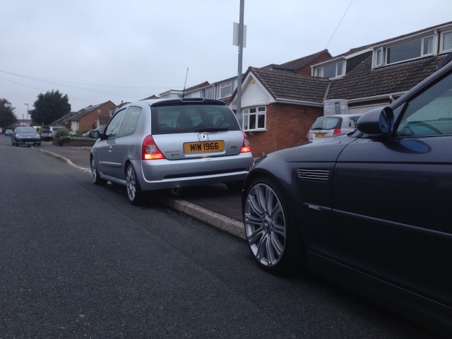

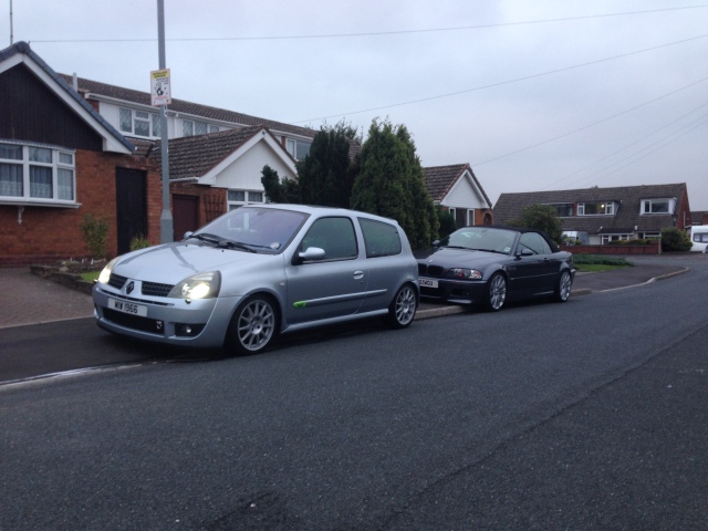

Had to re arrange the drive for them both to fit...

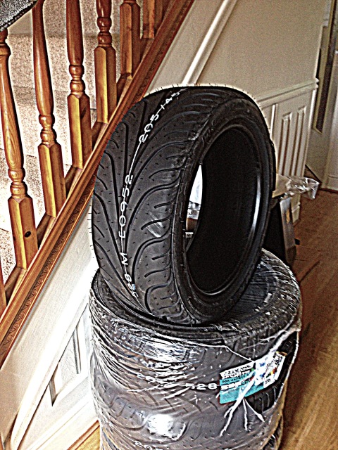

I need to get some 'track' friendly discs and pads , braided brake lines and I already bought some brake fluid as ECP had a little discount on it last week. ( I think I am going to try DS3000 pads and Brembo disc before I splash out on some Carbotech pads )
Along with that I need to fit a new front 'bottom' arm and also fit the Federal tyres I have sitting in the house. The car already has K-Tec coilovers but these will be swapped some time but for now they'll be fine while we get the other things fitted/corrected.
Any suggestions / thoughts are welcome. I'll update the thread as progress goes on...

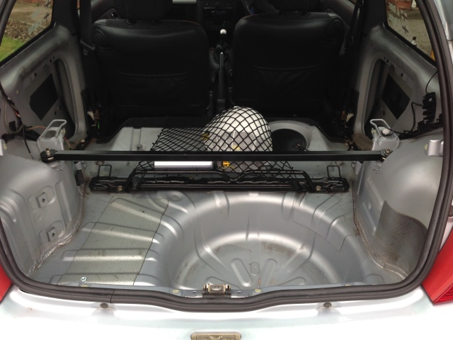

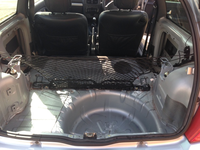

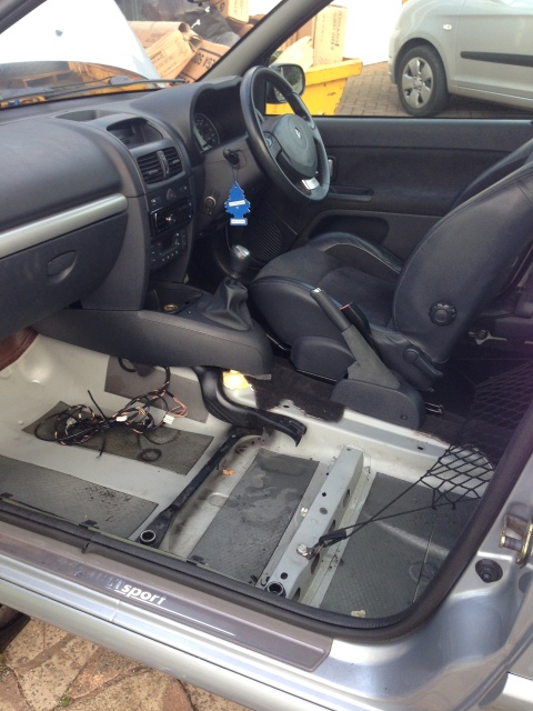

I've stripped as much out the back as I feel is right, I'm not sure why at a guess I'd say you save around 20kg but not much more. I think the weight saving could comes from the front door cards and OEM seats but until Xmas they'll be staying.
Also upon looking around under the car I've found it already benefits from braided brake lines and powerflex dogbone upgrade which was a nice little surprise.

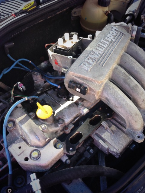

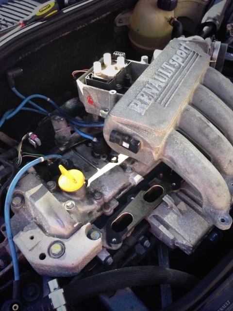

After driving it about I tend to get a rich smell of 'burning oil' so the weekend I thought I'd inspect more. After taking the inlet off I believe I have a slight leak coming from one of the rocker bolts directly underneath the inlet. I'm not confident its severe enough to cause the burning oil smell though...
I have booked it into BTM to inspect and rectify but speaking with Fred I'm not sure its a 'quick fix' :(

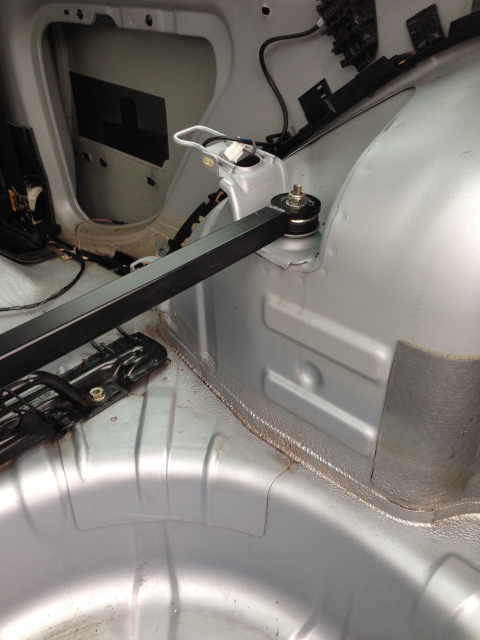

Dan @ M.A.D.
Really nice bit of engineering to be honest and a great buy for £15.00.

Well I received the car back from Fred@BTM with the cambelt complete and rocker re-sealed.

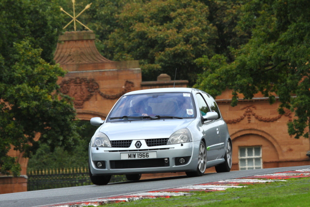

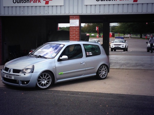

12 hours later we arrived at Oulton Park. Was our first track outing in the clio so it was more of a learning curve than anything but it seemed to be O.K. We managed to boil the brakes on the second lap which was my own fault as I just didn't have enough time to swap brake fluid. Apart from that the clio did us proud for our first outing.
Managed to destroy 2 rear Toyo T1R's and we just got home and noticed a huge consumption of oil at the bottom of the engine gathering around some sort of sensor directly below the fuel rail cover or next to the dip tube...

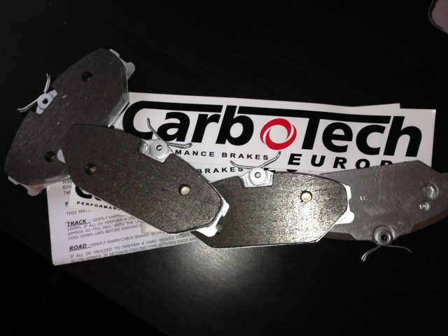

Also I've spoken with Carbotech and they are going to make me some of there XP8 range of pads. Not the cheapest but I did really enjoy the extreme stopping power they offered on previous cars.

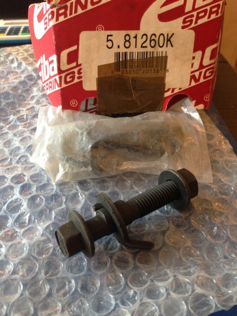

Bought these from a forum member, £15.00 it was worth a chance that we may need/use them.
Eibach camber bolts.

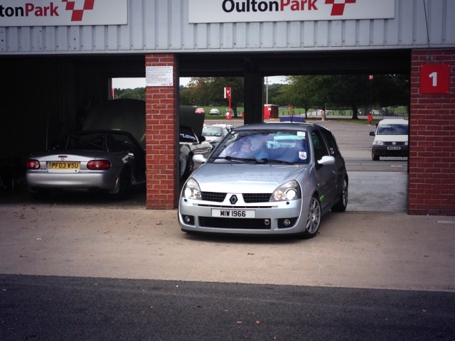

Anyway 2 pictures from Oulton Park I promised.
  Range Rover Sport
To be honest for a standard/ish car it was surprising how nimble it felt.

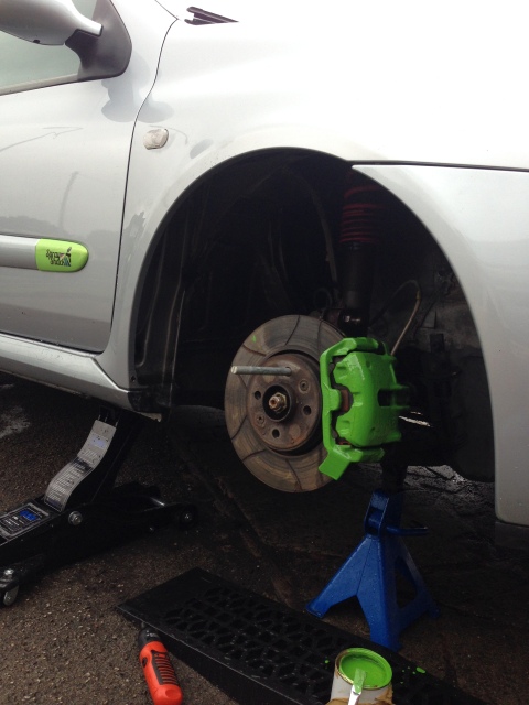

I know this'll not be to every ones taste but I really did need to incorporate some more green onto / into the car as the green 'bullet's' look out of place on there own.
Again not a hugely popular modification but for the sake of £30.00 and 1kg increase I thought "why not". In theory it's a pretty good idea however doubt there will be much if any increase / decrease in handling after having it fitted.

Just had these arrive, pretty excited to try them out. Bedding in required first though!
XP8 compound. If they are any where near as effective as they were on the Evo I'll be a happy man.

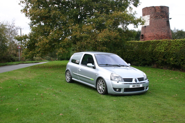

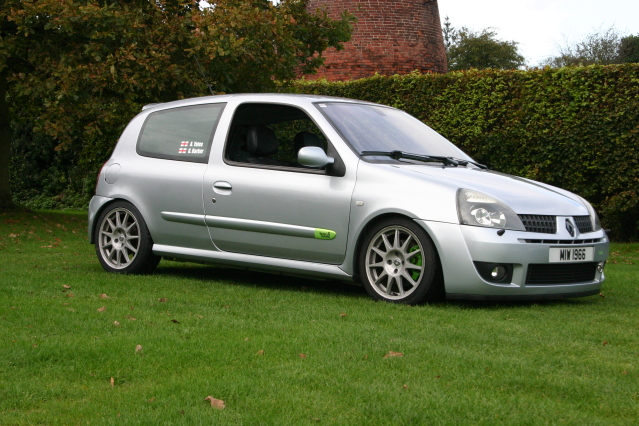

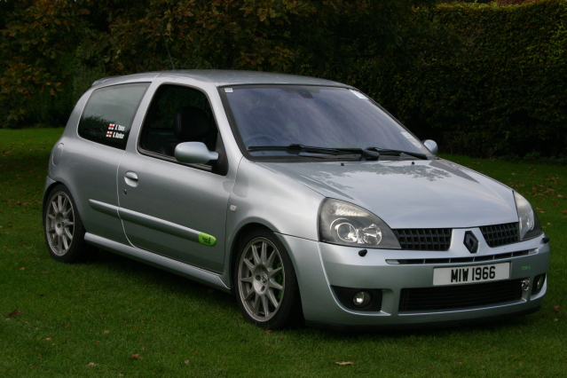

Managed to get the camera out the weekend so thought I'd take a quick snap or three of the car how she is at the moment.
Well I've wrote the idea off for attending Oulton next week. So a fair few things need doing before the end of November but with Xmas fast approaching I'm not 100% I'll get everything complete that I wanted.

well it seemed fine on my way home last night, had a hint of oversteer at 90mph allegedly ;)
car is too low (for the road), that rear strut brace makes a racket too!
  Range Rover Sport
Oversteer we can deal with, understeer is when we have a problem lol.
I know that stupid ass rear strut brace is damn noisey but I like the 'theory' behind it even though I'm pretty confident it does nothing but add weight to the car.
