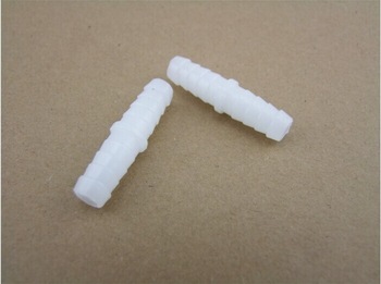

Just buy one of those plastic joiners, cut pipes and join them together.

I didn't even think about that you have just saved me lots and pain and money :) thank you very much
Do you know what size i will need ?

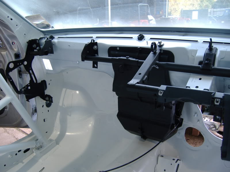

Well I wanted a clean look inside instead of looking at that plastic box as well I am only running the top of the dash as well. I have been looking at heated front screen to replace it to get around the misting front screen problem and have a roof scoop for air flow inside

Do you still run your full dash ? Because that's why I want to get rid of it so it doesn't look messy in the car

The cage I am running means I don't think I can run the dash bar which makes fitting the bottom of it very hard. I just want it to look smart especially when it's painted

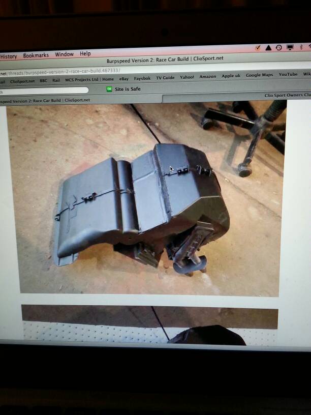

I cut all the sh1tty bits off the heater, then stuck a piece of black plastic across the front of it. It only goes up to the screen, and nothing to the footwell. Much tidier.

That sounds good mate I don't suppose you have any pictures of it do you ?
  182cup & 172 racecar
Might be in the build thread somewhere. I know it involved a dremmel, and a lot of mess. But the heater box is much slimmer now,esp without all the footwell stuff on it.

Just cut into it, then you can see what you don't want. Cut it all back, and I think it was a biscuit box lid, siliconed on and sprayed black. Job don.

That's doesn't seem too bad to be fair it looks smart

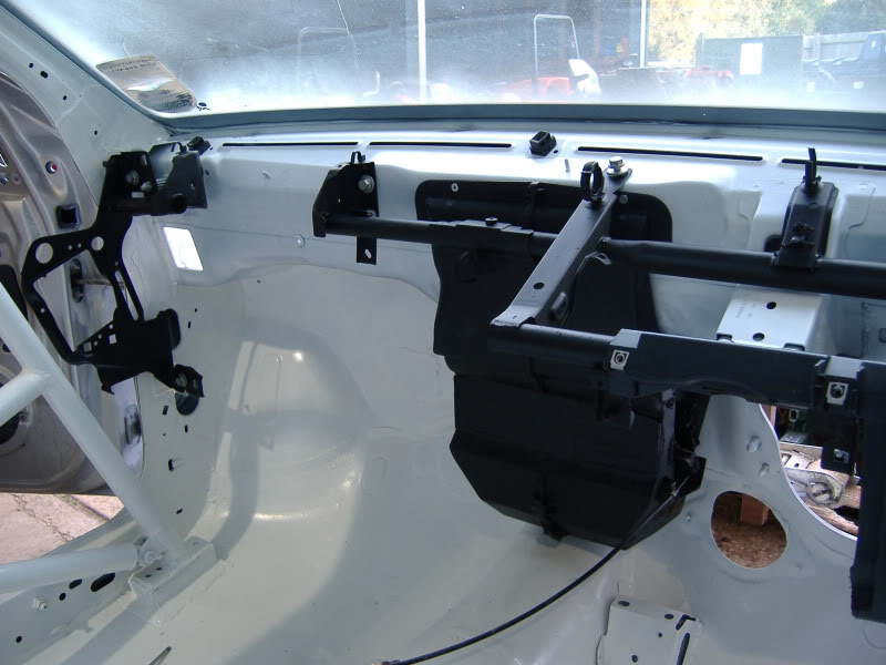

Just looking at your fire wall (changing the conversation completely) have you scraped all the glue sealer stuff off ?
  Clio 172 Merc ML55
If I remember rightly the front ones are held down with some plastic nuts on studs in the bulkhead/firewall, all the rears are glued and as you said just heat them up and scrape off, I found a hairdryer was enough to warm up the glue, it is a messy job though and normally ends up with a lot of residue that needs removing afterwards

Thats cool thank you very much i have got all the brown stuff out its just this waxy glue stuff. Have you taken it out the rear as well or is that a bad idea ?
