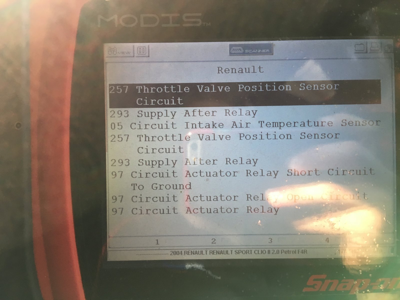

hi had the engine and gear box removed after putting all back the Clio ran for about half an hour turned of them went back to start and wouldn't start check codes and have found these any ideas on problems. I am pretty sure all earths are all put back right have triple checked.
Fault codes with snap on scan tool are 97 circuit actuator relay short circuit to ground and open circuit

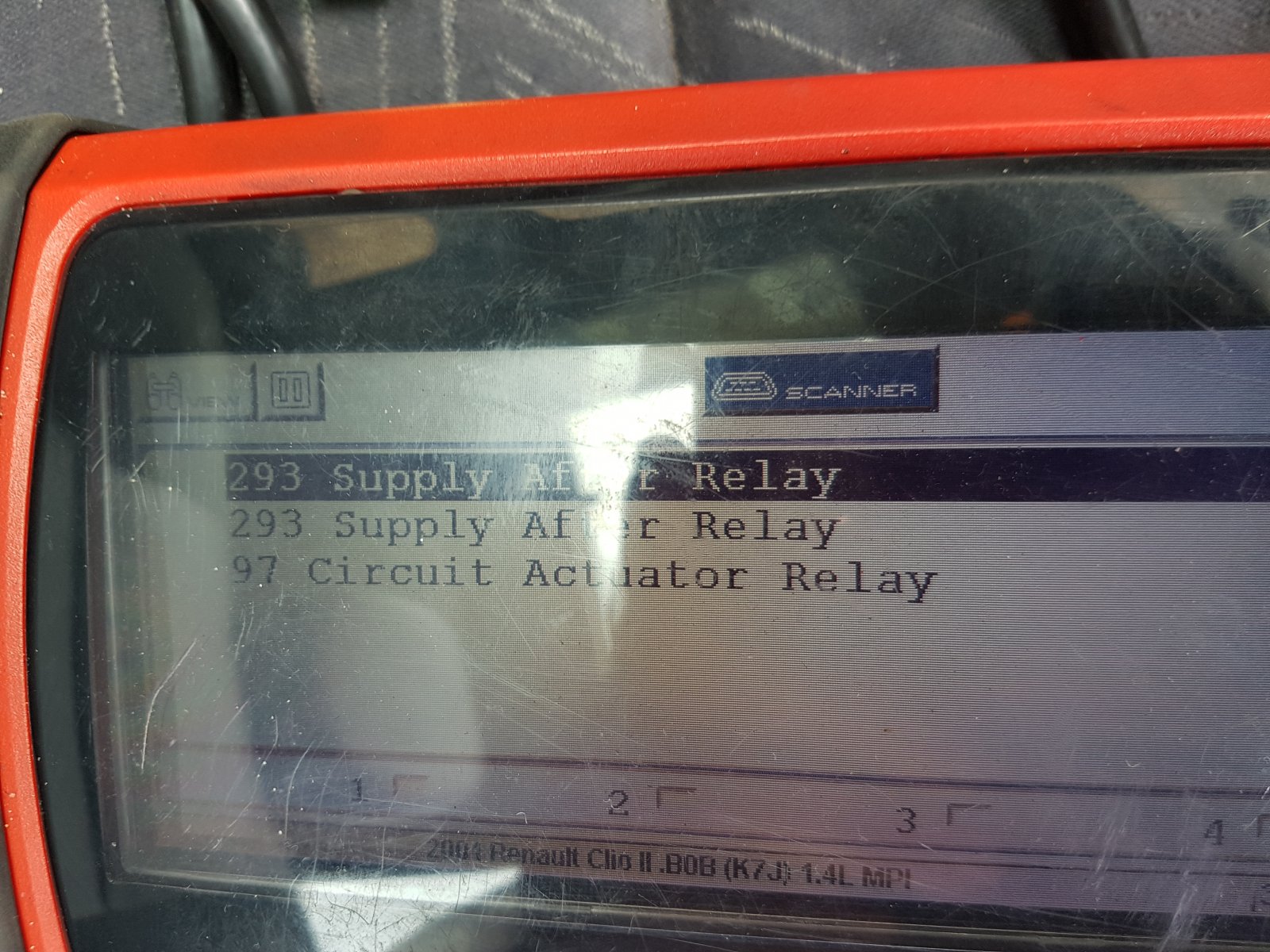

i have the same after engine and box out at the weekend :( shreed dog bone bolt, same fualts but on a 1.4 16v.. only i have 2 x 293 1 x97..... i have check the relays mick what should i do next mate?
