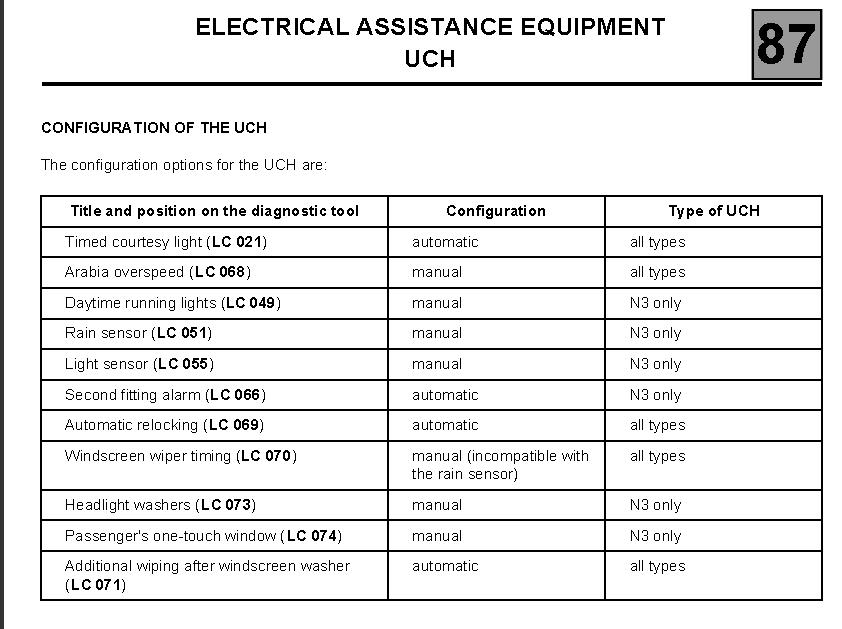

Thanks mate. Yeah I've read about this in the workshop manuals, some functions are automatic, some have to be manually configured. Some of the functions are N3 only, including 'autolights' and 'rain sensitive wiping'. So I'll definitely want the N3 UCH if I'm to fit these bits. However as far as I can see so far, the climate control is not controlled by the UCH. It has a live feed from the UCH and that's about it. I'm tempted to try and get this working on the existing UCH if possible then post up a guide to show cup owners what they need and how to fit the climate control.

Quoted from the Clio workshop manual:
"The UCH is located behind the dashboard on the left
hand side.
This computer contains most of the electronic units,
including the engine immobiliser decoder.
There are four UCH models, depending on the level of
equipment installed in the vehicle:​
a bottom of the range (N2) version,
a top of the range (N3) version,
a specific version for the F9Q bottom of the range
(N2)
engine.
a specific version for the F9Q top of the range (N3)
engine.​
NOTE
: the top of the range UCH may be fitted in place
of the bottom of the range UCH."
Doesn't necessarily state that it will function as a top of the range UCH though! :S
