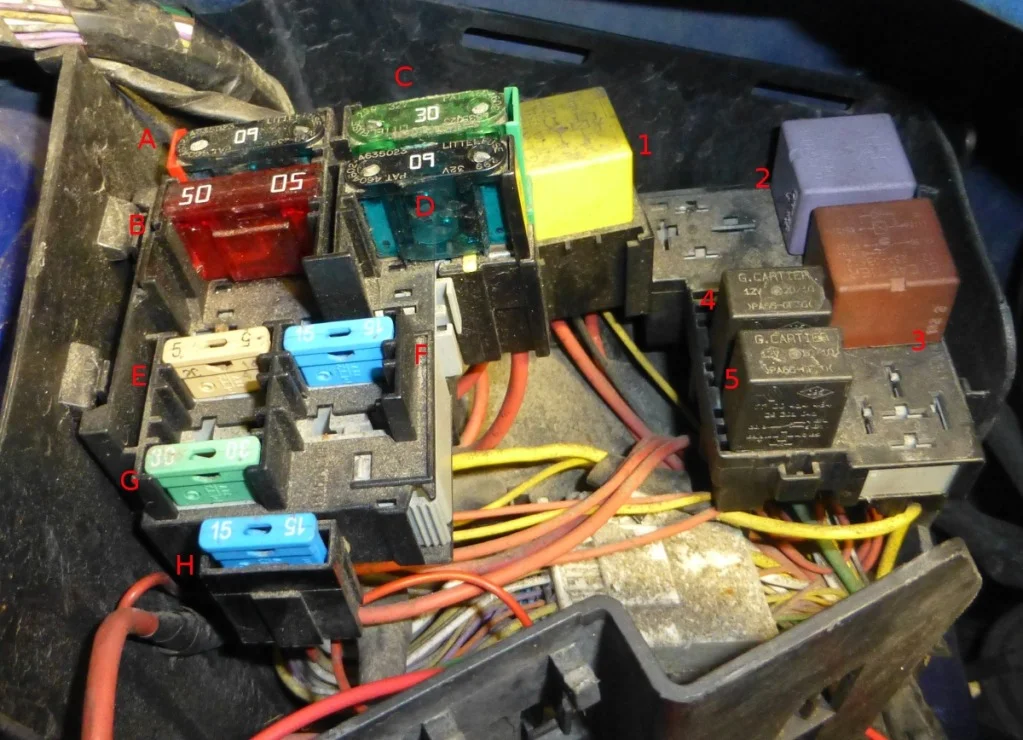

Can any one help with identifying a fuse for me ..? its the Green 30 amp one marked 'G' on this image ..keep blowing every time ignition on?
Have found if I unplug ECU it doesn't blow..tried new ECU pops fuse every time ignition is on position 2 (dash on) not when turn to start?
thanks

That's the main power feed for the sensors and EM. Check your H02 sensor wiring as I bet it's touching the exhaust.

HO2 = Heated Oxygen Sensor
Darn Electrics - That's the Knock sensor and unlikely to be the short to Positive. Have you checked the U/S H02 wiring loom as this is the most common place for the 30A fuse blowing to be resolved as people don't restrain the loom correctly and it touches the exhaust, melting the wiring until the +12v bangs to the exhaust grounding the live.

Wire to Lambda sensor wire (if it is the green protective shroud to sensor just behind flex on downpipe ?) is fine well away from everything held on a clip all ok...?
