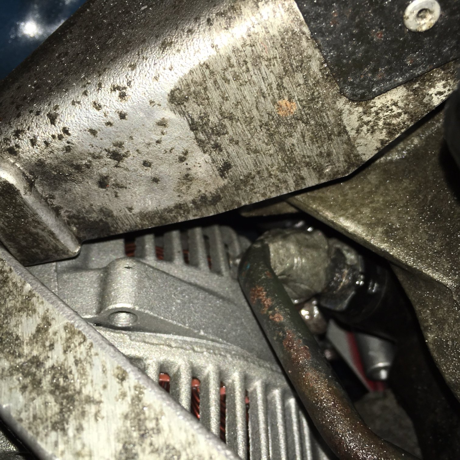

TBF the power steering fluid leak was more towards the alternator side but it was all over the engine bay when it let go.
At the connection above, although this pic is taken after I put a load of liquid metal around it.

I would recommend swapping that PS pipe... From the picture it looks like the low pressure one but still wouldn't like to rely on liquid metal mate.
If it's just when pulling away maybe the cables knackered and not releasing properly or the different unmatched clutch bearing is causing the issue, but why did the Valeo one break is also the question.

Sorry the old picture to show where the leak was coming from, I've since gone EPAS. The liquid metal was a temporary fix to get me from Cadwell Park to home (Essex)! The Valeo item was snapped when it arrived in the post, and due to needing the car for Cadwell I quickly got one from GSF.
