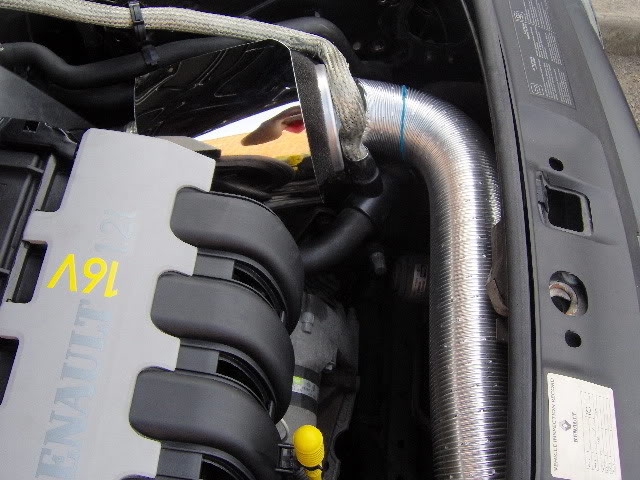

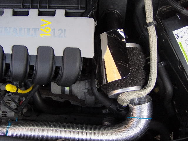

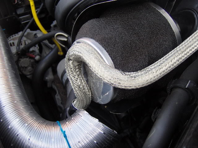

when i got mine fitted at r-tec, they removed the cold air feed aswell.
so today i fitted a heat shield and intake pipe, cost £23 including jubilee clip.
took 10 mins and looks pretty good too. heres some pics.

Thats a neat job mate - I like it alot!!

the car seems move responsive now, she really likes the nice cold air,
gonna get a smaller pipe from the n/s as i couldnt fit the bigger pipe through
the gaps.
