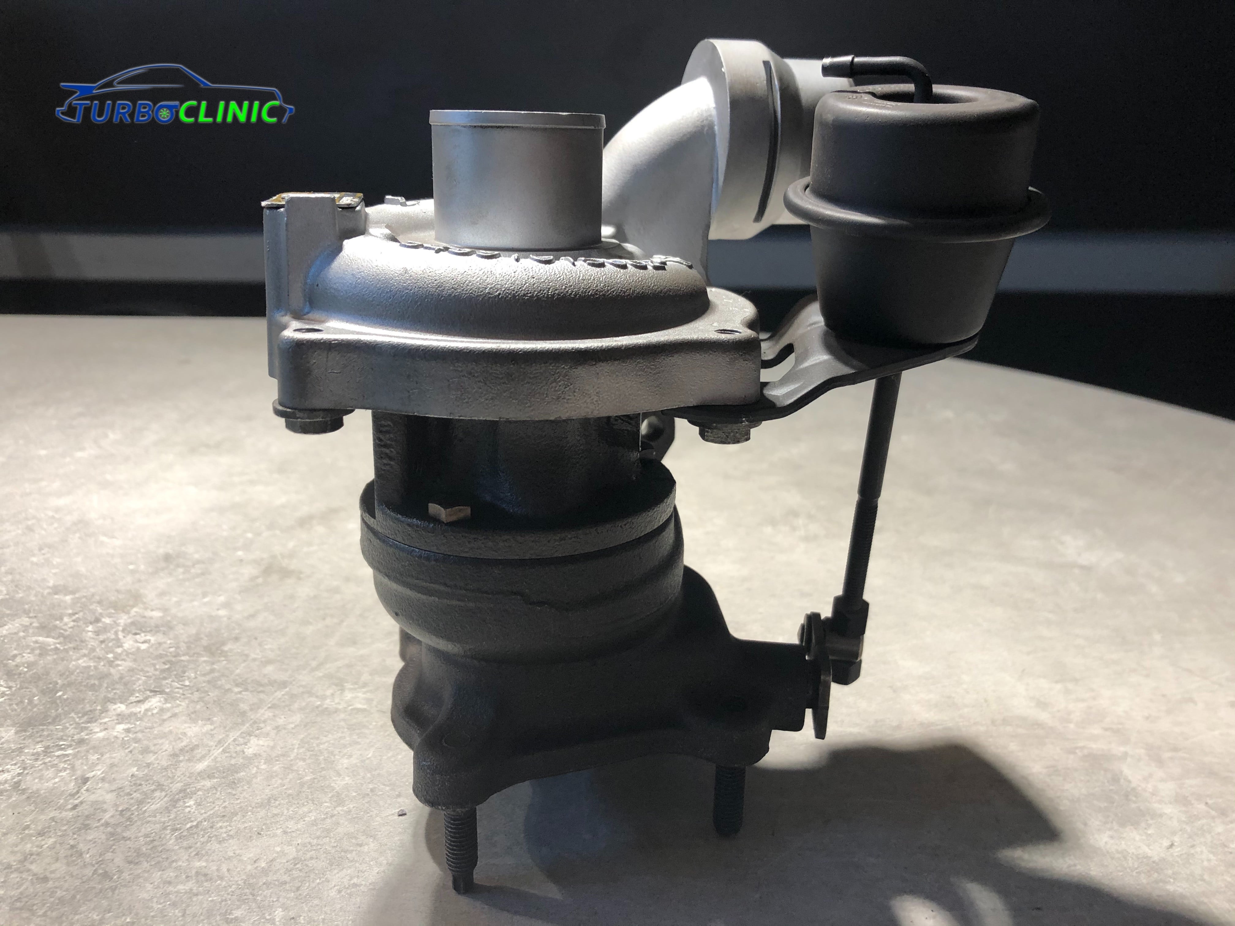

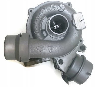

Hello I`ve got dacia 1.5dci 85PS ( remapped to 103PS stage1 ) with delphi dcm1.2. I ve got kp35 FGT turbo ( with wastegate 54359700029 )
that is with vacuum electronic valve to actuator ( euro4). To stage 2 i need more air ( pressured of course ), so I was thinking of installing turbo with VNT from 103/106PS 1.5dci ( from megane/scenic2 and clio). Is that possible to install it ? 54399880070
As far as electronic vacuum valve - they both use same valve
I need to know if it `s possible to remap it by tuner ? I know my high pressure pump and injectors are capable to give 130PS.
Thank you all for replies.

I managed to remap and setup VNT bv39 turbo on delphi dcm1.2 (86hp stock).
I also added MAP sensor 3kPa from 1.5 106HP megane3/qashqai . No problem with that.
I wonder how much torque and air boost can we safely put in stock k9k engine( 86hp stock) ? and how much safely bv39 turbo can handle ?
I wonder also about jr5 gearbox : they survive annything more than 300Nm ?
