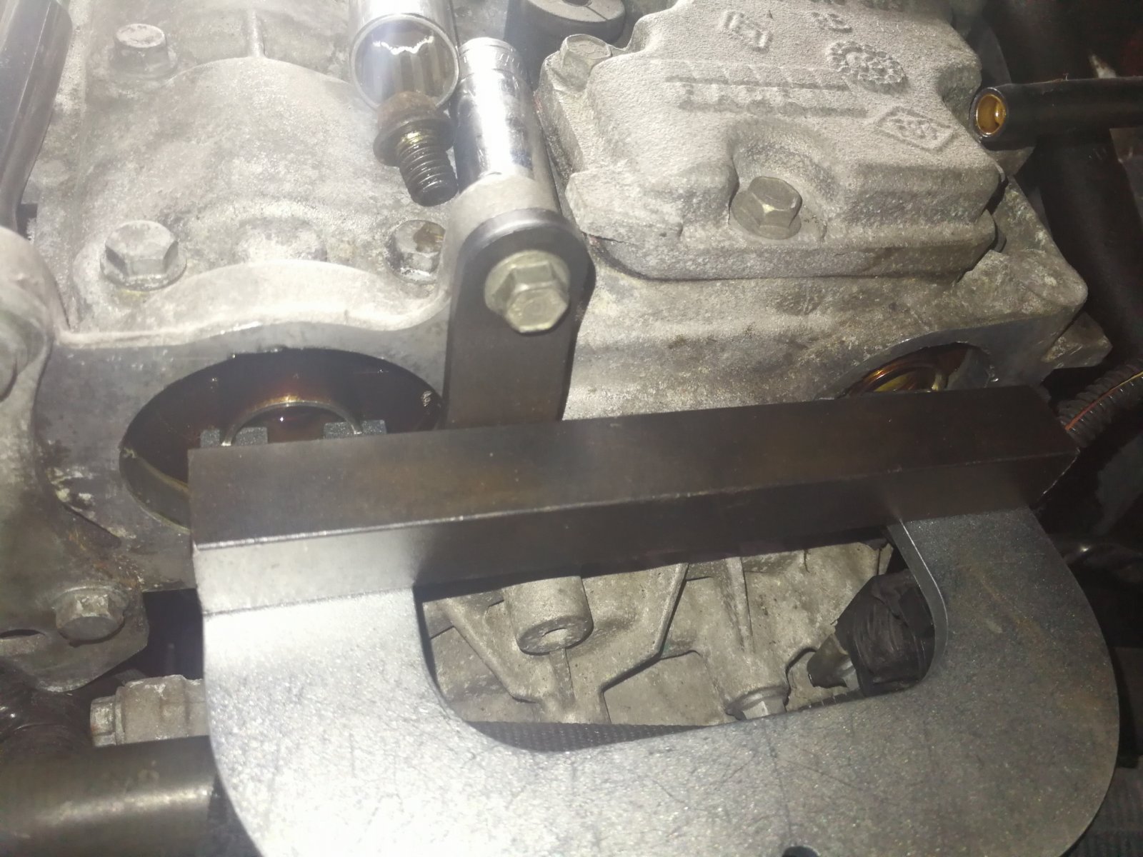

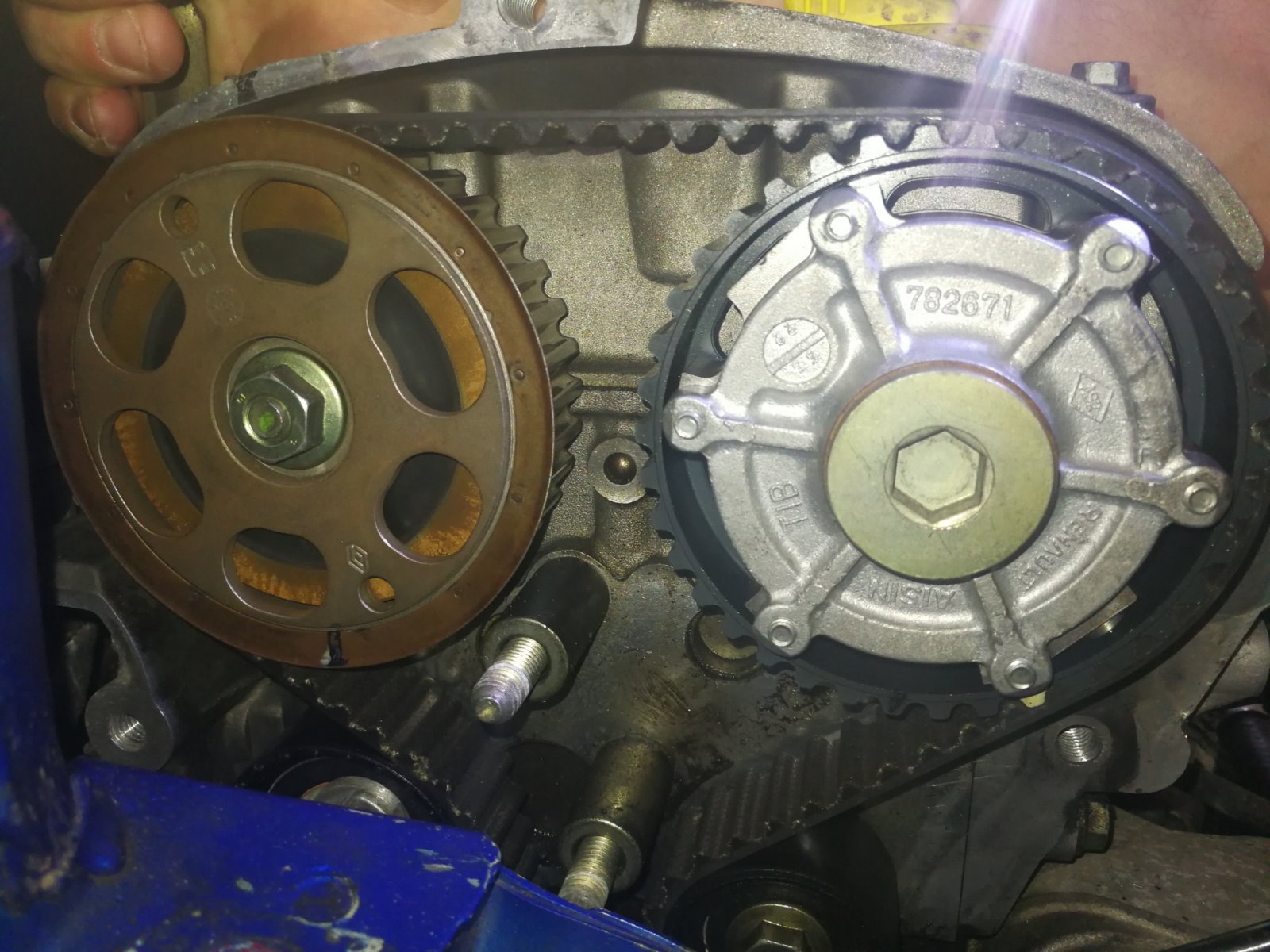

Been trying to diagnose my friend's 182 that has a very sluggish acceleration. Feels like it accelerates to about 3k rpm then begins to feel sluggish after that. Codes checked and nothing came up. Its in the garage anyway so we've had everything off. We decided to look at the timing whilst we were at it, put the pin in the front of the engine into the crank TDC and had a look at the cam slots. They seem pretty much in line and the cam tool goes in fine, both slots are below the line on the head. However, I saw mentioned somewhere about the dephaser needing to be point at 12 oclock and it seems as though, when the locking tools are on, the dephaser points 45 degrees to the left (image below). Also there are some paint lines on the cams that seem 180 degrees out for some reason (unless we have got the cams upside down?)
Could this be the cause of the sluggish feeling? And if so, could someone please tell me what is required to line the dephasher back up to the correct location? We are scratching are heads trying to figure out what is probably a simple solution. Also, could somebody explain what the dephaser actually does? and how it works as we have no idea, couldn't find an answer anywhere.
