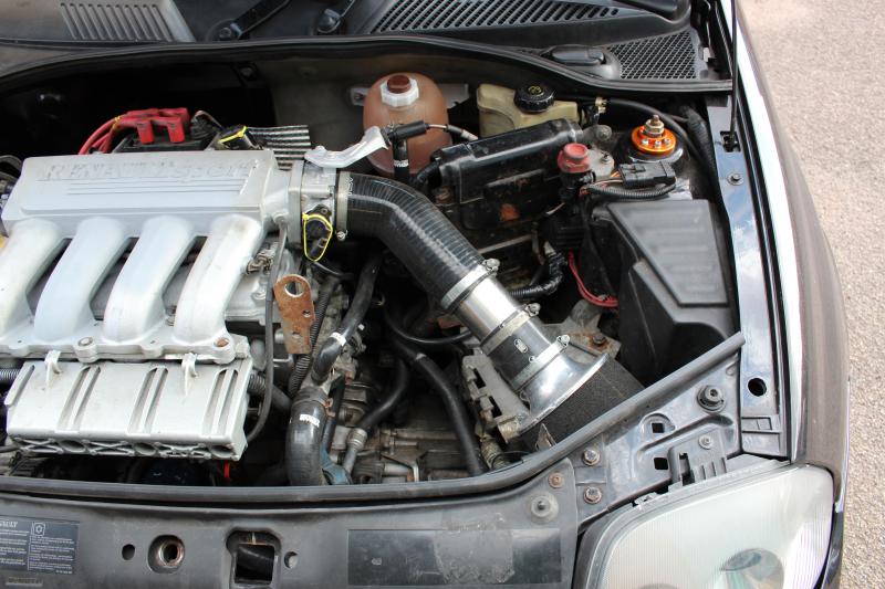

I dont think it is getting hot, when ive run it and watched it spike Id imagine the coolant to be bubbling and boiling but its not.
Ive changed the coolant sensor and thermostat already.

Use a brand new coolant sensor, its cheap.

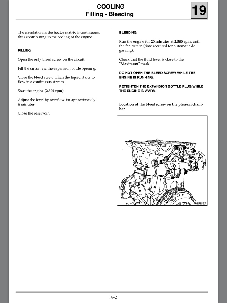

Correct. Maybe worth bleeding the system....
Re: dmallett's indecisive clio thread! Monaco ph2 pg1+, Titanium ph1 pg31+, PB ph1 pg
I rebled it when changing the thermostat, then when changing the coolant hoses and radiator (polo rad and we know that keeps it cool enough as it worked on my 421'd car amd your supercharged slut lol) Oh and the reason for the standard rad going it was leaking!
Not saying I bled it word by word to how that says, but I did it the same way Ive always done it lol.
Think tomorrow after work im just going to run it with a hose in the expansion tank and see if any s**t comes out. Maybe its got a build up of s**t or something somehow?

Get it running and warm and squeeze the s**t out of the top big hose!

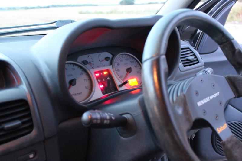

Starting issue- Changed decoder ring as I found one in the garage after ordering a spare, no difference. Imoboliser light flashing at fast rate and wont let car start, this happening ever other time I try to use the car.
I did read that someone has the same issue with crank sensor, now I know all signs are pointing towards imobiliser but I think I might change it anyway as I have several and its just another thing tried.
Think im going to bite the bullet and have it put on clip.
Getting hot issue - Rebled the system as DannyR suggested so will keep an eye on it and see if it has helped.

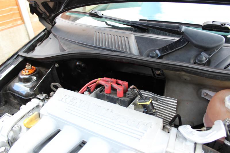

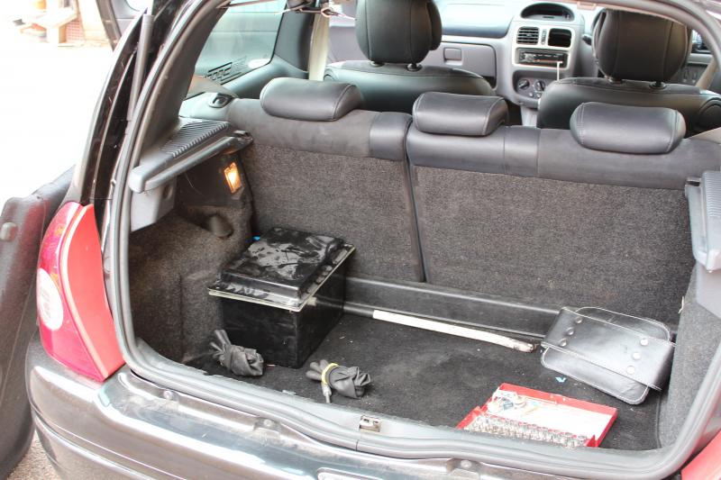

Then using parts I had from previous clio I moved the battery into the boot, purely for something to do.

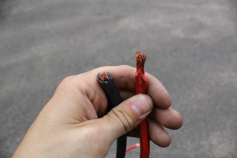

I upgraded the wire on what I previously used. (these are off cuts that i stripped back, Im not that careless/messy!) The wire certainly helps it start better.

Not as dirty as the coolant, the bottle is clean but it seems to be pushing some dirty s**t about in there. Unsure where its coming from :S

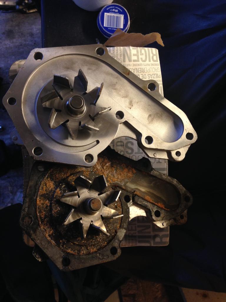

Cocked that up, don't think I cleaned the old gasket off completely & it leaked.
Before CSS,
re-fit water pump & another new gasket
fill with fuel
& if I get time wash 6/7 weeks of dirt of it.

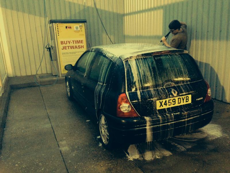

So last Friday night I re-fitted the water pump, actually a really easy job on a ph1 with out aircon! In the process I managed to knock off the break resivoir so after fighting with that I ended up washing my car with the help of @hiben1 in the dark basically.
And with that the next morning we headed to CSS.
Needless to say the car was still filthy and I missed an entire door when washing it, luckily just outside the location of CSS was a car wash.
Then tonight @Alex W was supposed to be coming round to re-program a key and try help me find out why my car still likes to say its hot, see this thread for more details http://www.cliosport.net/forum/showthread.php?755446-Temperature-gauge-rapidly-changing

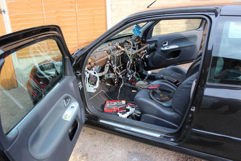

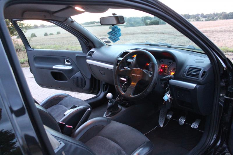

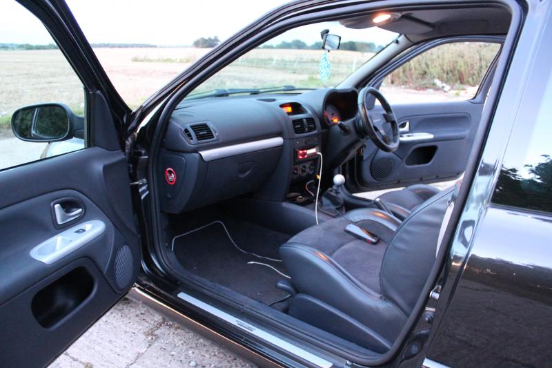

Anyway Alex got caught up at work and as I had set aside the night for car stuff I decided to swap the dash for the ph2 one.
No sweat
& done
Still to do,
Wire in Hazard switch
Wire in door lock button
Make the cup holder bit fit (air bag ecu in way)
Swap clocks back to proper ones (running a set on 91k from an old car to check the clocks work, they do!)
Program Key
Turn air bag light off (dash air bag removed)
Fit ph2 A-pillar trims, they are different it seems and I have thrown my ph2 set away.
Finally work out why my car says its getting hot
Fix dash top in properly.
TBH I need @Alex W for most of those jobs with his CLip, but still it looks pretty even if some of it doesnt work.
