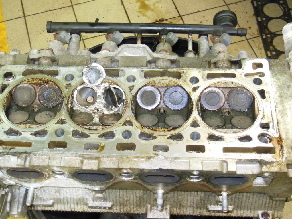

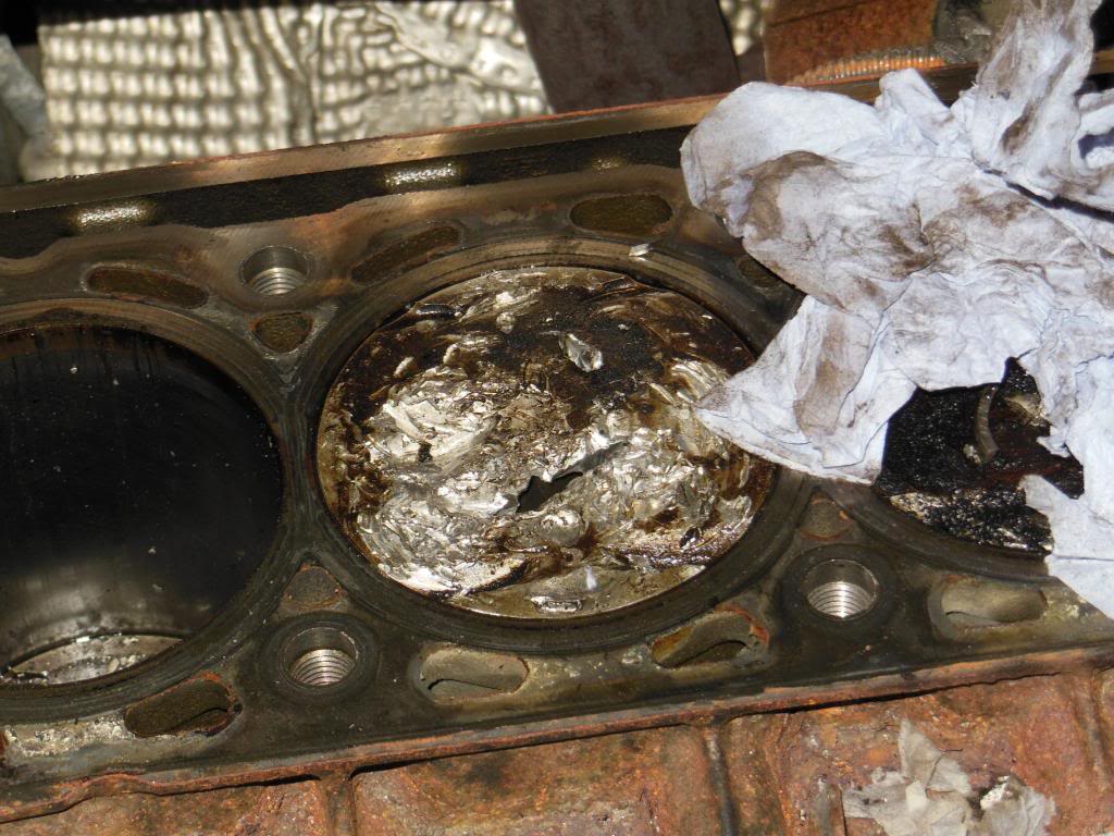

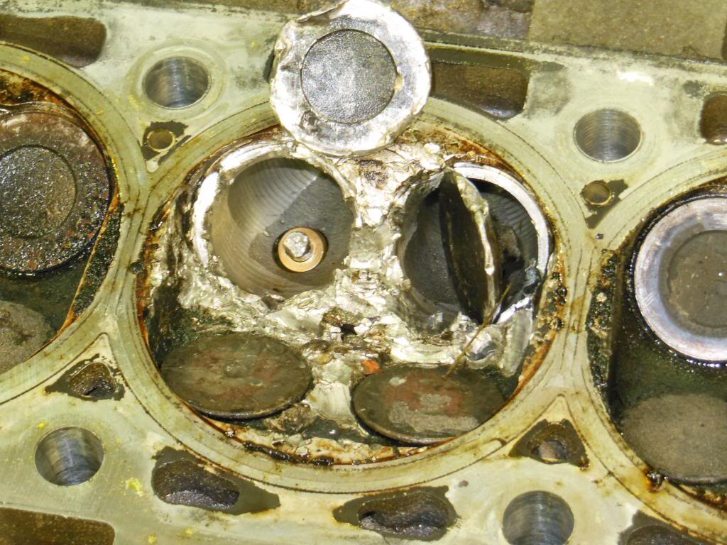

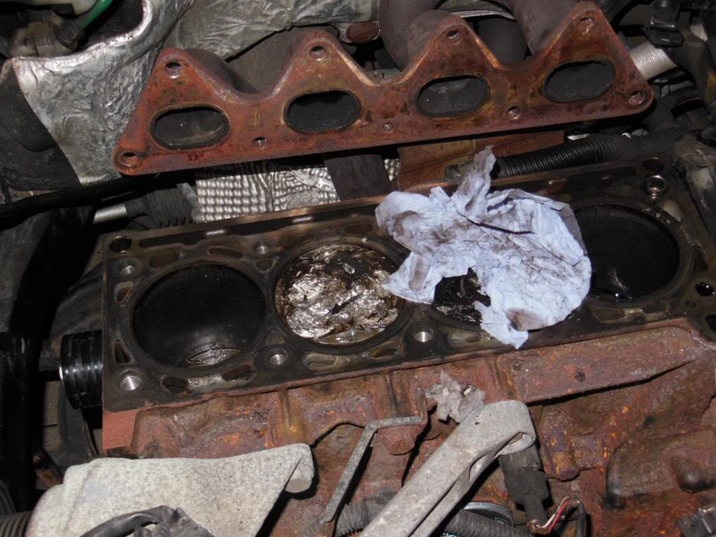

Having been to see the car took a few snaps, here are a few photos of the damage

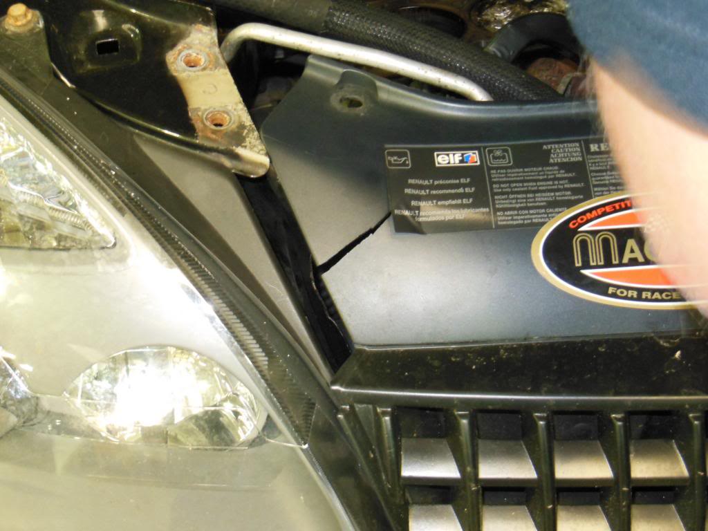

And to add insult to injury cracked the front grill by leaning on it with the slam panel removed.

I will never understand people that dismantle engines without moving things from around them, it's asking for damage! God knows how the aux belt can go on and off without the AC pipe being unbolted from the front panel
