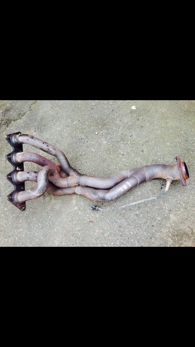

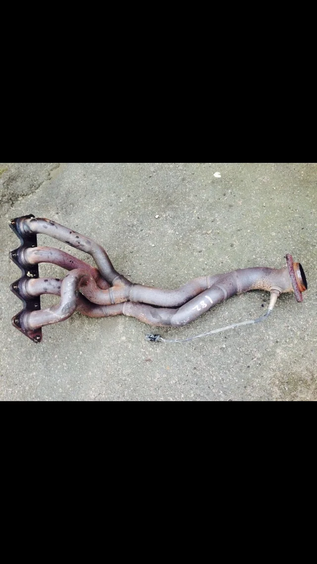

Does it look like this:

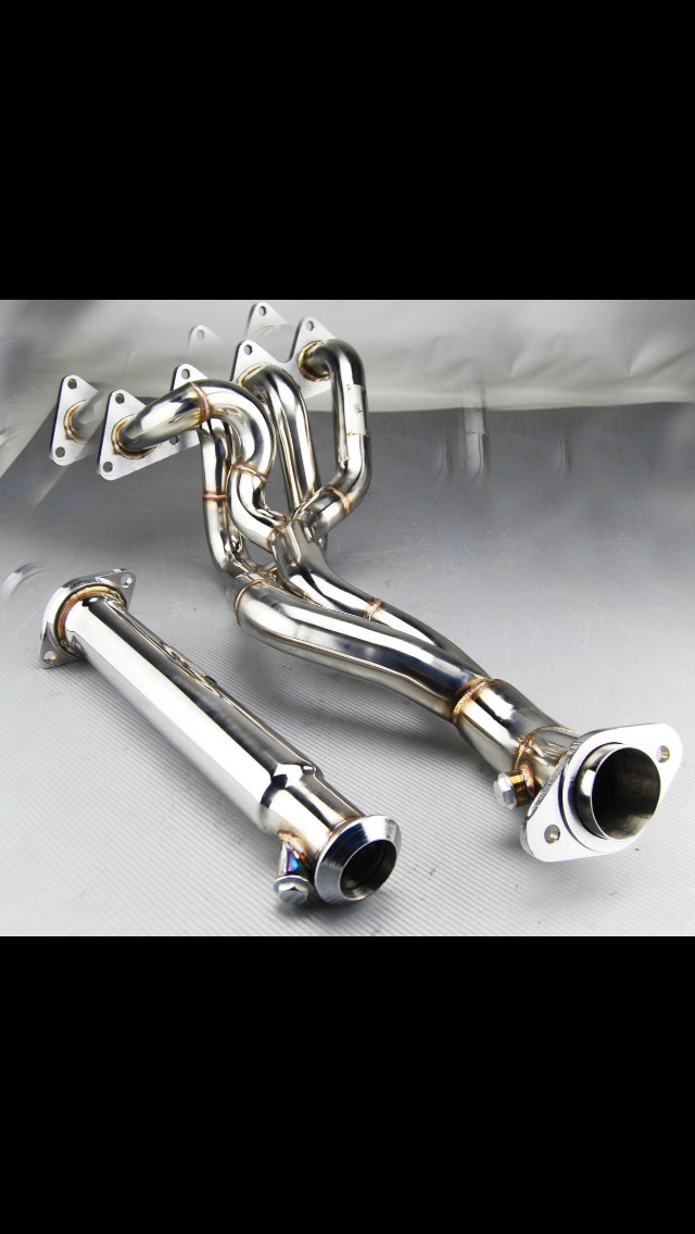

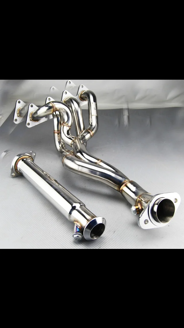

Or this:
They're shite.
Welds crack, runners crack, flanges aren't flat, the link pipe puts the exhaust against the body, or on the floor. The manifold itself hits the subframe.

They're s**te.

They're shite.
