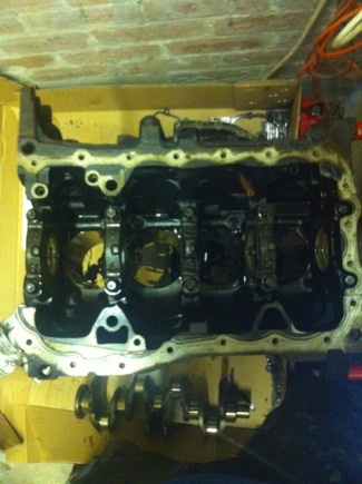

Well iv never been bothered about doing a thread but thought I would knock up a quick 1, started buying parts for the car last sept and began work on the car this January,
Parts I picked up where

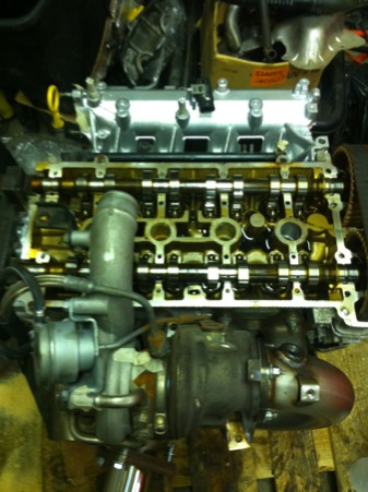

Megane 225 complete engine
225 milltec down pipe,225 milltec decat, helix paddle sprung clutch , usual service parts, megane 225 lift pump/sender unit, k tec uprated mounts , vacume fpr.

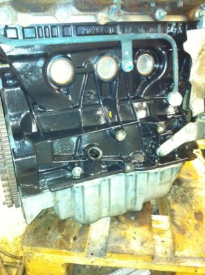

So then I set about getting on with the work,,,

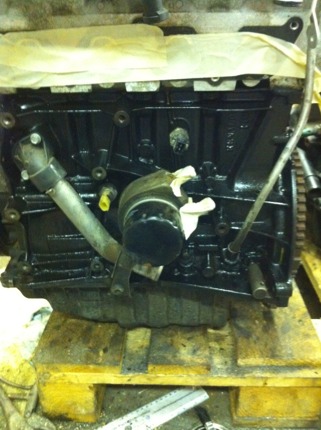

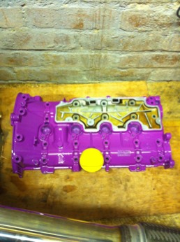

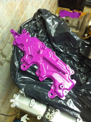

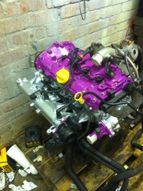

A little paint
A bit more paint

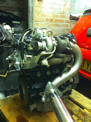

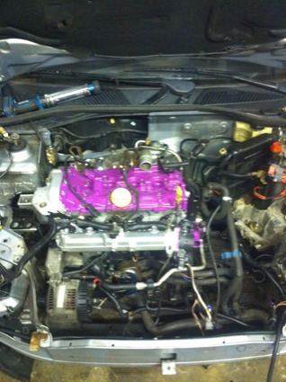

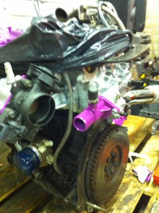

Then got round too making a custom throttle body mount and lined the jc5 box up to drill and tap the neccery holes
Then got it all bolted together and dropped in place

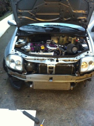

Then set about making up a custom power steering pump and alternator mount which done the job but was giving a little vibration thru the car so has now been changed too a own set up from a traffic van, I measured up for size too get the intercooler made up and started routing the pipe work

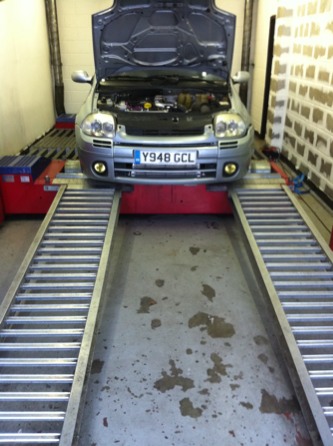

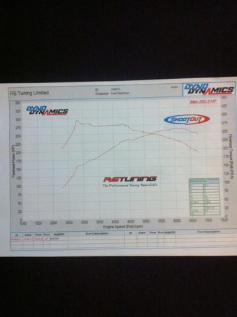

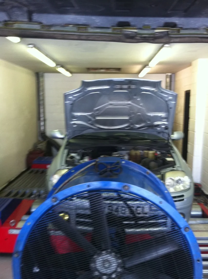

The build wasn't without it's llittle problems along the way, iv had the car mapped at Rs tuning by Paul, and made 228 at 0.6 bar. Had a few teething problems which iv now sorted out and it's booked back in in a few weeks to crank it up

Quite easy tbh u obv need too use the Clio fly wheel and sump then just a case of trying your box on marking the holes up and drill them out,

ImageUploadedByTapatalk1313261388.435077.jpgWell back from Rs tuning and happy as a pig in s**t car drives amaizing certainly puts I smile on your face, big thanks too Paul. 262.5bhp. 290Ftlb. ImageUploadedByTapatalk1313261388.435077.jpg
