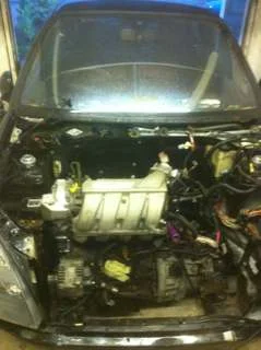

Like this
Power steering pump bolts in under alternator, I had too use the f9q pump too tho as the pully is stepped in a little the Clio 1 catches subframe
