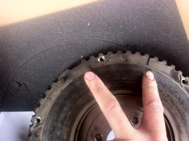

4. Theres apparantley a seal behind the dephaser or in the dephaser, I asked renault and they said the dephaser comes with all seals and bolts. The one I got didnt, they showed me one from a megane and that did come with a new end cover however this was a Torx head not a 14mm hex.

Camshaft and crankshaft locking tools are absolutly necessary. Pulley locking tools aswell and you'll need the VVT extended cog for the 1*2 F4R engines. Dephaser has a oil seal behind (Renault only) and a seal behind the front cap.

The seals come as a kit with new can pulley bolts, all are necessary:

Cam pulley seal kit and bolts 7701471629

Yea it works on oil, need fresh oil for good practice really, prolonged life etc. When you first start the car after putting a dephaser on it will rattle like fck until the oil pressurises into the new dephaser, I'd rather that oil was new

^and you never start the car with a new dephser without priming the oil system first (unhook injectors and crank the engine)
