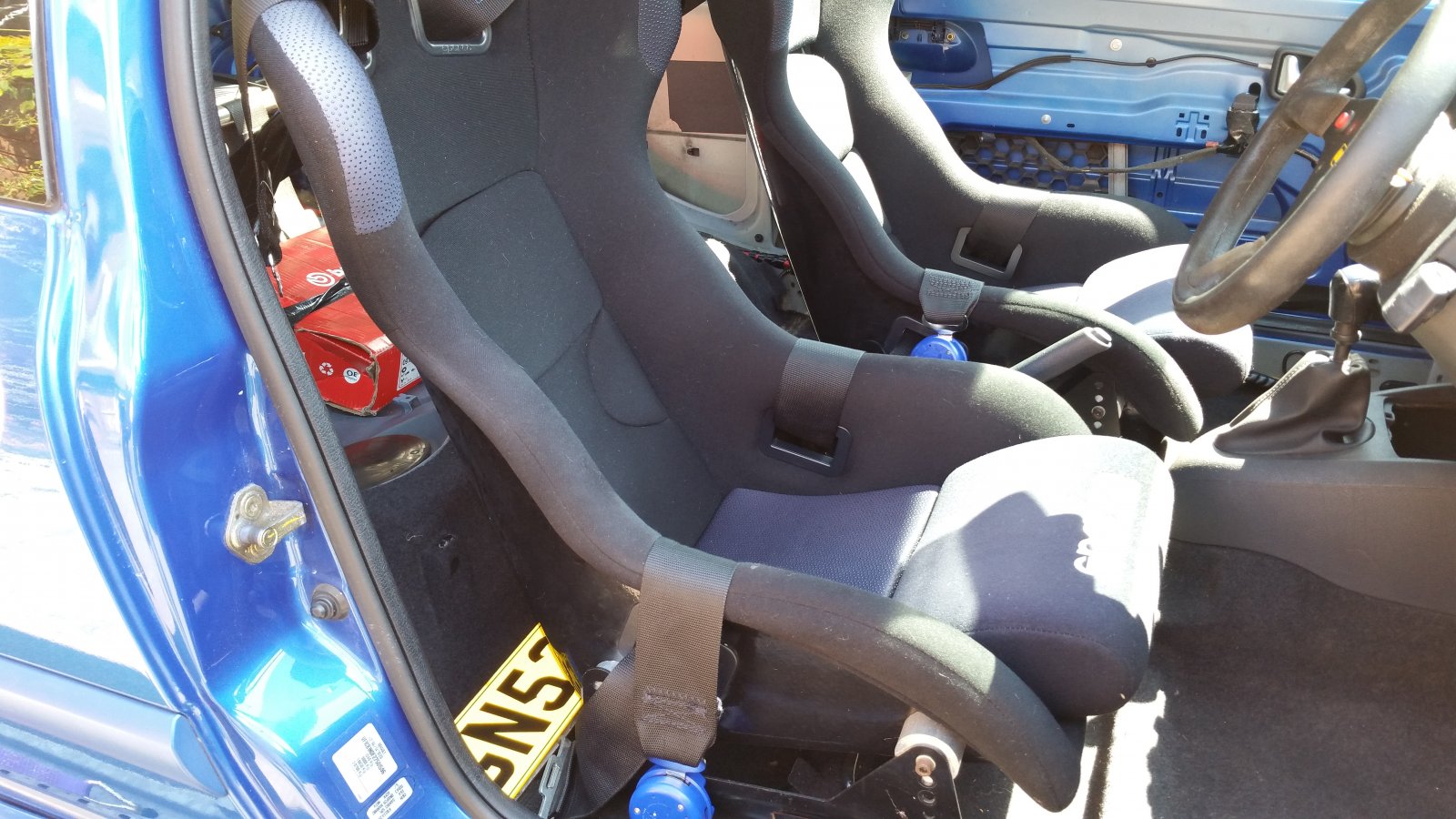

Cambelt and dephaser is usually about £500 on a car with A/C but a cup would be cheaper. Dephaser sounds like a rattle from the top of the engine which should be easy to hear.
All the other plans sound great. I'd check the angle of those rear harnesses though as they won't do their job properly at the wrong angle. http://www.msar.co.uk/pdf/UsersGuideRacingHarness.pdf
