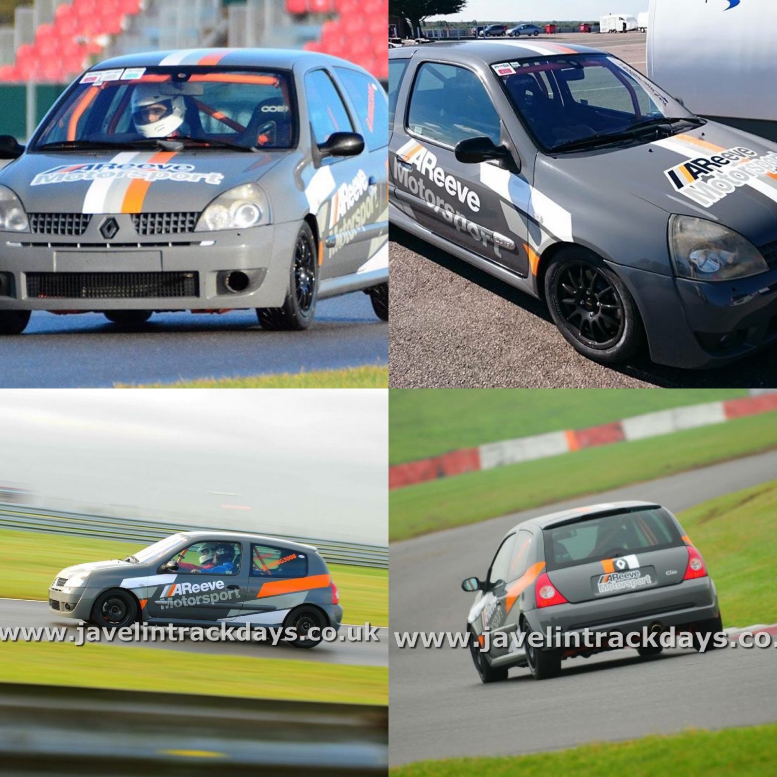

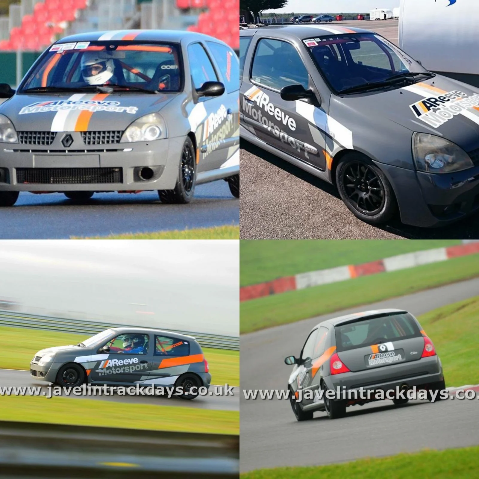

I'm there tomorrow bud, I will be in the a grey/ orange Clio 182.
If you need a hand with anything or want to chat give us a message on 07956049502

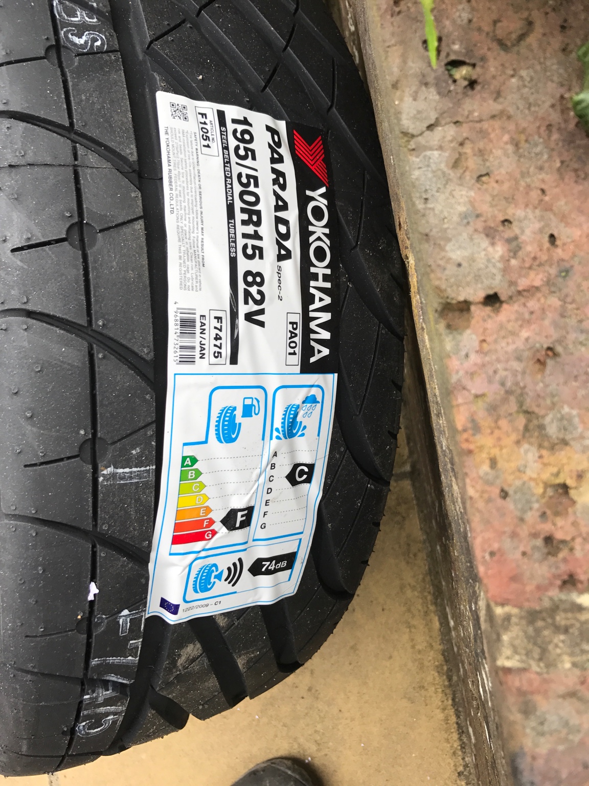

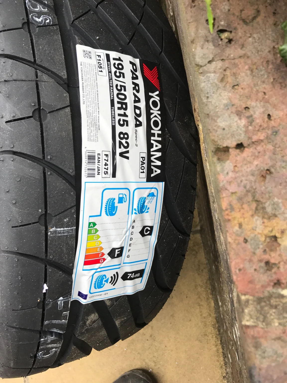

That's really helpful mate thanks what tyre pressure should I be running to start with ? I only ask because I put 15s on my car yesterday and was Running 16s before. Do they have a pump station there to adjust them ?

Presumably you're on road tyres in 195/50/15 if so just drop the pressures 2-3 psi and then go out and build, build, build. Use the turn in and apex cones and also the brake boards to gauge your braking distances. Also use the last lap as a full cool down lap, this is important as you don't want the car sat there in the paddock red hot.
On returning to the paddock after your first session and cool down lap, turn the car off leaving the handbrake off. Then either leave the car in gear or chock the wheels. Then check your tyre pressures, you'll want them at around 29psi front, 28 rear. I state these as once the tyres warm up again then they'll inflate to the recommend 32/30 psi.

Brave lol. Although I have used them in the dry and they were spot on. Was a very warm day though. What made you pick those, tread pattern ;)

Why is it brave lol I just got a good deal on a wheel and tyre package I know there not the best on the market will move onto something els when they are worn out

Bare in mind I'm pretty new to this so I don't really know what tyres are good ore bad really

Yeah just take it easy. Just don't search those tyres on here lol.
I thought they were fine, cheap too
