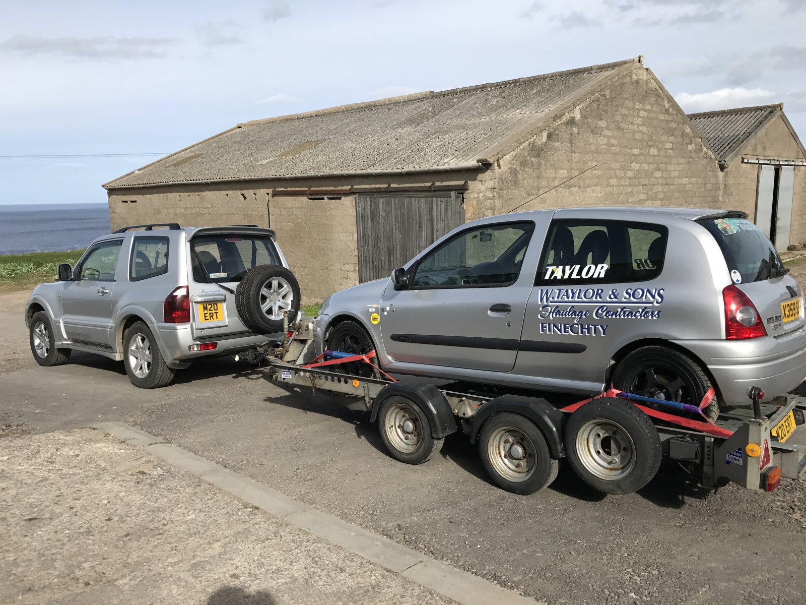

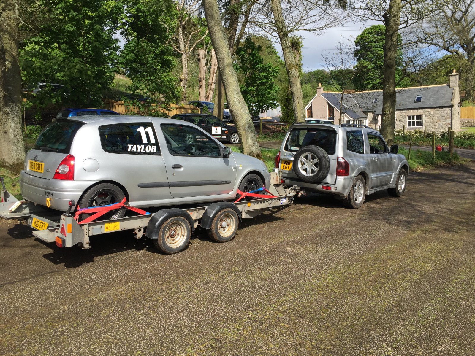

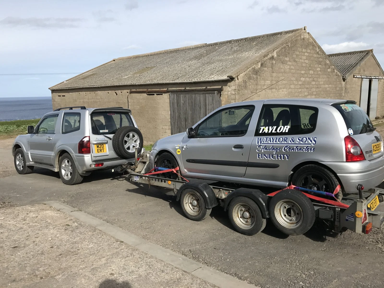

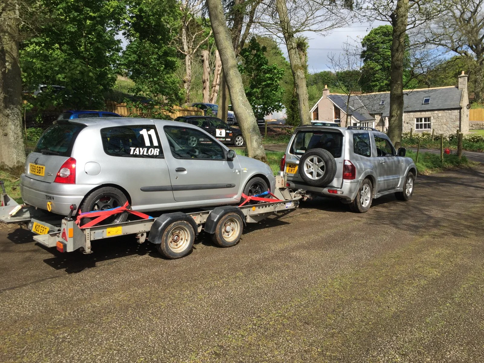

Cheers mate, any pics of the Clio loaded?
Mertin
  Ph1 172&Ph2 172 Cup
Got quite a few pics, heres some below
