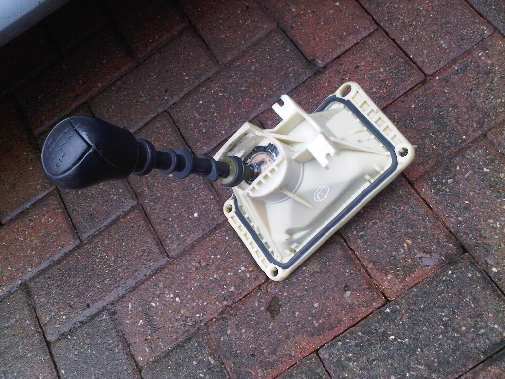

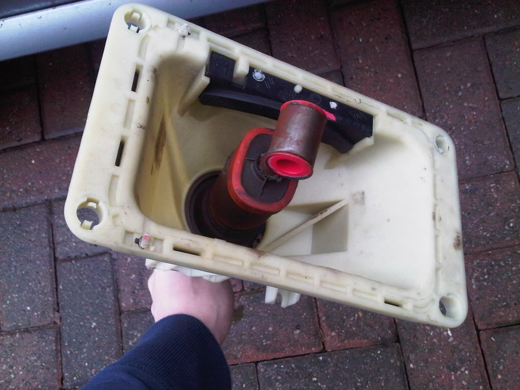

heres the pics of gearknob/leaver.

If its anything like my 106 you just need to remove the old one from the inside and you should see a hole where the stick attaches to the linkage. Then you might have to jack the car up to attach the linkage to the new stick and then just tighten the 4 bolts inside the car.
  Storm Grey 200
This is correct.

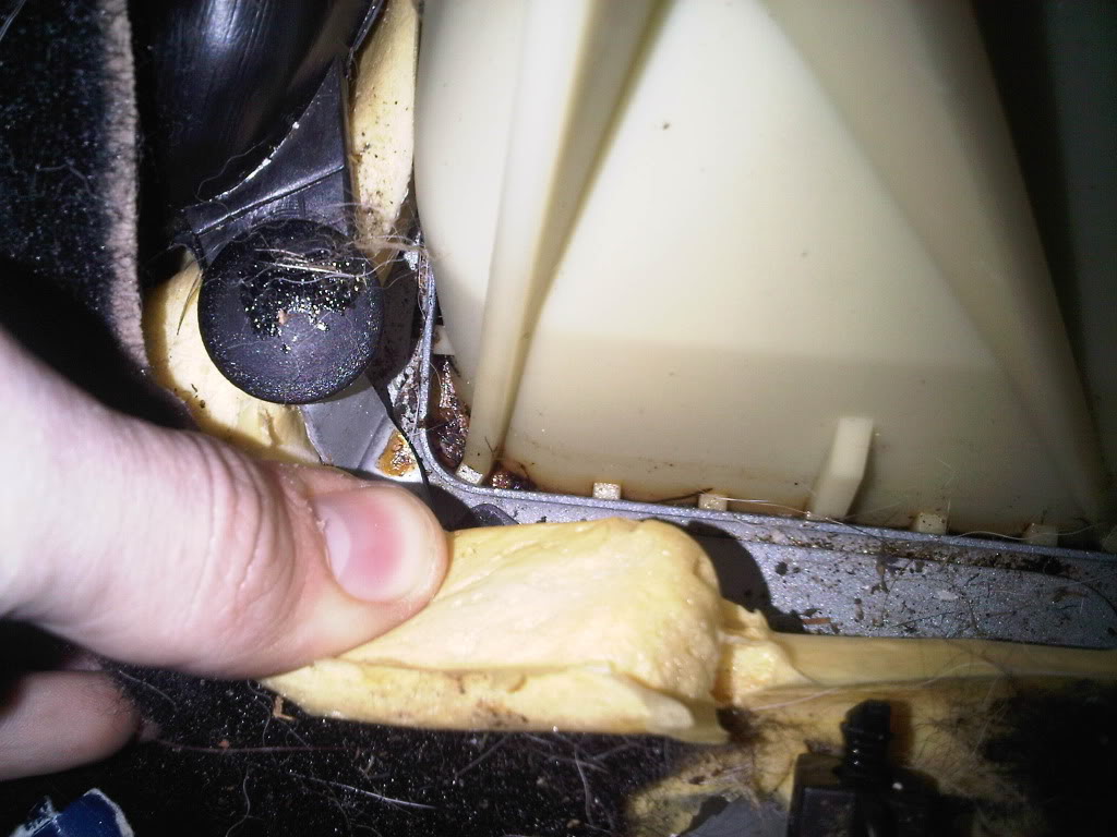

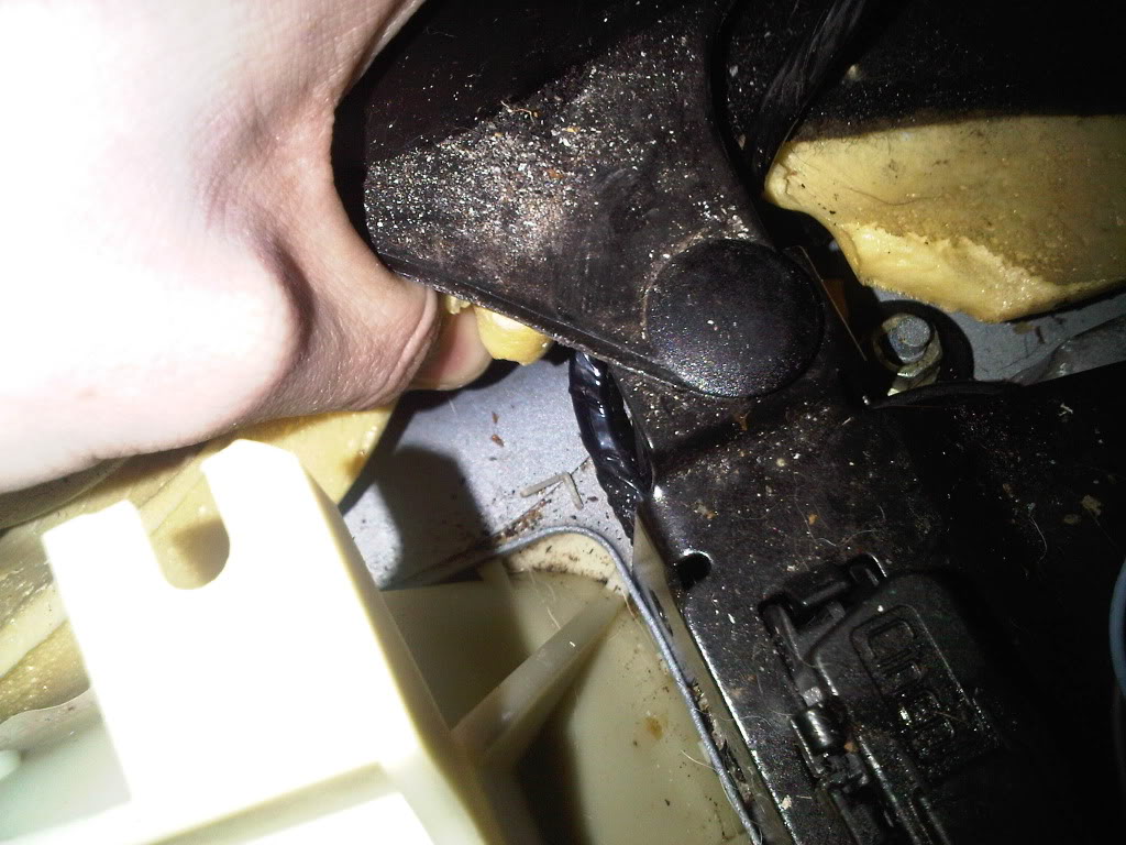

the bolts are actually underneath the chassis, there metals actually moulded/curved round them inside of the car, ill get a picture.
