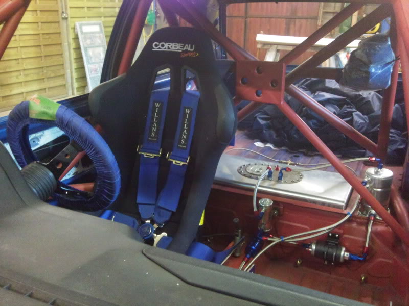

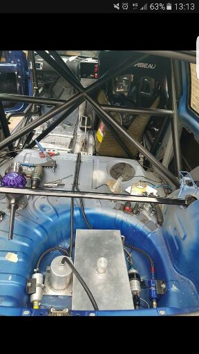

Heres mine - still got to make a removeable cover for it.
Going to run a filler to a plastic side window with 2nd skin.
Been suggested about rear impacts obvious the tank has no where to go. So possibly might make a rear crash bar behind the bumper.
Sent from my SM-G935F using Tapatalk

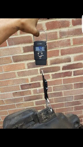

Anyone know what the oem fuel tank system weighs?

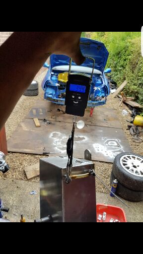

No worries, so thats my tank, plus 500g for swirl pot, then about 1kg for 2 pumps. Lines wil be similar to standard.
Then about 1kg for box. Other words not a lot of saving. But for me I got most of it very cheap and wanted to stop surge with the swirl pot anyway, so wasnt really about weight saving.
Be more beneficial for the chap above for sure.

So around 3kg saving in you think? As you say, not a huge amount. Depends on the use of the car though I guess. Every little helps, just got to be careful where you place it.
