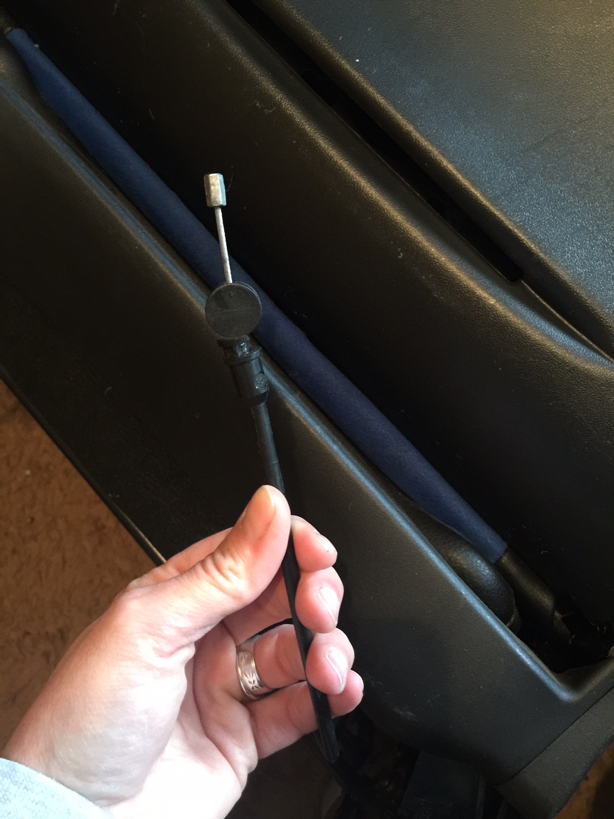

Hi guys, so I collected my seats on Sunday. Should there be any plugs/electrical connectors under the seat? I know the cup doesn't have airbags but should there be anything for the seat belts?
This is the only cable under the seat, they recline & slide fine?
Thanks
leedsboy
  Bean 182 + E70 X5
It's been a while since I fitted my Trendlines but I don't remember any other wires/connectors on the seats.
The only thing to plug in is for the pre tensioners which you take off your old seats, then it plugs into the connector attached to the car.
The wire you've attached is obviously for the tilt and slide function.
As above
The cable is for the seat runner so the seat slides by the look of it.
The 172 Cup will have:
Passenger Side - Wiring to the seat belt pre-tensioner (two wires)
Drivers Side - Two wires for the pre-tensioner, two wires for the seat position sensor, two wires for the seat belt warning light / beeper
The only other wires under there will be for the side impact sensors (two wires going to the sills)
