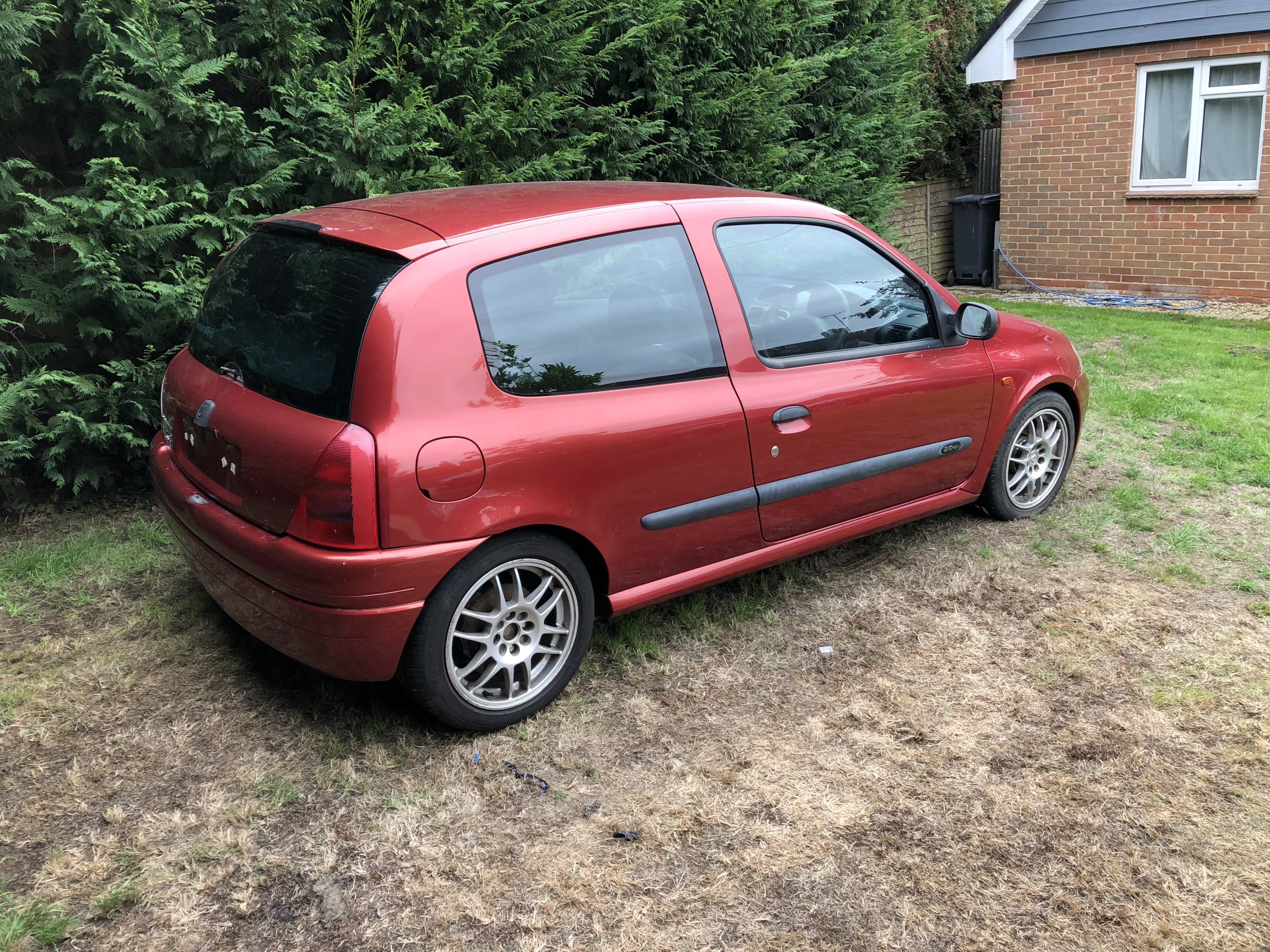

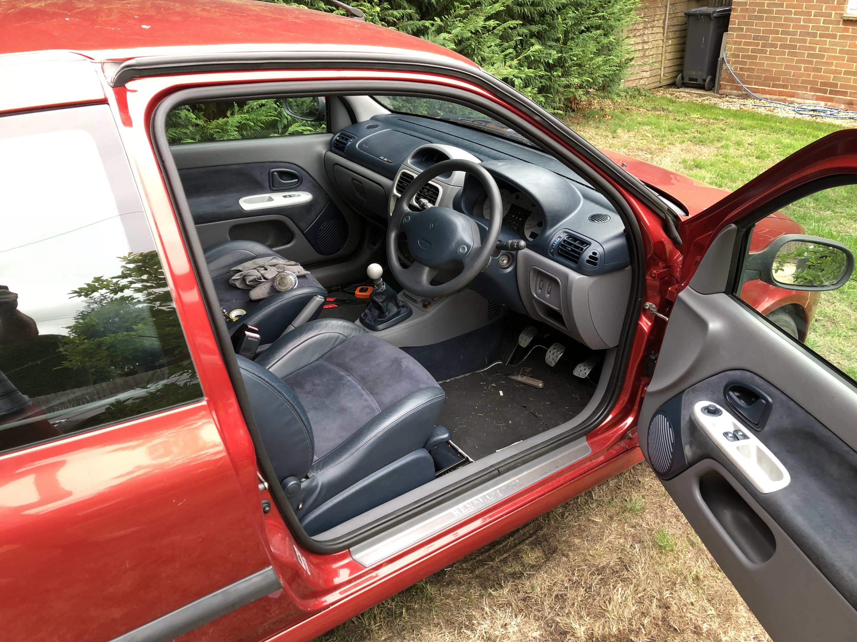

Well after all the uncertainly over the past few months we have decided to let the Mercedes go that the better half uses.
Like me she’s has nostalgia with the red 172s so she really wanted to have this as her daily. As it’s a rust free example I was to put the time into it.
So set upon working on it to get it ready for daily use. Commute is only 16 miles a day so nothing hard.
Work done so far.
Fitted original rear lights
Fitted rear wiper motor
Fitted better front seats
Wired all airbags in correctly
Fitted nice steering wheel and airbag
New cup shocks with eibach springs, top mounts etc
Used set of F1s
New PS3s all round
Fitted origInal airbox and air feed
New rack ends
Dents removed
It’s booked in at the end of the month for the following
Full cambelt service including dephaser
All fluids
Plugs, leads, coil pack
All engine mounts
Should be good fun hopefully.

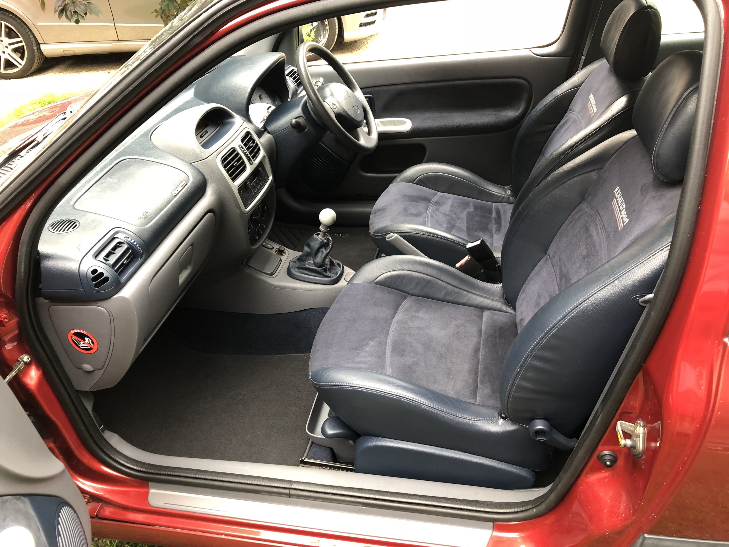

Lots of scratches around the car but that’s ok, it’s. It going to be a minter. The interior is up there with best for the age and that’s what you see behind the wheel.
Already has a k-Tec exhaust fitted so will update with a rs tuner map.
s**t pics for now

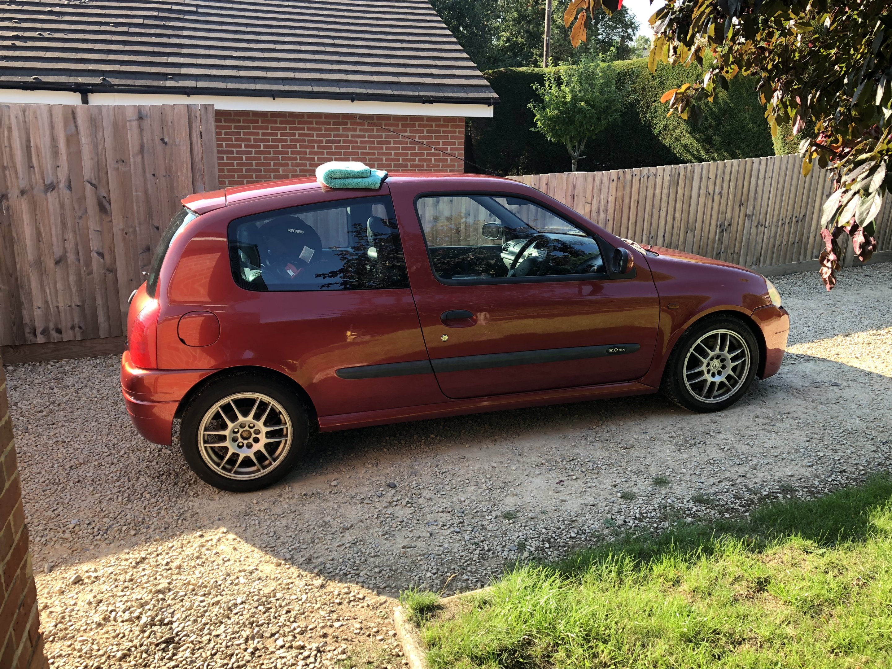

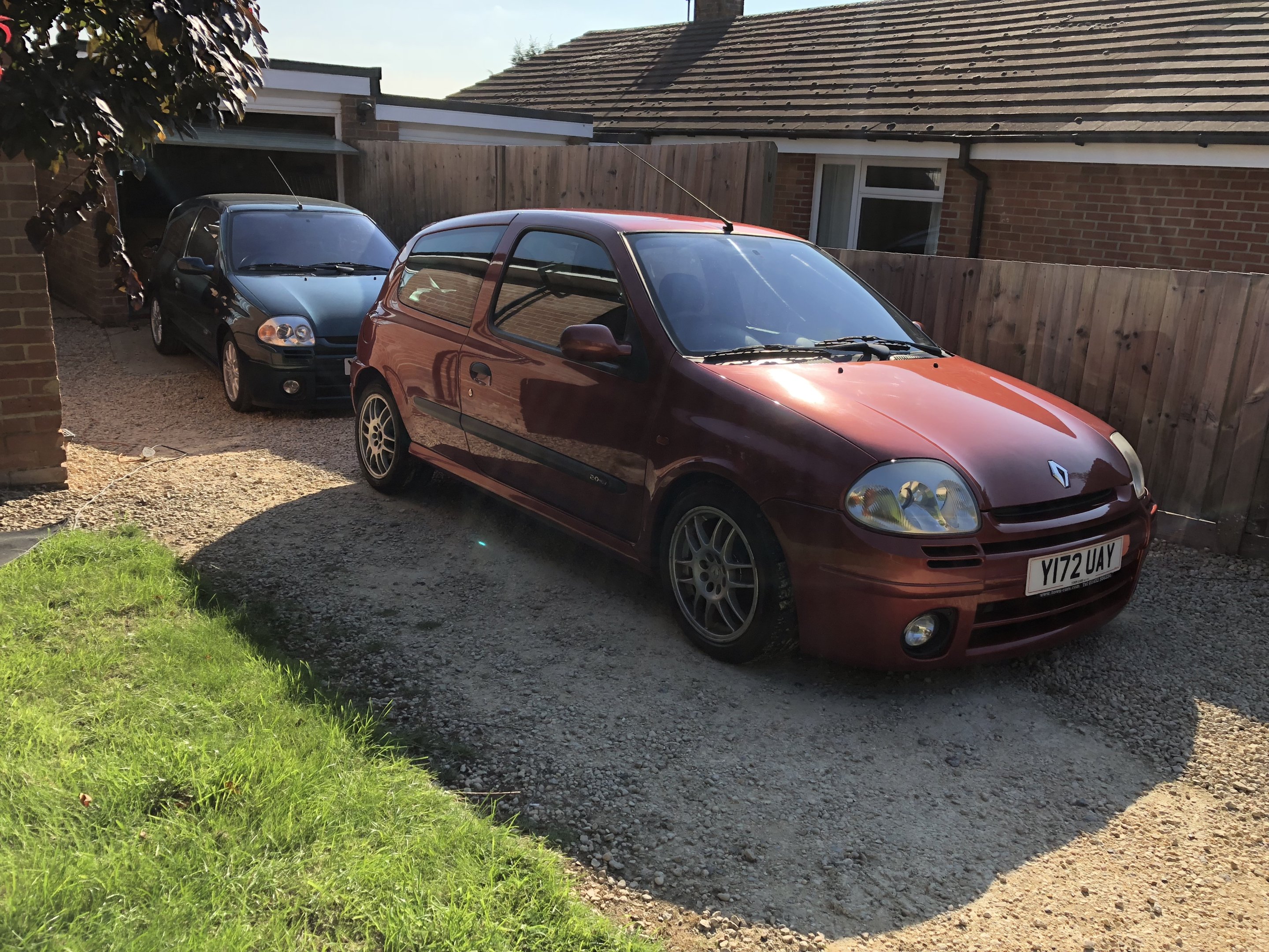

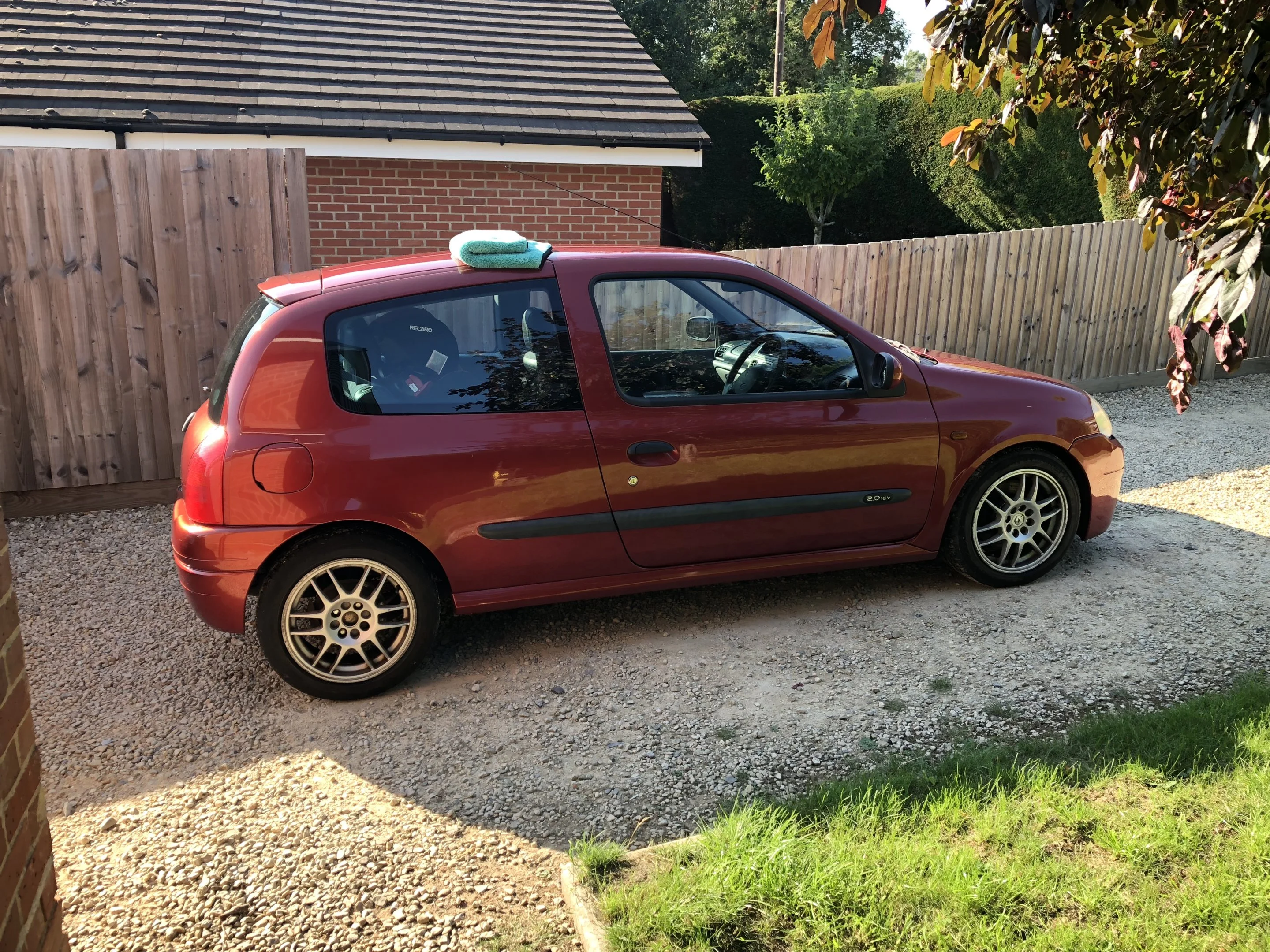

Couple of shots after a quick clean. Busy day tomorrow, door dent removal and new PS3s all round being fitted.
Alignment Saturday after I fit camber bolts followed by aircon re-gas, and finally fit the parrot Bluetooth handsfree kit.

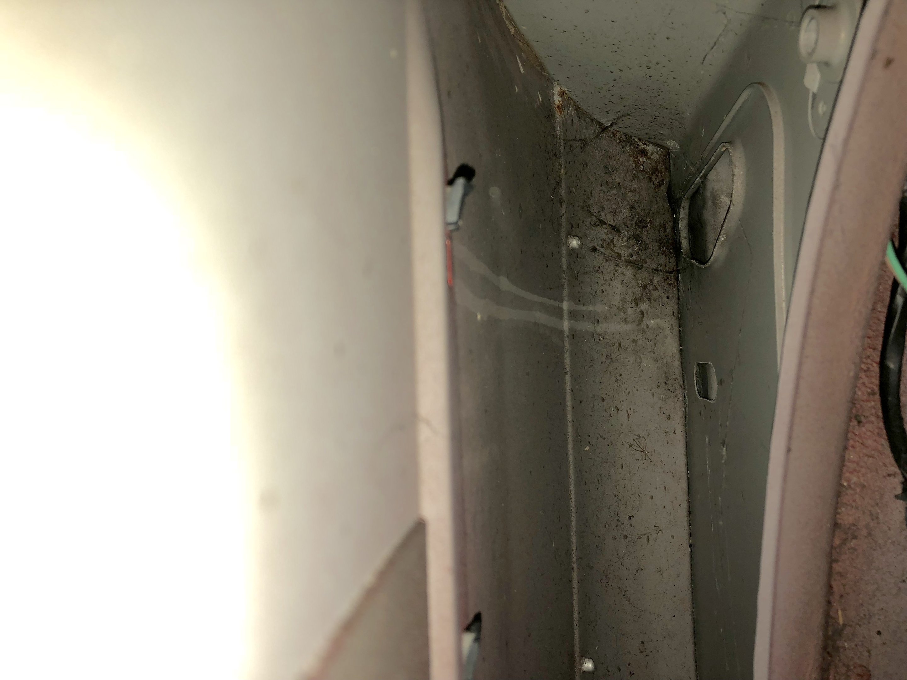

Yeah cheers. Is that a back seat removal job?
No you can’t remove the back seat bases and pull the top parts forward so you can pull the back of the door card. Remember you need to remove the front seat belt anchor at the bottom and also the seat belt anchor for the rears that go through the door card, once you have pulled door card off, unplug speaker wire.

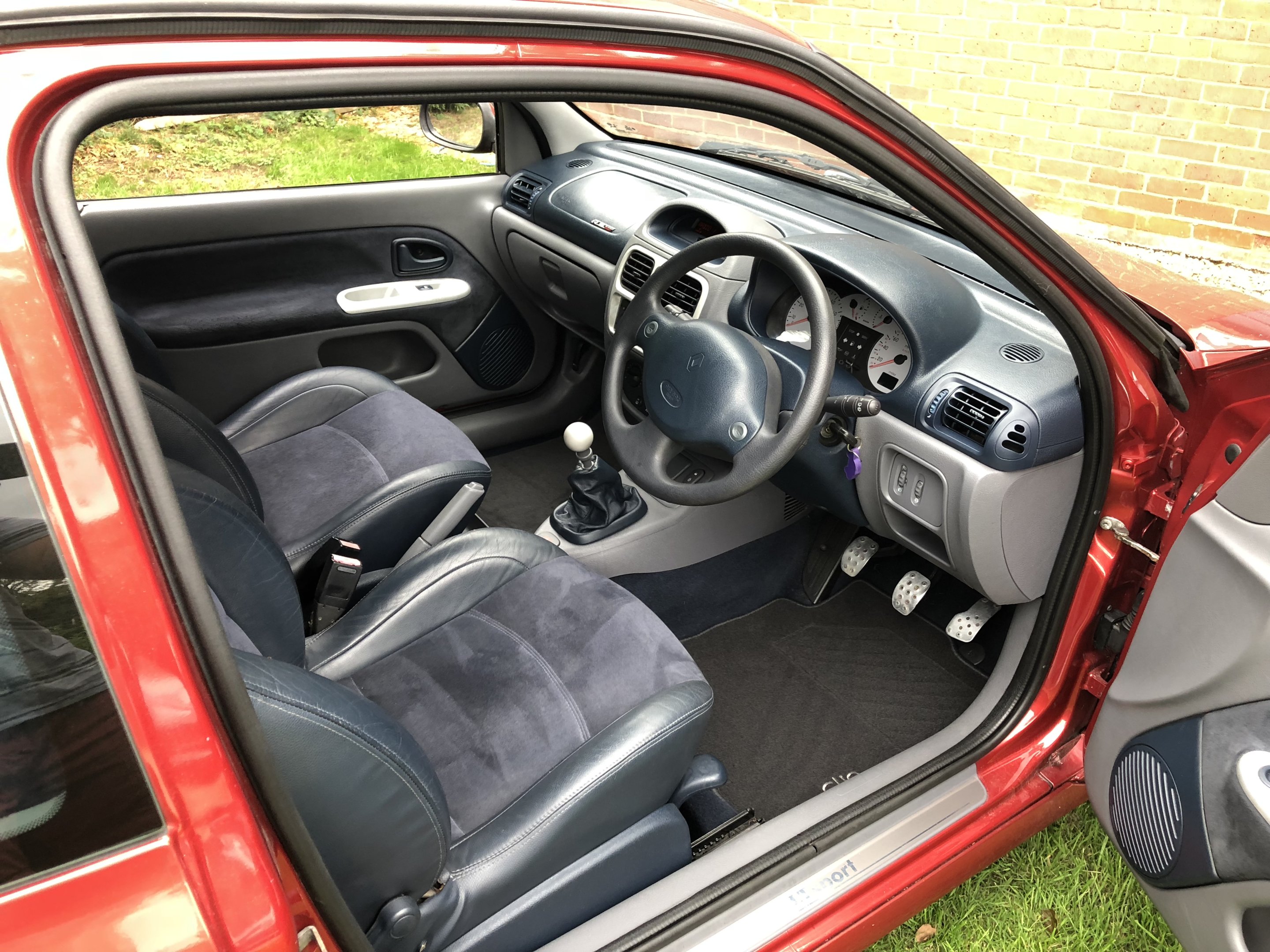

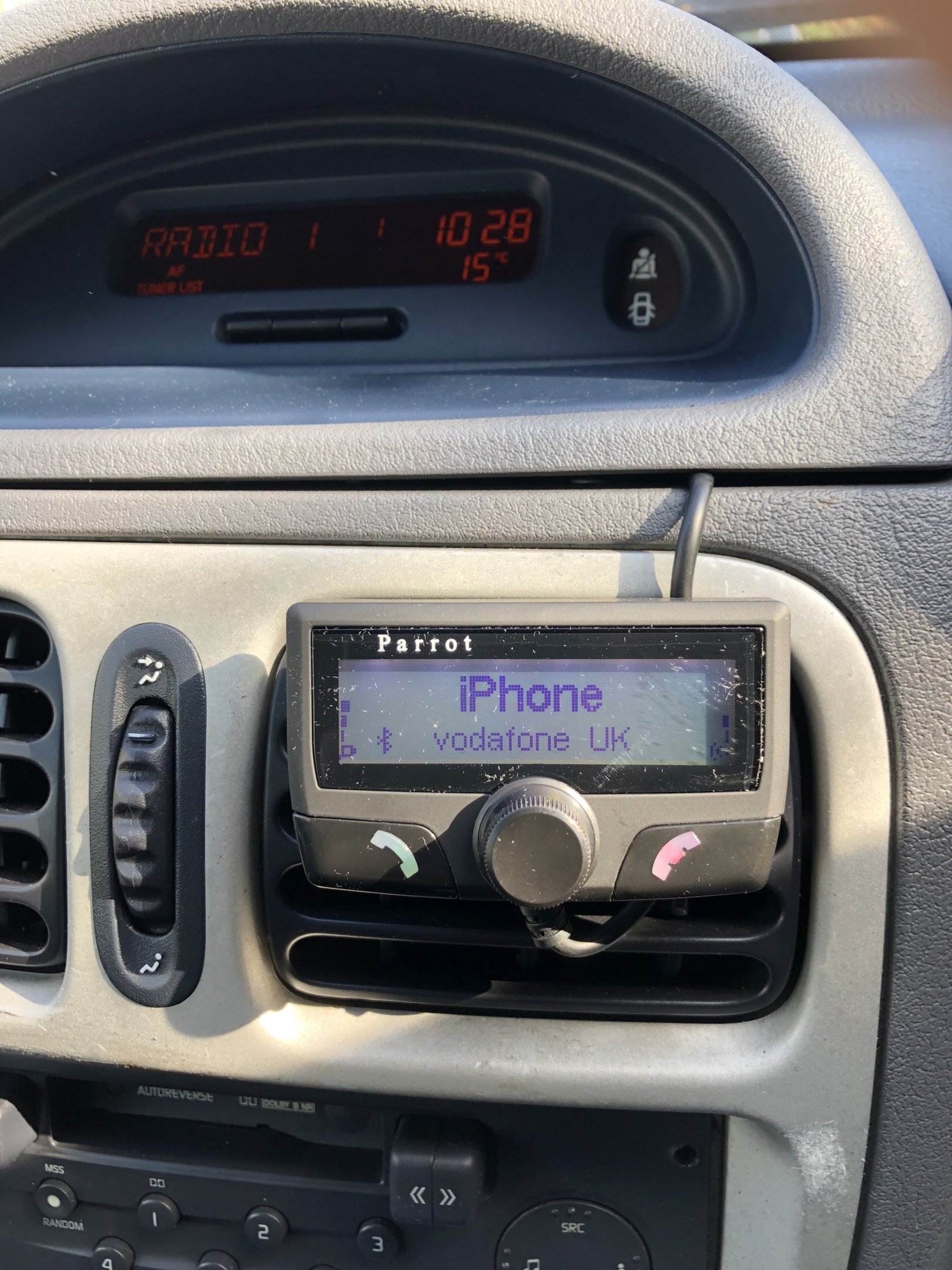

Busy couple of days. Alignment be done and feels great, new PS3s fitted, aircon gassed, lamda replaced (precaution), and parrot hands free fitted. Also fitted new brake line holders that bolt onto the strut.
Touched in scratches, not perfect but certainly presentable.
Only got one photo.

Looks good perfect daily now, quick question, does the dash top with the clock in just pop off the dash or is it plastic welded on, I am guessing you had to take it off to run the cable underneath for the Parrot
