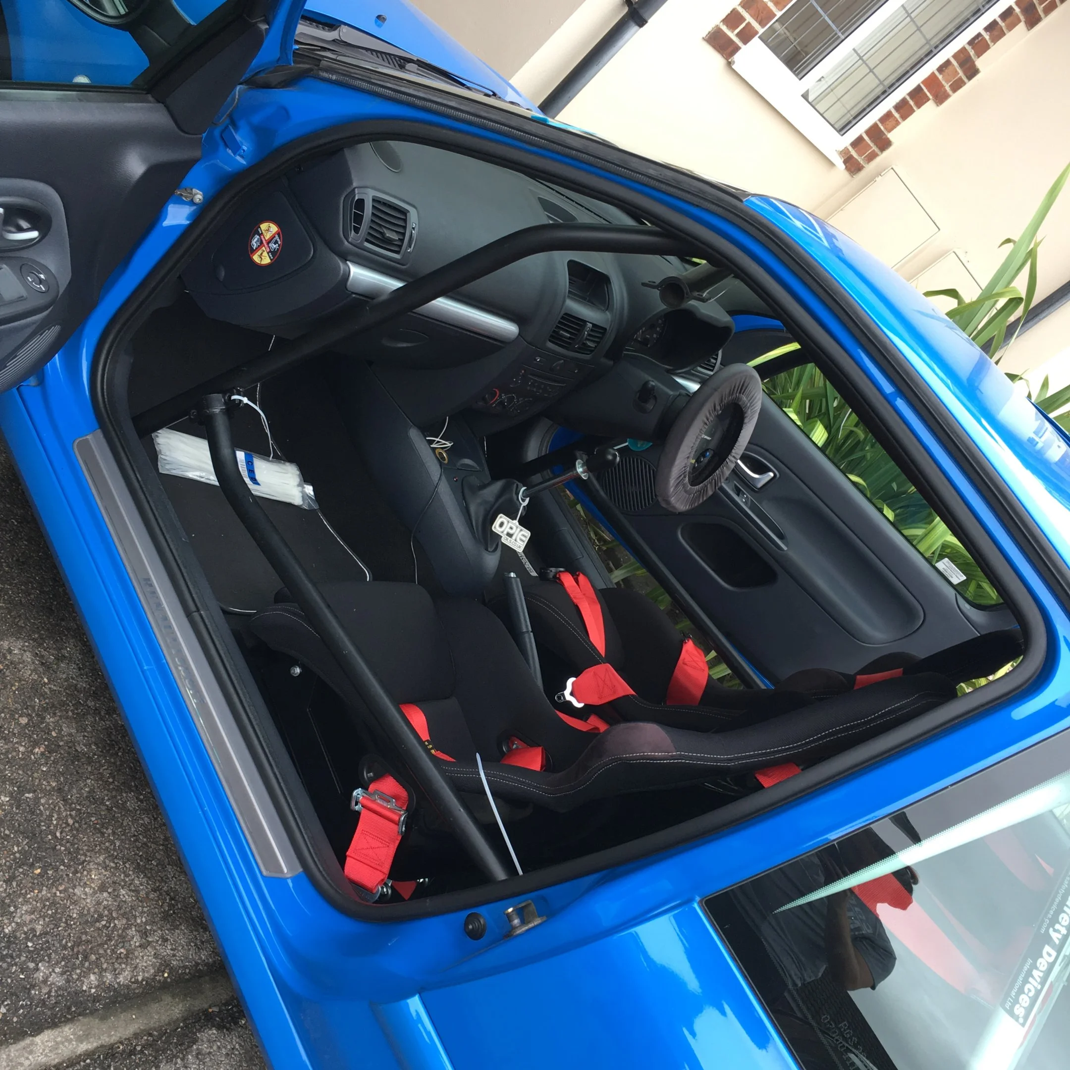

I’ve recently secured a front section of roll cage for my Clio however I had a few questions:
1. Can you keep access to the front glove box? If so is it just a case of trimming the door? Any pics would be great.
2. Sun Visors. I assume you just just remove these.
3. In order to fit the cross cross, along the windscreen do you need to remove the rear view mirror?
Anyway here is a pic of how I cable tied it in place this afternoon!
Thanks in advance
Tom

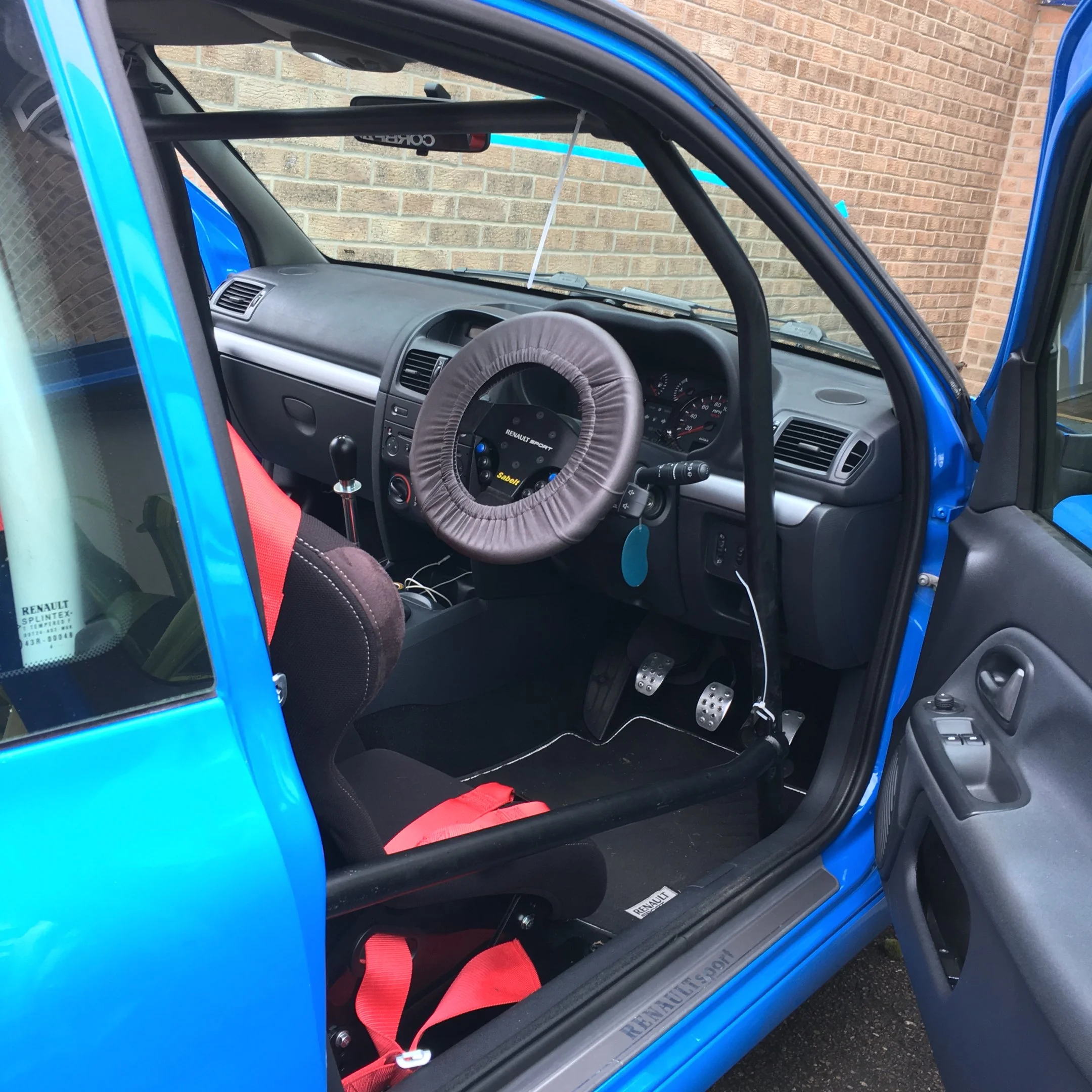

I've got the same issue with the Mirror, if you don't have the cage raised is there a standard way people are refitting the mirror?
Cheers
R29TJR
  2005 RB 182 Cup
Cheers
I took the mirror off when fitting the cage (there is a small clip at the back and then you slide it off) and then simply refitted it once the cage was in place. However I may remove the standard mirror and replace with a large motor sport item.
