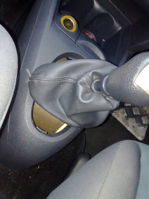

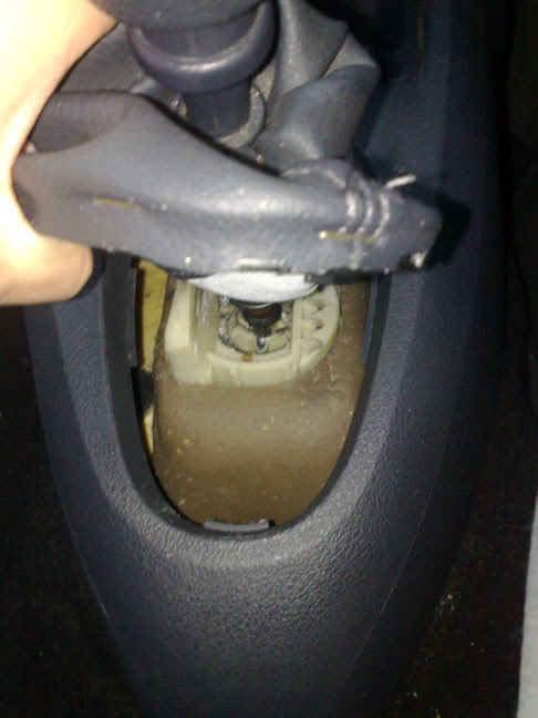

My gear gaitor has come off, I beleive it may have snapped, I may need a new one, if so where do I get them from?
Or do I not need a new one? Just wondering how the hell you get the gear stick and gaitor off to change it?
SEE PICS:
Thanks

May supprise you but Renault sell them.
Pretty sure they are just held on by an elastic band at the top or a zip tie?

When mine broke i just tucked it behind the clip at the bottom of the pic, always worked since.

i replaced mine last month. cost about £30-£35 from Renault.
cut the old one off with a scissors (held in place by zip tie) and the new one comes ready to fit and you just pull the zip -tie, cut off the excess and then click into centre console.
5 mins tops
