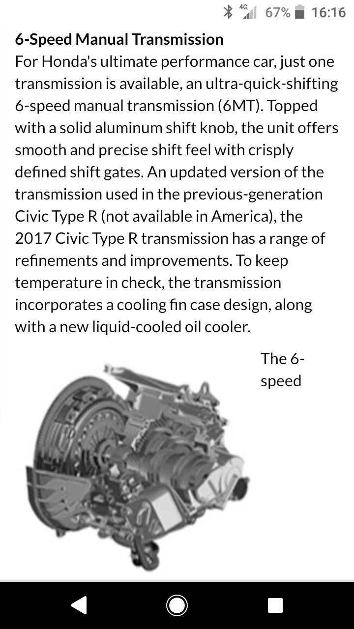

I think you're the only one i know of who's made a cooler for the box 😂
  Civic type r fk8
Civic type r gearbox, must be something in it
