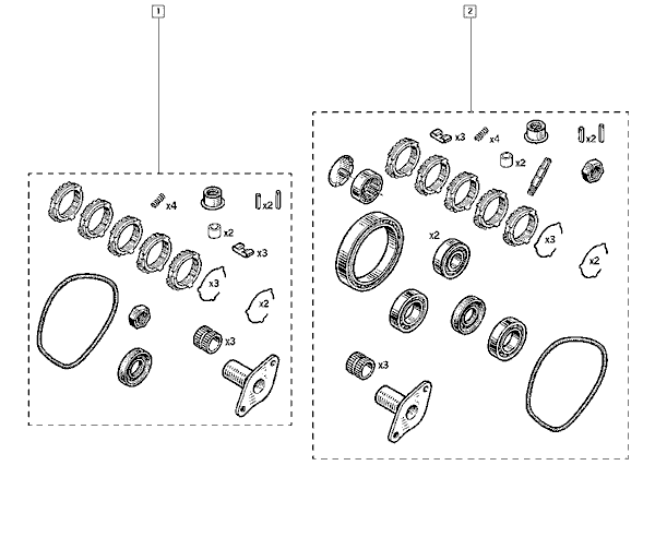

This is what is listed under 'gearbox repair kits' accoriding to Renault.
JC Synchro Kit 7701472393 £68.37
JC Synchro Kit 7701472395 £196.59
From the looks of things there are two synchro kits varying in parts. First kit seems to be a smaller kit, and in the second a full kit (including the first kit's parts). Both of these kits include the oil seal and housing too.

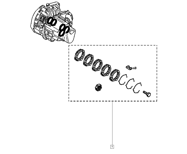

JC5-089 Synchro Kit (looked up specificaly for that gearbox code) 7701467942 £83.88
This kit seems to be included in the first and second kits I listed weirdly. Doesn't seem much point in this one as it has nowhere near the amount of parts in compared to the first two kits - maybe Renault could shed some light on which kit you'll need.

this is the first one. showing part numbers 7701472393 on the left, and 7701472395 on the right.
this is the third one, part number 7701467942.

Make sure you get the right kit for your box, the small and big kit for JC5-089 is not the same as for JC5-130.
Personaly I would go for the medium kit (1) as a lot of things not included in kit (3) needs to be changed when taking it apart. Make sure you have the right tools very easy to chip the 5th gearwheels if you dont use extractors specific for this task.

why not get the box apart and see what it needs, then order the appropriate kit?
kit 2 is the only one with bearings, so whether it's diff or layshaft bearings, neither of the others covers that
