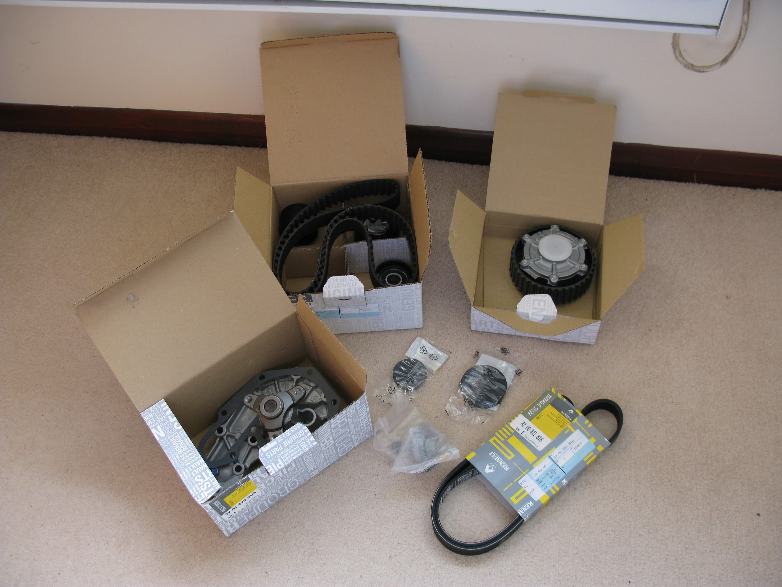

The first year i owned the 172 cup i didn't really do much to it, I done all the belts, water pump, dephaser and replaced all the suspension/bushes with new renault items as although it was a 1 owner car it's service history wasn't all that great. With a clean bill of health and some uprated brakes i done a track day at cadwell, spa, and brands and a couple of trips to the ring.

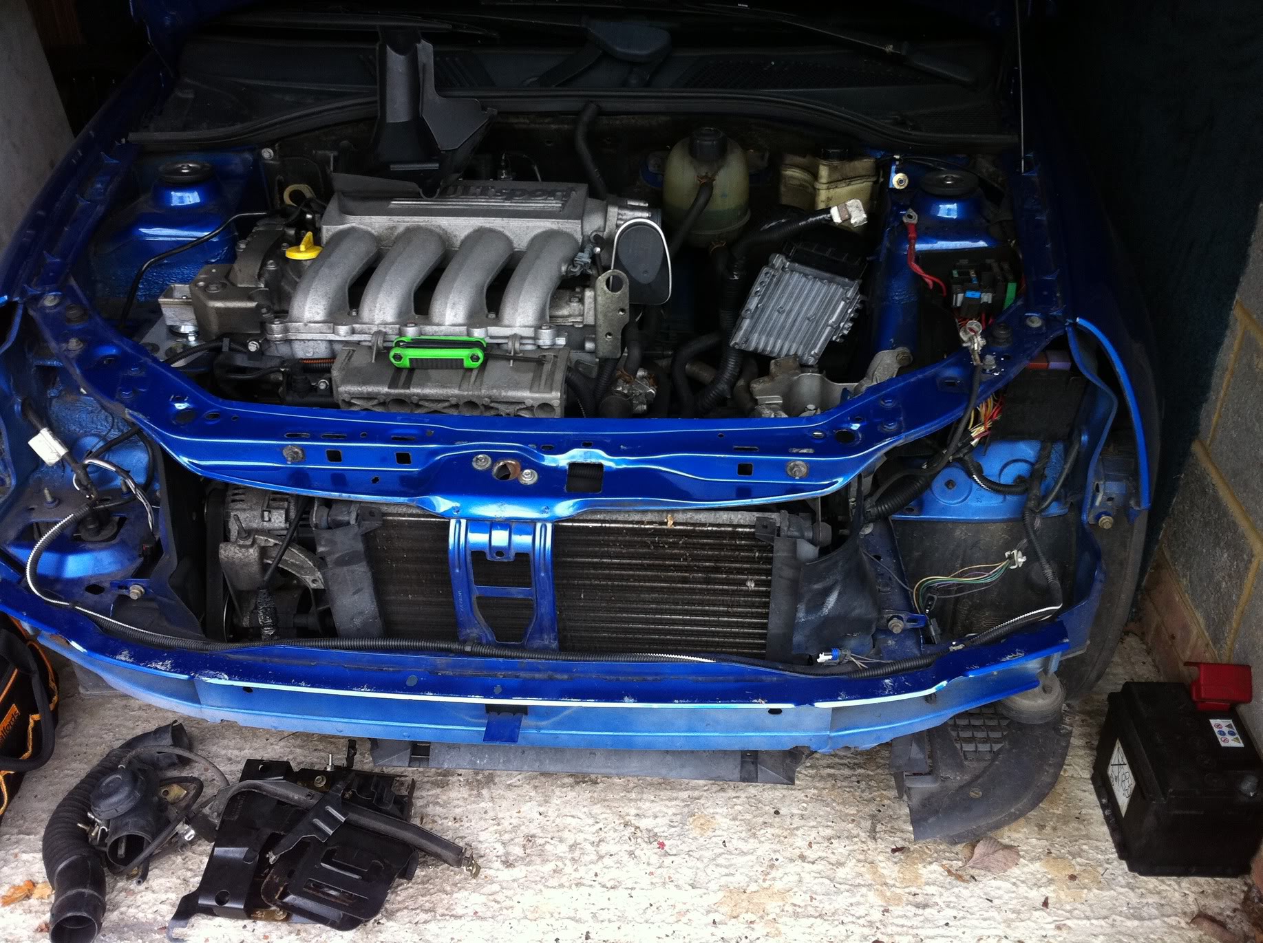

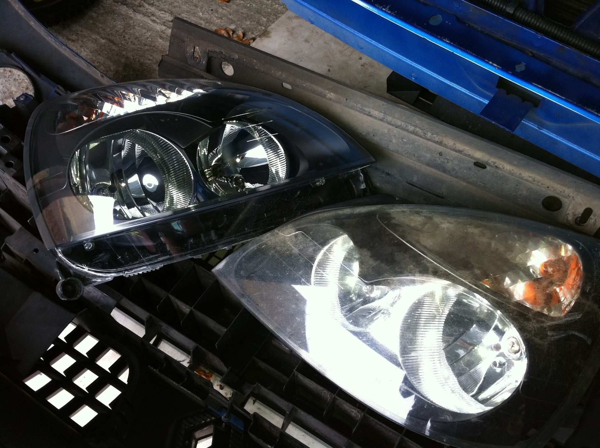

At the moment I'm in the process of stripping the front end down and giving it all a good clean and replacing a few bits, also gives me a good chance to sort my headlights out as they've got really bad over the last year or so.

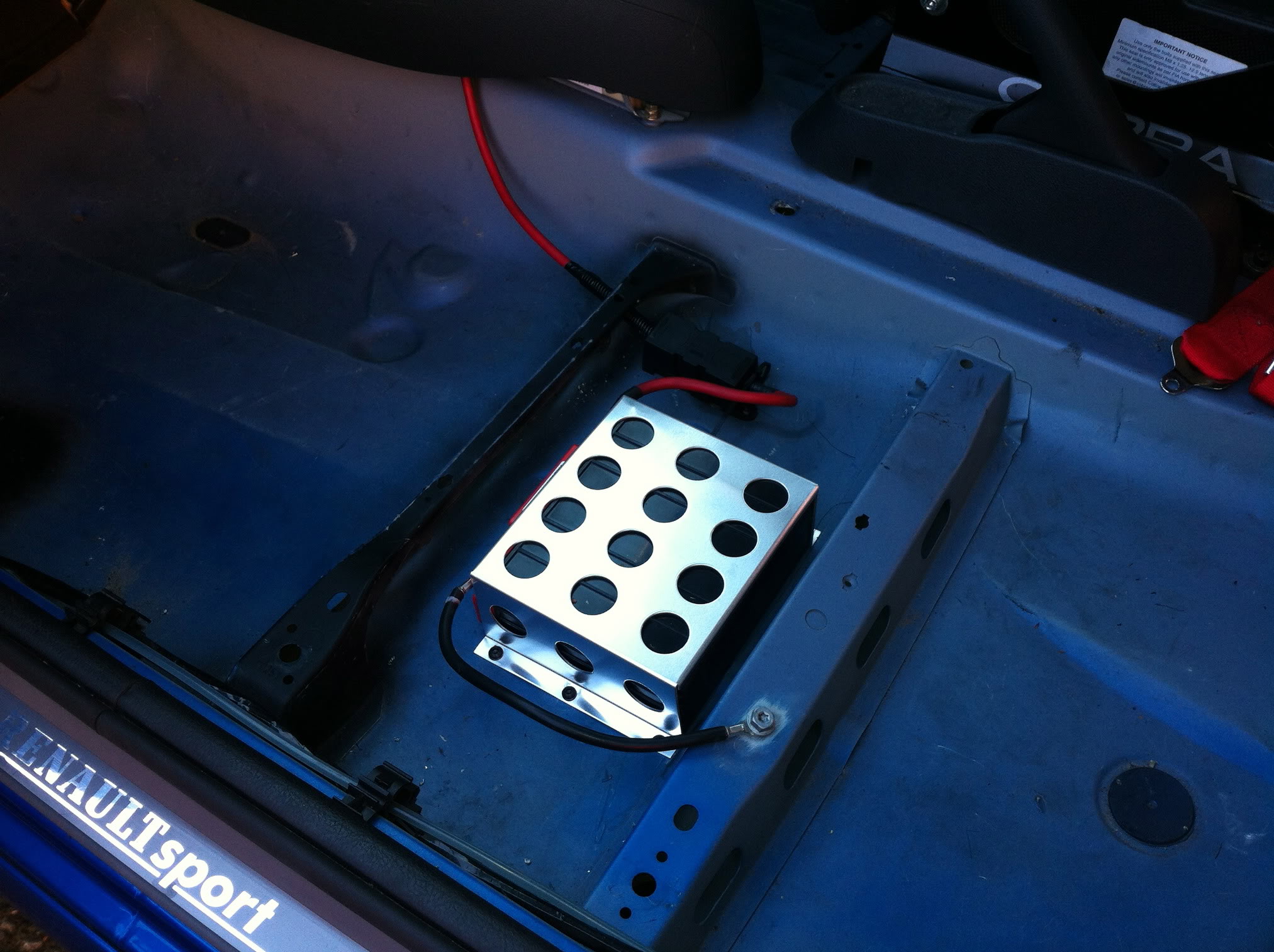

I've also got a odyssey battery i'm relocating to the passenger floor area, and the brakes are in need of some new discs/pads.

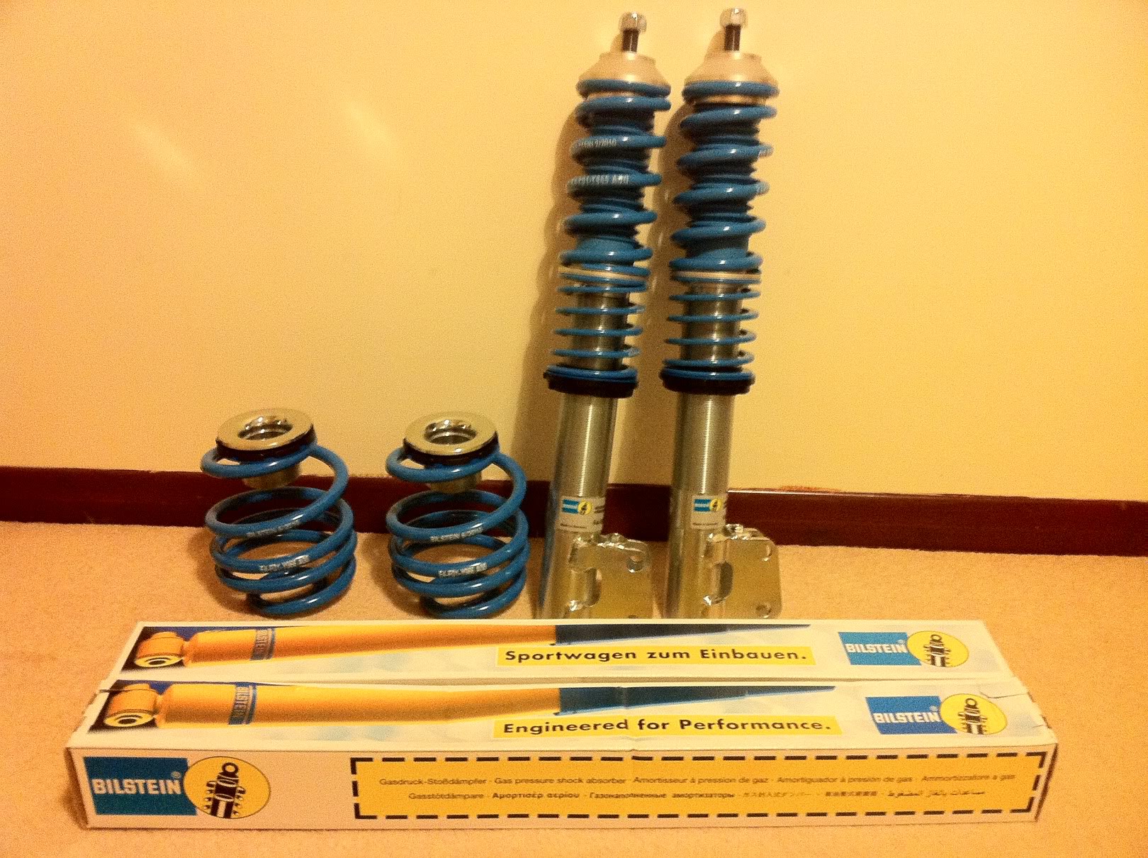

After a trackday in november/december I'm going to start looking at different suspension options with a more aggressive geometry setup. I think that will be about it for this year though as through the winter months i don't get much chance to work on the car.

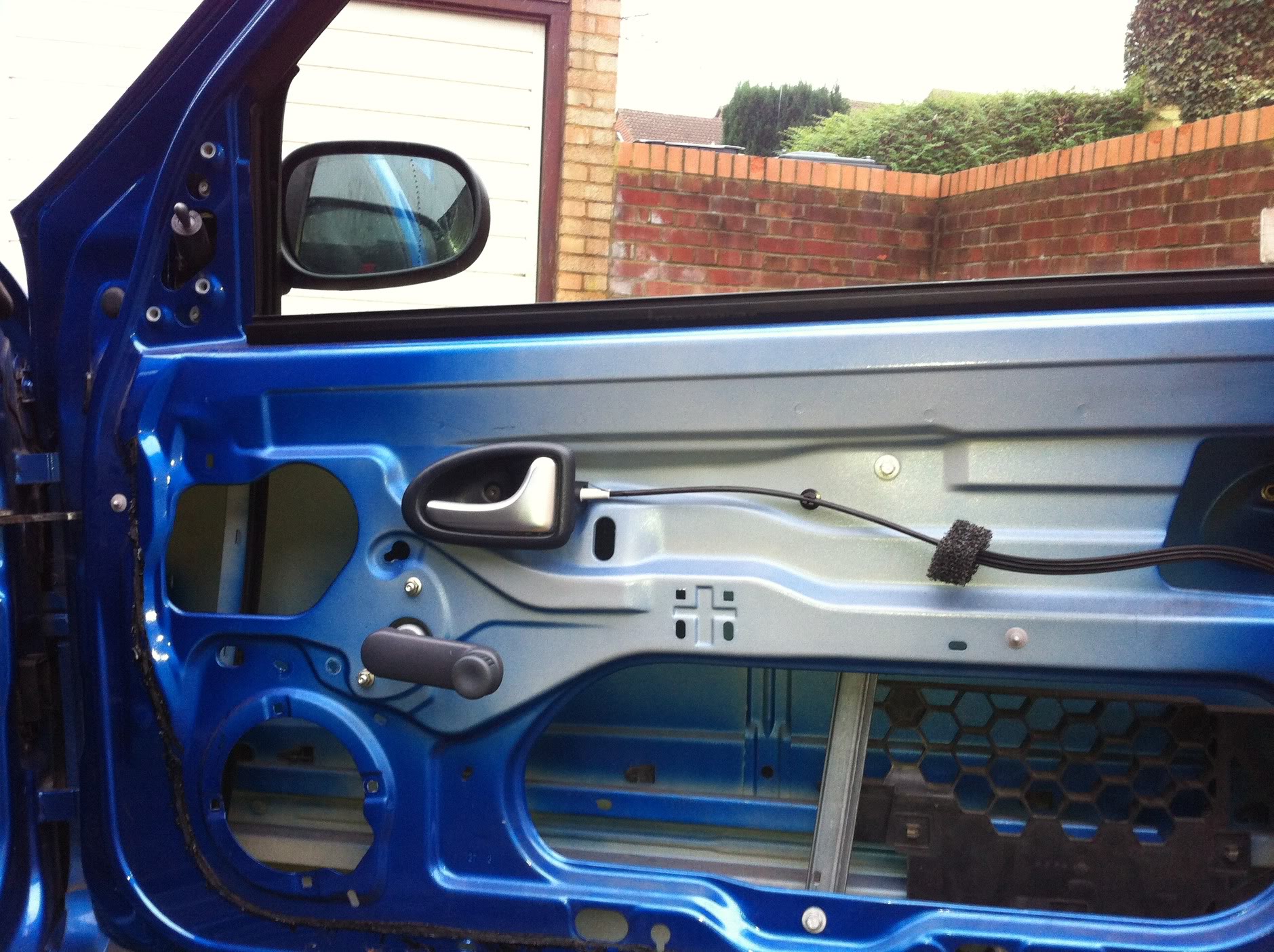

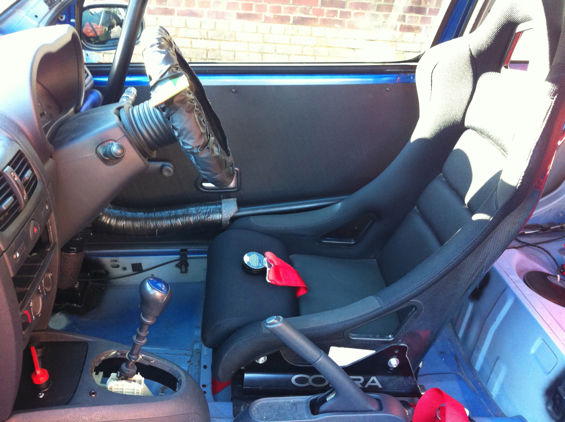

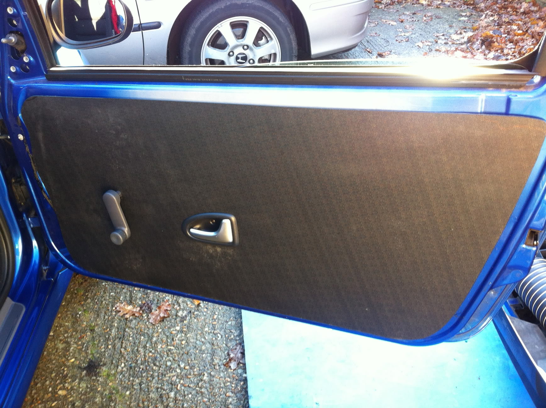

I've finally got round to sorting my doors out, I've replaced the windows and mirrors with manual ones now which has allowed me to remove more wiring, I've also made some door cards up and relocated the door handle so it's fits flush. Pretty pleased with it and it hasn't cost a penny which is always a bonus!
I've also finished of my battery relocation, I used a power master switch so that i can disconnect the battery every time the cars not in use, hopefully this will avoid any annoying flat battery moments!

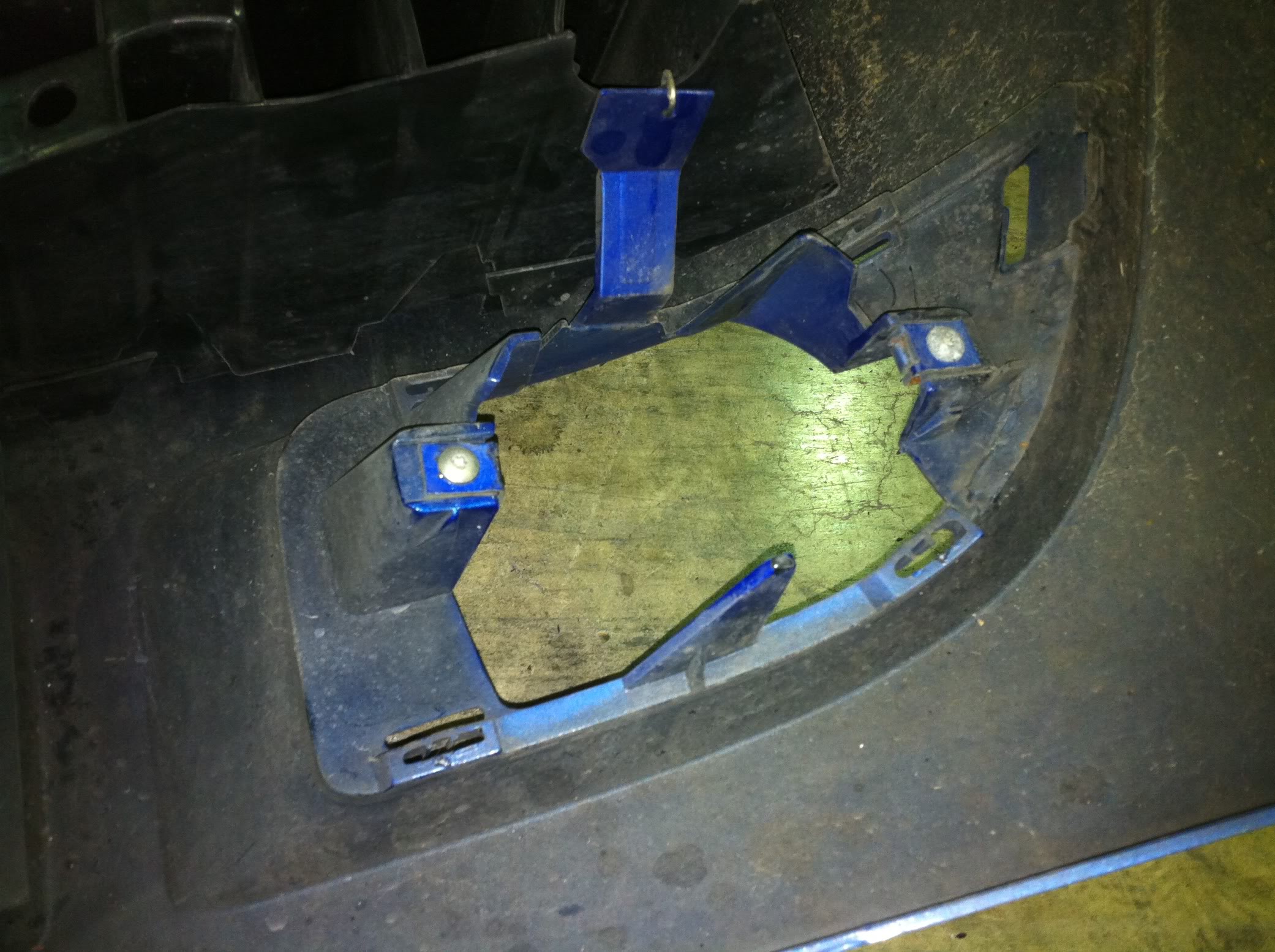

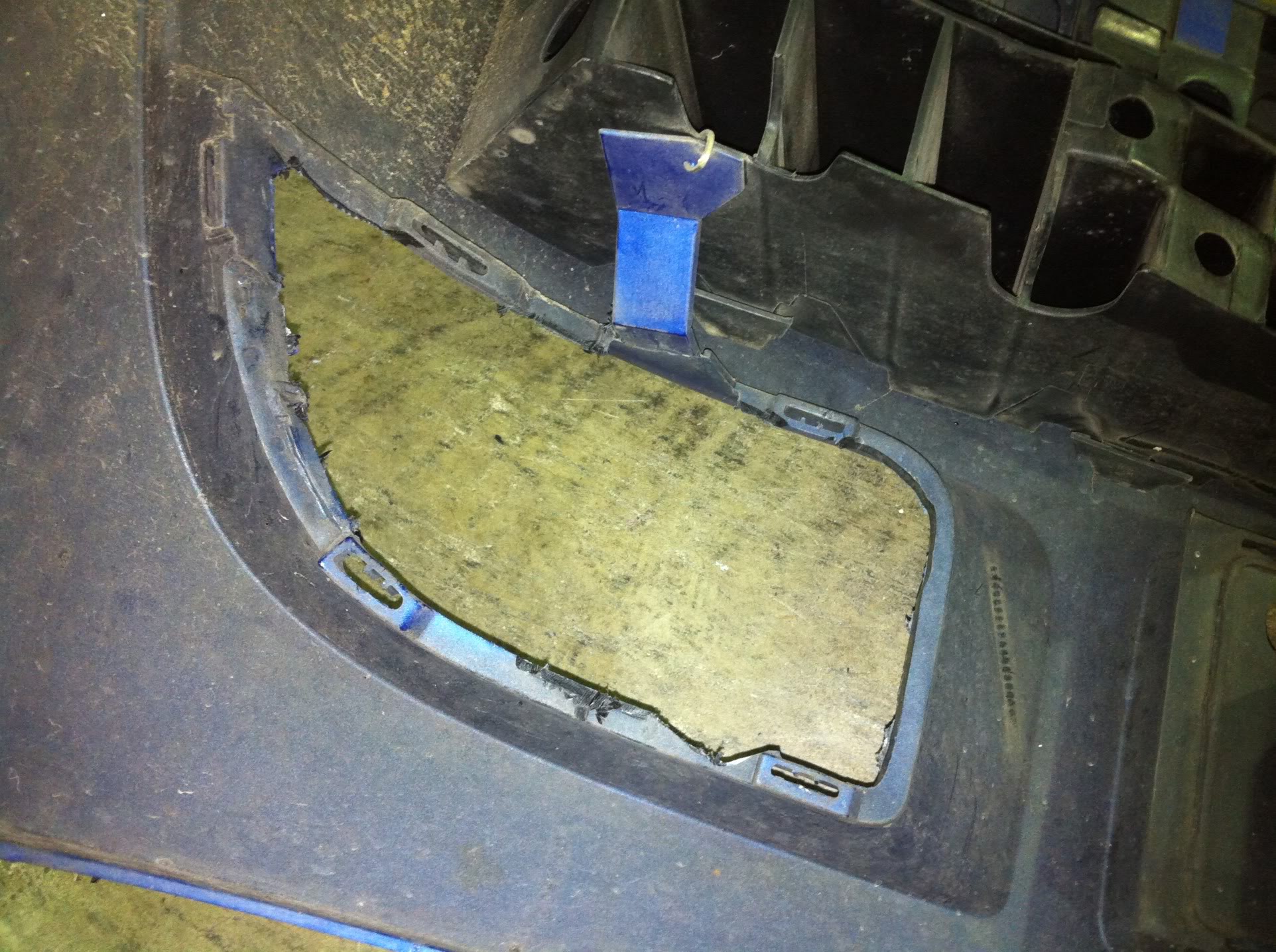

I really want to get the bumper back on now, this was removed for brake ducts, also gave me the chance to remove a few more bits and tidy everything up.
The brake ducts will hopefully be finished soon, as you can see i've removed a few bits of bumper around the foglight cut outs, just waiting for some ducts to arrive so i can attach them in place.

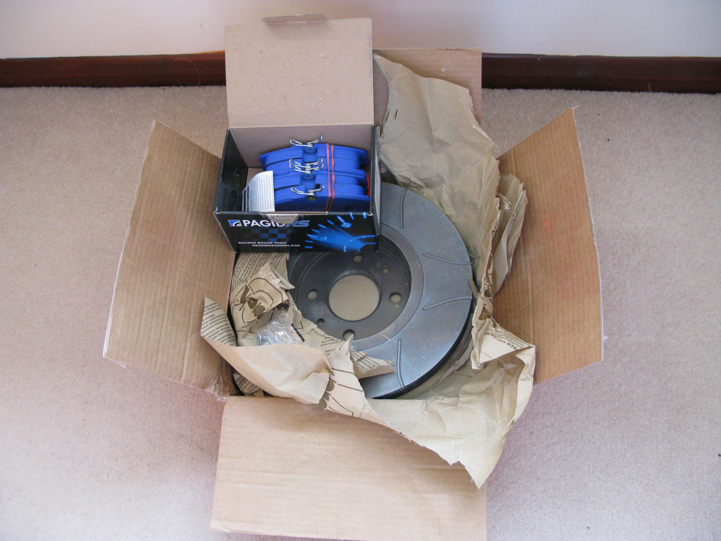

Before the cars back on the road I'm going to replace the brakes, they've lasted pretty well actually, I used pagid blue pads with brembo discs, mogul 660 fluid and hel lines, while i've always been a fan of these I have found myself wanting some more braking power at higher speeds so i've gone for a set of PF97's, I'm just hoping I like these pads as they're pretty pricey, just hoping they're not too ON/OFF as i've heard a few people say they can be pretty grabby, i guess only time will tell as brakes are quite a personal thing imo.

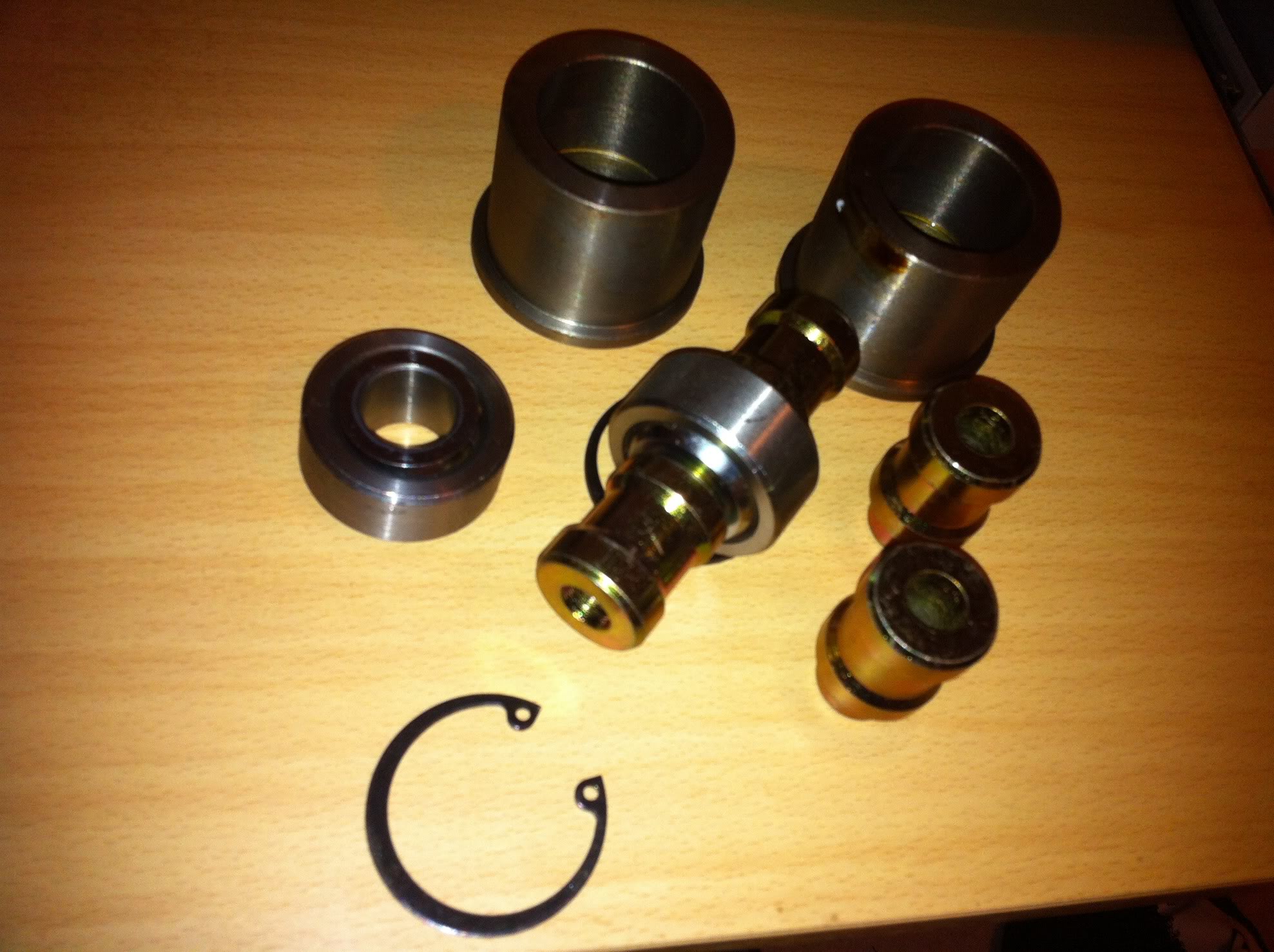

Thats all for the time being, next up will be the 'Pure motorsport' rear beam bearing kit as my bushes are pretty dead now, and then to fit all the new pads and discs and check everything else over to see how it's held up over the year of track days and ring use.

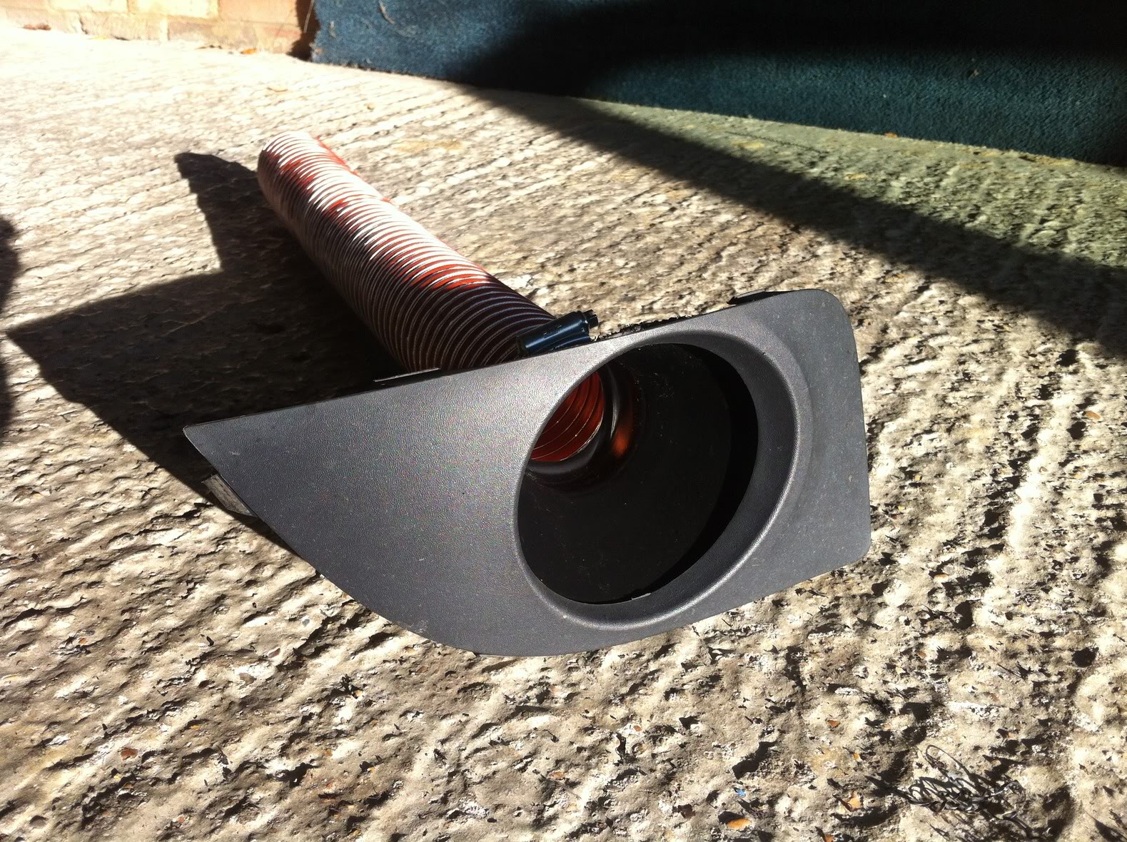

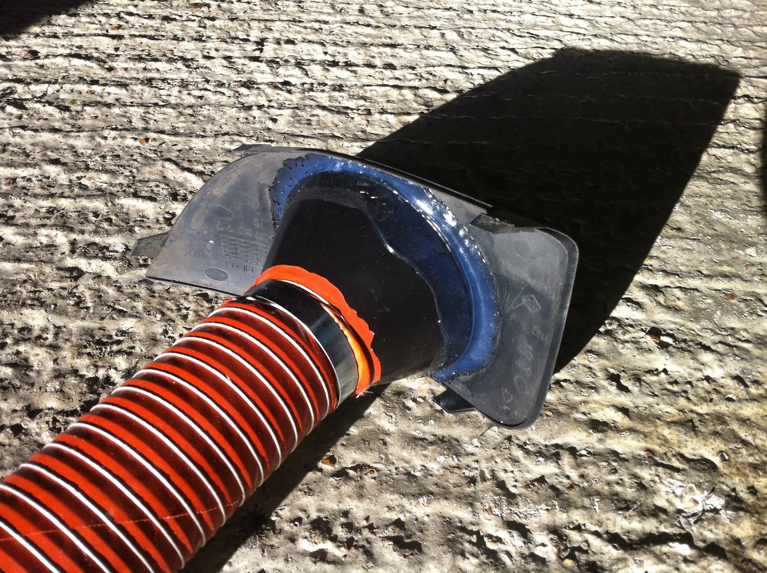

I've made up the brake ducts now, just a case of fitting my bumper, fitting the ducts in place and finding a way to direct the air onto the brakes. This is how they look so far.

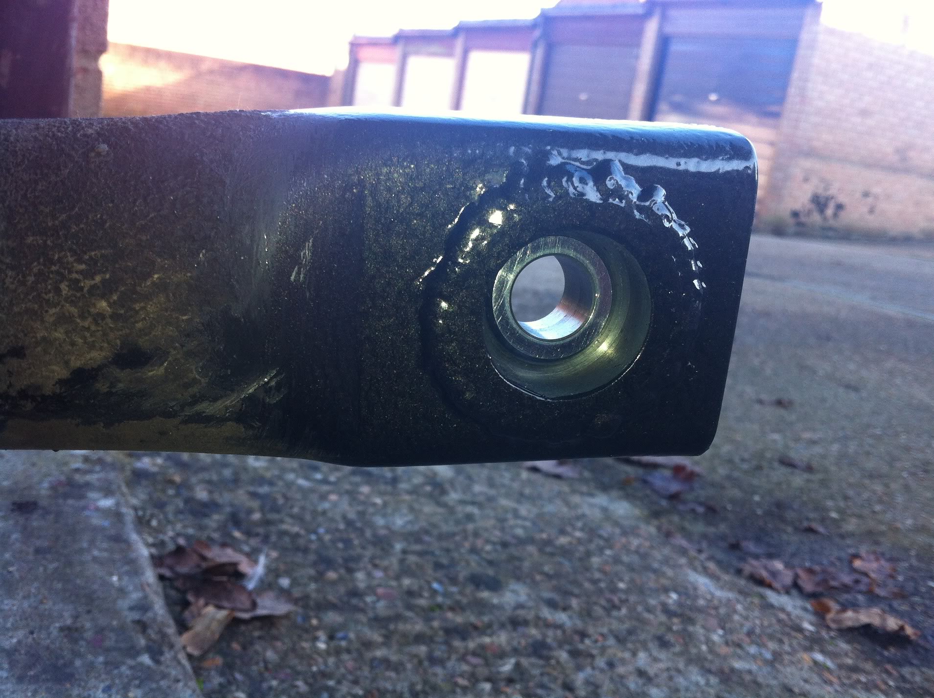

I've also had my rear beam bearing kit turn up this week so the next thing to do will be to strip the rear beam give it a good clean and possibly a bit of paint and fir the bearings.

What diameter is your brake ducting? I am wondering whether mine is too small looking at yours!

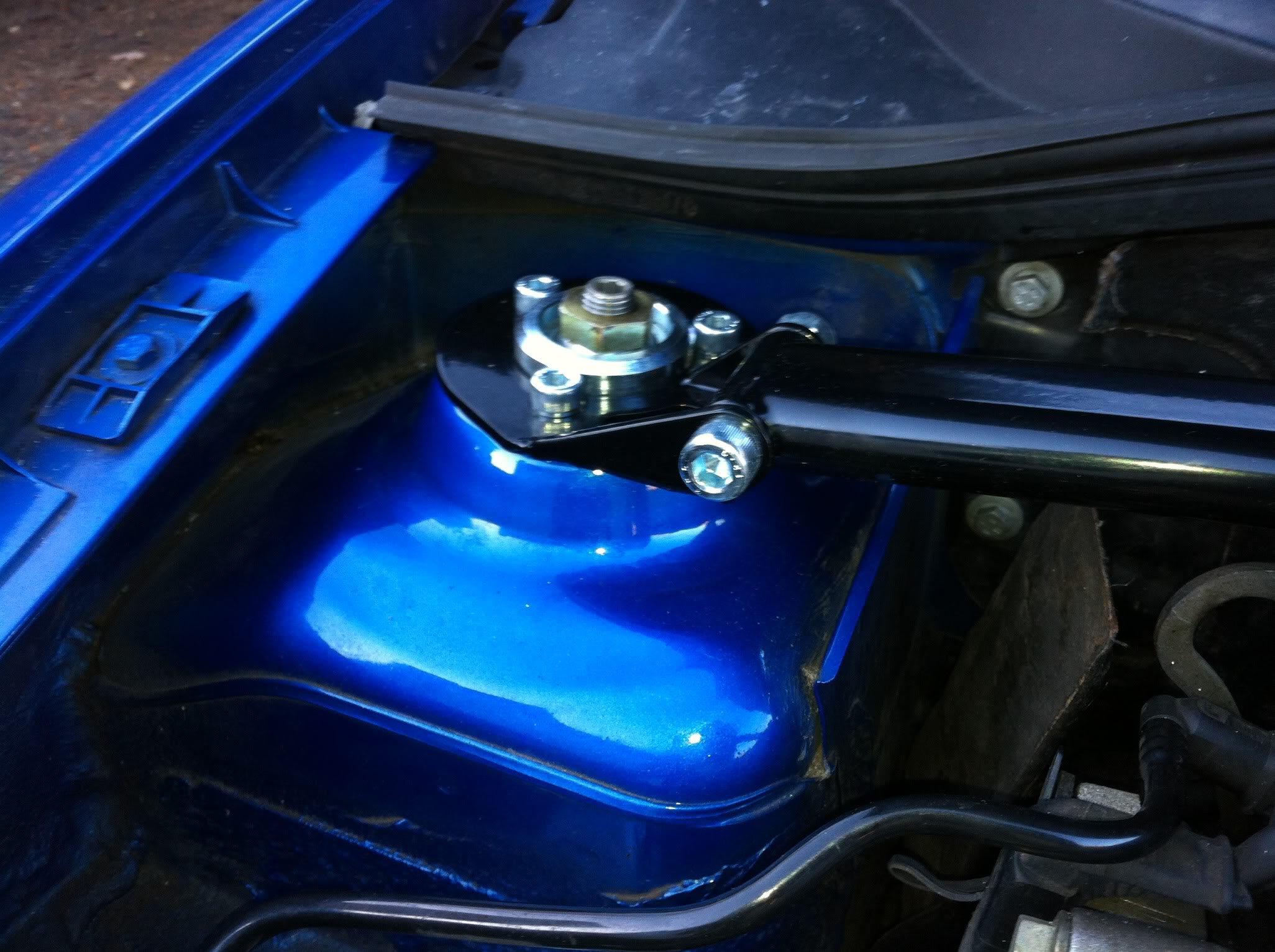

Just a quick update, not really done a hugh amount but as i want the clio back on the road in february I got a couple more bits done on the car, the first being the Pure-motorsport top mount and strut brace, fitting was very simple and I was pleased with the quality and fit of the combo.
Second job was to replace the rear beam bushes with the Pure-motorspot spherical bearing kit.
Again the quality and fit were very good, as i had to take the rear beam off in my garage i wasn't looking forward to putting it back on as i was very restricted to the amount of room i had but it went on perfectly with no alignment problems that i quite expected to come across.
Just got to get some discs and pads for the rear and bleed the brakes up and i can get it out the garage and give it a long over due clean.
