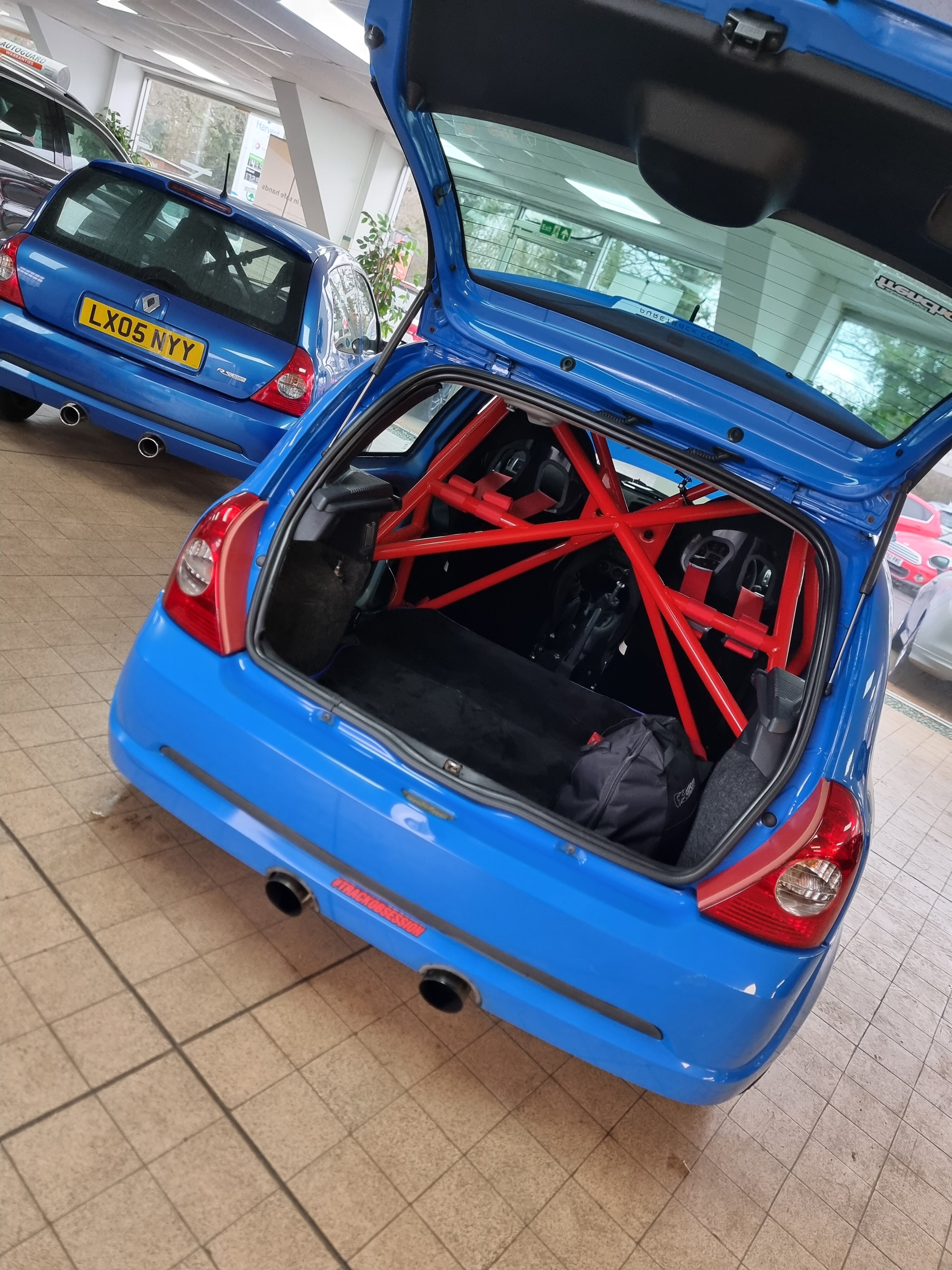

Speak to Fulcrum motorsport . Awesome cages and they can fit it for you.
