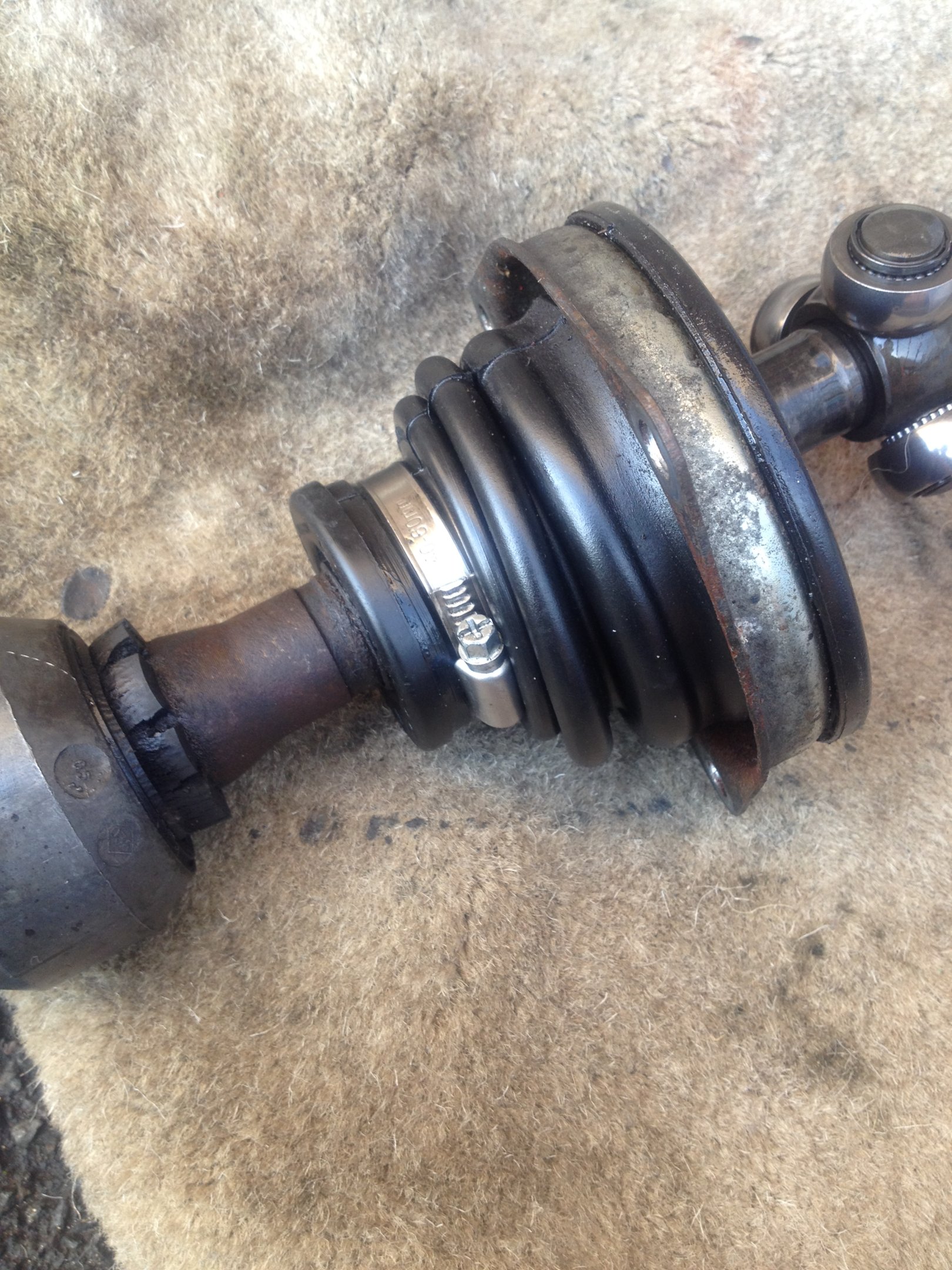

Removed my passenger side driveshaft as it was leaking gearbox oil from the inner gaiter area. I thought it was a split gaiter but once removed it was the gaiter that had been dislodged and clip come off to one side.
I have refitted the gaiter and jubilee clipped it on, will this be ok?
  RB Clio 182
It should be fine although im not sure if thats the side thats very close to the block so the jubilee may catch if its not the oem one.
mossyv6
  Trophy,V6,5GT,AG200
Thanks everybody.
I have put it all back together and put gearbox oil back in and so far so good :)
