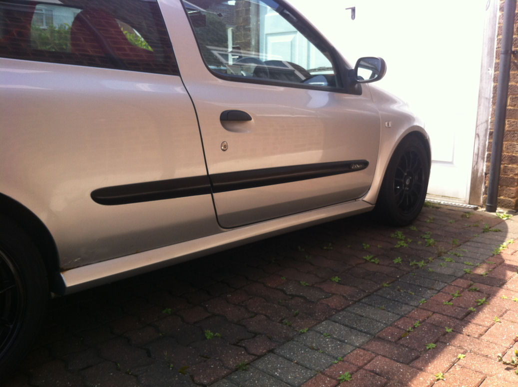

How to repair this ugly looking rust?
cjgower
Basically looks like the paints bubbled and then chipped away. Not sure what else can be done about something like this apart from an entire respray on that section / panel?
  Inferno 182
That's coming through from the inside buddy. Need to stop what's causing it or it'll just come back unfortunately.
  2014 Clio 200t edc
I saw a clio today with primer in the same place and though how odd it was, didn't expect them to rust for some reason.
I echo the above though, need to sort what's causing it.
  Inferno 182
Sometimes if you catch it really early you can get away with covering the bad area inside with a load of grease. Unfortunately yours is way beyond that stage :(
Daniel
  Whichever has fuel
I've had, f**k me, 100+ mk2 clios? I've never had one with a rusty shell. Ever.
As someone has said, they don't rust as they're galvanised.
Chances are it's had a new back wing at some point in it's life and it wasn't seated properly. Water is getting in and is eating it's way out.
Same when you see clios with rusty doors, chances are they've had new skins. (Which I'd never have on my own car, they always rust, I'd insist on a new door, but I'm going off topic now )
Gally
Hmmm it's actually easily fixable that.
Notice unlike most cars it's not coming round the wheel arch area, it's blistering from the body.
Personally, I think it's been painted as the paint chips a lot easier after it's been painted in most cases.
See the large chip are the bottom of the rust? That's thick paint and unormal looking.
With the proper prep ie Bilthamber products and a decent paint shop that won't come back. It may look bad but i've seen, estimated and fixed a lot of corrosion in my time and that's easy stuff.
As Daniel said, if that panel had never had work done it would never rust like that. I've see heavily stone rashed rear quarters on those cars and they don't budge.
Gally
Oh and you need decent tyres.
One way to check if it has had a quarter panel. Open the tailgate and compare the sealer where the strut is on both sides. The factory clio sealer can never be replicated perfectly, it's a big thick flat bead from top to tail-lamp.
  RenaultSport 172

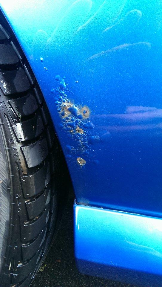

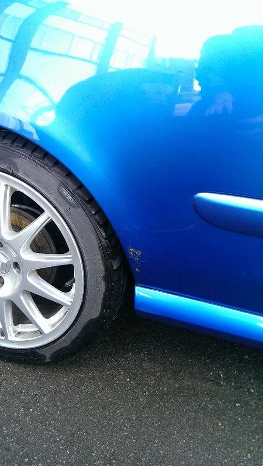

My ph1 is rusting quite bad and the paint has all bubbled up. It looks awful. Not sure if I can be bothered to pay out for a fix as the car is worth so little. I also have a bit of rust under the fuel filler cap
How much does it cost to fix this? (Not the best photo)

Went and got a quote today from a bodyshop i've used before, told me it would be about £370 and that was including fixing a few other parts including a scuff on the bumper and front wing.
Everyone on here was right though. They confirmed it has been sprayed before
MrBlonde
I Have this on my cup on both sides,very small tho,about the size of a pea!.i think i will have ago doing it myself as its very small and ive had a look and its just where crap has got in it from behind,so can grind it out and treat it and while im at it will waxoyl it to.Just need to get a can of mondial paint made up.

Probably had some repair work done already although they do rust there. Need to take it right back. Should be looking at no more than £350 if you want it to last.
