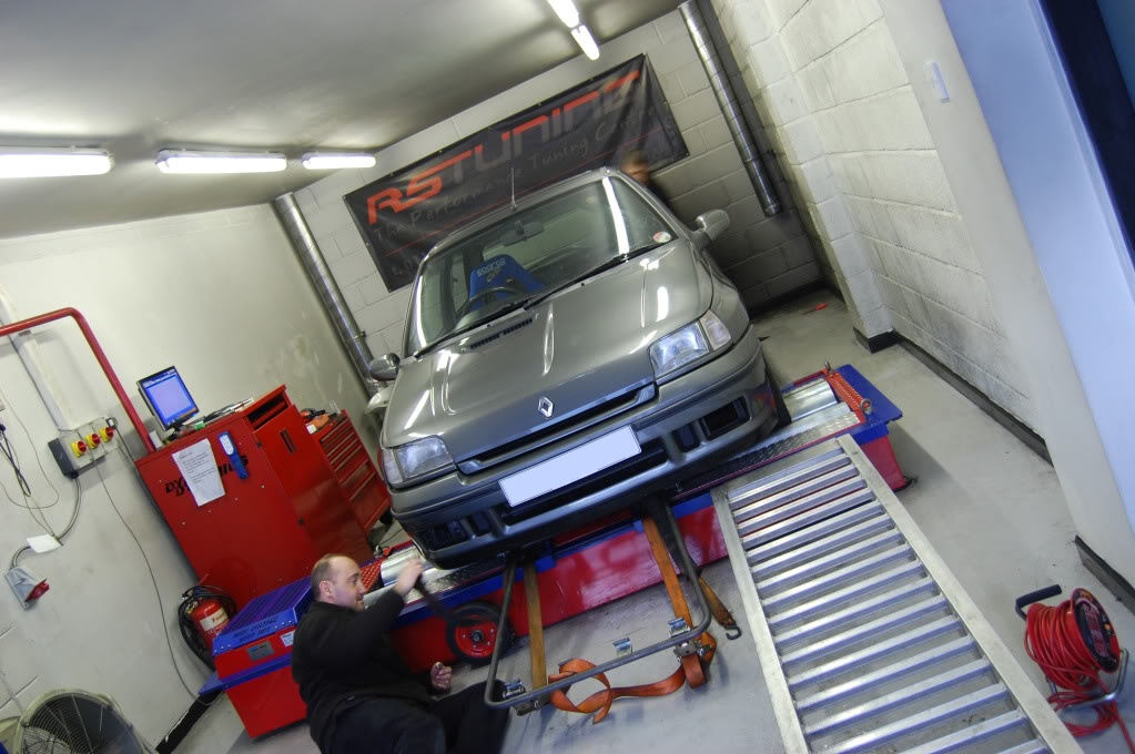

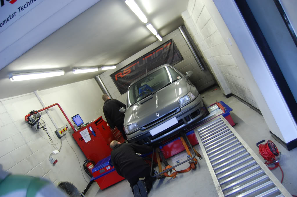

Poor result from the hybrid today on the dyno, but glad I did it as I know know there is a serious problem with it.
Took the drive upto Paul @ RS Tuning in Leeds, to see what power the hybrid was running...engine spec is: Megane F7R 2.0 Bottom End, Valver Head...Running Williams ECU. I was told the williams ECU was chipped to allow the spec of the engine to run, but its seems not to be the case.

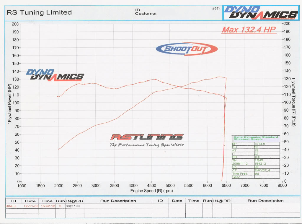

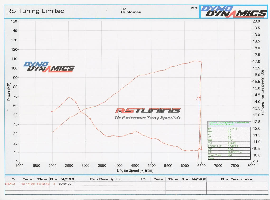

For people that know graphs, you can probably see whats going wrong. Paul explained to me it was massively overfuelling, due to the valver head having smaller valves than a williams head, and the williams ECU was putting too much fuel in, obviously never been set up properly for the engine.
Massive overfuelling resulted in s**te power output :dapprove: Hybrids of the same specification were running around 160bhp at the rolling road day there just two days ago, so its safe to say im 30bhp down :(

I wouldn't call this a poor performance, 130 bhp is still ok. Sounds like it just needs a proper live mapping session. Im sure paul could sort you out with a custom map as aposed to going down the expensive standalone route.

Looking at the vid again you can see its over fueling abit from the smoke.

Did i read in your prooject thread that the lambda was a bit fooked so you cleaned it?
When my valver was overfueling it was all down to a lambda sensor. Bought a brand new NGK one (was a quality part) for 50 quid or so. The instructions that came with it advised not to get any contaminents at all on the sensor and avoid touching it iirc.
What I'm trying to say is, perhaps you need a new lambda. Although the theory behind the small port overfuel is sound. :)
yeah, i thought about that, and yeah it was in the project thread
it could be a partially both being messed up, but after opening the ECU is looks like its never been touched, 100% boggo williams ecu, so it wouldnt be running right anyway
