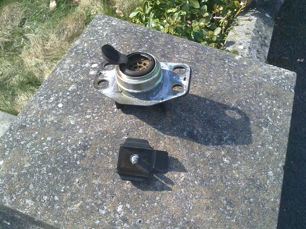

I was getting knocking from the front end while pulling away........
  Impreza RB5 #054

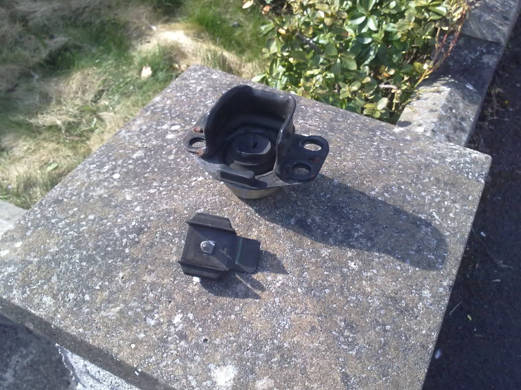

Think this might of caused it? lol
When i changed it, i stuck a trolley jack under the engine to support the engine and when undoing the bolts the engine didnt move, but while fitting the new one i had to jack the engine up a good 3-4"!
Poor fucker had been sagging like a b**ch!
  Impreza RB5 #054
I've powerflex'd the dogbone mount now anyway, From what i can work out, the dog mount goes first and if its left it will take everything else with it.
  Stripped yozza'd cup
The dogbone mount makes a huge difference on it's own anyway. My knocking has completely stopped since I fitted mine. The single best (within reason) modification.
  Impreza RB5 #054
Gotta agree! For the sake of 30 odd quid

I need some help... bit of a novice. i have the same knocking in 1st and 2nd on my 172 and i have asked ten people and had 10 answers on whats causing it.... what do you guys think?
davo172
  TCR'd 172
Dogbone mount !
