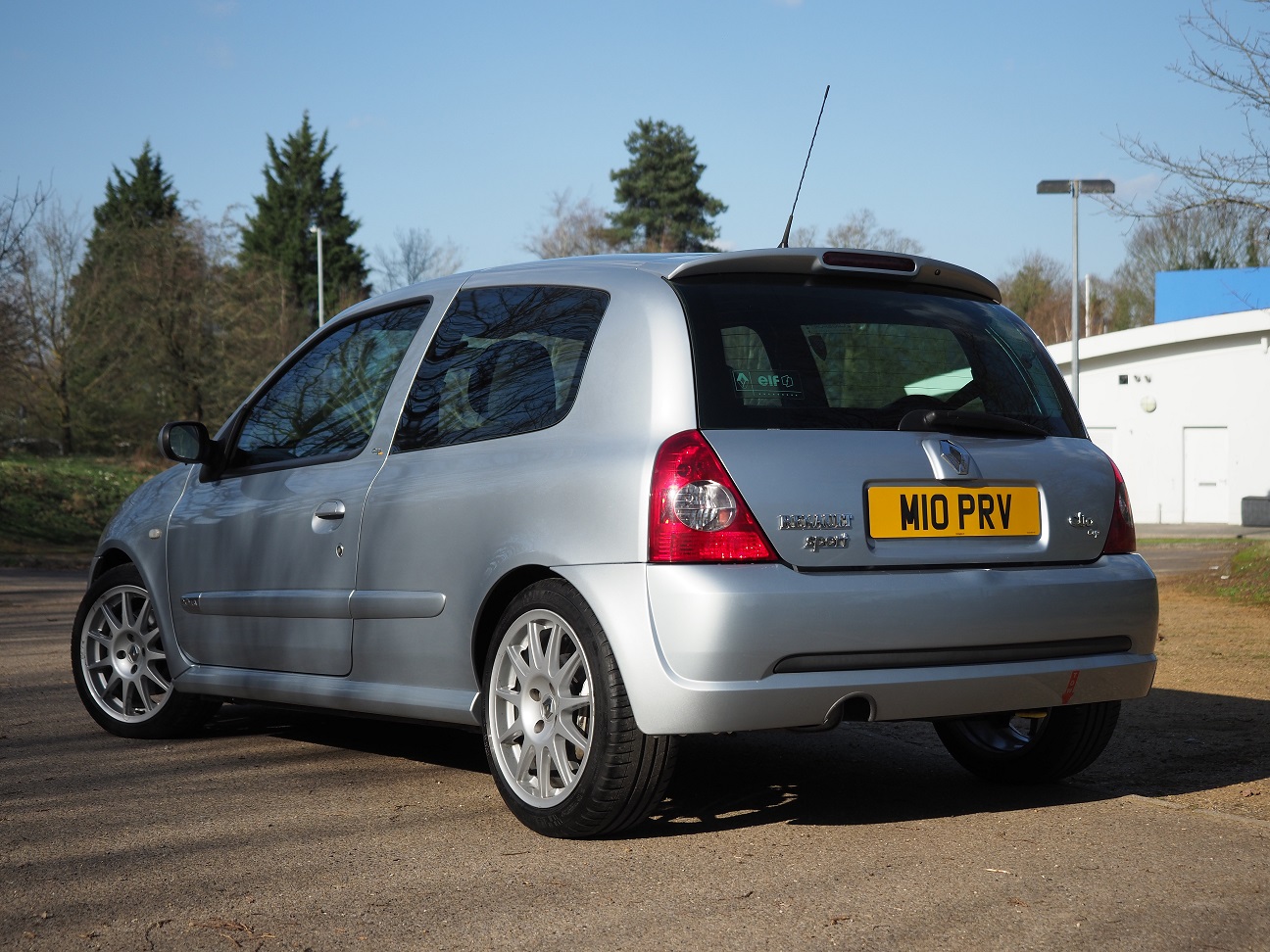

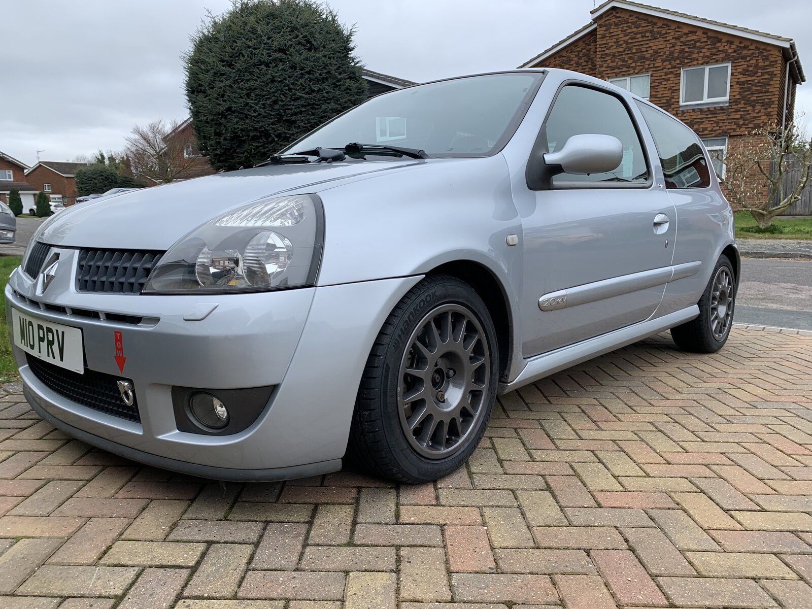

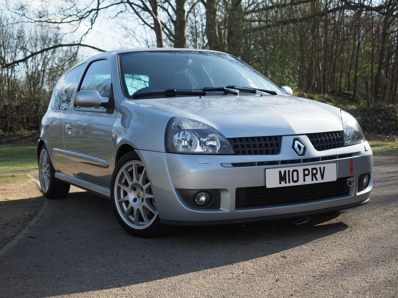

The car was already in great shape but as the weather has been so good, it was time to get the wheels off, check everything is in order and give it a good clean. My only worry now is that this one is too good to be competing with and I should get myself another ...
Anyway, enough chat for now and here's a few pictures from this weekend's efforts.

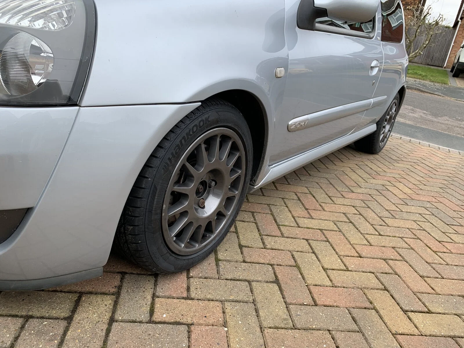

Good point about the wheels, maybe I need to consider other options.

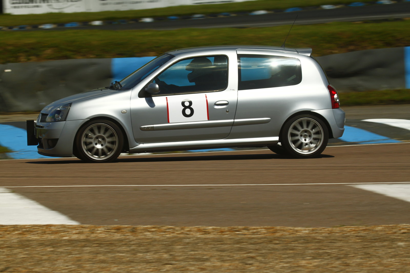

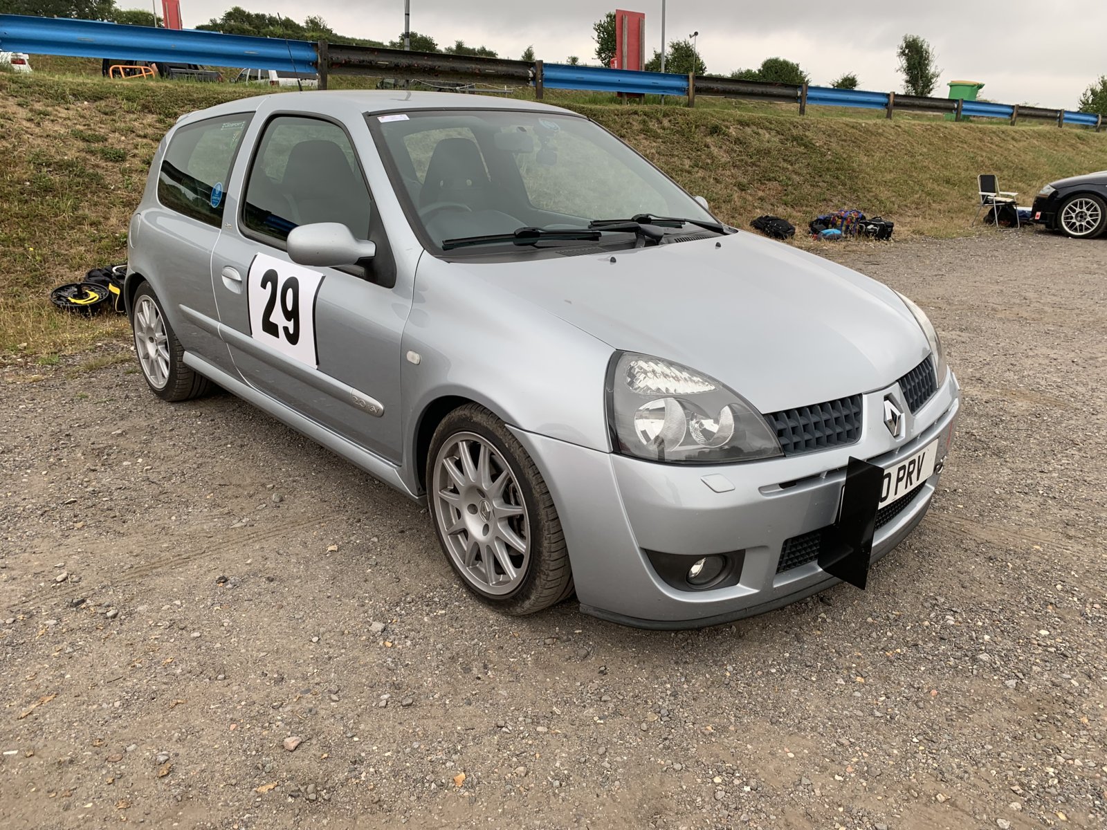

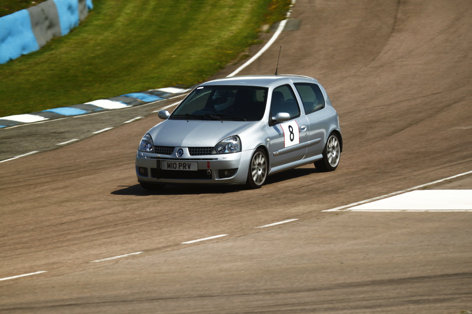

It's been a while but today I finally particpated in my first sprint down at Lydden Hill. Unfortunately I was a bit pre-occupied to take many pictures but I do have some in car footage that I'll upload and share later.
The day was full of firsts; first sprint event, first time on a track in a fwd car, first time at Lydden Hill, first time driving the Clio really hard, nothing like piling on the pressure. Anyway, I achieved my objective of not coming last in my class and the car felt great. Obviously a lot to learn and get familiar with the car, but the biggest challenge was judging how hard I could brake and I had quite a big lock up on one run.
Now starting to look at which event next, I have an option to return to Lydden Hill next month but may visit North Weald first as that is much more forgiving and it'll be safer to see how far I can push it without tyre barriers !

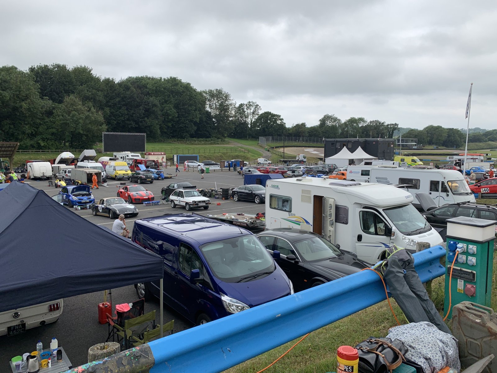

That was a better day, getting more familar with the car so managed to shave about 1s of the lap time on each timed run. Started at 99s, finished on 95s.
Better news is that the class leader posted the same time for the last two visits to Lydden Hill at 90 sec ish. So last time I was 8s off the pace, yesterday it was only 5s.

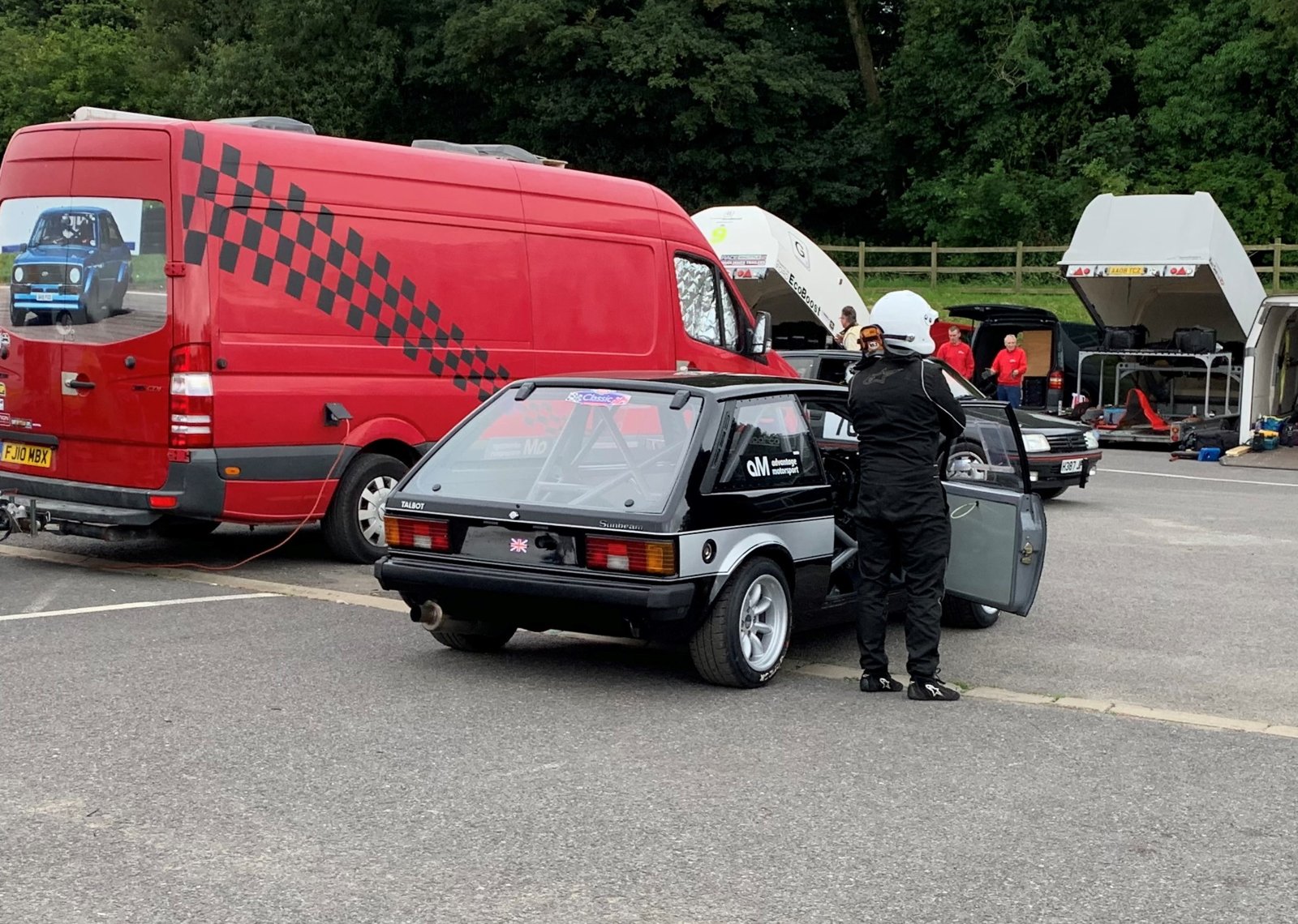

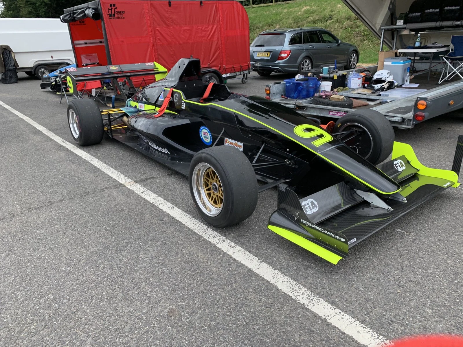

Also, some fantastic kit being given the beans round the track so thank goodness there's a class hierarchy :cool:
The chap with the 911GT2, also has a Ferrari 458 and a 911GT3RS, drives them like he stole them and is well into his 80s o_O
Oooh, Lotus Sunbeam. I'm sorry but I'd sell the Clio for one of these ....

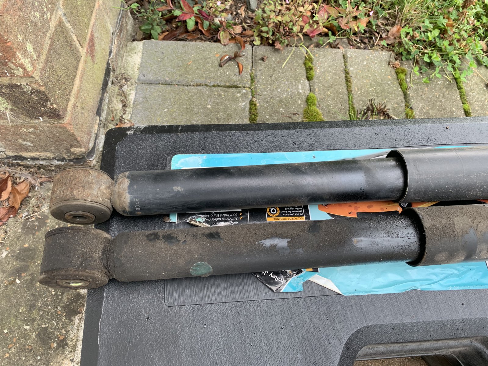

Last time out, cornering left & right definitely felt a bit different but as the car on track is still quite new to me I wasn't sure if it was real or just in my head :unsure:

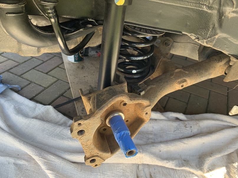

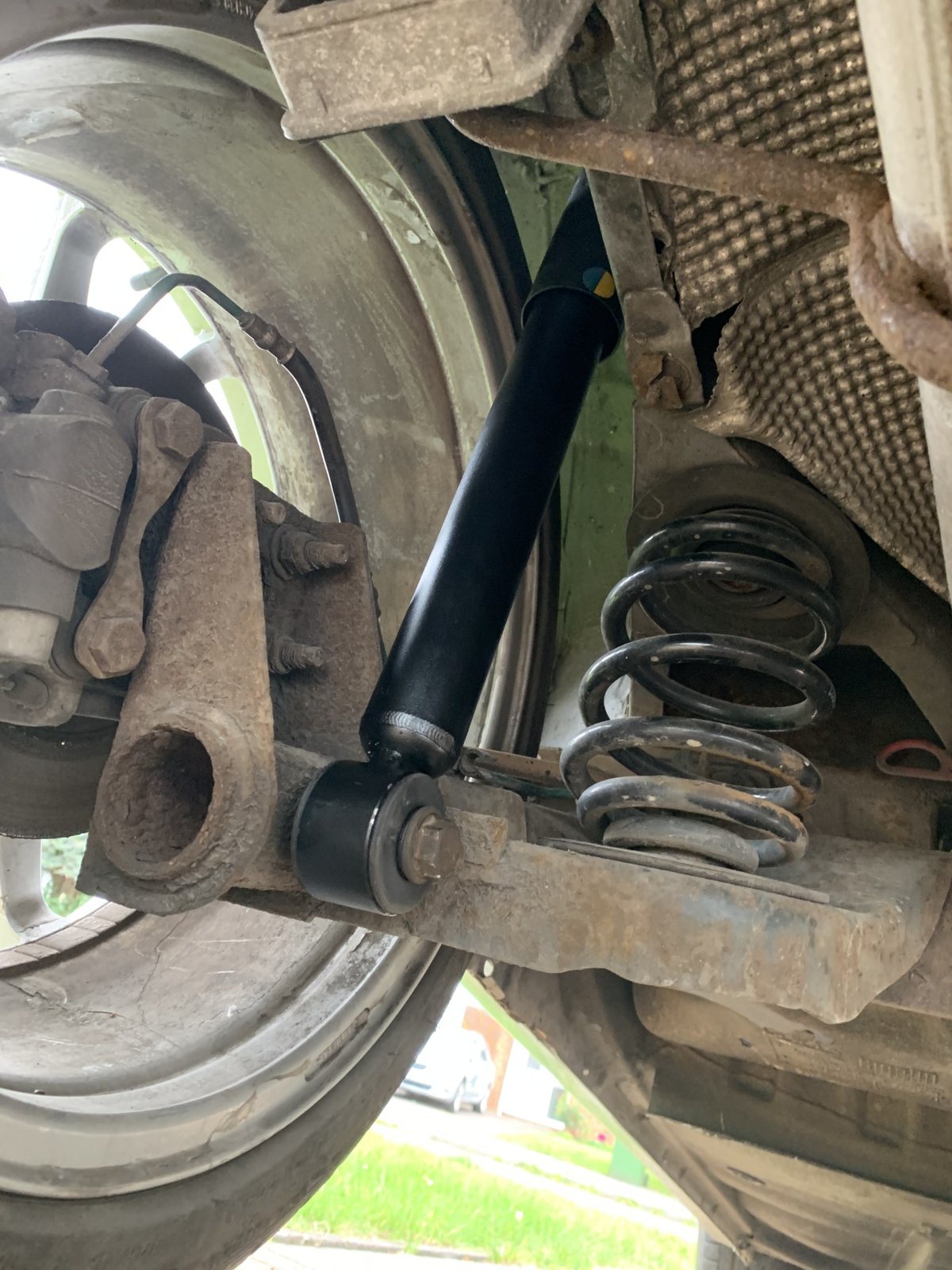

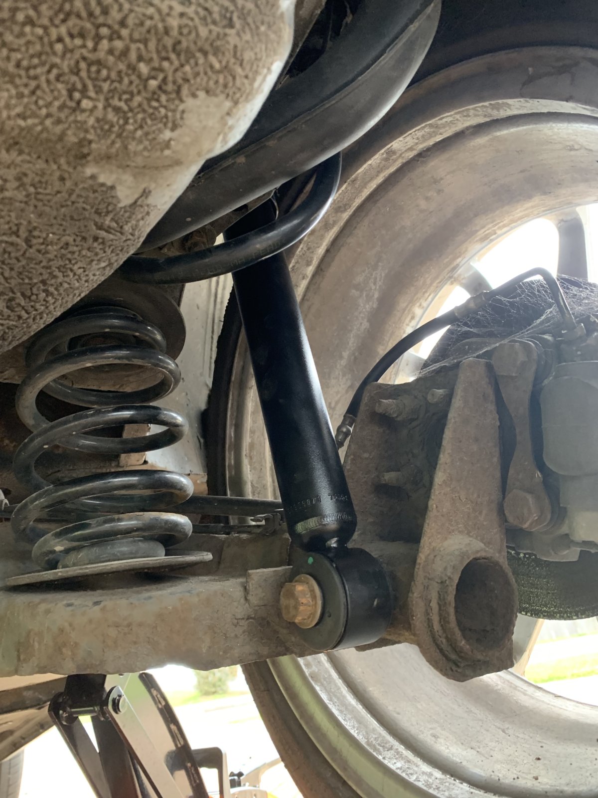

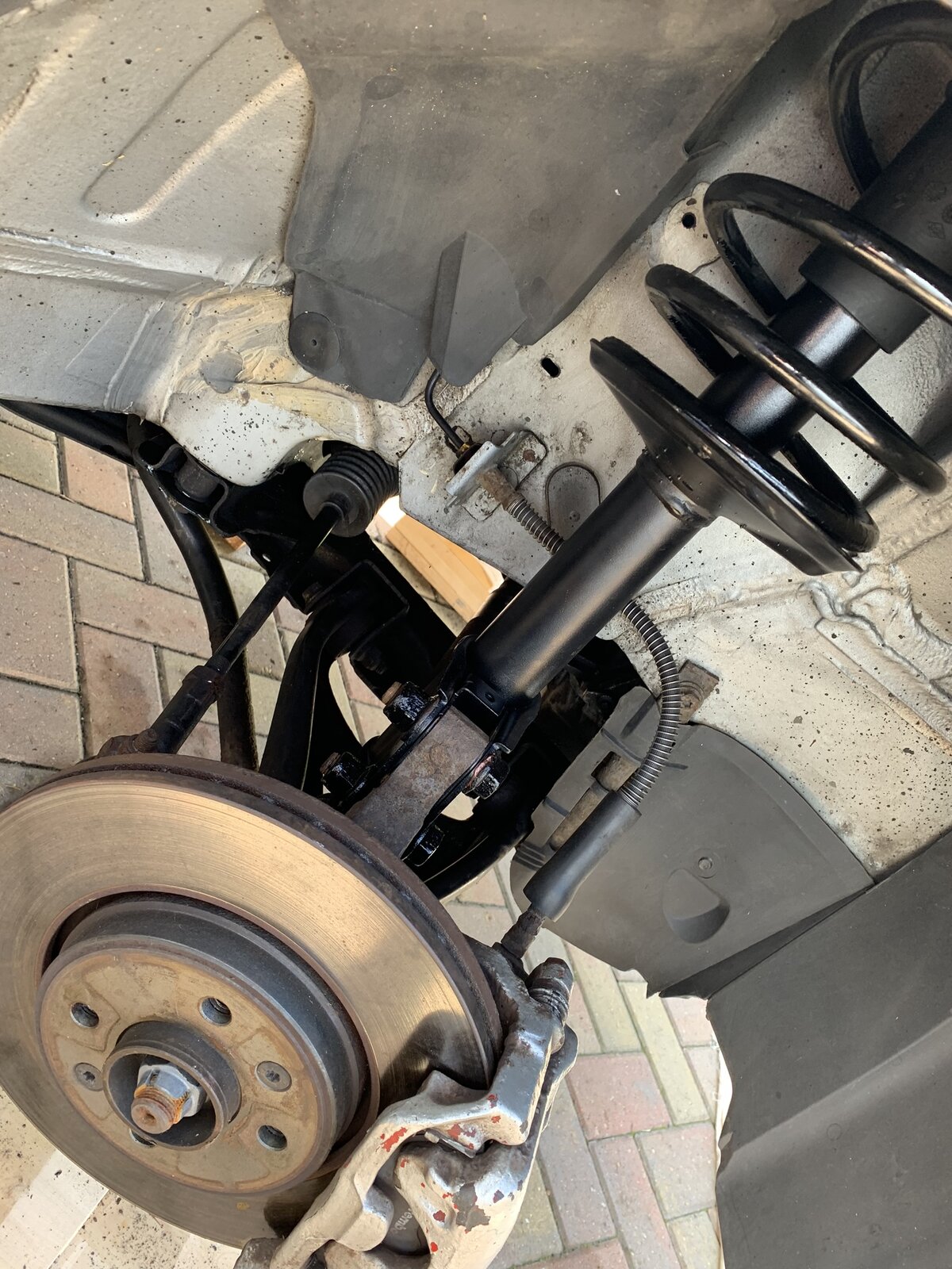

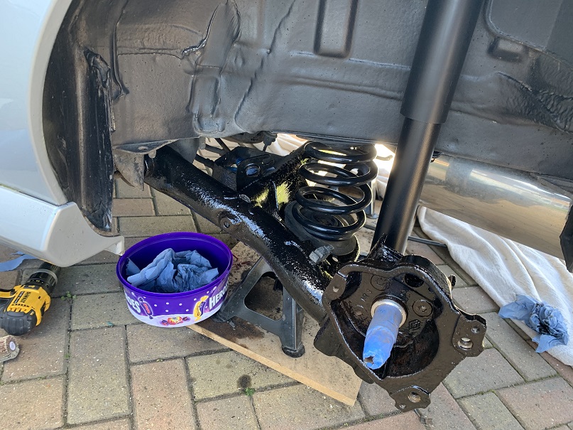

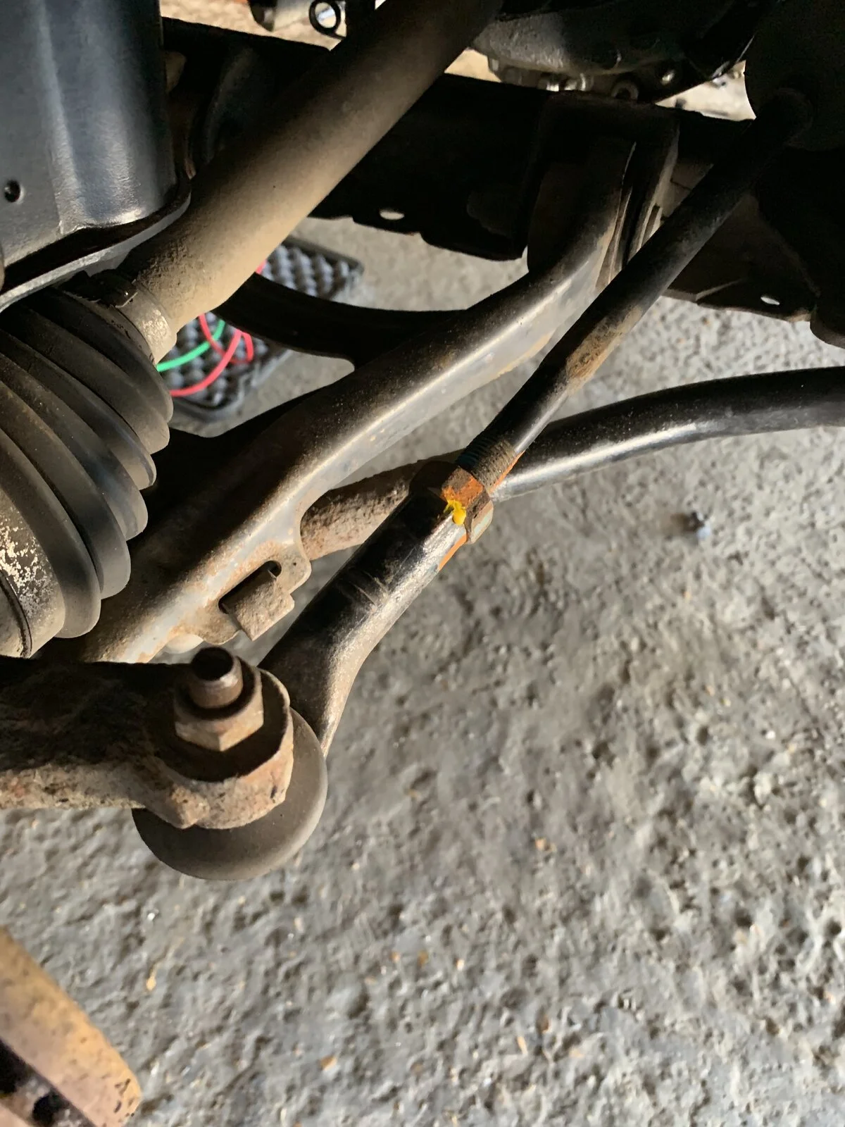

So, time to take off all the wheels and have a good look around. The nearside rear shock looked beyond it's best, so time for some TLC. I'm quite happy with engines and even gearboxes, but never touched suspension before. I was pleasantly surprised how easy it was to swap out the read shocks.
For good measure and to make sure I have a good known start point, I'll be swapping out the fronts too as soon as the weather allows.
Can you guess which one is knackered?
The next problem is that having nice new shocks wants me want to clean up the rear beam, hubs etc etc. Does the list of stuff to do ever end :oops:

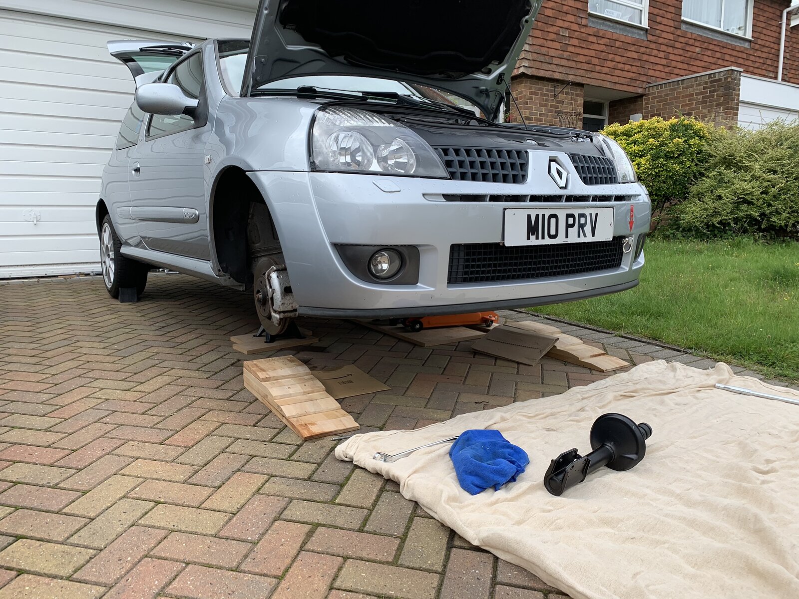

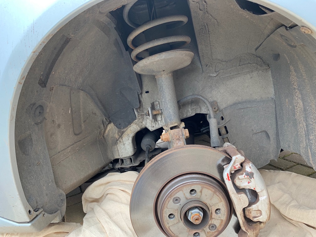

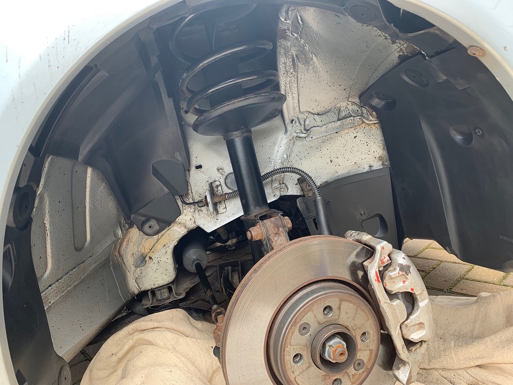

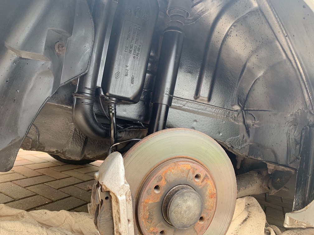

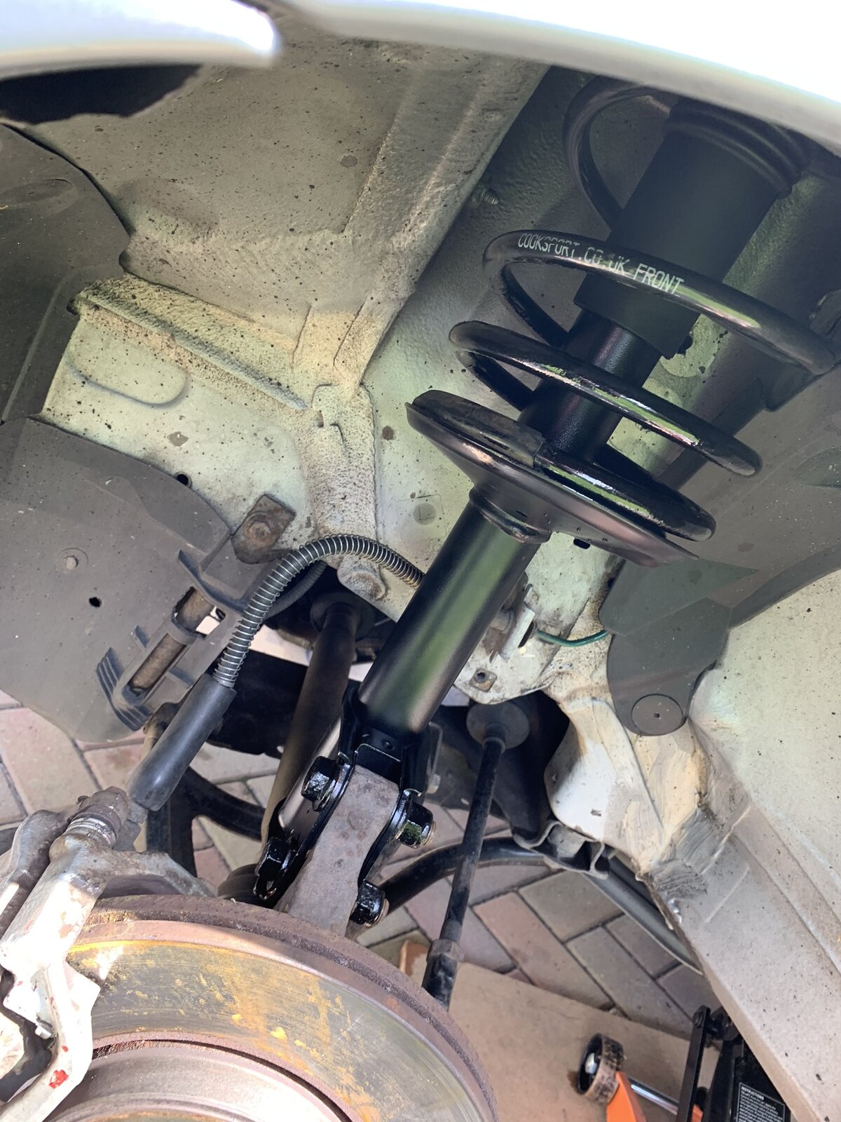

Encouraged by the straight forward job of changing the rears, I thought I'd now tackle the fronts using the excellent thread in the guides section ( https://www.cliosport.net/threads/g...n-suspension-struts-springs-with-pics.319663/ )
Fairly easy, the only challenging bit it trying to align the hub to damper, getting the bolt holes to line up, supporting the hub and slotting everything into place at the same time. I could have done with a couple of extra arms :D
New disks and refurbished calipers will follow soon, so I'll clean up and paint hubs at that time.

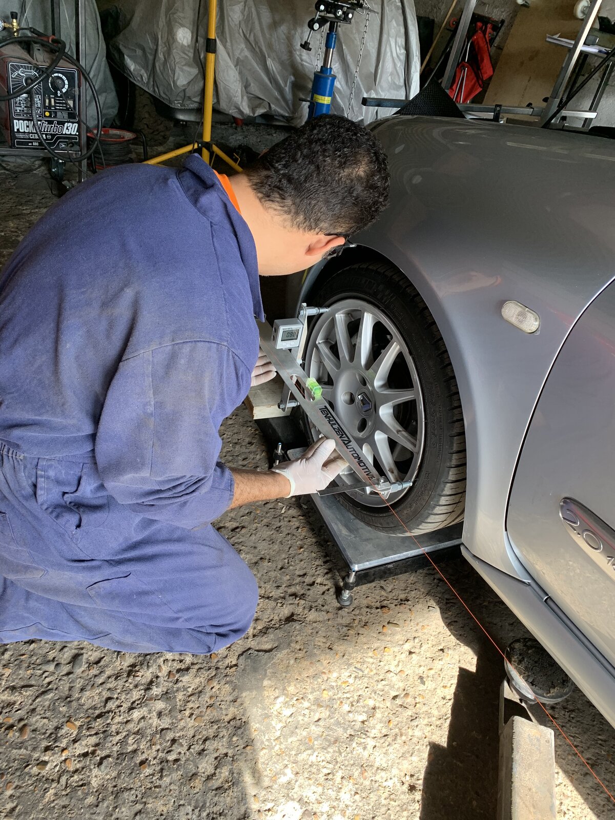

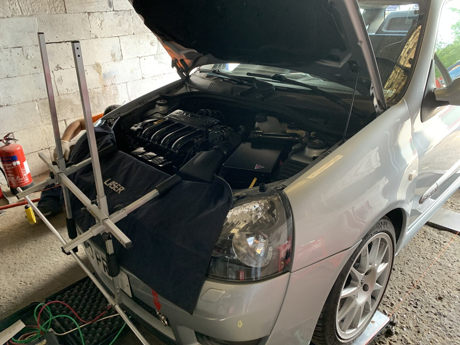

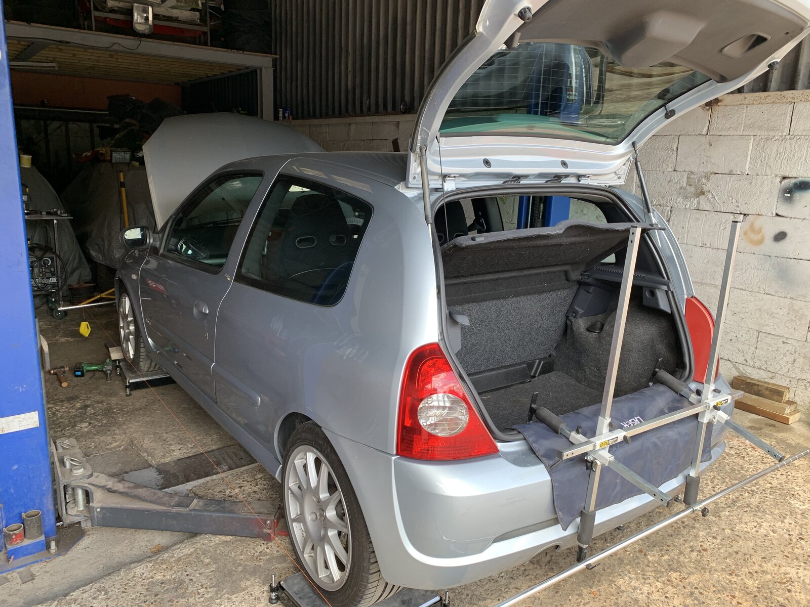

Despite my apparent success at swapping dampers, I wanted it checked over, everything measured and aligned.
As it happens one of the CS traders, Yaser ( @almaghrbi ) of Kent Motorsport is just around the corner so I spent an enjoyable morning watching him give it all the once over. It was great to be able to hang around, take some pics and ask a bunch of dumb questions whilst is was done old school with time and patience. I have a much better understanding of the measurements and how they interact with one another now. Apart from way too much toe in on the front, it was all pretty good.
Even got the car weighed - 1020kg :cool:
With new dampers and now the alignment done, it certainly feels better and the rear doesn't crash about so much so I'd certainly recommend Yaser if you need your suspension setup.

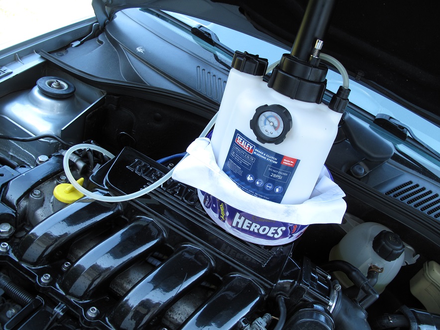

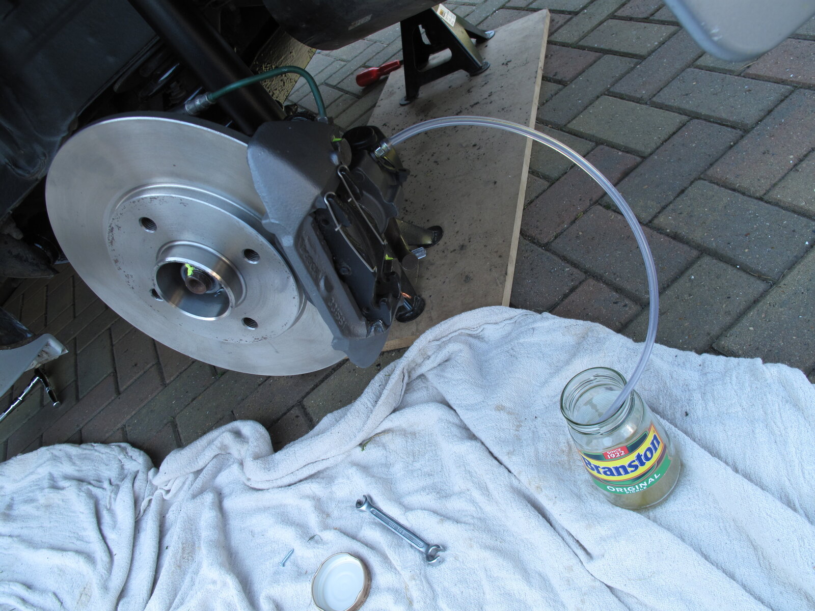

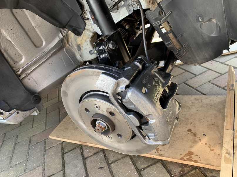

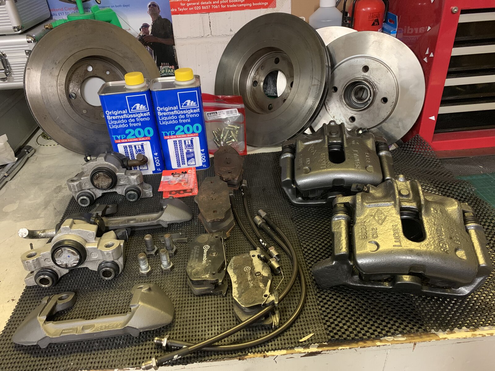

Contemplating and building enthusiasm to replace my old discs and crusty calipers with this lot. Thinking about the best way to go about it given I don't have access to a lift.
I'm thinking of swapping the calipers over and a rough bleed corner by corner starting with the rear and once it's all done, then do a full fluid change. Also, probably days before I even start, I'll remove each wheel and check all the bolts are going to undo without a fight. Sods law says it'll be the last one that would otherwise put up a fight and I'd end up with 3 of 4 done.
Any views on effectiveness of the various ezibleed/sealy bleed kits?

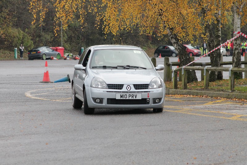

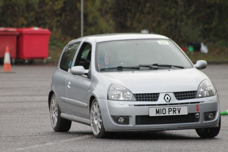

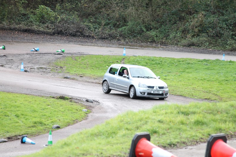

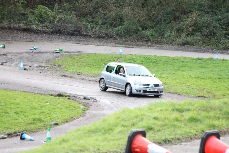

As far as the motorsports goes, I had a fun time at the Sevenoaks & District Motor Clubs annual Autosolo events in the last couple of months managing a 3rd in class. These events are not too serious but great fun where hooing around the Brands Hatch paddock car park/rally stage doing handbrake turns is actually encouraged. I discovered that pumping up the rears to a million PSI helps to loosen up the back on a damp surface :cool: I've added a few picture below.

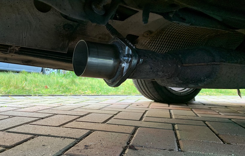

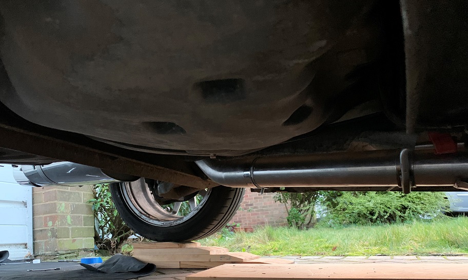

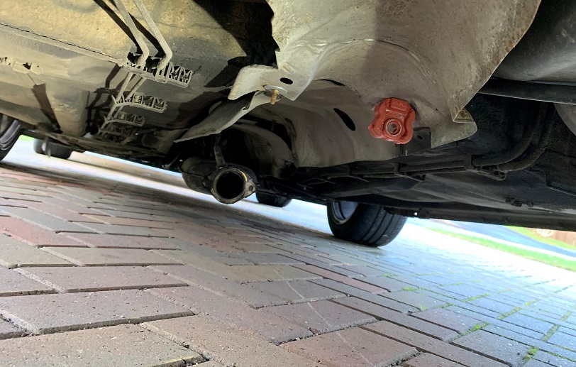

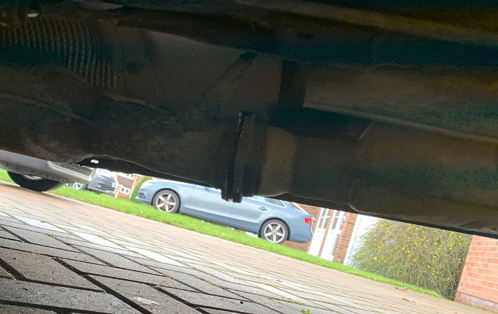

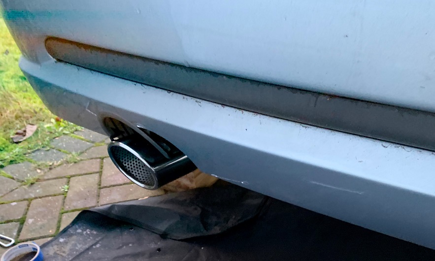

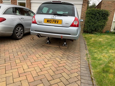

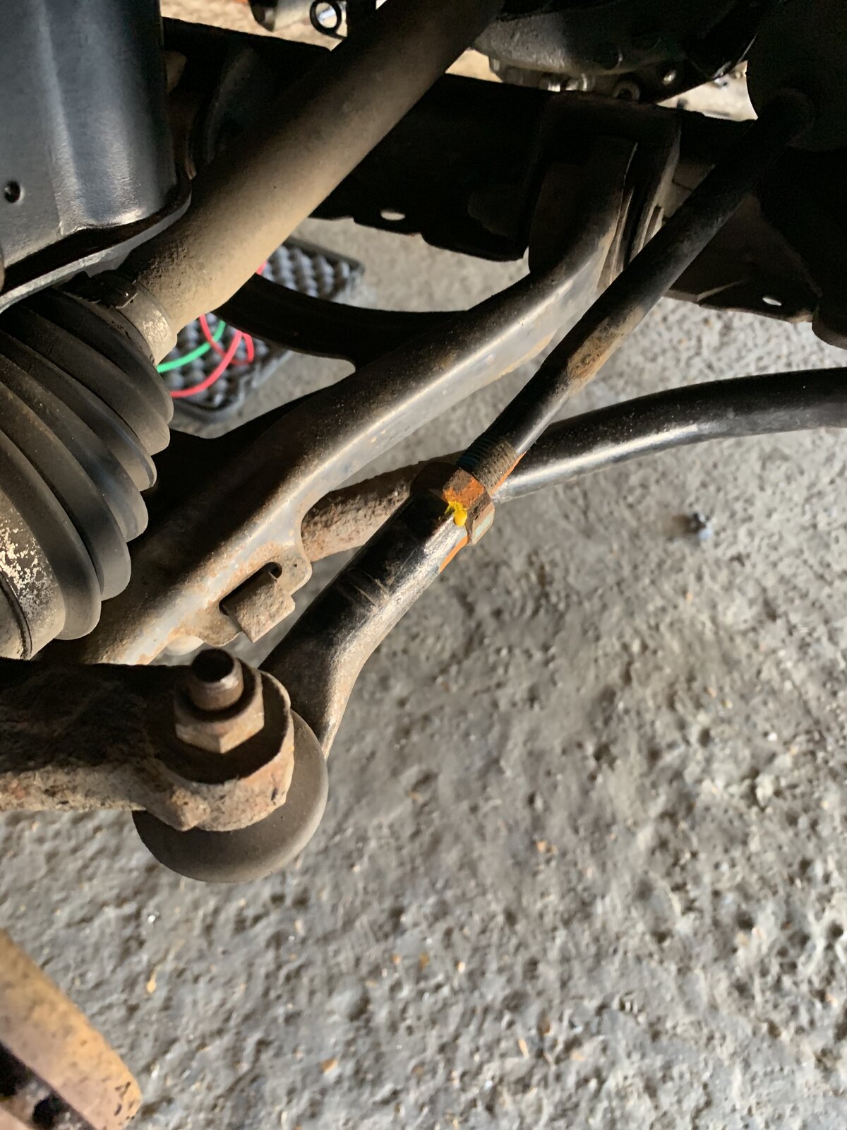

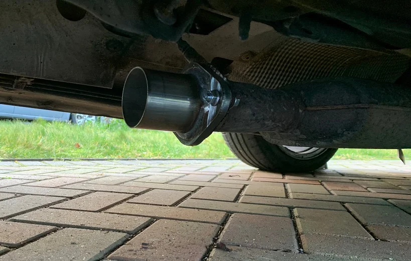

Quick update: as the exhaust arrived earlier than expected, there was a break in the rain and in best Clarkson under estimation I thought "how hard can it be?" I decided to crack on and get it changed.
The first thing that became clear immediately was one of the sources of the blow and where that rusty nut I found on my driveway had come from :oops:
Secondly, given my bumper has been cut previously, I decided for a straight out tail pipe (I have another uncut bumper if/when I want to go completely standard but finding a new original exhaust has been impossible). My thinking was that it'll surely line up :rolleyes:

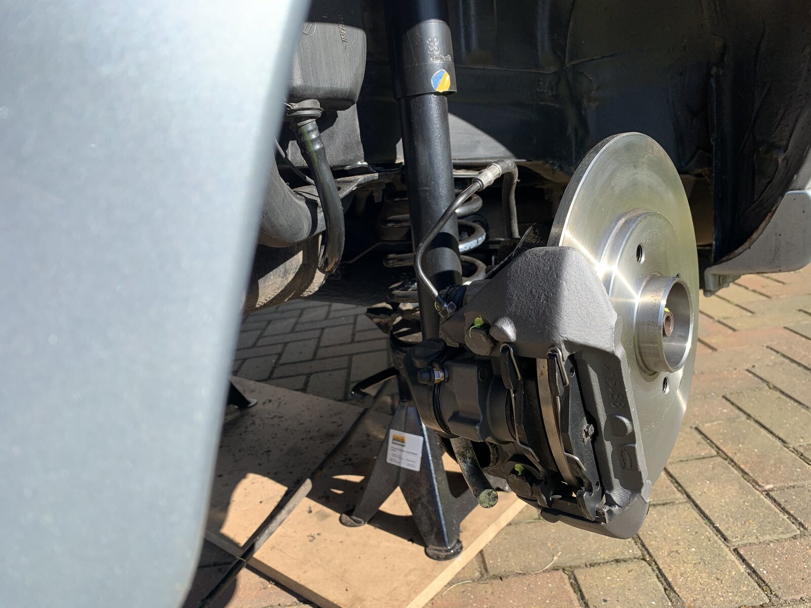

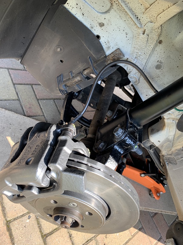

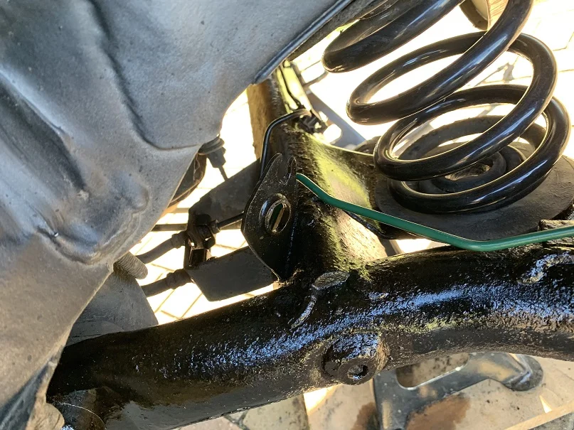

In these very unusal times, I'm fortunate to have a job where I can work at home but I've found myself not being very good at having a fixed end to my day and end up working more hours than I would usually. So, even though I can't go anywhere I have decided to take a days holiday and get started on the brake overhaul that I've been meaning to do for so long.

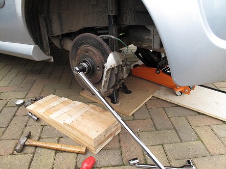

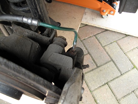

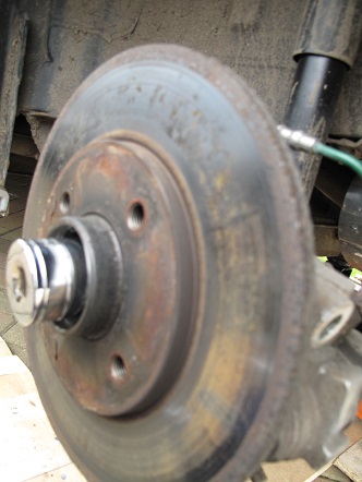

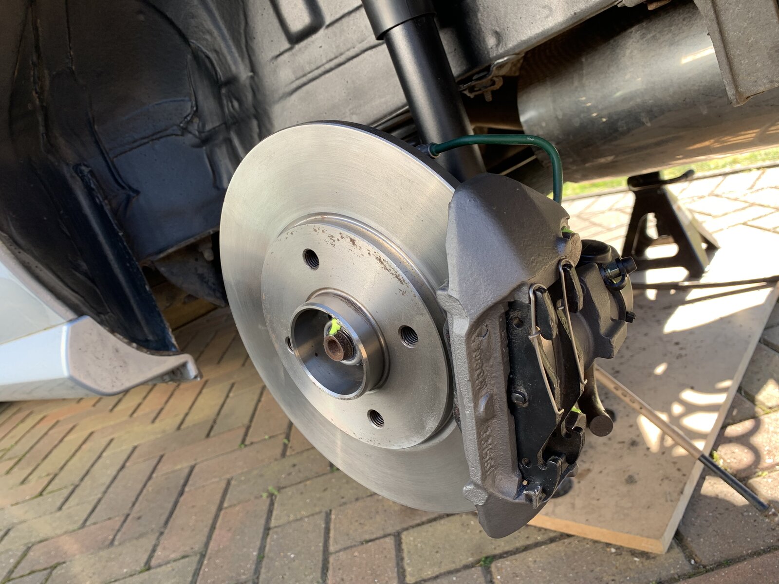

I decided on a cautious approach, ensuring everything would come undone and I had all I need before going beyond the point of no return, this unfortunately has meant an early finish today :(

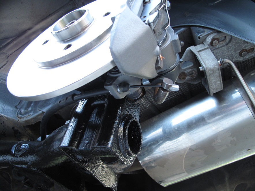

Following fubarNet's guide for rear disk swap gave me a lot of the info, but I workied out the handbrake route & adjustment and the brake pipe routing too as I will be swaping calipers as well. I might even write my own guide to cover these extra bits.

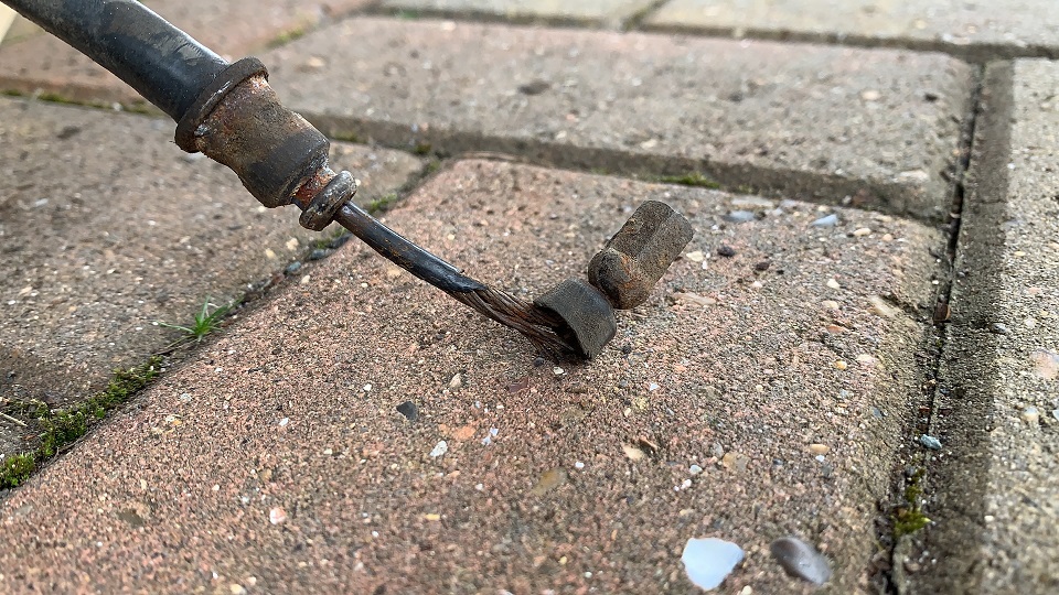

My biggest fear was that the brake pipe would be siezed in the caliper, it wasn't but the end fitting is siezed to the pipe so I expect to damage the pipe splitting the two. Fortunately I have a spare pair of rear brake pipes, so I will be changing them anyway.
With my trusty socket set and a 24" breaker bar everything has come apart fairly easily but one of the handbrake cables look ready to snap so I've dashed off an order to RPD and will focus on having a tidy up whilst it's in pieces waiting for the new cables to arrive.

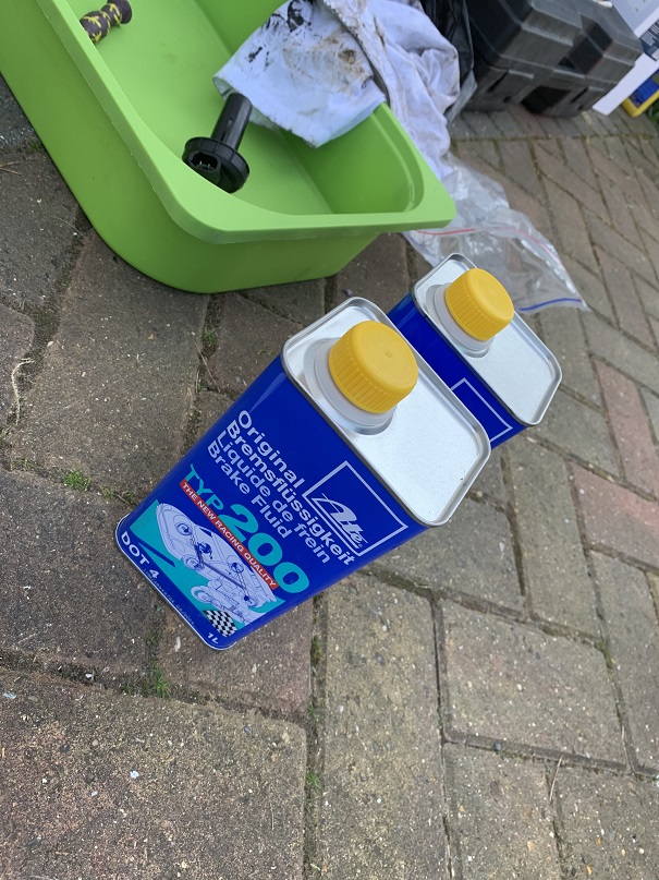

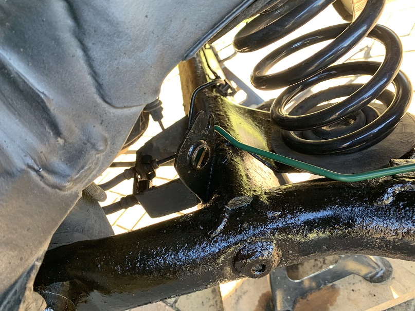

Cleaning, painting and new brake lines. I have a spare rear beam that'll be getting the full refurb treatment and swapped over in due course but I couldn't put the new brakes on without a bit of a tidy.

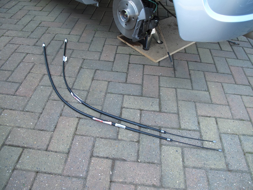

All done. After a pause to wait for new handbrake cables to arrive, I've set about finishing off the brake refit. Refurbed calipers, new discs, pads, brake fluid, braided hoses at the front and replacement brake lines at the rear plus a good old clean and tidy up too.

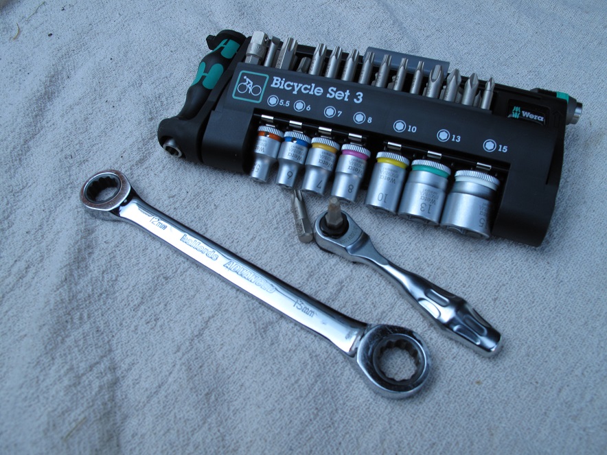

Made good use of my Wera pocket toolkit, teeny but great for those hard to get at places.
