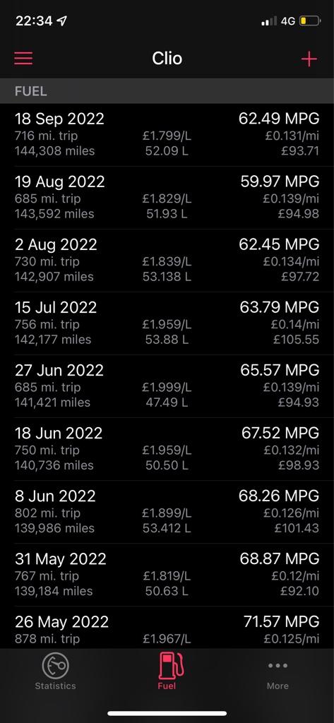

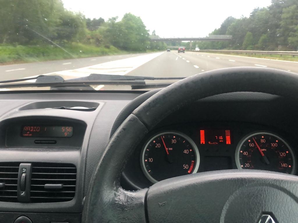

I used to complain a lot about excessive fuel consumption while out in Europe trying to keep up with traffic at 80+mph.
63 on the cruise control and a very light foot when up in Anglesey returned more than 720miles with still a bar of fuel to go, and 68mpg.
I’m a loser but that felt good !

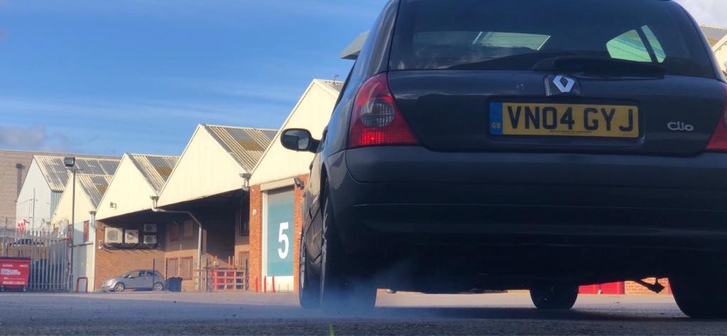

Oil consumption is now a reality. This is something I would only realise in the past after long trips to Europe. 5k miles in a month has required regular topups, the official rate is somewhere around the 3/3.5L for 5k, so not quite 1L per thousand, but still, can’t be ignored.
The car does not smoke black anymore. Like nothing, it’s impossibile to see black smoke. However, the only color I can see out the exhaust pipe is blue.
My theory is that the turbo is going, and that whatever soot is produced it just sticks to the exhaust pipe.. however this doesn’t really make sense at it has to somehow come out at some point.

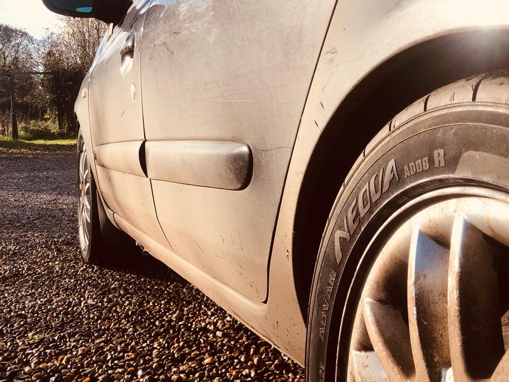

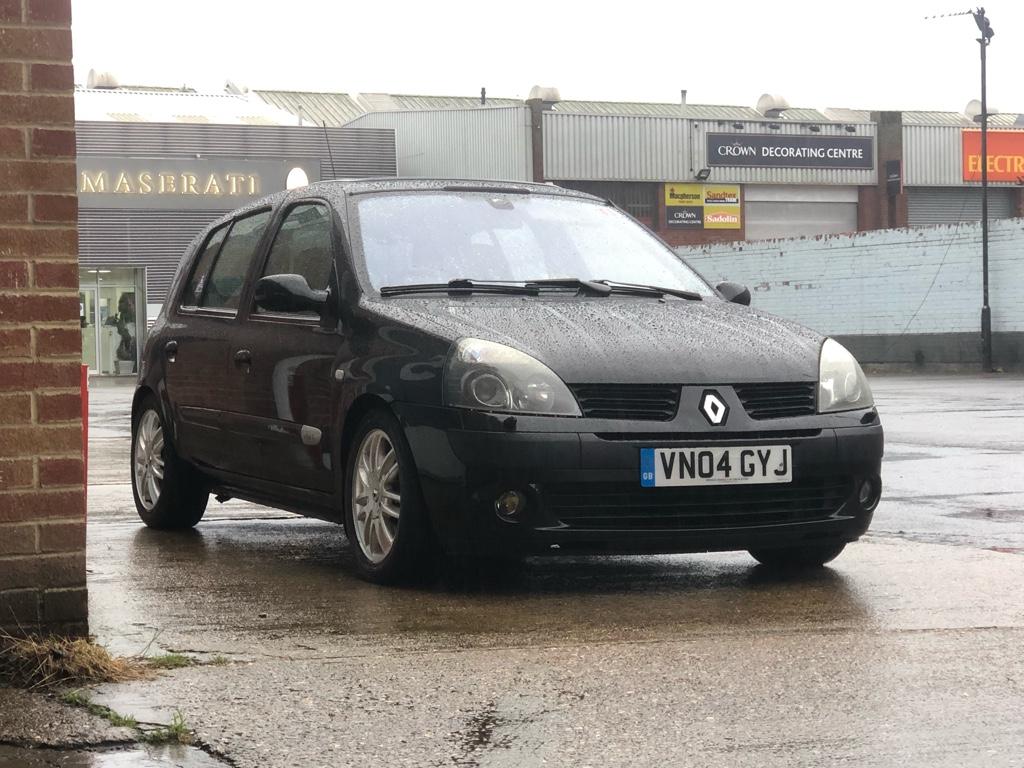

The car is also absolutely filthy, has not been washed in almost 3 months and 8k miles, not proud at all.
A quick snap of the last time it was cleaned

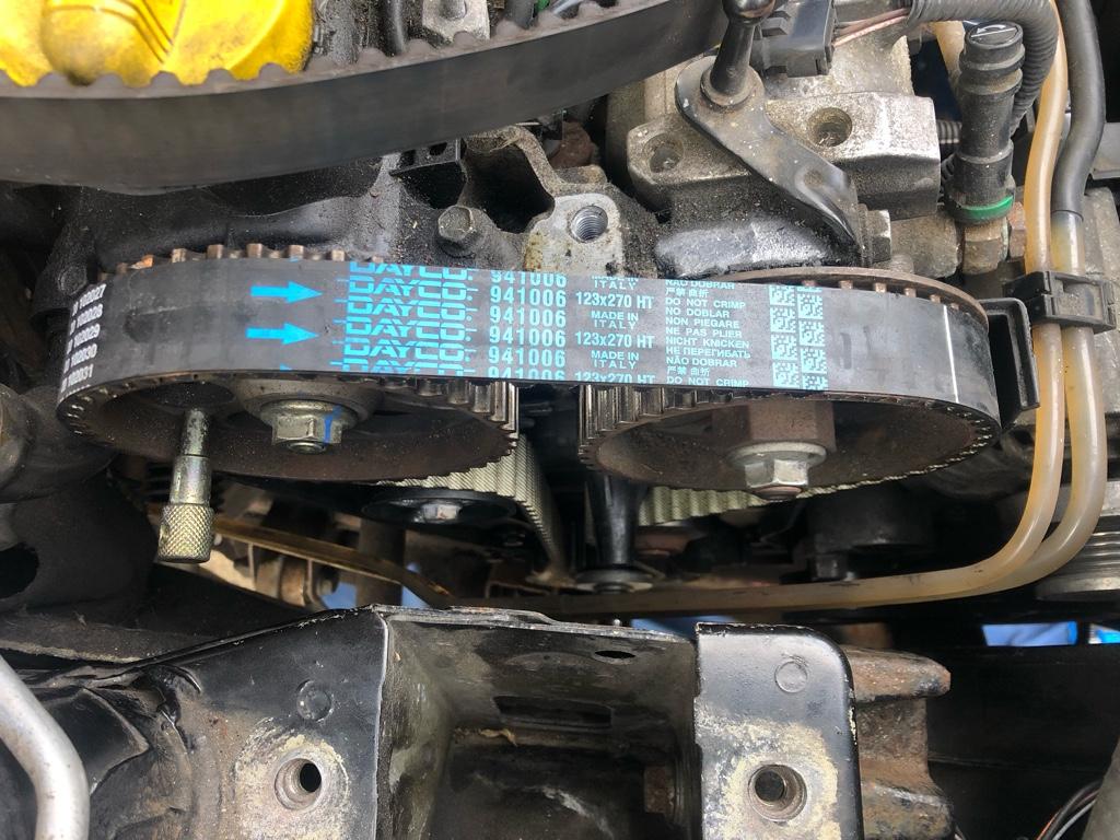

Last week I finally got round changing the cambelt. This is officially the second cambelt this car gets in my ownership, although long time traders will (won’t) remember I had to do it twice with the red car as I forgot to fit the lower timing cover after changing the water pump.
Said pump won’t be changed this time, i should be amazed if we’ll ever get close to the mileage that will require it to be changed again.

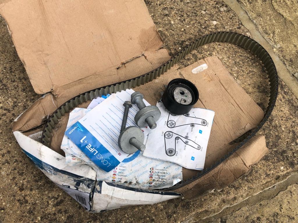

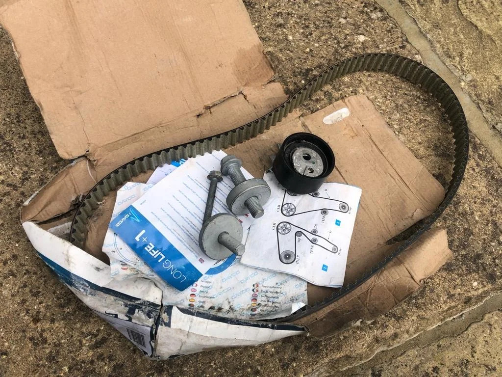

One of two years ago I bought a Dayco timing kit, found on eBay as a surplus item from somebody that didn’t need it or bought the wrong part. From memory it was £12, and it included the belt of course, tensioner with bolt, and both an M12 and M14 crank bolt, so any K9K engine should be covered.
Here’s what the kit looks like after being improperly stored for a long time
Thankfully whatever is left of the cardboard managed to hold in all the important bits.
This job isn’t particularly difficult, but there are two or three things that make it quite clear your working on a French car.
The “freewheeling” crank sprocket is the star of the show here, a chance for my cheapo Sealey timing tools to make an appearance
The old stuff is of course faultless.
In fact, I decided to religiously stick to the service manual 65k interval, already knowing it is quite conservative.

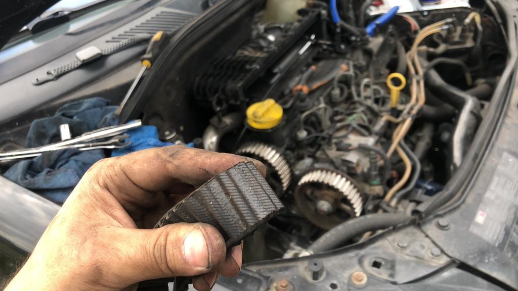

Here’s the old SNR belt after 67k, or almost exactly 5 years.

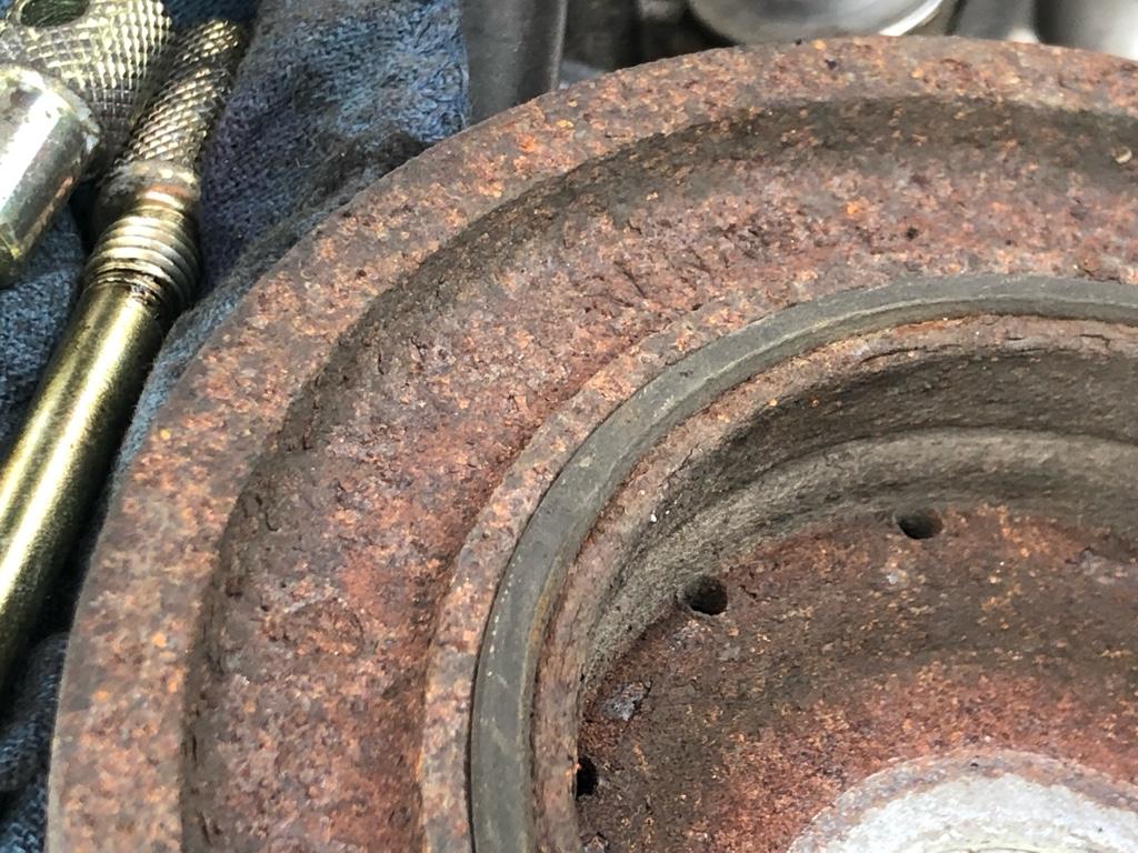

I took care of checking thoroughly the rubber element on the crank pulley.
They can fail and cause all sorts of havoc, mine looks fine to me.

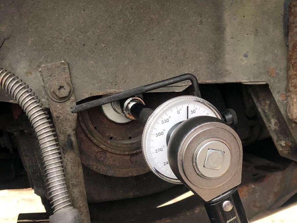

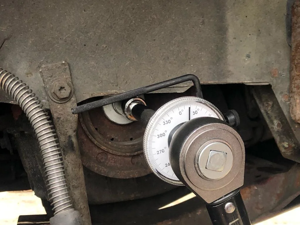

I tried to torque the M12 crank bolt using an angle torque tool I bought years ago.
Not the easiest thing to use.

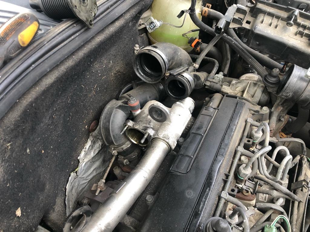

Also, I decided to take out the EGR valve and actually make it functional again by flipping it the right way round.
No other reason other than pure curiosity, I disabled it as one of the first job when I got the red car back in 2017.
The problem was the now completely caked up egr passage.. I couldn’t just open it up again and expect the already tired turbo to swallow all that crap up.
So I disconnected every hose to the inlet and ran the car with the passage open to the elements so that it could vent out any dirt.
Worked a treat, reconnected everything and started up the car, very Smokey at first but eventually cleared up. Will keep an eye on the valve on the next few days, it’s only 3x 10mm, easy.

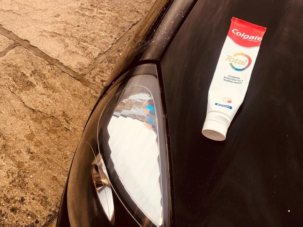

Last but not least, periodic headlight polish.. any mk2 owner I think can relate. This is like shaving your beard for the first time, it just becomes like slavery after that.
At least the new setting is quite scenic and makes the job a better experience, for a change..
I wasn’t properly impressed with my now 4 year old 3M drill kit ( [emoji38] ).
But, after splashing some cash on some used Dewalt drill and impact combo, things improved.
The icing on the cake was trying out the ultimate cheapo rubbing compound

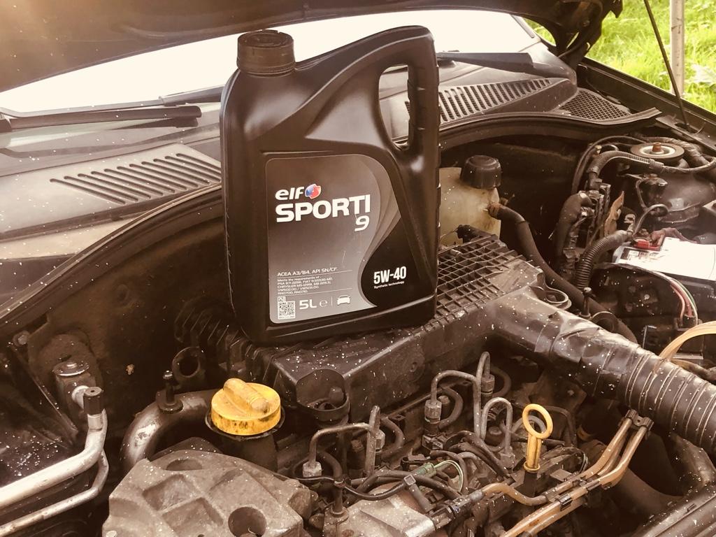

And after a quick and long overdue oil change with the cheapest genuine filter I could find (£7 this time) and also the cheapest 5w40 Elf oil ..

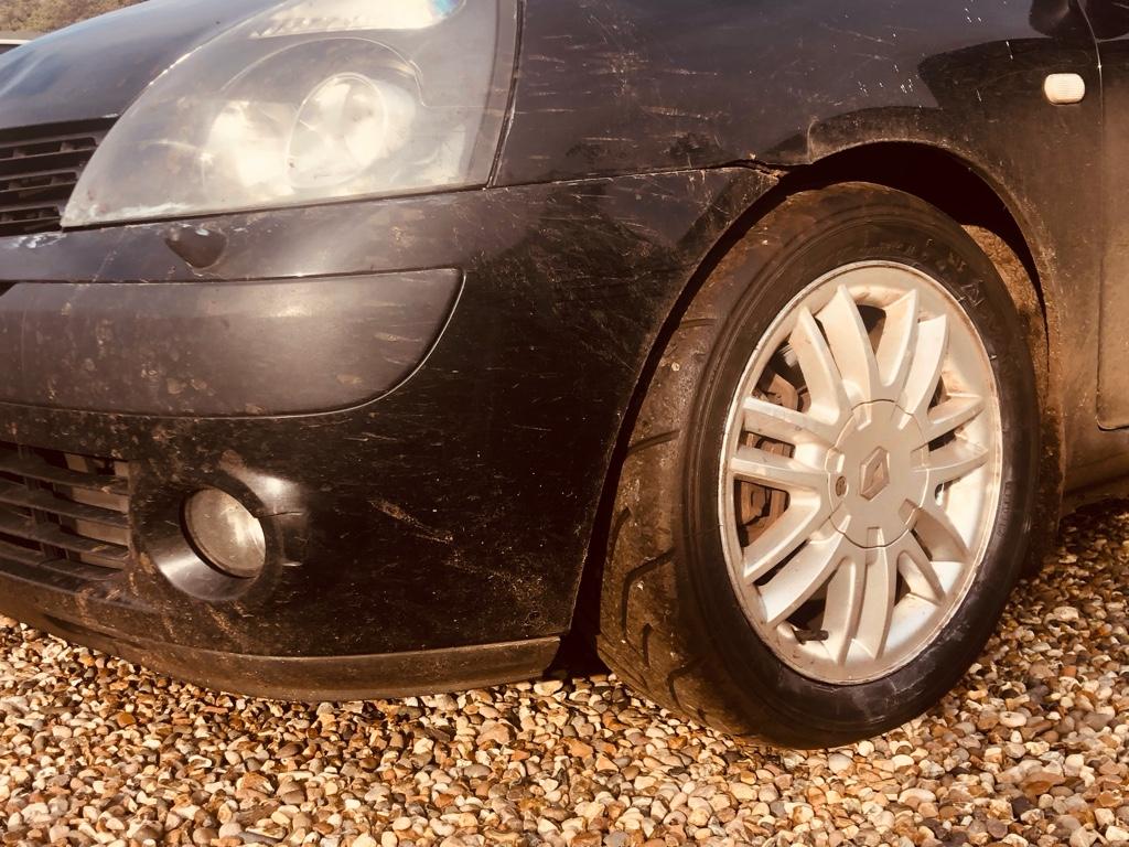

I finally got round fitting the Michelins on, the winters were scrapped for good after picking up two punctures in 5 days and being well over their recommended service life.

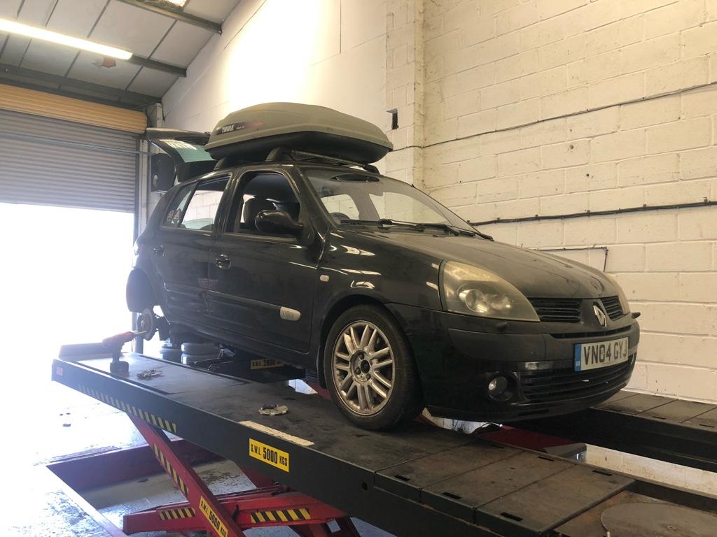

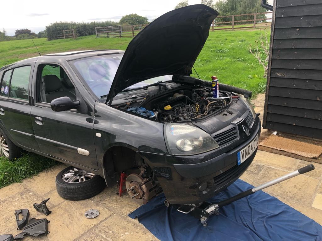

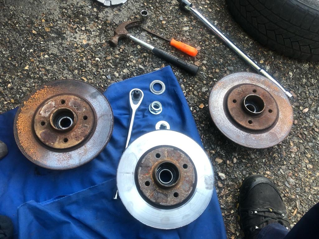

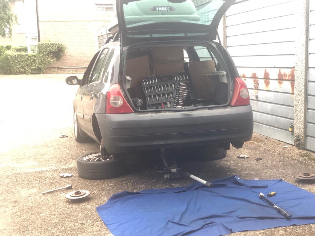

First problem was with my rear wheel bearings. I’ve had 2 fail in a short amount of time, granted they were used spares I kept in stock, but still it was quite the inconvenience.
Thankfully, they’re very easy to do on these cars even with the disc brake setup I run.
I ended up buying 2 new old stock bearings, I think they were listed for a R19 and for a mk1 megane.. they fitted just fine, my inner bargain hunter was happy at £6 a piece.

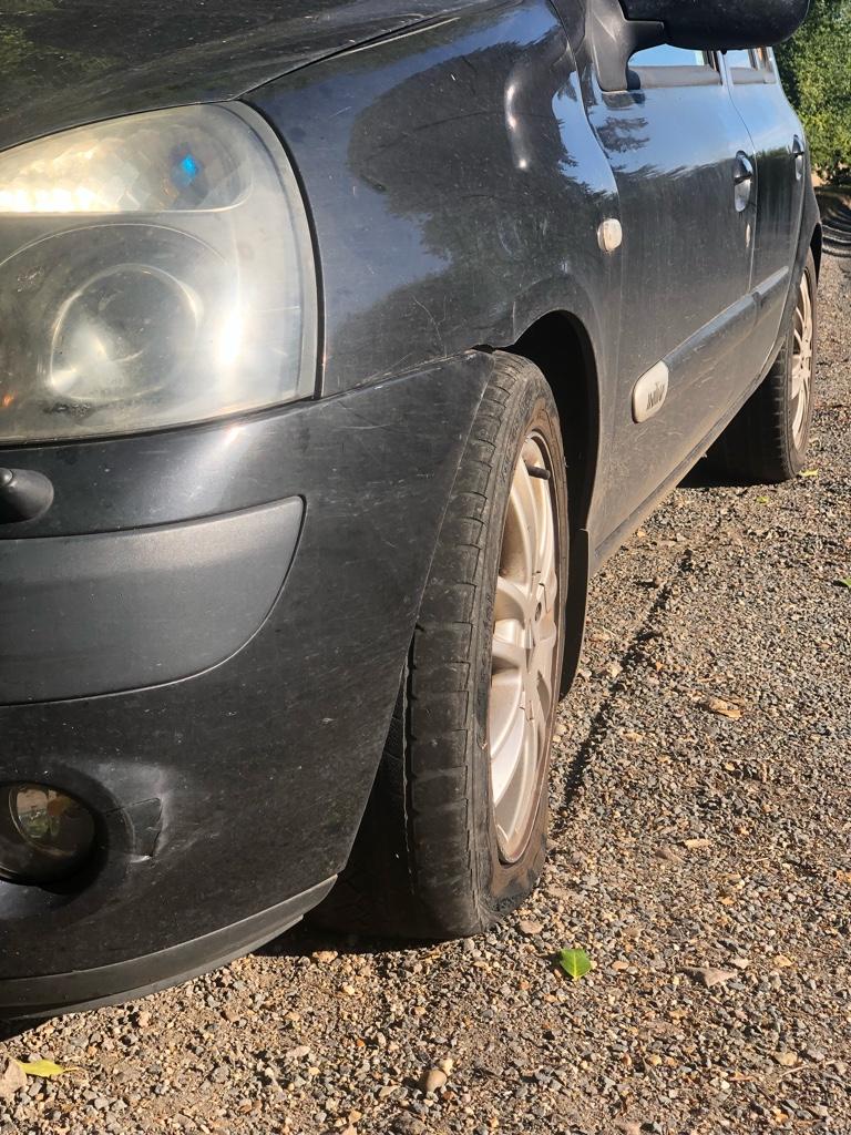

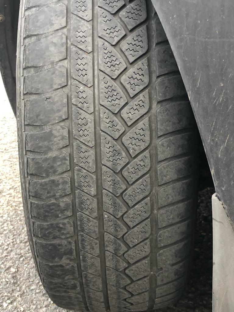

The other big issue was tyres.
I was running this set of continental winters, dated 2011. They were ok up until last year, but recently they’ve probably just given up on life and had become dangerous on wet roads.
I know I should have changed them long ago, but I have a problem throwing away stuff that still has life left in it, so I keep them on.

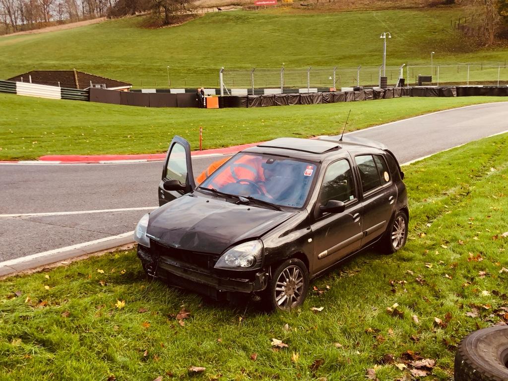

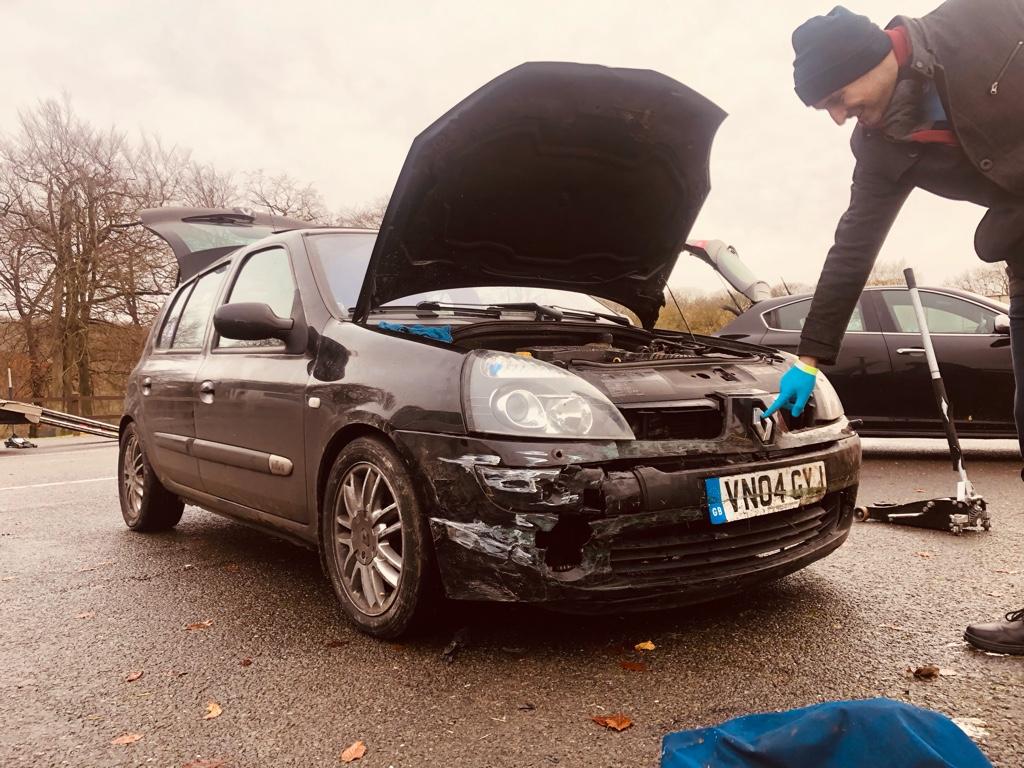

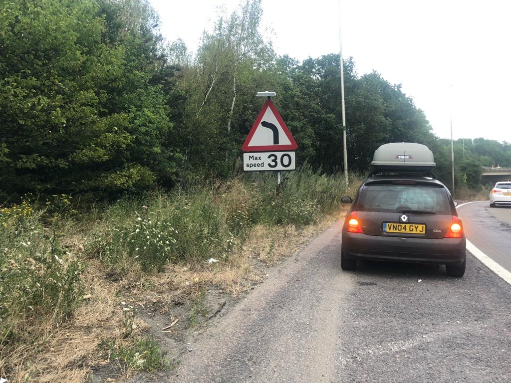

Until, I spun off a motorway ramp almost killing myself and the car, and picked up two punctures the week shortly after.
Enough is enough [emoji23]
I took a picture of where I has spun off the previous week, you can just about see the wheel tracks of when the car slid off the road facing the wrong way
It is fair to say that one of the punctures was caused by a bent rim following a nosedive in the most unreal pothole… I still blame the tyre [emoji38]
During that time I already had the spare on for the first puncture, then a second rim started losing air because of the pothole.. I remember having to stop every 5 miles to put air in the wounded tyre.. hated life.
Michelins back on !!

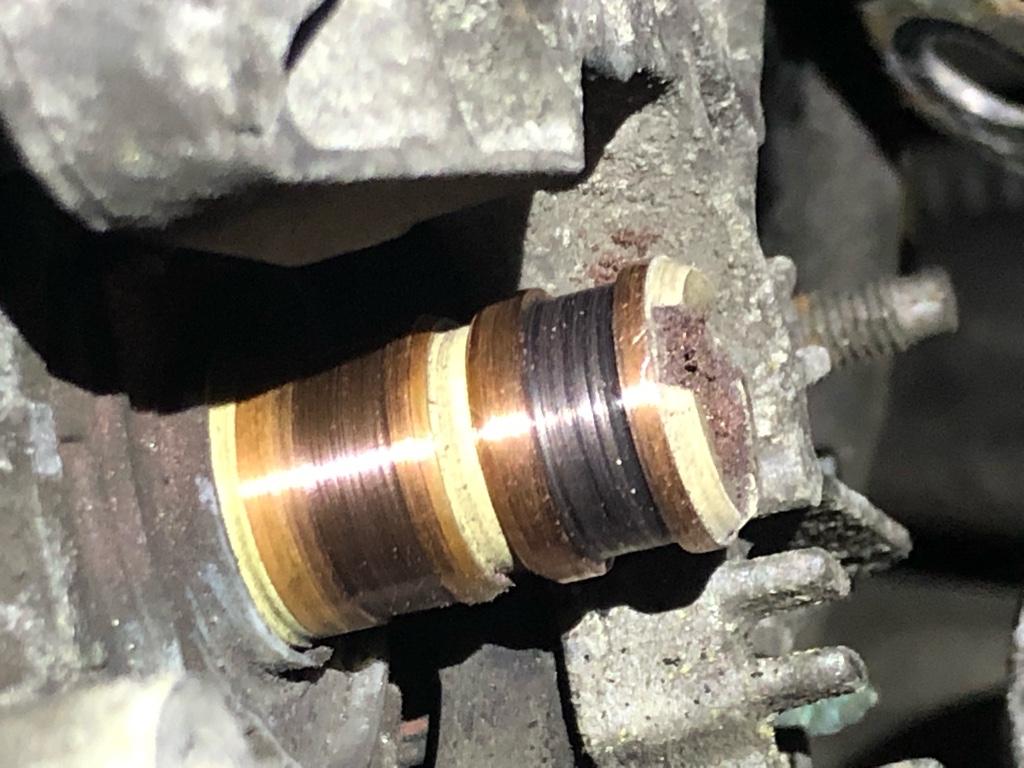

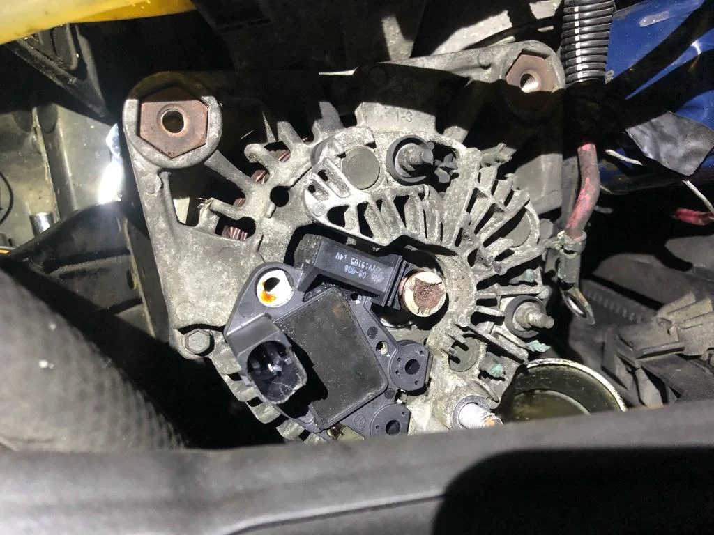

Alternator wanted his day of fame last month, battery light on first thing in the morning, greeeat.
Bonnet up again
This turned quickly into major disassembly because France
Regulator slip rings have seen better days
I had a spare one that I didn’t fit when “reconditioning” the alternator years ago, it had a different conmector and would not fit the rear dust cover.
Nothing that a pair of side cutters won’t fix, so although this isn’t ideal now as the slip ring is beyond repair, it will do for now.
Looking for a cheap alternator to rebuild [emoji102]
It charges fine, exciter wire came off again wtf [emoji2959]

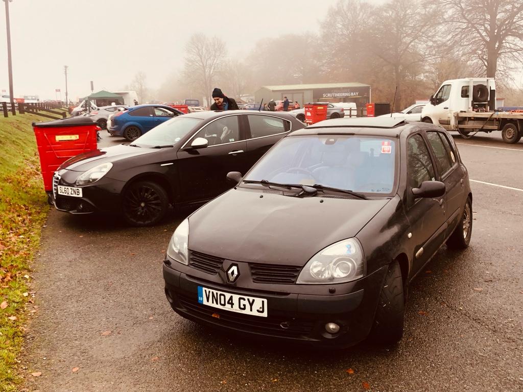

And back we are from a fun weekend at cadwell.
I had an open pit lane booked with Javelin with some credit I had from a previous event I couldn’t attend.
Always wanted to experience cadwell park, looks brilliant fun, and it was.
The days leading to it where spent mostly sourcing tyres. I ended up fitting my old a048 to the front, while a pair of ad08r picked up for £20 were mounted on the back wheels.

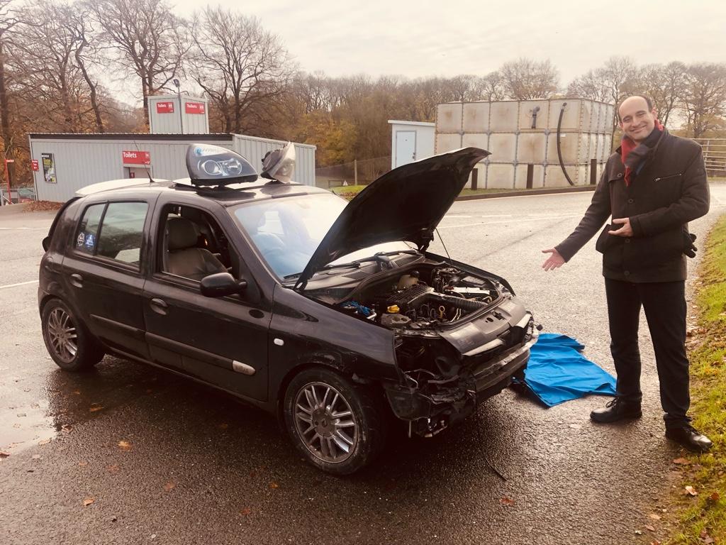

I also tried to fit some second hand Goodridge brake lines, but the rear calipers (and one of the hard lines) decided two winters is enough to seize solid (all these parts were rebuilt 2 seasons ago) so I had to go in with 20year old rubber lines and 2 year old fluid, yea.
I gave the air filter a blowout, flipped the egr back to race mode, packed some oil and tools and pointed the nose north.
On its daily duties the car has been faultless. It does its thing brilliantly, I love the way it drives, and although I have been randomly browsing for other cars I just can’t justify getting rid of it, it’s too good.
Trackday then; my last one was cut short for some problems that ended up being related to a failing driveshaft that exploded weeks after, this one I hoped would be smooth sailing and loads of sliding about all day long.

Once back on tarmac it was evident that many things had shifted somewhere in the front of the car. More than one light on the dashboard was flashing, the tyres were rubbing on something and it seemed like there were no engine mounts; a couple of seconds after I lost all drive and died right at pit entrance, I wanted to disappear.
Immediate red flag of course, my worst nightmare. We had already lost an hour waiting for some fog to clear, everybody was eager to get some laps in… and here comes the bellend with that diesel clio head butting the tyre wall ..
Luckily, the organizers told me that it was only 3 minutes til lunchtime, this made me feel a bit better.
I only then had a proper look at the car while we were waiting for the recovery truck.
The radiator support was caved in near the RH headlight. The front bumper had been ripped off and was dragging under the car in bits. Both headlights were hanging by the wires, and the bonnet was a mess.
What was incredible however, was the lack of any sort of leaks from the radiator and AC condenser, which is now the shape of a potato, no airbags went off, and best of all, while trying just for the sake of it, the car fired right back up.
I shoved what was left of the bumper in the back, and made my way to the paddock trying to hide under the dashboard.
What surprised me was the positive response from the people, I swear somebody was applauding !
Once back in paddock I took everything off the front end and set about pulling the rad support away from the engine.
We initially tried with a tow strap that was unfit for the task. A second ratchet strap seemed tough but couldn’t not shift the metal structure at all.
Until finally, some Yorkshire lads with a 7.5t invited us on their trailer, where the Clio was strapped down and the chassis pulled back straight-ish with a 10ton winch [emoji38]
Proper job, now I had a better shot and cable tying whatever was left in reach to make the car look somewhat decent for the 3 hour drive home.
After a couple of hours of bodging this was the result, I’d say not too terrible.
