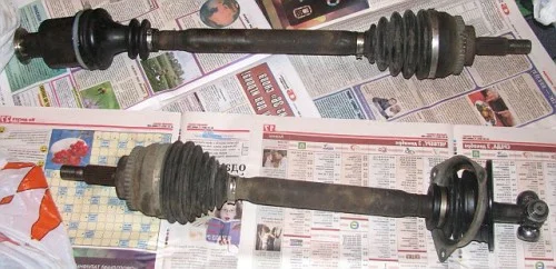

After reading every thread I can possibly find on this subject im still really confused. My inner cv boot has split on my ph2 172 (passenger side). I was led to believe that I need to replace the whole driveshaft so I phoned Renault to double check. Guy on the phone says they do a replacement inner cv boot aswell as an outside. I told him what iv read on here and he says he actually did one the other day and it can defo be done. So.... I came back on here and had another look and this is what iv concluded.
Outer cv boot can be replaced passenger n drivers side. Inner cv boot can be replaced on passenger side but not drivers side.
Someone please correct me if im wrong.

Two it seems but they are different (Passenger being the bottom one below) I believe every version of the sport uses a different driveshaft so it makes it tricky, would likely need to stip the shaft down to replace them or get the stretchy style boots but they can rip easy if snagged.

Drivers side shaft slides straight out so its this side that can be done easily
Passenger side shaft out means draining the gearbox oil and getting messy

The passenger side shaft (in above pic,the one on the bottom), I had to change the inner boot rubber after I noticed that the gearbox oil was leaking out. From what I picked up from Dialogys is that the shafts comes in two diameters, 25.4mm and 28mm. My car has the 25.4mm one.
