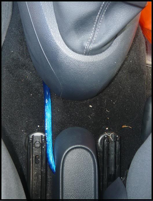

  133, 182, Kangoo 182
Nope! So far I've got;
- Power cable down middle of car. Cable is visible between gearstick and handbrake (will get some pics up later). I could have hidden it but didn't fancy cutting any carpet! Will probably get some carpet wrapped around it to sort of hide it..
- Speaker cable + RCA cable down right side completely hidden.
- Speaker cable down left side completely hidden (will also have an RCA to go with it once I get hold of one later tonight).
Got to do;
- Power cable into engine bay, onto battery.
- Ground cable.
- Crossovers/Components/Tweeters fitted and wired.
On track to finish tomorrow methinks. :)

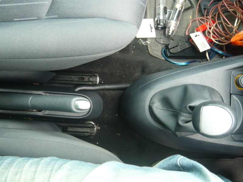

Please excuse the unhoovered carpet lol.
It doesn't look great, but that's the only visible part of the power cable and I will, eventually, get around to hiding it (either cutting carpet or covering it with carpet.. though I don't think that'd look too good).
  Ph1 172 + Combo van
thats not too bad, wrap it in something is quite a good idea so it looks the same colour as the carpet.

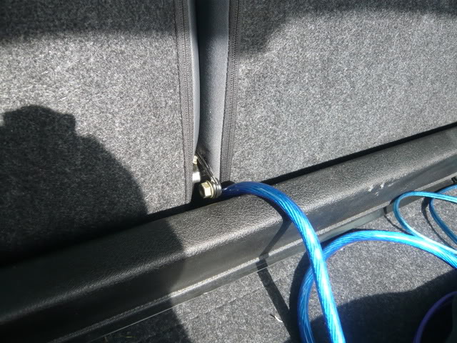

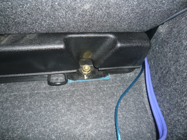

Is this bolt a good place for the ground? Obviously taking off the black paint first.
  1.2 Clio
Yeh thats the bolt i used. VERY tight the thread is, and you need to remove the paint on the bare chassis, not just on the bar that goes across!
The bolt also gets a bit sticky in palces. But be persistent. And what i ddi was coat the entire bolt in WD40 and the thread i9nto the chassis. Goes in and out more smoothly now, but still bloody tight!
Makes a great ground though, so far. When i get my 2 rear batteries, i hope it lives up as well as it has so far!

that bolt was tight on mine. i used the one inbetween the split in the rear seats.

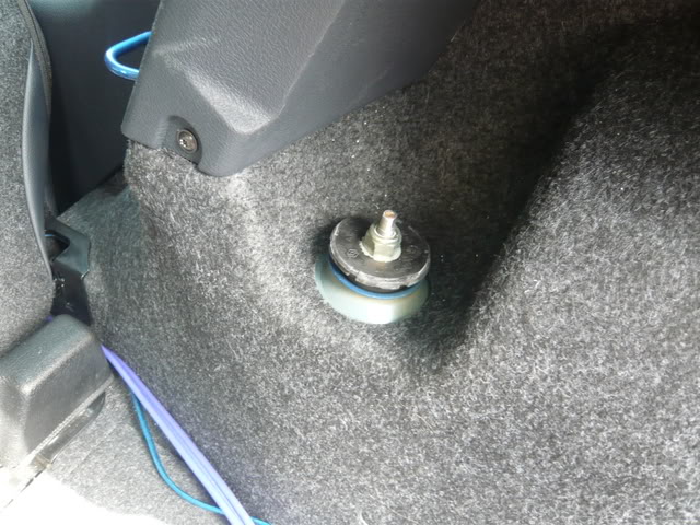

Decided to use some of this tacky plastic tubing around the power cable to make it less obvious. Better than bright blue cable but still not great. Will do for now...
Not liking this 'ISO bar' (that's what it's called?) bolt.
There's a bolt where you put the strut bar ('strut tower'?).. is this suitable?
My power cable goes through a gap between the rear seats.. will it still be ok to have a ground cable run there too? Is it the bolt in this picture?
Sorry about all the pictures! lol

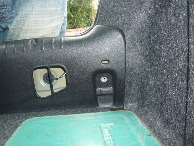

Found another possible earth location. Right under the plastic trim on the edge of the boot there's a threaded hole with no bolt (same on both sides). Looks quite bare and perfect size for the terminal on my cable which could be fed under the plastic to have direct contact with the metal.
(the right one)
