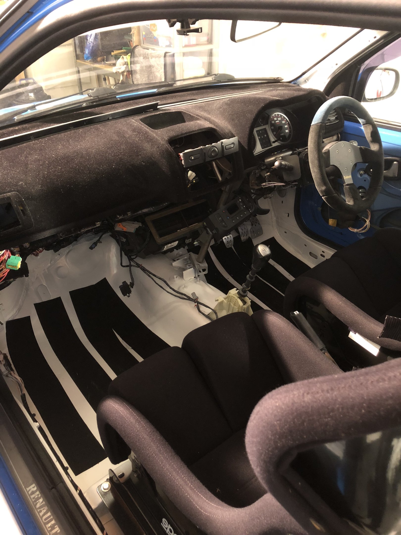

Finally getting round to stripping the interior now but have a question.....
what have you boys used on the floor once the carpets are removed for a little less slip? was thinking about trying to put down something like skateboard tape stuff but not really sure.
and advice or ideas welcome thanks

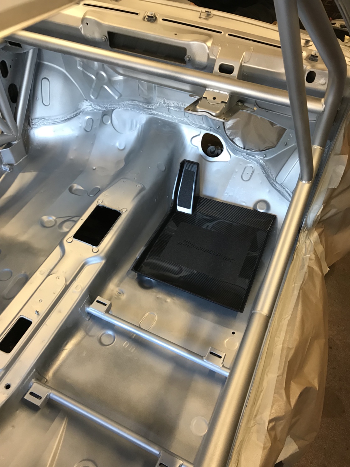

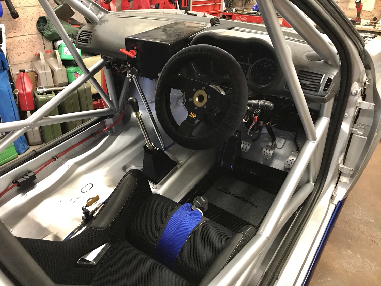

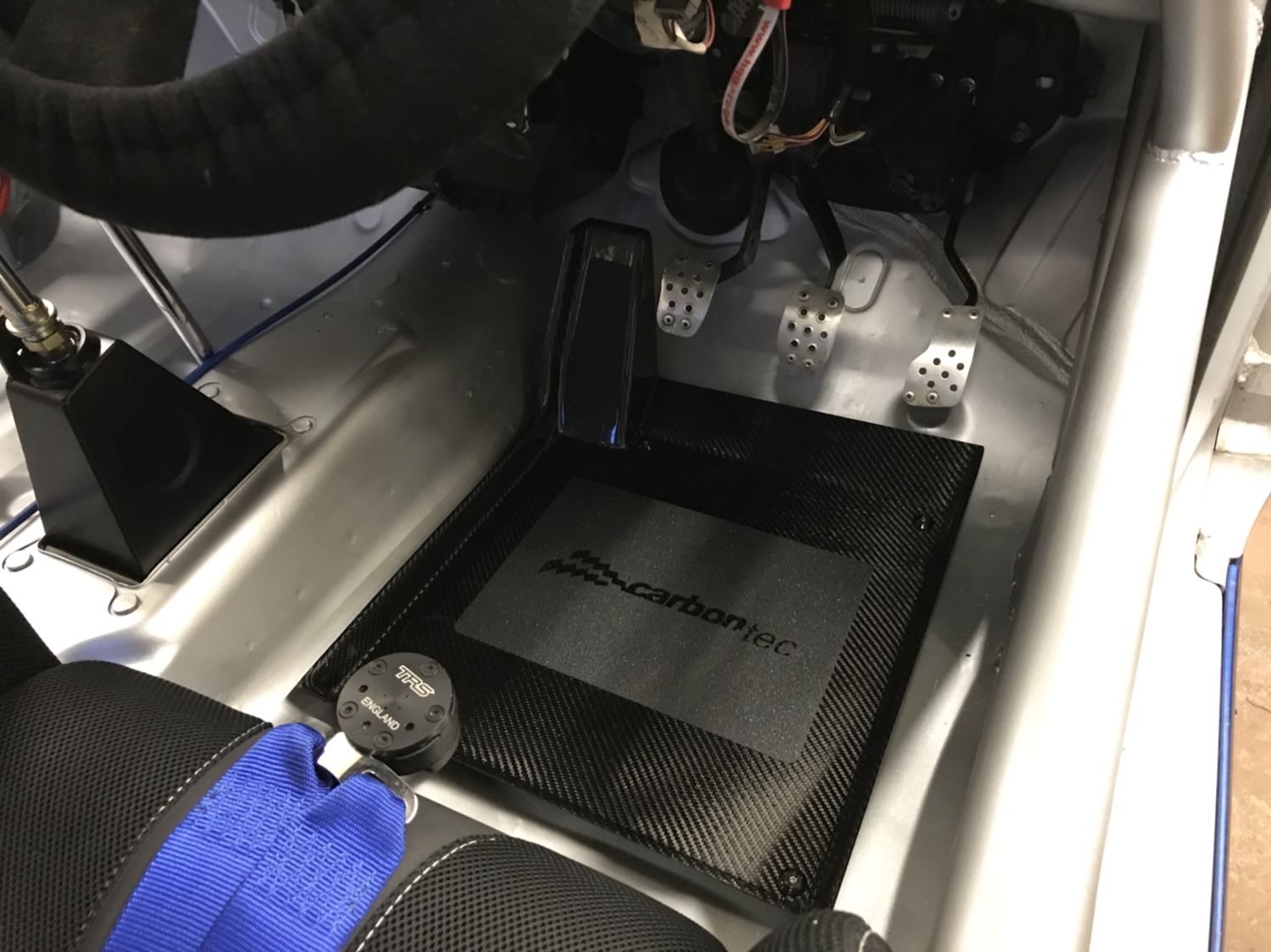

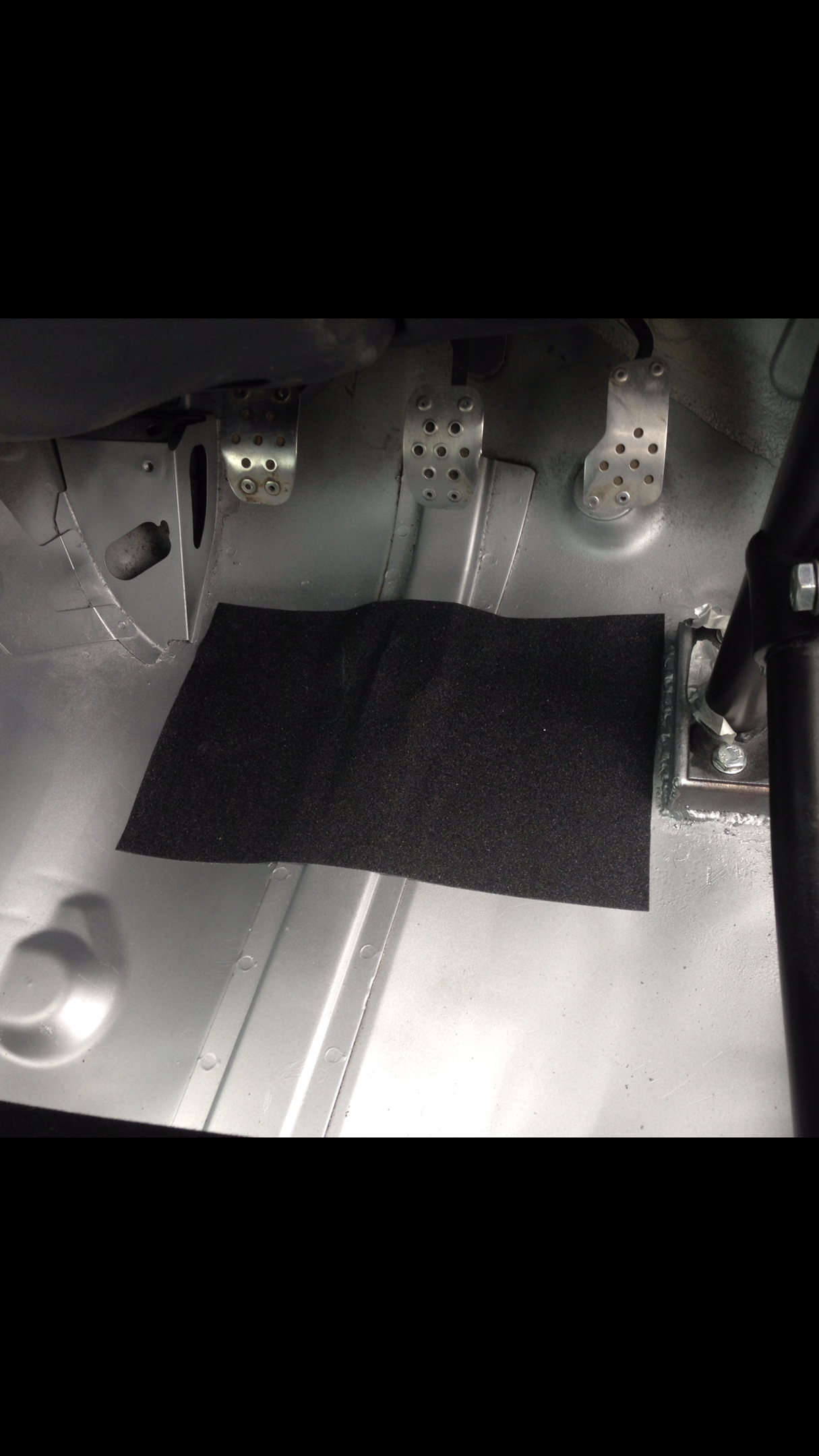

I recently organised a group buy for these:
https://carbontec.pl/carbon-foot-rest-for-driver-cliosport-impreza-sti-evo
John Lindsay
  PH2 RS182
In that picture it’s just laying on the floor lol.
But it now has a bolt with countersunk washer in each corner through a Rivnut in the floor.
  Clio 182 Trophy
That's beautiful! Don't suppose you know if another group buy is in the pipeline ... ?
A mate has just bought one for his Megane R26 a few weeks back, the build quality is superb, they're a lot thicker than I thought they might have been

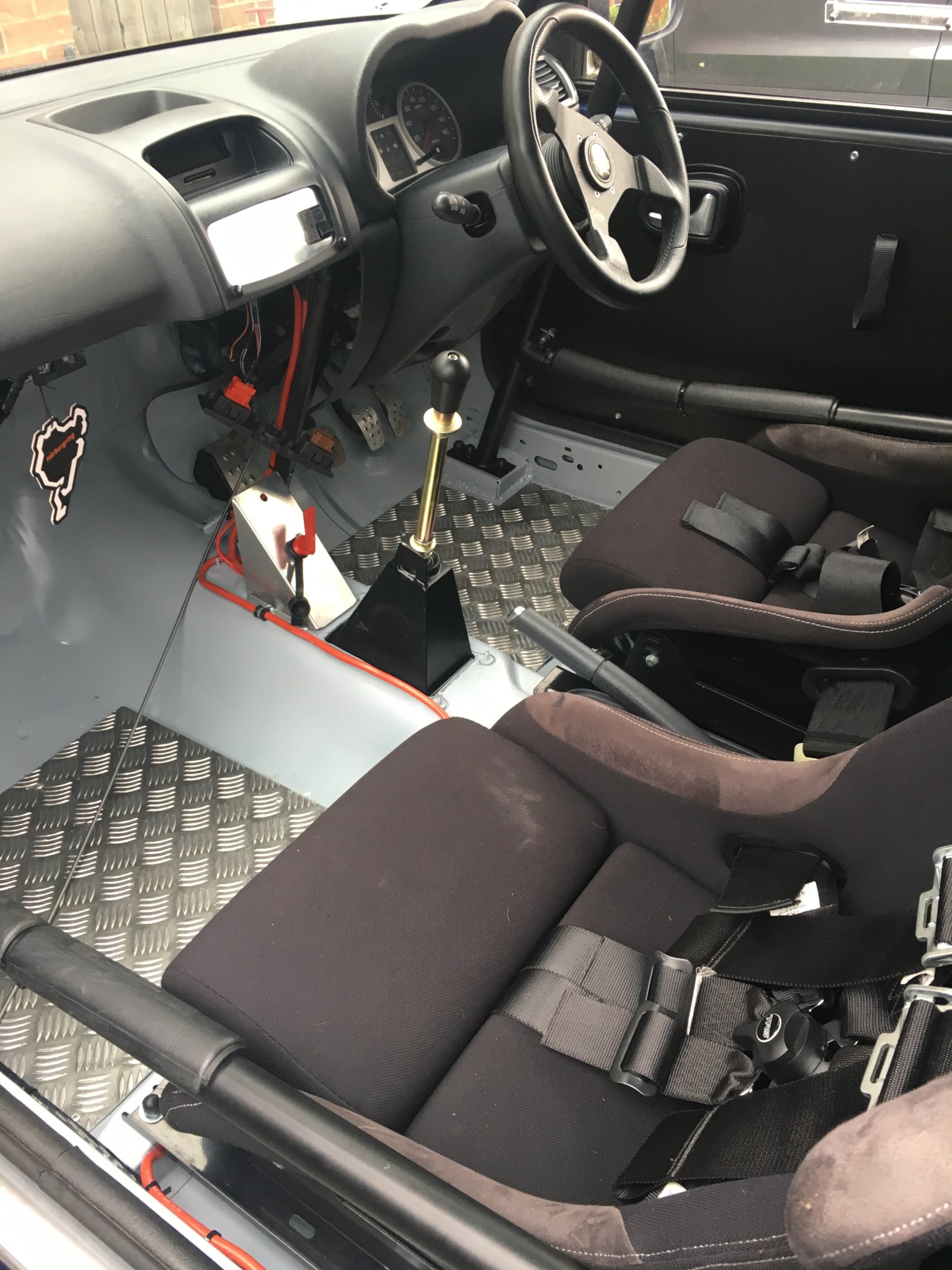

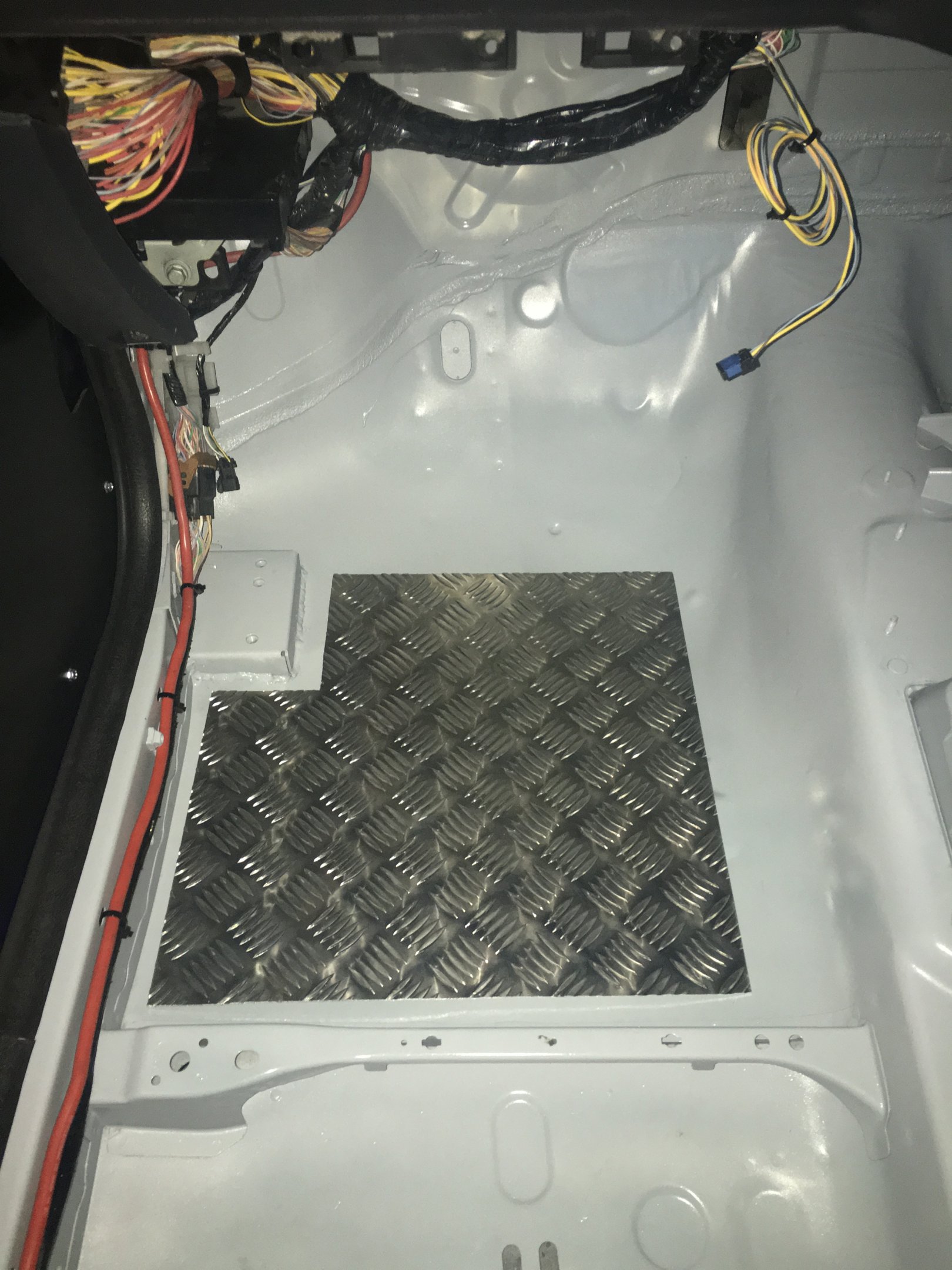

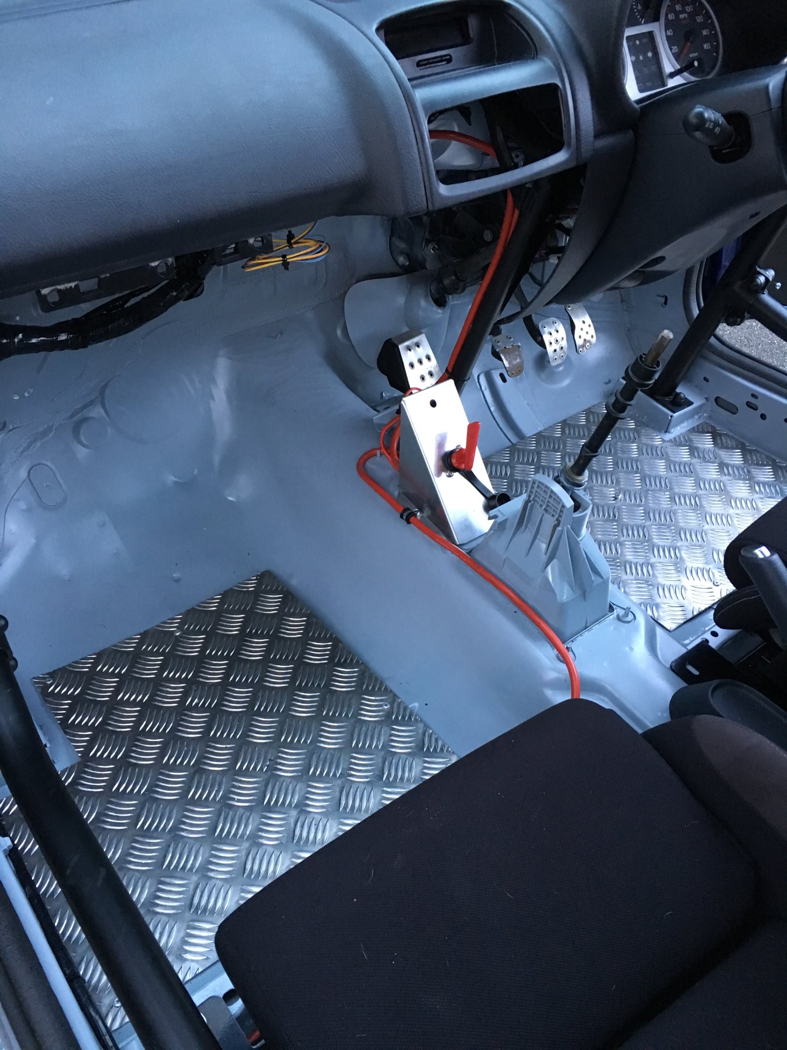

Aluminium checker plate cost around £40 fairly lightweight and hard wearing.
