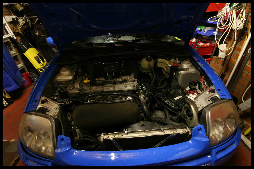

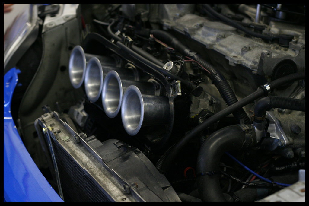

  B/G 182 + PH1 Track
Link to our car
http://www.cliosport.net/forum/showthread.php?t=364943

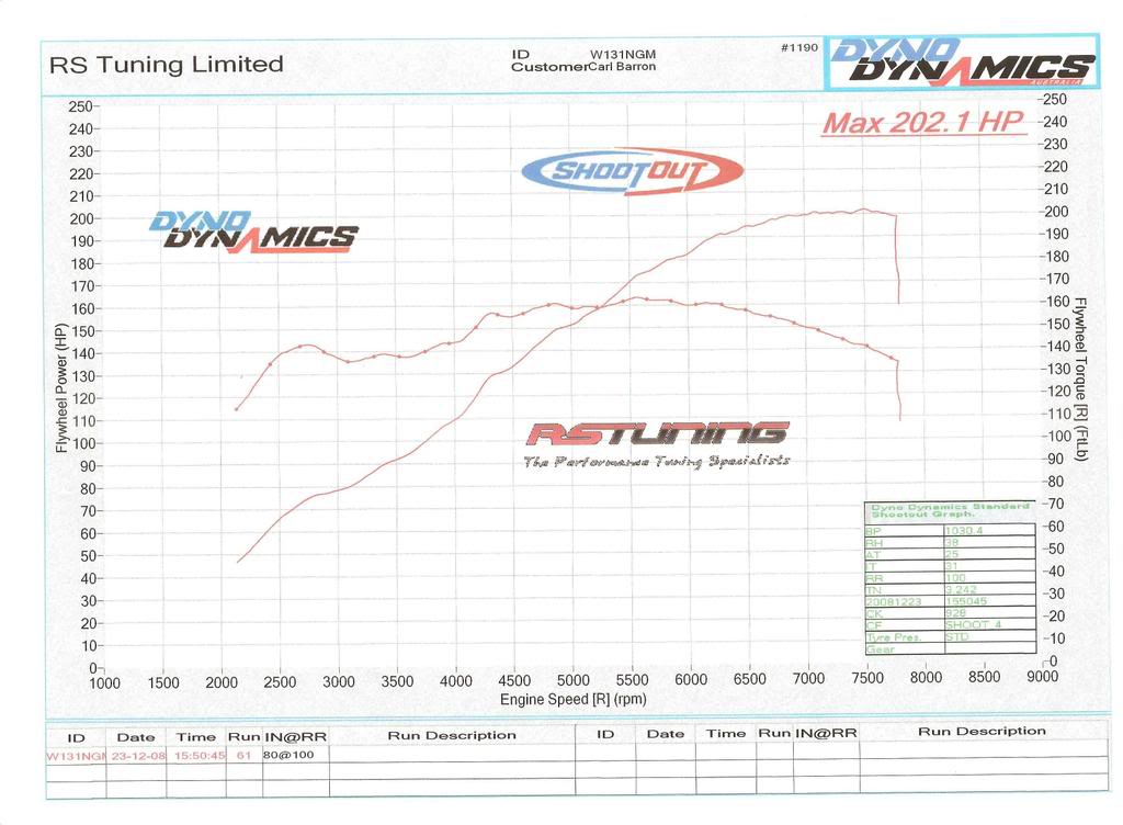

The graph shows the results.
That is standard engine running 420 Group N cams(basically stock lift)
The car is very different to drive, than when standard.
ITBs are great for track, (not going to argue this again ;)) But you will never see there full capability on the road:).
Love our car the noise is awesome and the car pulls very well, should pull better by the end of the year though :eek:
