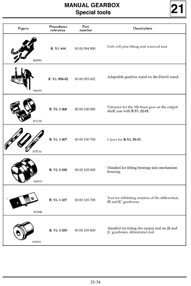

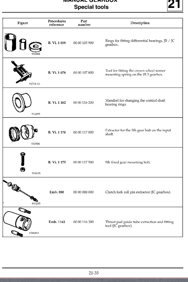

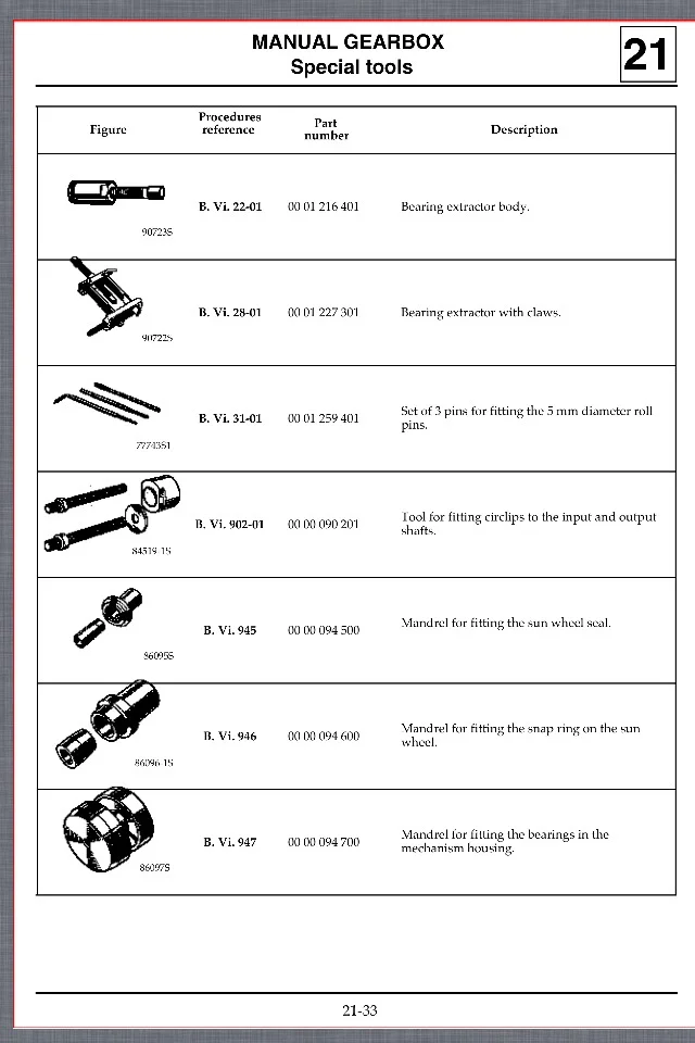

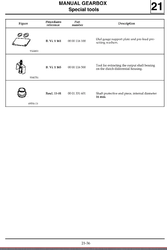

Could anybody help me with this? I'm looking for the special tools to dismantle a jc5 gearbox
Can I get these direct from Renault? Or does anybody know of someone selling or willing to rent them out?

well, i do know you need a deep socket wrench of more than 32mm to dismantle the diff...
  Clio172cup rally car
these are the tools in the manual, I just need the tools to take off the 5th gear, big socket for the nut on the diff and the tool to replace the pins on the selector forks

its easier with the right bits, but you can do it without
i do them myself (sometimes) but most of the time i send them to my gearbox guy as they're a bit of a t**t!
