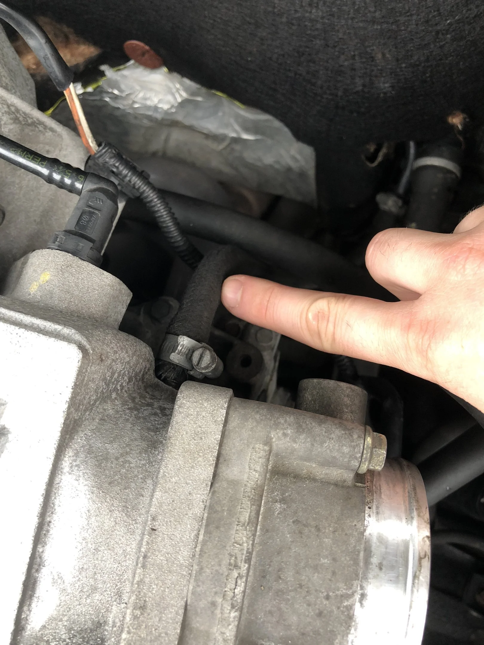

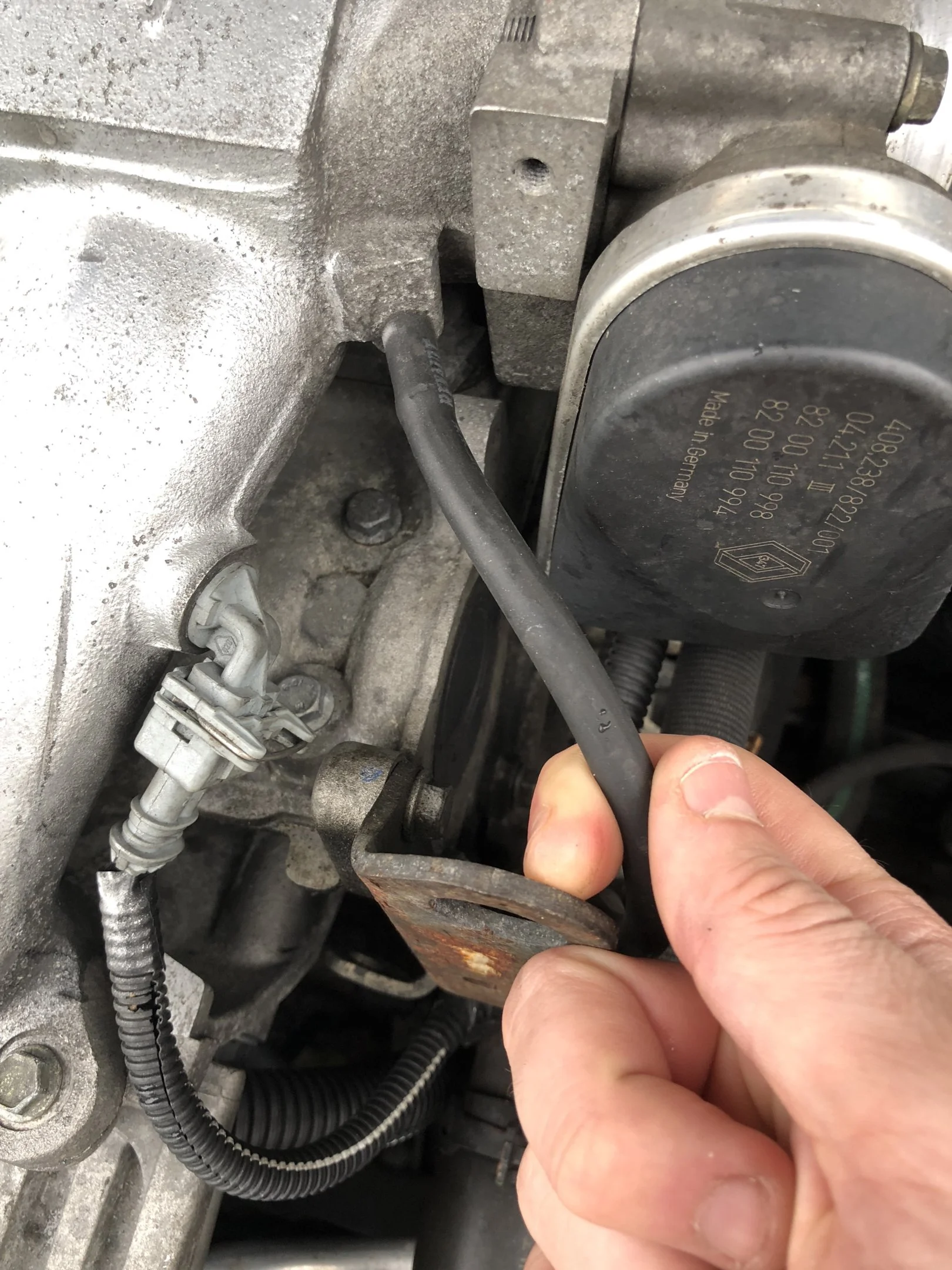

Carbon canister is more ticking not a heavy knock. Pull the plug on it temporarily to shut it up if needs be, will throw the eml on
  PH2 172

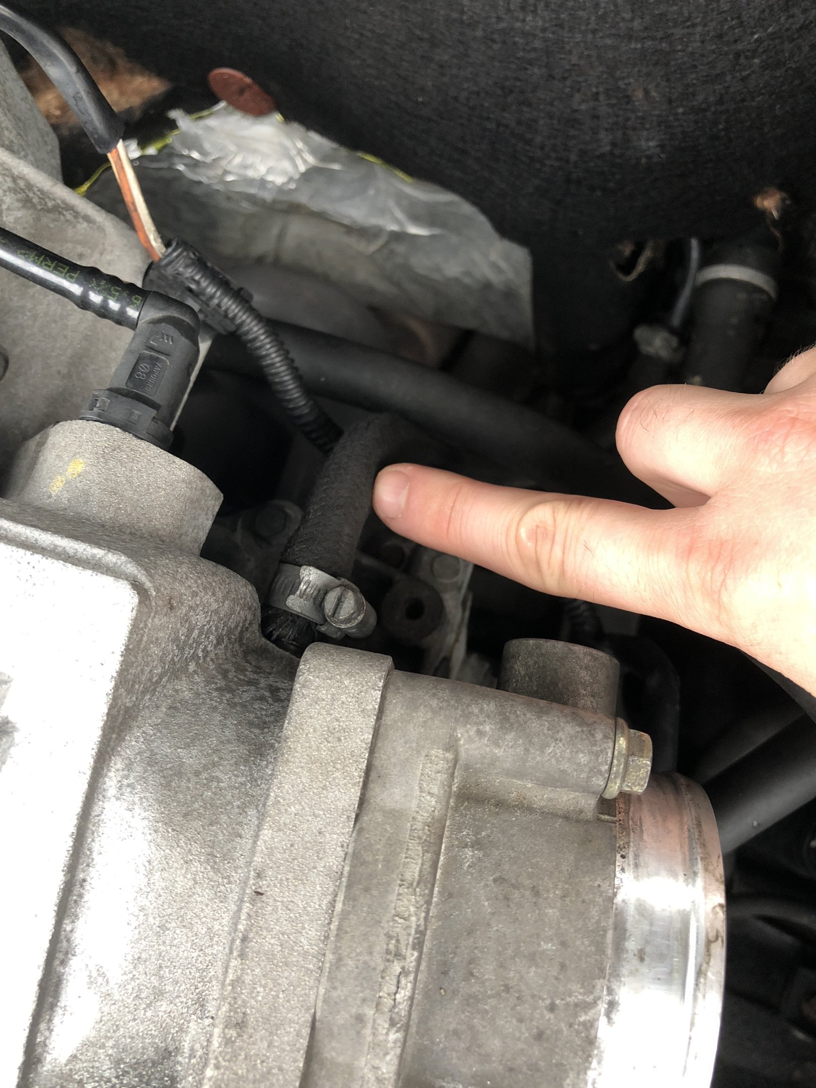

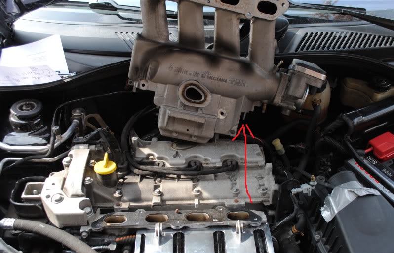

How can you tell if it’s the cannister/how did you fix it?
Disconnect the vacuum hose from the back of the inlet manifold & cap it.
CC sounds more like a single ticking tappet than a rattle tbh, and the noise will disappear in the general cacophony over 2k revs.
This way will not throw the EML light.

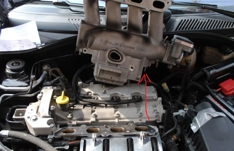

  Clio 182
1st or 2nd?
  Clio 182

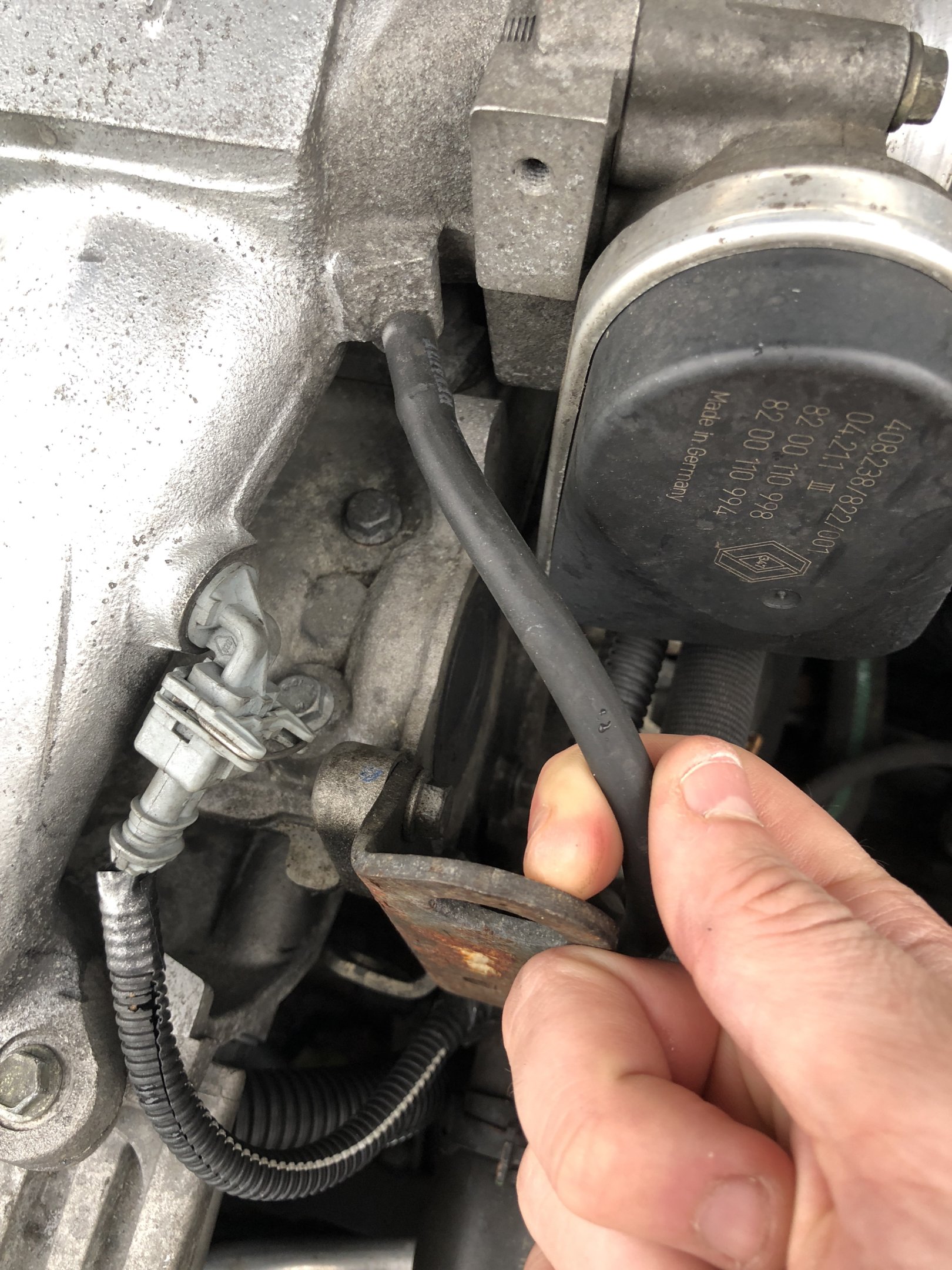

It was, guessing somethings flicked up and damaged it - wheel arch liners were removed before i bought the thing
  Clio 182
Just in case anyone was interested - the soft cover for the aux pully had fould causing the belt to wear and partially snap - fixed in about 1.5 hours phew

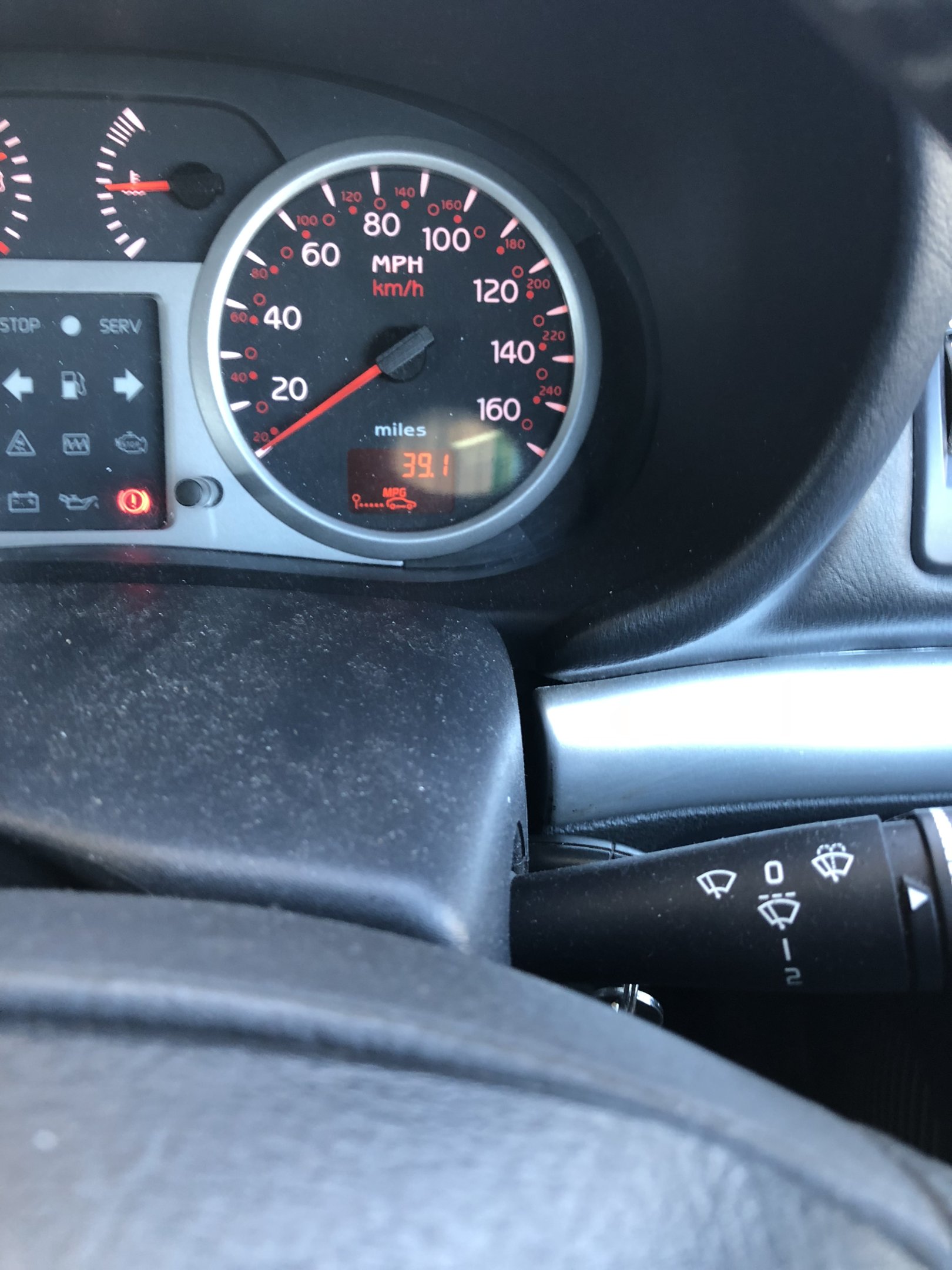

Went up to Yorkshire this weekend about a 310 mile round trip, car was faultless tbh - just ticked out 100k and still returning 350miles + 50 left in tank and late 30’s mpg!
  Clio 182
Tbh i sat at 40ish the way up in traffic roadworks on the m45/m1 but was happy coasting at the speed limit on the way home ;)
