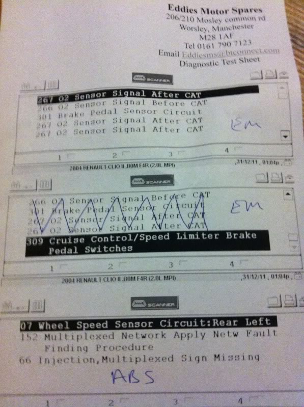

Just had my fault codes read, see pic
  Renault Sport 182
Just had my fault codes read by the local garage, seems to be an open circuit on the rear left wheel sensor, not sure about the others though.
Should i check the wireing to the sensor first, he was kind enough to check on auto data and told me its pins 14 and 29?
Any comments welcome.

Always check the wiring first then physically inspect the sensor and target for any faults. if no luck and all connections are good replace the sensor.
