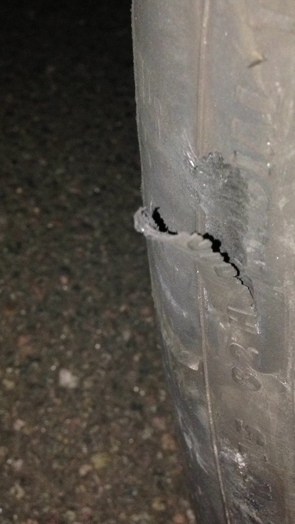

Too busy beeping at a friend and I ran into a kerb at about 10-15mph.
The wheel went onto the kerb, it did not just bounce off it.
Here is the damage to the wheel and tyre.
Do you think it's safe?

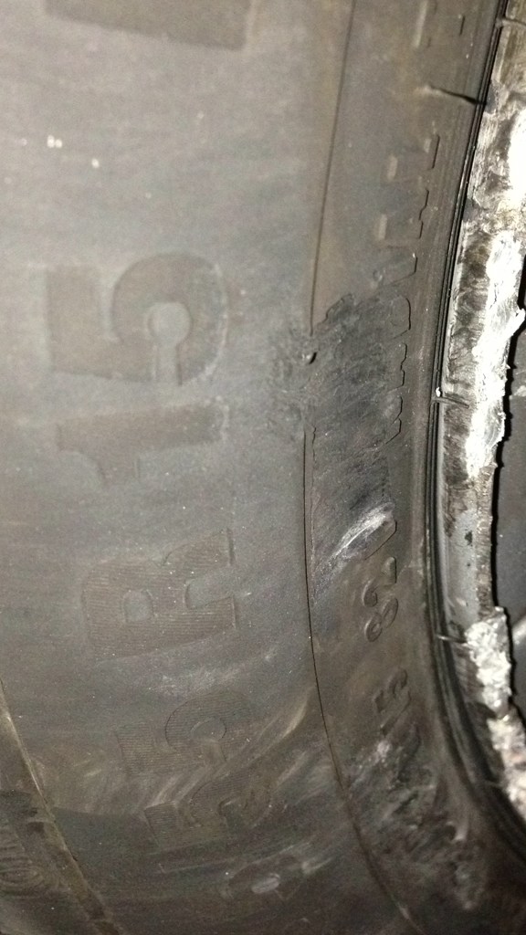

The second picture is when I peeled the excess off

I think I'm going to put that wheel on the rear for piece of mind!
I'd rather still have steering if it decides to blow :eek:

Tyre should be fine, dad did exactly the same to his T5 Sportline when I was in it, I seen it coming and literally just cringed! He has quite a hefty chunk missing too!
  Many.
Echo whats above, thats just a small bit of outer rubber, if it was down the cords I'd want to throw it away.
