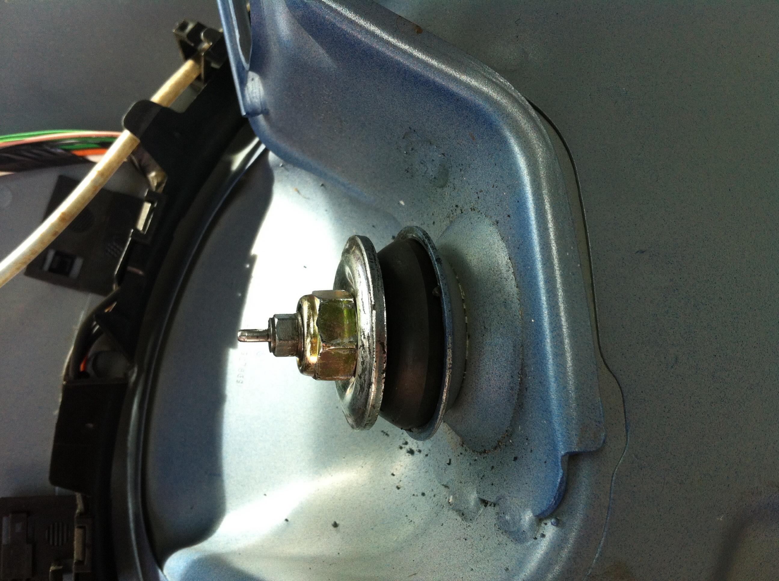

Currently trying too fit a set of rear adjustable yellow Koni's into a clio, has anyone got any pictures of what order the rubbers and things go in at all?
and should the standard rear rubber top mounts fit on the shocks? currently they are not fitting on.

ahh right! so your not supposed too use just a normal piece off rubber then? your supposed to use something with a metal sleeve lining the inside of the rubber?
Currently there is a dome shaped all rubber mount (no metal tube inside) with flat side facing up against a big metal washer with the nut on top, dont know if this is correct or not as the standard oem top mount has metal inside and a sleeve soo has a lot less give than just a pure rubber mount that I have in place currently

can someone please confirm if correct or not?
( tried too attach a picture )

Ph1 Tom
From the top. Nut, washer, rubber, car, rubber, washer
The Koni shaft is 12mm which is bigger than the 9mm standard shaft. There's no metal sleeve for the Konis, just use the bushes on their own.
