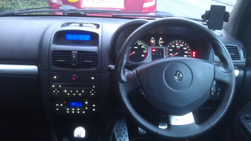

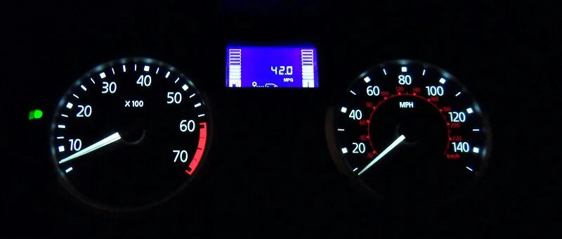

I have, it's fiddly and takes ages but it looks good. The only problem was the centre console clock. That's supposed to have bulbs in it but my old 05 182 has some strange kind of SMD's in it that nowhere sold, they had 4 mounting points as apposed to two.
In the end I wired in two bulbs from elsewhere for the clock and sanded the orange filter but it never looked right.

Looks brilliant.
Fiddly isn't a problem.
I'm an electrician and have worked on computer motherboards before.
How much did it cost and how long did it take?
Should be 2nd nature to you then costs around £4-5 maybe cheaper maybe dearer. It'll take around an hour or two I got a harness made up so I can test the dash is correctly working too.
Those SMDs are easy to get hold of, they're PLCC-4 SMDs.
All MK2 Clio 2004+ that have a centre LCD in dials use these, and also most of the centre clocks too.
