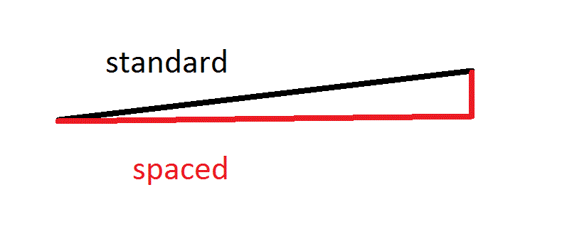

And just to really help, imagine this one too:
Also with identical geometry between the inner and outer pivot points.

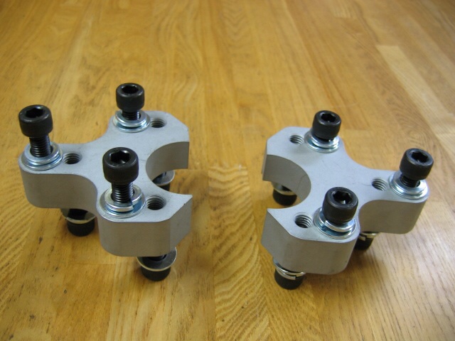

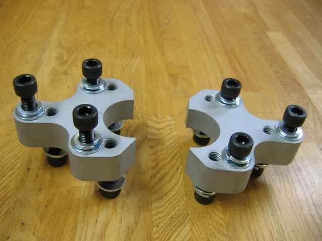

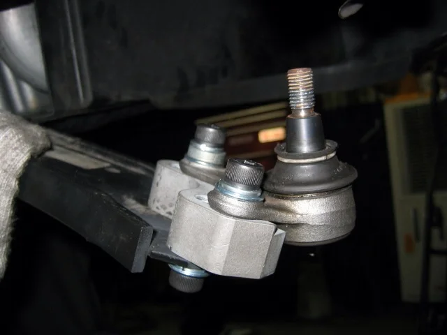

A ball joint extender with the ball joint in the original mounting place is the easiest solution to do correction cheaply and keep everything oem but you could knock them pictured spacers above in your shed which makes them very easy for some improvement.
Edit: and to answer the op, my pictures are the easiest way to make longer ball joints while also going someway towards correcting the roll centre and poor wishbone angle when lowered.
They will NOT help by being thick mate, spacing it out on a flat spacer would be exactly the same, they are just heavier!
I cant believe a bright guy like you isnt understanding this even with my help, I can only apologise if Im not explaining it well enough.
But just try it with a practical experiment if you cant just reason it with logic like I can, get two bits of metal, one bent and one straight, with the same length between the ends and then move then in an arc, and you will see the ends move exactly the same.
Sadly mspaint wont let me rotate 10 degree or I would show you, lol.

Aye I see what your saying, draw a line through the two pivot points and the wishbone angle is irrelevant, the wishbone could be 'v' 'w' or any conceivable shape and it would still make no difference. My theory wasn't quite correct in that sense but it still lengthens the wishbone essentially as per OP.

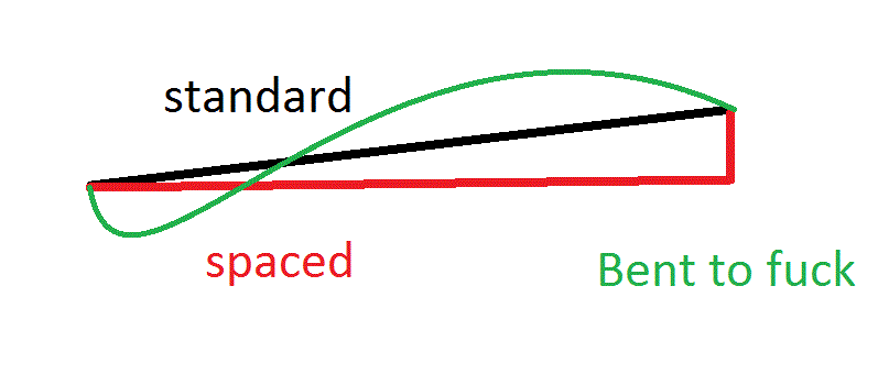

look at the green arm I drew. What's its wishbone angle? I made I bent to take away the temptation you have to just look at the big flat bit when deciding on angle.
  182/RS2/ Turbo/Mk1
Ignore that. Hadnt seen your reply. Glad you got there in the end with why it won't change roll centre. :)

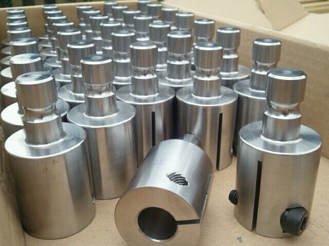

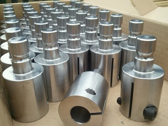

All you need to do is flatten the hub/extender meeting face when using my pictured extenders. Exactly what you have done with the fat pin in your kit ;)
The VW boys still weld the pins to the hub as they get ovaling of the hub using your theory which I have said to you before.
What are these off Morgan - did you fab them up?
No that's just a generic image I found but that is the simplest type you could make in terms of machining time.
VW, Jap and 4x4 lads have been using this type for years.
There is a lot more to it than that actually in terms of how they locate, a lot of thought has gone into that kit :)
It is all stuff that could be done on one of these types too though of course.

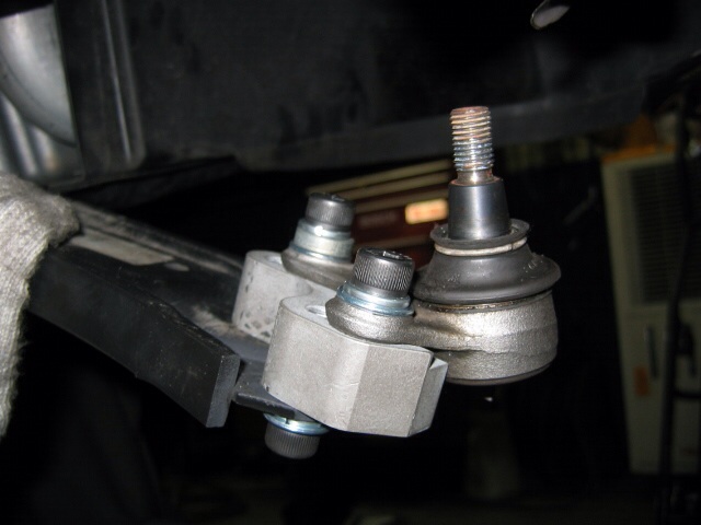

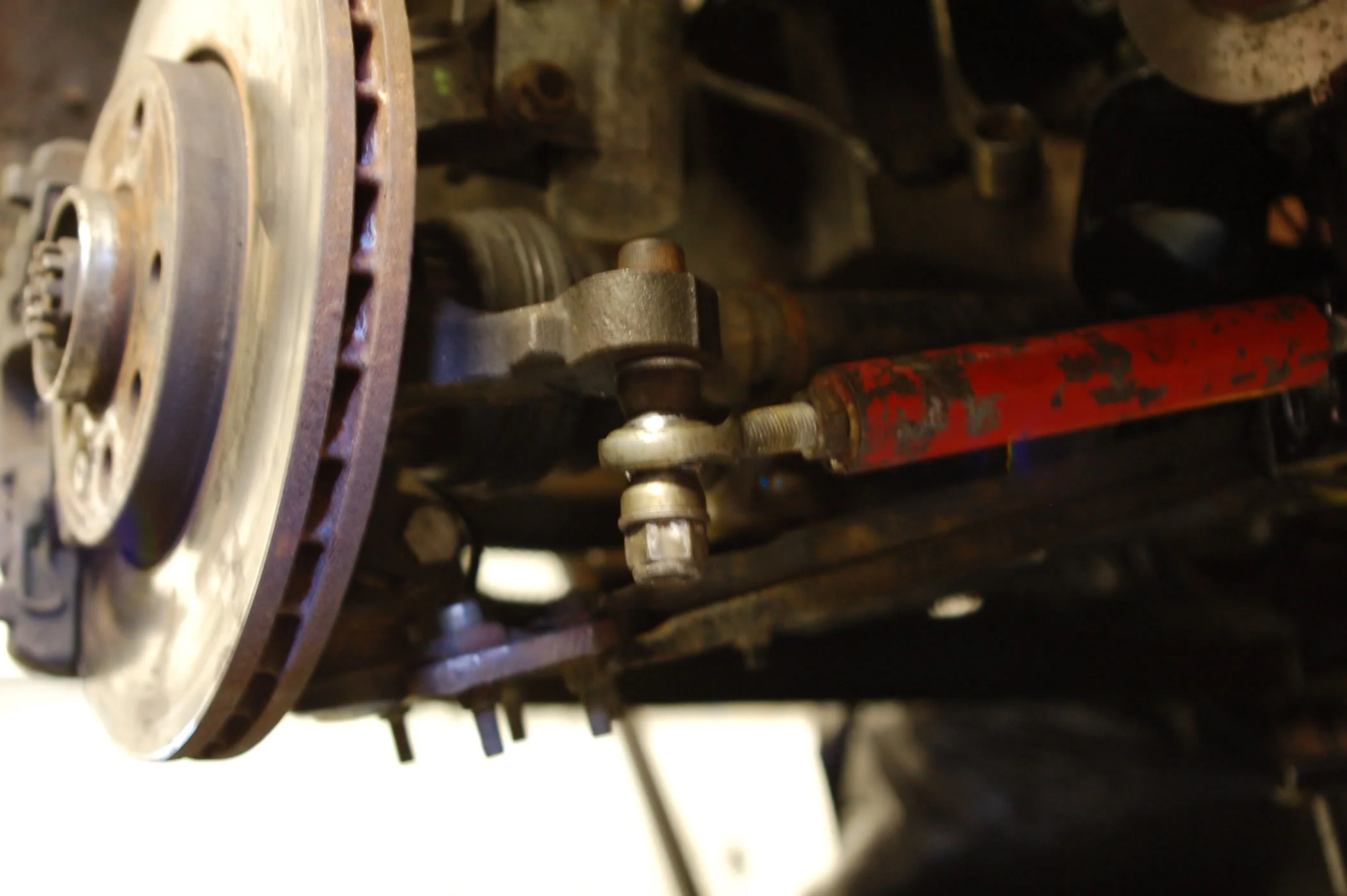

Not a great picture but if you look at the balljoint on the wishbone on this setup I did on the rear of my nova, you can see it spaced out with a plate like I mentioned:
(not the rose jointed but in the foreground of the picture, the slightly out of focus balljoint in the background)
