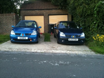

Literally took brownyboy 5 minutes. Hahaha. Thank you so much.
This is a pic of the car literally as it was taken off the axels.

Gonna give it a clean tomorrow and take more! And yeah cheap as chips, saving to get my 182 rb ff.. Mm aha doesn't bother me what brand/no brand they are so long as it doesn't break ;)
  MG ZR 1.8
Nothing wrong with cheap-ish springs, some can be alright.
Looks not bad though, not bad at all. Have to get some decent pics.
If I rememberim gonna dash home and pick up the canon camera tomorrow, get some really nice pictures with that.
